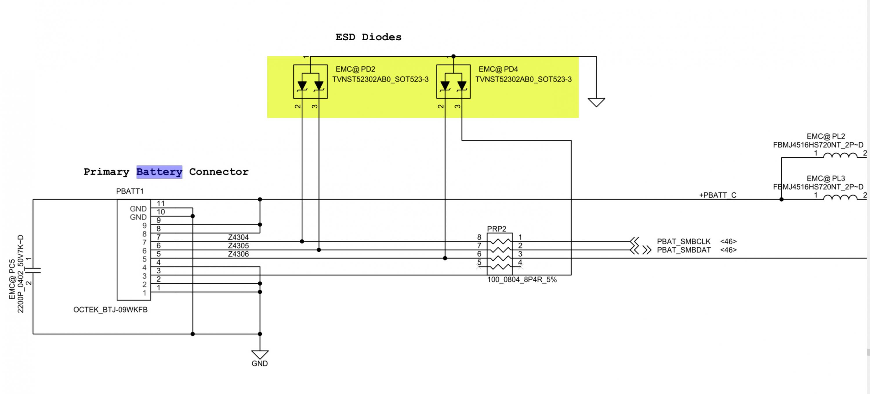

    dell e6440 la-9931p rev:1.0 battery not detected already i replace battery
    still problem same. pls help thanks in advanced

    Battery not detected will be:
    1) connector fault
    2) connector contacts not soldered
    3) ESD diodes clamping the SMBUS circuits - remove PD2 & PD4 and test again. My bet (of a fresh box of Haldiram's motichoor ladoos) are on this fault. Killed 3 days on a macbook (other shops gave up on it) and it was down a tiny tiny SMD ESD dual didoe - needed tweezers to solder it.
    See attached. Post your updates.

      Re: dell e6440 no battery detected
      Sometimes its a shorted cap or mosfet on discharge circuit.
        yes!!!
        done pd2 is faulty i remove pd2 now battery detected
        thanku so much
          SMD ESD dual didoe
          DIODE. LOL, salivating while typing ☺️
          Good job. The ESD diode did it's job to suppress a transient event at the battery connector. Do replace it if available.
