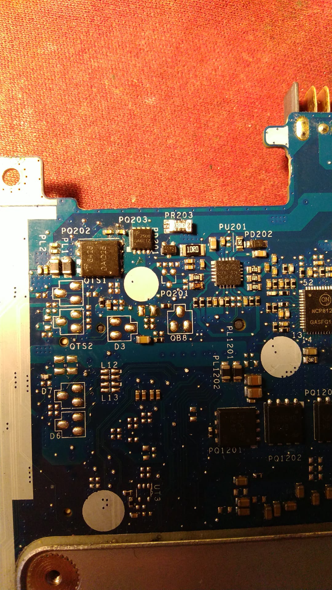

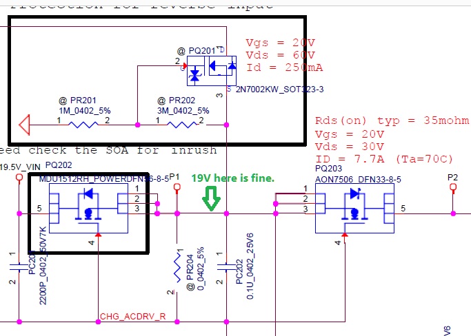

HP 250 G5 death
  • shybear
    • Jan 2010
    • 96
    HP 250 G5 death
    hi,
    I've a weird problema with this laptop tha t mount a BDL50 LA-D704P rev:1.0 mainboard.
    If I attach powerthe led near power connector doesn't light on and just sometimes its visible a periodic spike of 0,04A for a second next 0A again.
    There is nothing burnt and if I test the voltage at PQ202 main mosfet I get 19V but on the exit of it there is nothing.
    So without desolder it I just bypassed PQ202 putting 19V directly on PQ203 and alls works fine.
    So I desoldered PQ202 that looked to be good with tester but I changed it anyway with a new one.
    It doesnt' solve the issue and with the new one I've the same problem.
    There isn't so much components mounted and the only thing that could be is that PC201 is shorted but on mainboard its not printed. So I tested capacitors around here but it seem to be all fine.
    If I bypass PQ202 all works (I tested the boot too) but I think its not safe works without it.
    I attach a picture of the zone and also the complete schematic for reference.
  • mon2
    • Dec 2019
    • 14299
    Re: HP 250 G5 death
    Review the following voltages to ground:
    REGN
    ACDRV
    ACOK
    Of the charger IC at PU201. Post each measurement.
    The fault is likely in PQ203.
    • shybear
      • Jan 2010
      • 96
      Re: HP 250 G5 death
      Originally posted by mon2
      Review the following voltages to ground:
      REGN =>5.73V
      ACDRV => 0V
      ACOK => 0V
      Of the charger IC at PU201. Post each measurement.
      The fault is likely in PQ203.
      I also checked PQ203 (right now without desolder it) and it seems to be fine.
      I just checked again all small capacitors around PQ202 and no shorts.
      • mon2
        • Dec 2019
        • 14299
        Re: HP 250 G5 death
        Remove PR208 (~4k ohms) and check if the ACDRV voltage boosts to ~25 volts at the charger IC pin # 4.
        • mcplslg123
          • Jun 2015
          • 7262
          • india
          Re: HP 250 G5 death
          How you are measuring PQ202/203?? In resistance mode set your meter to highest scale and measure between
          01.PIN1-pin4
          02.Pin1-Pin8
          03.Pin4-Pin8
          • shybear
            • Jan 2010
            • 96
            Re: HP 250 G5 death
            How you are measuring PQ202/203?? In resistance mode set your meter to highest scale and measure between
            01.PIN1-pin4
            02.Pin1-Pin8
            03.Pin4-Pin8
            Thanks, yep if I'm right gate must be isolated from drain and source and also I tested between IN(pin5-pin8)- OUT(pin1-pin3) in diode mode.
            I bought anyway PQ202 (same as the mounted one) even if the original one tested with tester was fine.
            • shybear
              • Jan 2010
              • 96
              Re: HP 250 G5 death
              Originally posted by mon2
              Remove PR208 (~4k ohms) and check if the ACDRV voltage boosts to ~25 volts at the charger IC pin # 4.
              Following your direction I removed PR208 (4,12K) but ACDRV is still 0V.
              If I inject directly 19V on the OUT(pin1-pin3) of PQ202 I measure 25,6V on gate (pin4).
              Last edited by shybear; 02-03-2023, 05:32 AM.
              • mon2
                • Dec 2019
                • 14299
                Re: HP 250 G5 death
                Resistance mode, not diode mode.
                Post each measurement.
                Remove pq201 and test again. The 4k resistor should be put back on the ACDRV pin.
                Last edited by mon2; 02-03-2023, 06:49 AM.
                • shybear
                  • Jan 2010
                  • 96
                  Re: HP 250 G5 death
                  Originally posted by mon2
                  Resistance mode, not diode mode.
                  Post each measurement.
                  Remove pq201 and test again. The 4k resistor should be put back on the ACDRV pin.
                  PQ201 its not mounted on this mobo!
                  • mon2
                    • Dec 2019
                    • 14299
                    Re: HP 250 G5 death
                    Resistance mode, not diode mode.
                    Post each measurement.
                    Also, for:
                    REGN =>5.73V
                    Where did you attach the adapter voltage ? Or is this with the bypass of PQ202?
                    Are you using the original and recommended power adapter for this laptop?
                    Last edited by mon2; 02-03-2023, 08:05 AM.
                    • mon2
                      • Dec 2019
                      • 14299
                      Re: HP 250 G5 death
                      What is the voltage to ground of ADP_SIGNAL ?
                      This voltage is used to detect if the correct adapter is mated to the dcin connector or not.
                      If it is the wrong range, then ACDRV will not be boosted.
                      The bypass trick is also bypassing this adapter checking logic.
                      • mcplslg123
                        • Jun 2015
                        • 7262
                        • india
                        Re: HP 250 G5 death
                        The OP is drawing his own conclusion without mentioning the measurements going by the reply at post#6. Its not possible to suggest anything worth without suggestions not being answered completely/vaguely.
                        • shybear
                          • Jan 2010
                          • 96
                          Re: HP 250 G5 death
                          Originally posted by mon2
                          What is the voltage to ground of ADP_SIGNAL ?
                          This voltage is used to detect if the correct adapter is mated to the dcin connector or not.
                          If it is the wrong range, then ACDRV will not be boosted.
                          The bypass trick is also bypassing this adapter checking logic.
                          Man you're a genius!!!
                          I didnt't know this type of adaptor is smart power and you're 100% right.
                          I just tried with an original power adapter for and HP Spectre and even if this one is just a 45Watt, if I connect it to power jack the led light on!
                          Really thanks so much for help!!!
                          • shybear
                            • Jan 2010
                            • 96
                            Re: HP 250 G5 death
                            The OP is drawing his own conclusion without mentioning the measurements going by the reply at post#6. Its not possible to suggest anything worth without suggestions not being answered completely/vaguely.
                            First of all thanks! I know you wanted to know if I was right to say that mosfet are ok, so I was not so specific just to explain how I test these components.
                            Anyway for future reference help:
                            pin 1-2-3 => SOURCE
                            pin 4 => GATE
                            pin 5-6-7-8 DRAIN
                            so if the component is good GATE must be isolated for drain an source, so:
                            pin1-pin4 =>infinite
                            pin8-pin4 =>infinite
                            Between source and drain there is a junction so I usually test it putting tester under DIODE mode then:
                            pin1-pin8 must be around 0,5/0,6V direct and inifinite in the reverse.
                            • mon2
                              • Dec 2019
                              • 14299
                              Re: HP 250 G5 death
                              https://electronicsbeliever.com/how-...-is-defective/
                              • mcplslg123
                                • Jun 2015
                                • 7262
                                • india
                                Re: HP 250 G5 death
                                Originally posted by shybear
                                First of all thanks! I know you wanted to know if I was right to say that mosfet are ok, so I was not so specific just to explain how I test these components.
                                Anyway for future reference help:
                                pin 1-2-3 => SOURCE
                                pin 4 => GATE
                                pin 5-6-7-8 DRAIN
                                so if the component is good GATE must be isolated for drain an source, so:
                                pin1-pin4 =>infinite
                                pin8-pin4 =>infinite
                                Between source and drain there is a junction so I usually test it putting tester under DIODE mode then:
                                pin1-pin8 must be around 0,5/0,6V direct and inifinite in the reverse.
                                Thanks for clarifying but still prefer to check mosfet in resistance mode and not diode mode. A slightly leaky mosfet(not shorted) can only be detected when you measure it in resistance mode.Diode mode readinf may misguide you at times.
                                • CapLeaker
                                  Dell ATX PSU won’t start, but forcing it works fine?
                                  by CapLeaker
                                  Got a case of something new weird at work. There is an old 2nd gen Intel i3 in an old “Pizza box” shell that has a small form factor power supply. Unfortunately I forgot to take pictures and model number off it.
                                  Anyway, I get to work and get to look at this computer. Standby LED on the PSU is on, but the computer won't start. Hmm o.k. take the battery out of the main board try again, nothing. O.k. then… unplug the power supply from the main board and put in a full size ATX PSU (yeeeesss! Exact that blown Powerman IP that I fixed a while back), plug it in and the old...
                                  10-28-2024, 06:59 PM
                                • rounin
                                  MacBook Air A2337 (820-02016) USB-C Port Issue – Only Works in One Orientation (CC Line Problem?)
                                  by rounin
                                  Hi everyone,
                                  I'm working on a MacBook Air 2020 (A2337, board 820-02016) and running into a strange USB-C issue. I've gone through quite a bit of testing and part replacement, but I'm stuck — hoping someone here can shed some light.
                                  🛠 Original Issue
                                  The machine initially wouldn't negotiate 20V over USB-C — stuck at 5V.
                                  Diagnosis showed PP1V5_UPC0_LDO_CORE shorted to ground.
                                  I replaced U3100 (UF400) using a donor board (A2179), and the machine powers on fine now.
                                  ⚠️ New Problem: One USB-C Port Only Works in One Orientation...
                                  04-19-2025, 01:18 AM
                                • ex250
                                  Kenwood SW-505D no sound issue and pops from time to time when it works
                                  by ex250
                                  Hello mates,
                                  I bought this subwoofer a few days ago used and blind and it works erratically, as far as I could see, it has been tampered with, the speaker is not the original one and of 8 Ohm when it should be of 4, and there are some welds like reworked by the boards.
                                  It doesn't have much power (expected more from it) and it distorts if you increase the volume over the middle, maybe it's because of the high impedance of the speaker. The problem is that it has sound when it wants, the led panels all work correctly, you can hear the power relay on power on, but right now...
                                  12-29-2024, 03:27 PM
                                • eurowill
                                  a2141 820-01700 internal display not working / external works
                                  by eurowill
                                  Hey ya'll this is my first post on here. I recently aquired a used/broken 2019 mbp 16 a2141 with the 820-01700 board. Seller told me that the laptop needed a new lcd. However upon doing some troubleshooting i found out the lcd is fine.
                                  Laptop boots like a normal, plays chime, touchbar lights up however there is no image on the internal lcd. If i connect and external monitor while its already on, nothing happens and no image is displayed on external. However if i restart or boot the machine while its plugged in, the external then works and a backlight is now visible on the laptop....
                                  07-23-2024, 10:06 AM
                                • vf fa
                                  EIZO CX270 - No signal but Backlight and Panel works, logo works, admin menu works. OSD doesn't. What?!
                                  by vf fa
                                  Hi, so i guess I´ll have to make a new topic here, as i browsed through hundreds of other threads but couldn't find a solution to my problem yet.
                                  I got a EIZO CX270 from a friend. He said it doesn't work anymore and wont display any signal or take any OSD inputs. Well, as an aspiring photographer I couldn't say no, could I? Thought it was an easy game, replace a bad cap and have a working monitor. But nooope, it wasn't supposed to be this easy.
                                  So let me start with the problem description. I'll try my best not to skip anything so this might get rather long.
                                  01-31-2024, 01:40 PM
