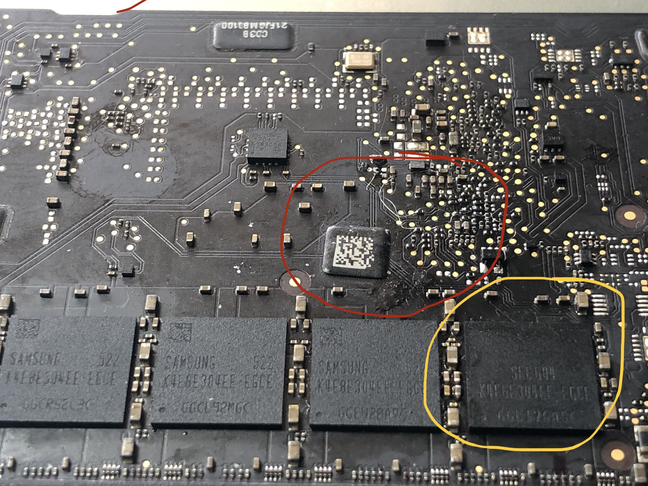

    So, I reworked processor.
    But I am not lucky.
    When I was removing the processor, I heard a few pops under it.
    As I understand, the remains of the juice exploded under the processor.
    But when I returned the processor to its place, I saw the absence of several 3.3 Volt connections on the back of the board.
    Apparently, this was the destruction of the layers inside the board.
    If I am pressing on this place, the connections are restoring.
    I haven't seen this yet.
    I did not violate the thermal mode for removing the processor. For me, this effect is a mystery.
    I removed another processor from the same board using the same thermal profile - everything was perfect.
    It appears that this board is no longer recoverable.
    I have a question: can I install this processor from this motherboard (820-00165-A) to later version (820-3437-B).
    I assume that the processor is good conditions and I have a motherboard with a dead processor.
    Thank you.

      Re: MacBook A1466 820-165-A No power Missing PM_SLP_S4_L
      Watch some of DosDude's Youtube videos on MAC CPU transplants. He says that the Intel U processors warp when removed, and he uses larger balls to compensate (0.45mm).
      The 820-3437 is the older board used in 2013~2014 Macbook Air's, and the processor is one generation back. 820-00165 was used in 2015~2017 Airs. The 165 boards are more attractive for resale as they run Monterey natively. 3437 will only run Big Sur.
        Thank you for answers.
        Of course I have access to boardview and schematic.
        So I guess I finished my investigations:
        This photo shows that DDR was replaced (yellow field)
        I suppose that "a professional repair technician" violated the thermal regime, and the area marked in red was inflated. A bubble formed there. This area has vertical movement, that I didn't notice before.
        I had been trying to restore connection with the wire, but it is unless.
        I used 0.4 balls, I hope it's enough to compensate bending.
        Yes I agree with you, This processor would be better use on the same models (not lower).
        Thank you to everyone who replied. The information was very helpful.
        I suggest this topic may be closed.
