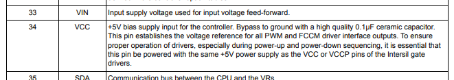

Does the Voltage Regulator ISL95859C supply +5 volt at pin 34 for the mosfet drivers or integrated Power Stages ?
https://www.farnell.com/datasheets/3109343.pdf

It doesnt supply, it shuould be supplied (fed) with +5V, that's power input not output.

Thanks for clearing this I was confused about that.

I post to confirm that the datasheet indeed state that Pin-34 it should be supplied with +5v
