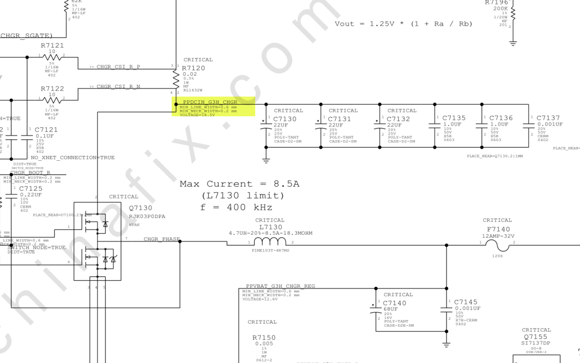

    Hi !
    Someone brought me a Macbook A1502 with no power & no green light on charger. Opened it & no liquid damage, good start.
    It had a short on the capacitors just above the battery connector, so I thought it would be simple. Injected voltage, saw a heat spot on the back of the board, and yeah, C6432 was blown (rather catastrophically, fused with the pad, but whatever, it's audio so it's not the most important for now), and removing it cleared the short.
    However, still no green light... Pull up my thermal camera again and OMG Q7010 & R7020 are at > 100°C !
    Here, I don't know where to look, as I'm clearly not an expert on Macbooks, but here's what I know :
    • The only other thing that heats up is U5000 (the SMC if I'm not mistaken), but only 30°C, so I think it's normal operating temperature.
    • Q7010 & R7020 are not getting hot immediately, only like 1s after plugging the charger (probably after the SMC kicks in ?)
    • There is no short after R7020 (it reads 100kOhm to ground, so it seems OK)
    • Caps around U7100 not shorted, R7121 & R7122 not pulled to ground by U7100 (read that it can do that)
    • PPBUS_G3H is around 2V, PPDCIN_G3H is around 15V (probably voltage drop due to the amperage drawn)
    Please tell me where to look, I'll take measurements, but can't let the charger for long to get voltages because of the heat produced.

    Re: Macbook A1502 820-4924-A No power
    Remove fuse F7140. Power up again.
    Meter in dc volts mode (20 volts or higher).
    What is the voltage to ground of the pcb pad for F7140, pin #1 (PPBUS_G3H)?
    Remove all power. Meter in resistance mode.
    Measure the resistance to ground of the pcb pad for F7140, pin #2 (consumer side of the PPBUS_G3H rail).
    Post all measurements and the meter scale used for the tests.

              What is the voltage to ground of PPDCIN_G3H_CHGR ?
              You can measure @ C7130 (+) tab.
                Originally posted by mon2
                Am confused.
                Pin 2 (PPBUS_G3H) is 10 MOhm
                Pin 1 (PPVBAT_G3H_CHGR_REG) is the one fluctuating between 400 kOmh & 2 kOhm
                PPDCIN_G3H_CHGR is 14.6 V
                • mon2
                  • Dec 2019
                  • 14415
                  That sounds too low. Using an official and proper rated power adapter?
                  What is the voltage to ground of PPDCIN_G3H ?
                  This is the INPUT voltage to the ISL6259 @ U7100. You can measure @ F7005.
                  What is the voltage to ground of PP3V42_G3H ?

                          I think you have assorted issues on this board - including use of a wimpy power adapter. The power adapter should offer a higher voltage than what you are measuring (assuming that your meter is accurate / with fresh batteries).
                          Measure the voltage to ground on EACH pin of D7005 diode. Does this dual anode diode pass through the voltage present on pins 1 / 2 - diode will select the higher of the 2 voltages to power this regulator.
                          If you DO NOT see the proper voltage on pin # 3 = output of this diode, then power down.
                          Remove all power -> meter in resistance mode.
                          Measure the resistance to ground on pin # 3 of this diode D7005.
                          Post all measurements.
