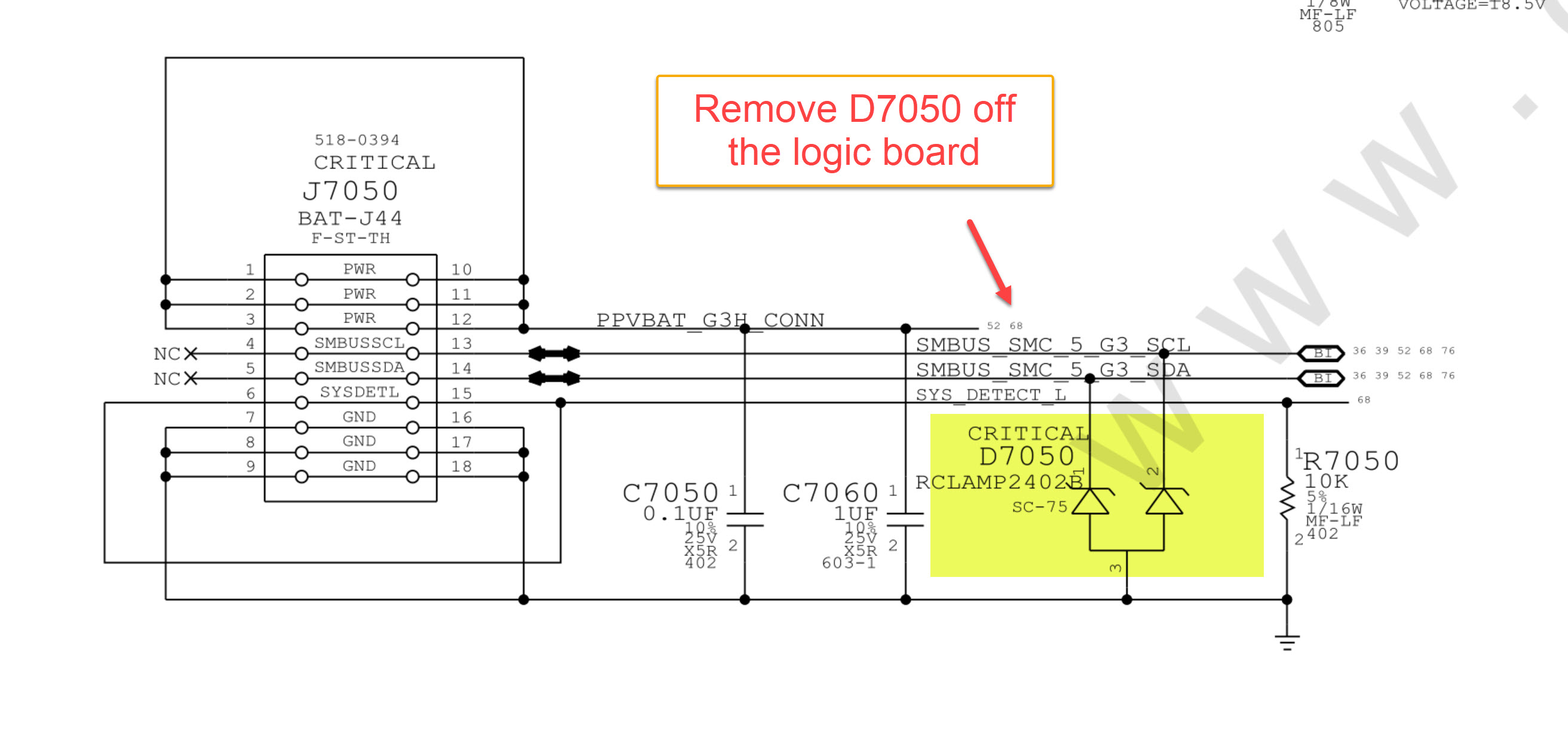

        Check the voltage to ground of the SMBUS SDA and SCL lines. Measure each and post the readings.
        • orion78fr
          • Apr 2022
          • 37
          • France
          Re: Macbook A1502 820-4924-A No power
          SCL (pin 4 of battery) is 2.820 V & SDA (pin 5) 6 mV
          • mon2
            • Dec 2019
            • 14680
            So SDA is stuck.
            Locate and remove D7050 ESD diodes off the logic board.
            Test again.

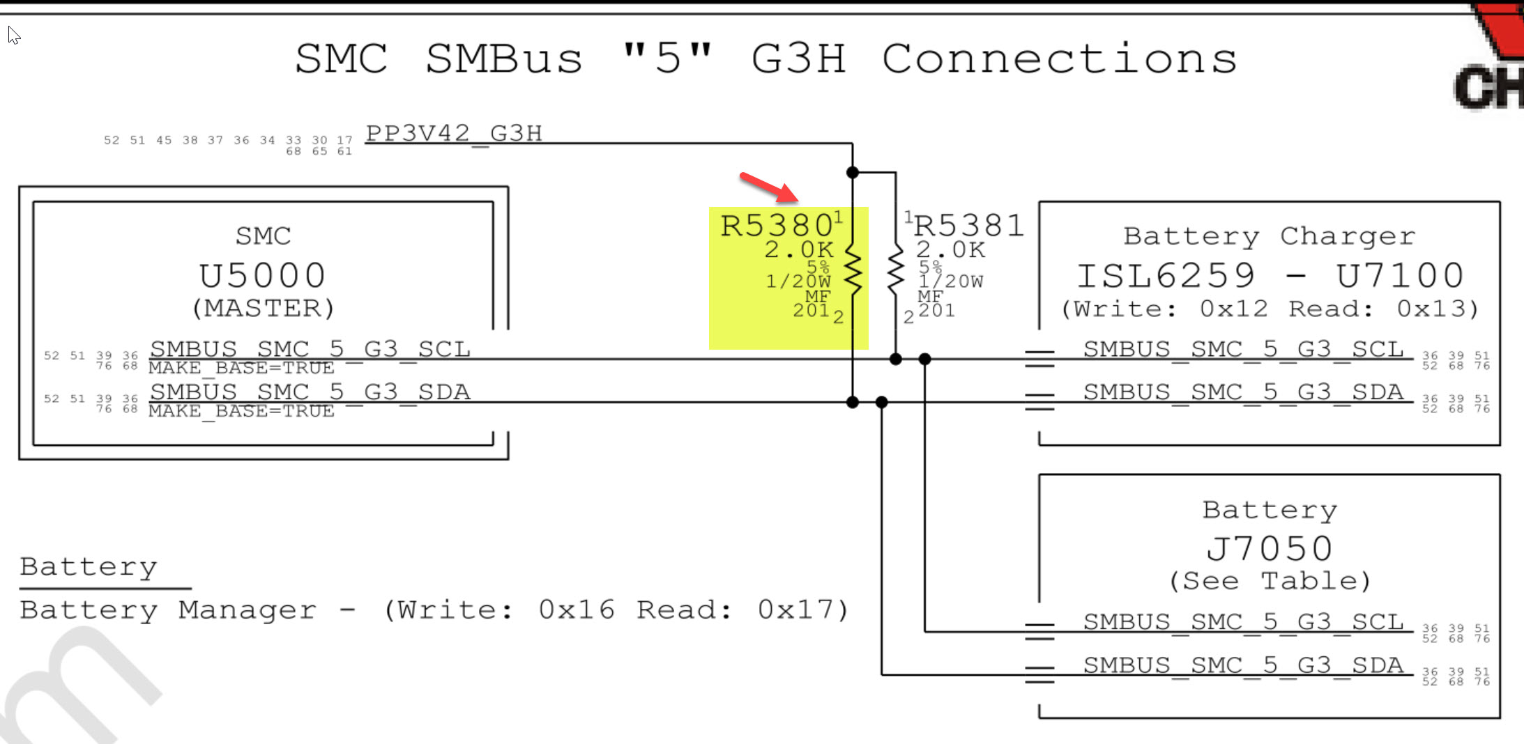

                Remove all power.
                Meter in resistance mode. Measure the resistance to ground of the SDA line.
                Compare the resistance against the (working / ok) SCL line.
                SMBUS (aka I2C) is an open drain driver. That is, there MUST be local pull-up resistors present on these 2 lines to function correctly.
                Respectively, check that the pull-up resistor @ R5380 is present.
                Measure the voltage to ground on each side of R5380.
                If R5380 is missing or defective, you can have the same fault.
                The value for the pull-up is not critical but must be present.
                  Remove all power.
                  SCL is 2.02 kOhm
                  SDA is 1.7 Ohm
                  R5380 reads as 100 Ohms
                  R5381 reads as 2k Ohm
                  Voltage on R5380 is 3.40 V on the PP3V42_G3H side & 6 mV on the SMBUS_SMC_5_G3_SDA side.

                  The value of R5380 seems too low, should I swap the resistor ? (the measure is in circuit so it may be 2kOhm but maybe there is a lower resistance path through the SMC)
                  • mon2
                    • Dec 2019
                    • 14680
                    #29
                    Yes - the resistance does not make sense. If it was this strong, the line should be hard high logic level.
                    Yes, remove it and then check the resistance without this resistor on the board.
                    Then replace it with any value of even up to 10k ohms.
