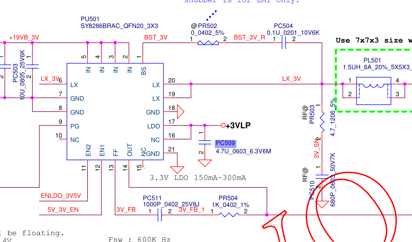

            Clearly +3VLP(LDO) is shorted to Ground. You need to inject 1V at PC509,pin1 with dc supply and observe what is getting hot. Very likely kbc and/or PCH.

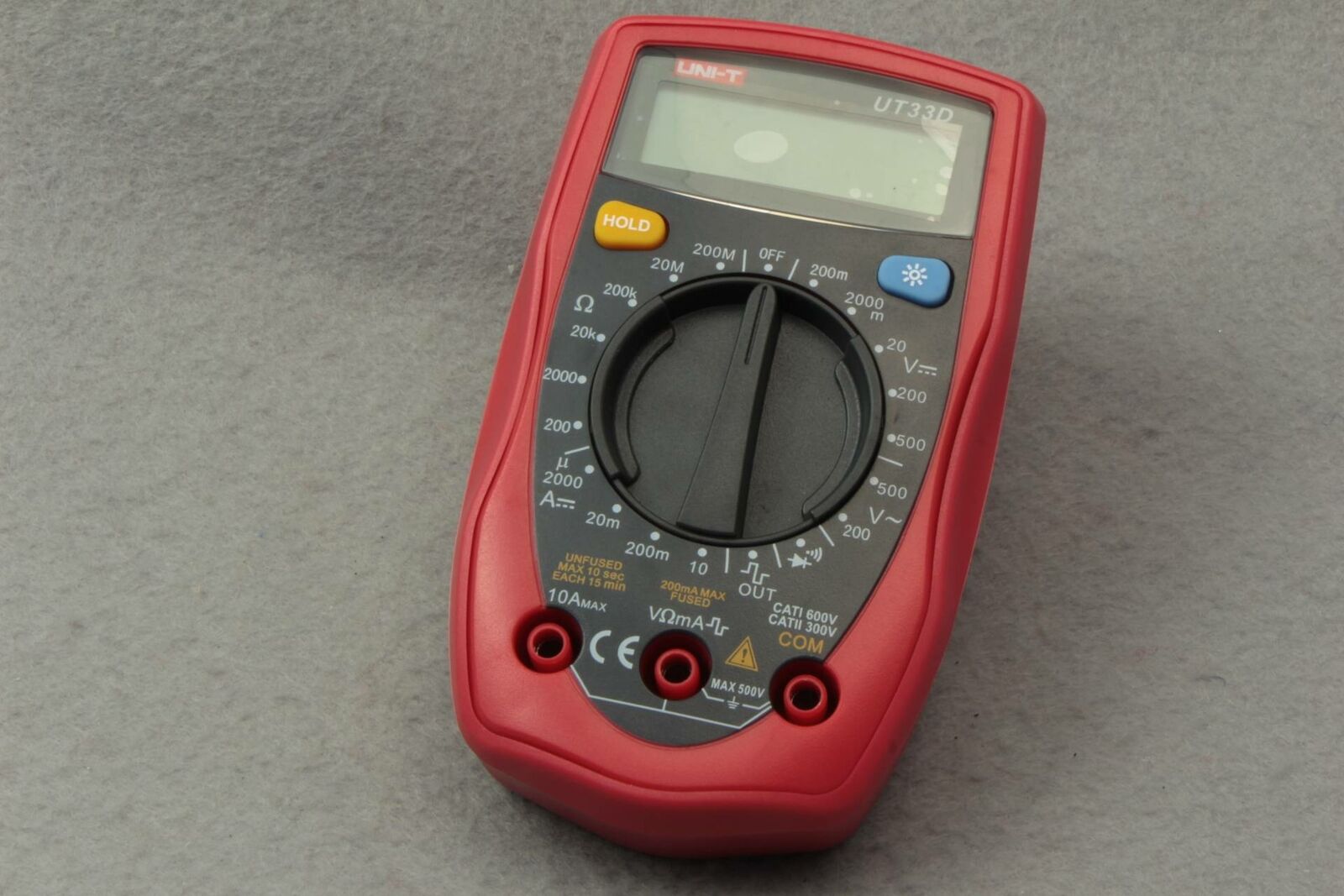

              Can you post a pic of your meter face used for the resistance checks? Wish to understand the scale of the measurements.

                since no board-view, i cannot find PR506 but i can say for sure that ENLDO_3V5V is present on pin 11 of PU501 its 4.5v and on pin 11 of PU509 its 0.49v
                It is the 5V_3V_EN on pins 12 of those that is missing.
                Pin 2 of charger IC is 20V
                On PC509 pin1 i have 1.3ohm resistance
                Attached photo of my MM

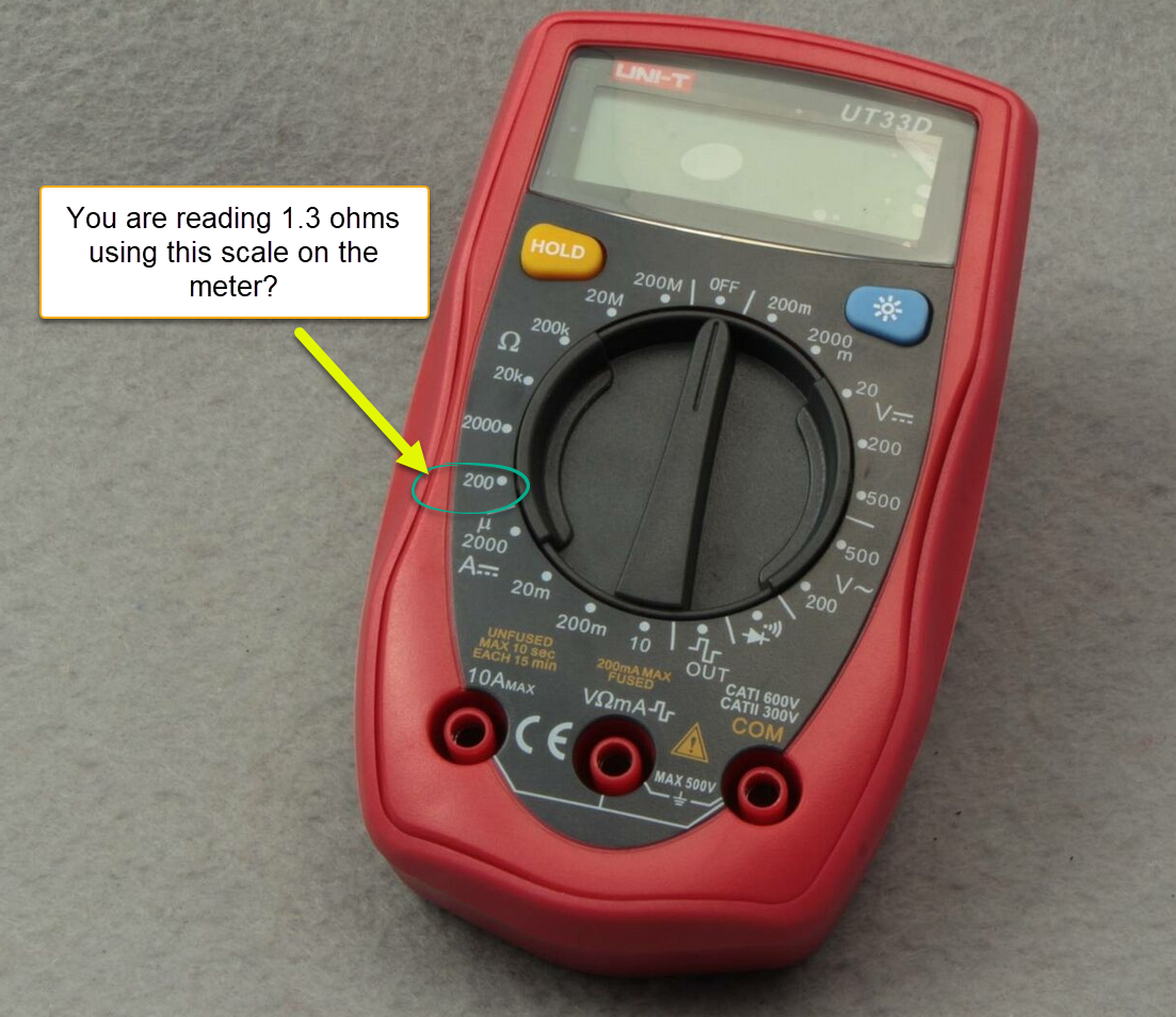

                  See attached. Can you confirm the reading and the meter scale used for this test?
                  If indeed 1.3 ohms on the 200 ohm scale, then you have a shorted component on this power rail.
                  As suggested by @mcplslg123, remove all power -> dial up your power supply to 1 volt (never higher to be safe from killing the CPU) & 2-5A.
                  Then red meter of the power supply on this LDO rail and black power supply lead to ground.
                  Review which part heats up or even cracks under this event. IPA works well to mist up while the part heats up. It may even be the capacitor @ PC509 but we need to confirm.
                  Post your updates.

                      It took me 3v to get the short to draw 0.4amp. i found out that the EC is getting hot
