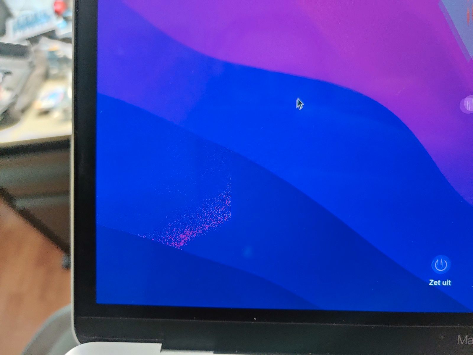

    Hi everybody
    I have a problem with friend laptop. Macbook pro a 1706.
    Hi has some screen fault. I will attach the picture.
    Is it repairable or does anyone good seller for screens in europe.
    I hope somebody can me give good information.
    No expierance in macbook repair.
    Regards Steve

    Anyone has idea see image left side undernee the glitching.
    Thank you

      I would validate that the graphics logic is working using an external monitor. Suspecting that the lcd display is defective. If you see the same fault on the external monitor then it is logic board issue.

        Hi Mon, So the screen kan not be fixed and need to be replaced. It is not the screen cable or so.
        Do you know reputabe seller for screens in europe.
