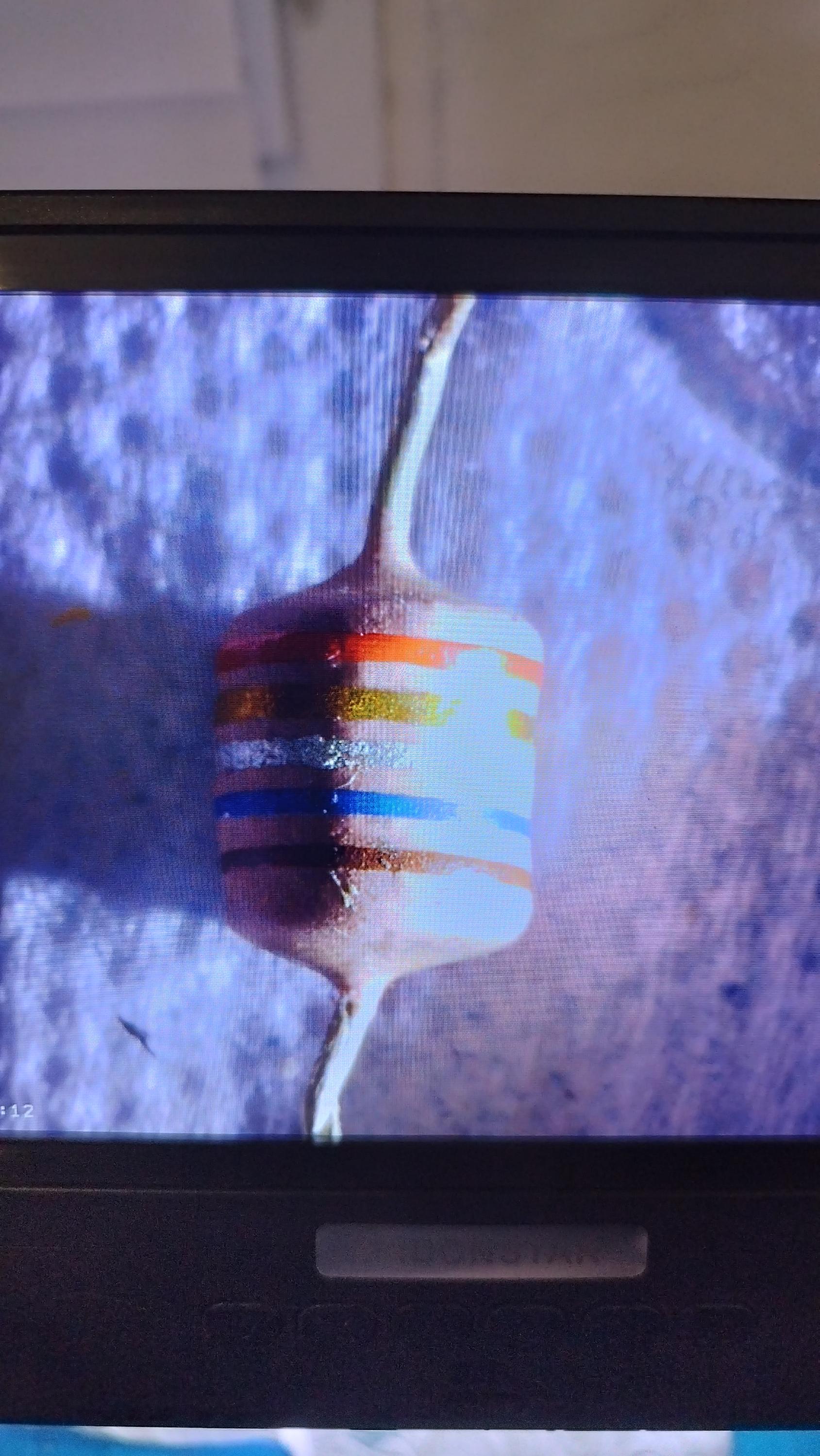

    Hello
    After checking this resistor which gives no value on the ohmmeter on a PS4 SLIM power supply.
    I would like to change it but by which power I can choose it knowing that this resistor is on the primary part that is to say on the 230/400 V side
    Value 16.8 Ohm normally according to color code (See photo)
    1st ring = Brown = 1
    2nd ring Blue = 6
    3rd ring Grey = 8
    4th ring OR Multiplier = x0.1 Ohm
    5th ring Red = +/- 2 %.
    Tolerance of either + or - 0.336 ohms
    Dimension of the resistor Length = 6.4mm, Width 4.8mm
    Can I place one between 15 and 17 Ohm or a little more?
    What power in Watt I can order if it is 2W or 3W
    I don't want to do anything stupid about the value to choose
    Thanks a lot to you

    This is a safety resistor, plays the role of a fuse (0.16 Om. 5%).

      Strange because it doesn't even sound continuous in this case

        What is strange here, 3 stripes (silver) is a multiplier of x0.01.

          Re: ps4 power supply resistance out of order, what to choose?
          I was really surprised to see this silver stripe in the 3rd position, so I considered it as a grey color.
          I can't find any other information about a silver band in the 3rd place for 5 rings.Maybe it should not be taken into account then =S so I will have to calculate it as 4 rings.
          This would give 0.16 Ohm but tested in several modes Diode or megaohm the resistance gives nothing at all.

            Is this the resistor at location F3? if it is, it is a 0.16Ω-2watt. Lotas post #2 is correct

              So the resistor is indeed 0.16 OHM which acts as a fuse we will say.
              I ordered a 2W and it is much smaller, so I took a 3W which is the same size and the power supply works now

                I don't think I've ever seen a multiplier band of gray (and definitely not white), it's always been silver of that set of similar colors.
                Purple multiplier is rare enough as it is... I think I've only seen 1 or 2 ever.
