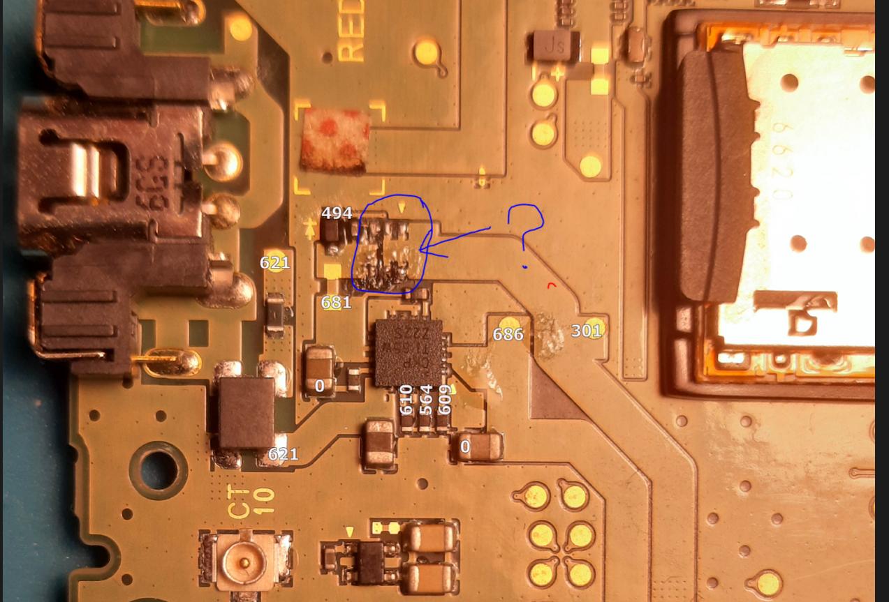

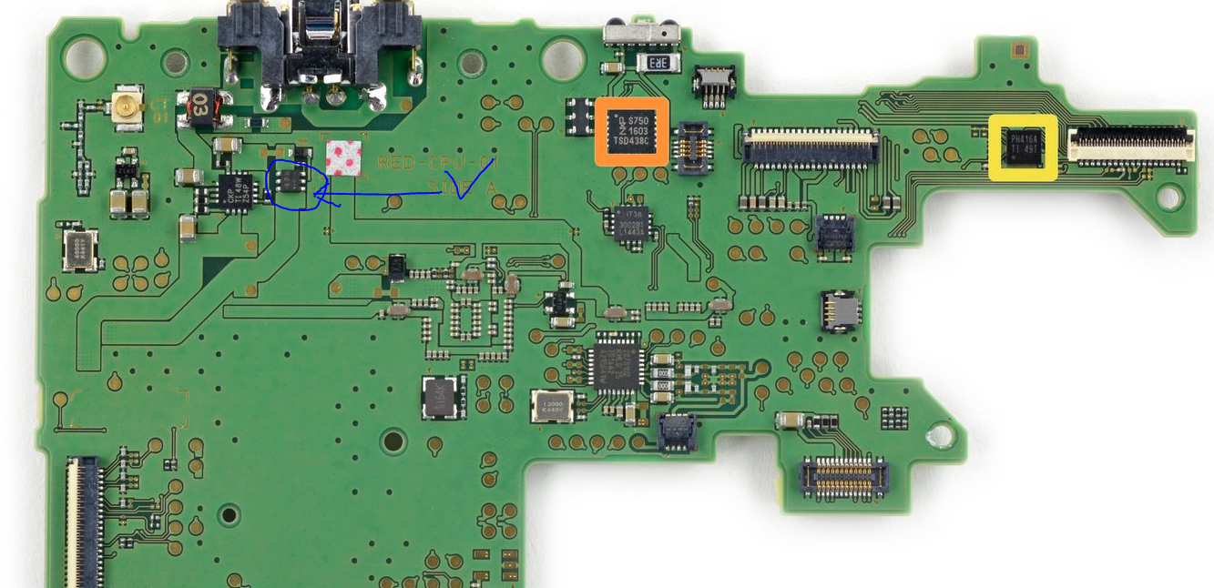

    Hi!
    I have this nintendo which had a bad home button. I've ordered a new one and when i mounted everything it didnt turn on.
    I did some measuremnts which you can see in the pictures.
    Could someone help me if i shorted something?
    Thanks.
    the zip file has 2 pictures with diode readings
  • lotas
    • Jan 2016
    • 4805
    • Russia
    Re: Nintendo 3ds xl. dead after home button replacement
    You are missing some kind of dc converter.
