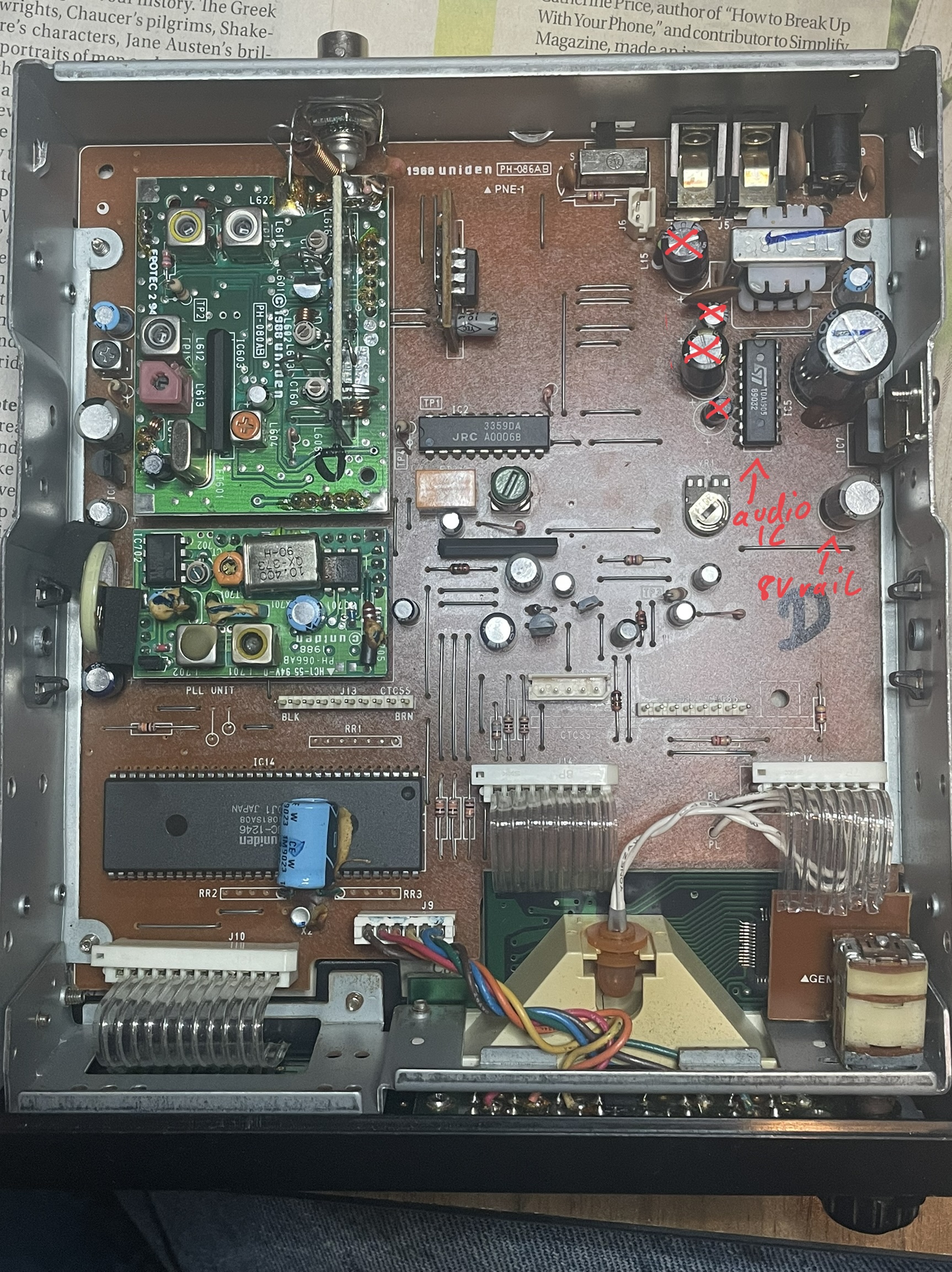

    Got today two Uniden BC 760XLT vintage scanners in for repair.
    Complaint: extremely weak / no audio.
    IC5 TDA1905 is the audio IC. Replace 4 electrolytic capacitors that are in a row next to the audio IC. See picture. When you are at it, change the capacitor for the 8V (7808) as well.
    Easy Saturday evening fix. Time for more

    don't cha love ezpz repairs with schematics...

      Re: Uniden Bearcat BC 760XLT scanner no audio repair
      I agree eccerr0r. Was a perfect Saturday evening repair after a hard week at work. Not complicated, straight forward and schematics to boot. It’s nice to catch a break like that once in a while. Lately it has been everything else but RF and audio to fix.
