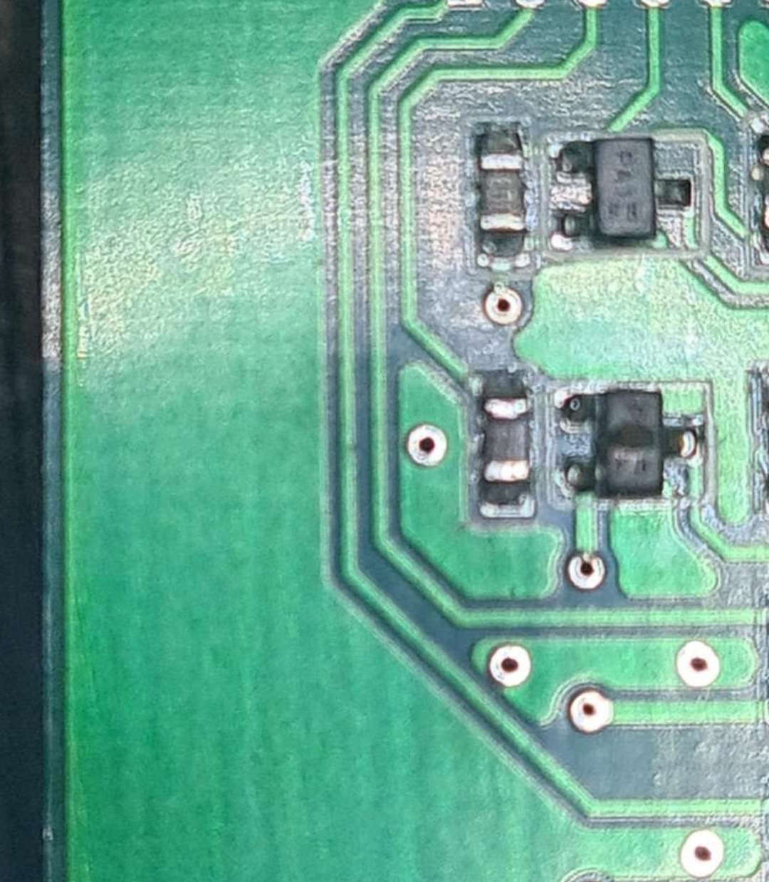

    My svod3 reader broke down and I checked and measured... and found out that sot323 diod is faulty
    Can I use a sot23 instead?

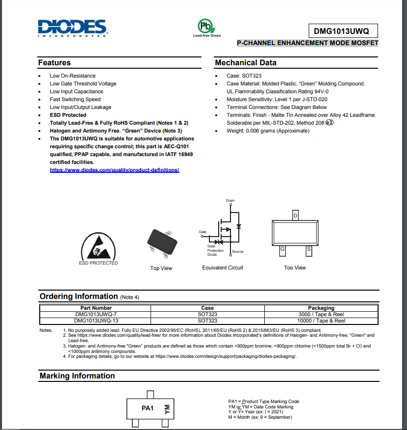

      The marking on the component is PA1 its diode right and not a transistor?

        Re: SVOD3 Programmer SOT323 diode faulty
        Not like that?
        • appie1206
          • Oct 2016
          • 127
          • netherlands
          Originally posted by lotas
          Not like that?
          See picture
            As indicated in post #4 it is a DMG1013UWQ mosfet
              I've also blown my SVOD3 up previously. Parts are all available off Aliexpress. For reference:
              PA1 (DMG1013UW)
              NH2 (DMN2300U)
              NG4P (TPD4E1U06DBVR)
              I recall the PA1 FET should measure 0.8V Drain to Source in diode mode, faulty one measured 1.2V. I did swap that one out with one of the PA1's at the top of the programmer, which fixed the SPI25 read issue I was having at the time. Parts came a few weeks later. I bought quite a few of them in case I do it again.
              https://www.aliexpress.com/item/1005002295417345.html
