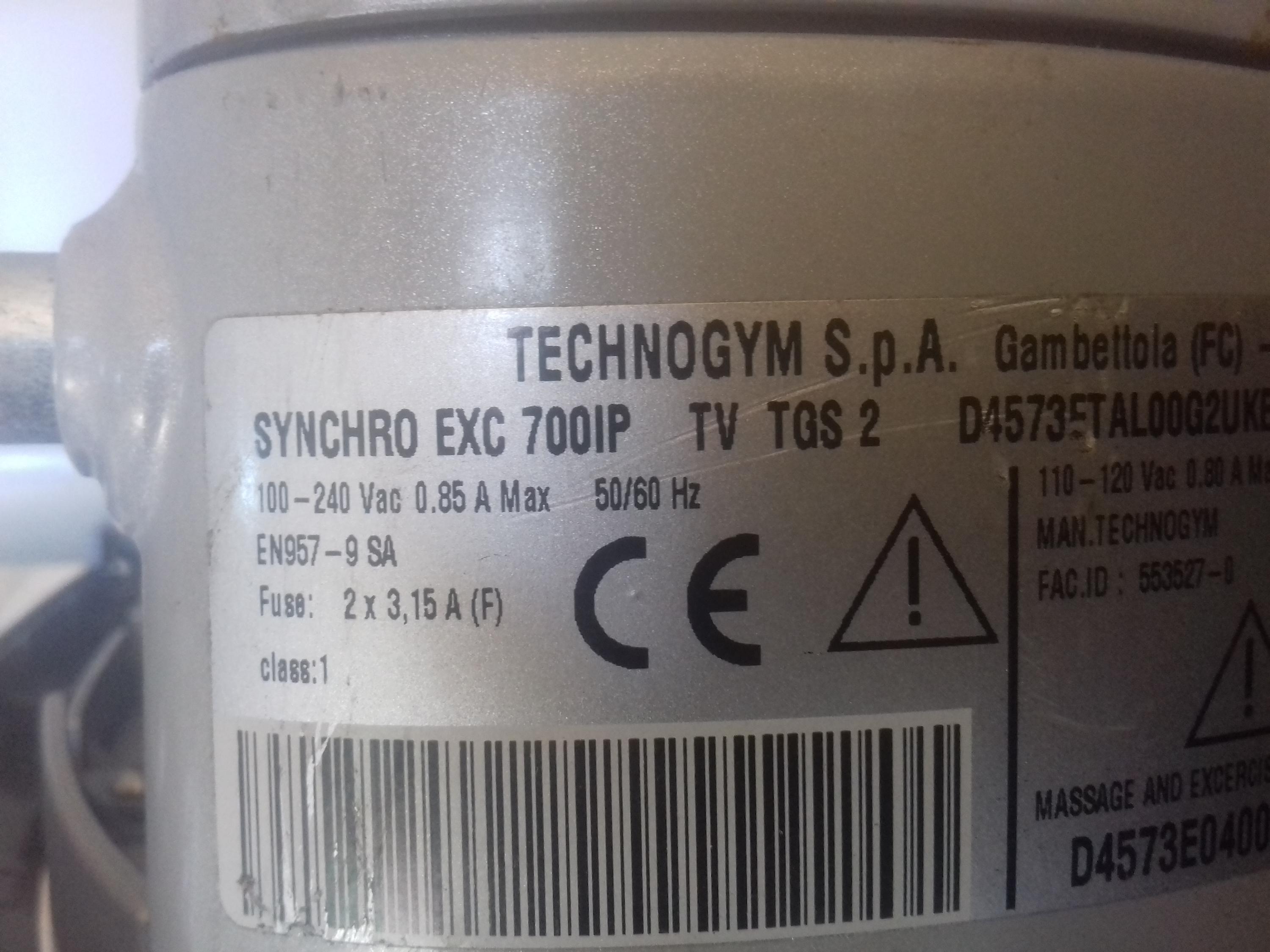

                          Re: need some help to limit current after repair
                          id label
                              id label
                              This is part of a sticker showing. The other part is the D4 numbers. From this sticker we know that there is a 15 AMP fuse on the output side which is most likely DC? The 2X3 in front of the fuse is anyone guess. Mostly likely the physical size. The input of the device is between 100 to 240 AC with a maximum current of 0.85 Amps. Multiplying .85x240=204 Watts of power. One can never get more power out of something then they put into it. I believe the 240volts in AC RMS if it is not the case then the Peak to Peak voltage must be converted to RMS before the multiplication to the 0.85 of current. So we know that no matter where we go in the circuit the DC voltage will never produce more than 204 watts of power. So where there are high voltages there will be low current. Understand though that any voltage can kill a person if the resistance to ground is low enough. Is this the only sticker on this device?
                              I believe this is your model https://cdn.badcaps-static.com/pdfs/...bb22ccb277.pdf
                              This has the pdf for download
