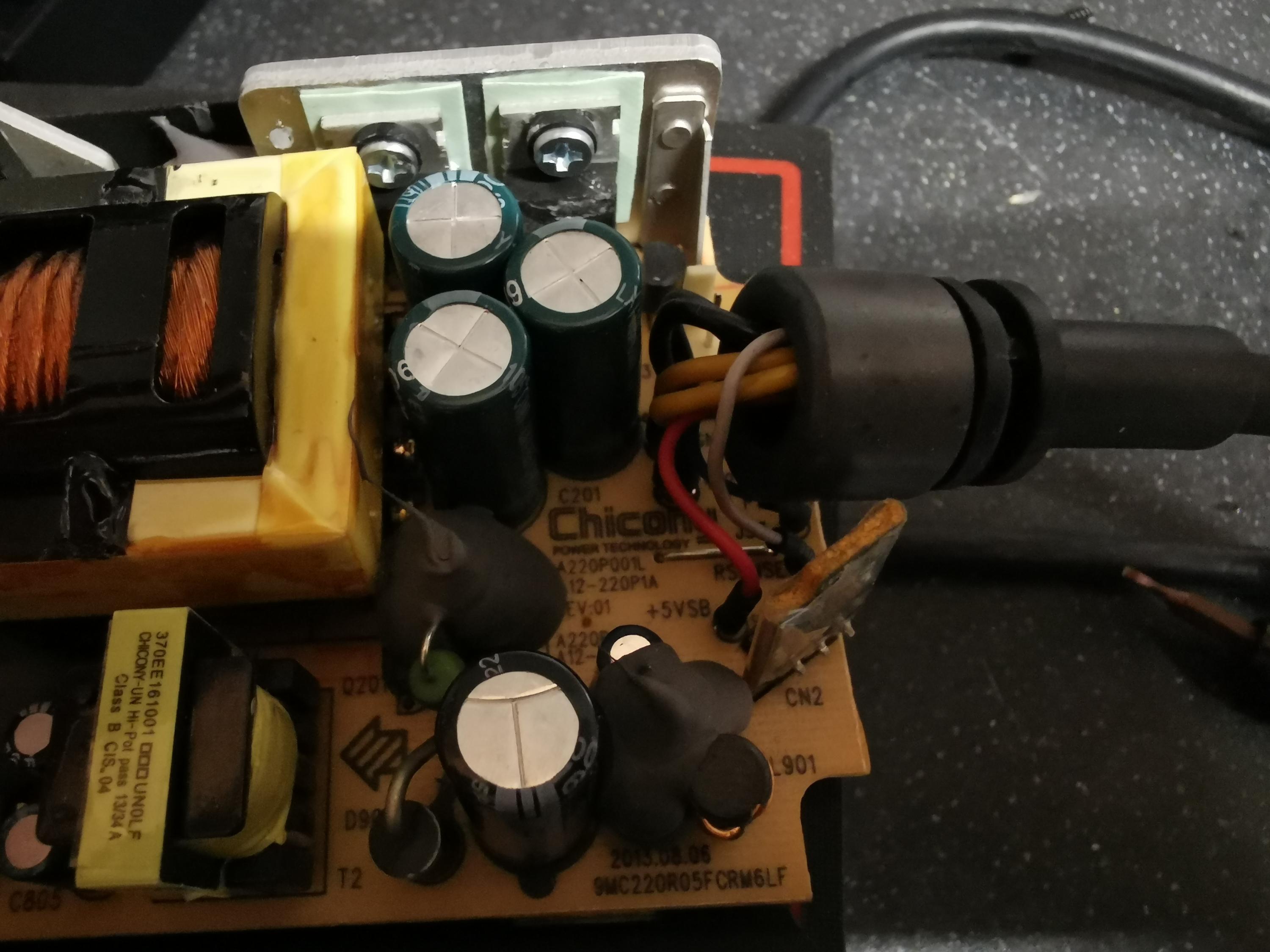

    Pulled the old Samxon and Elite caps in favor of some Kemet Poly's. Used 2200uf in every spot even though the Elite cap was 1500uf. Working well so far.

    Were the Samxon and Elite caps failed? If yes, what capacitance and ESR did they show approximately. At least visually they don't appear to have any signs of failure.
    Also, use of polymer capacitors in power supplies is generally a no-no. However, this is a flyback converter design (as evident by the lack of output toroid filter), which generally are less prone to oscillating / output filter ringing. So the chances of the recap not working from ultra-low ESR caps are much much smaller compared to a standard PSUs. Certainly avoid poly-modding regular ATX PSUs, though... unless the caps to be replaced were already rated for ultra low ESR variety.

      They were not failed (yet) but have seen a lot with failed Samxon caps so I did this a preventative. What makes a Poly a no no on the output side of a smps?

        psu's can sometimes mis-interpret the lower esr as a short circuit on the output.

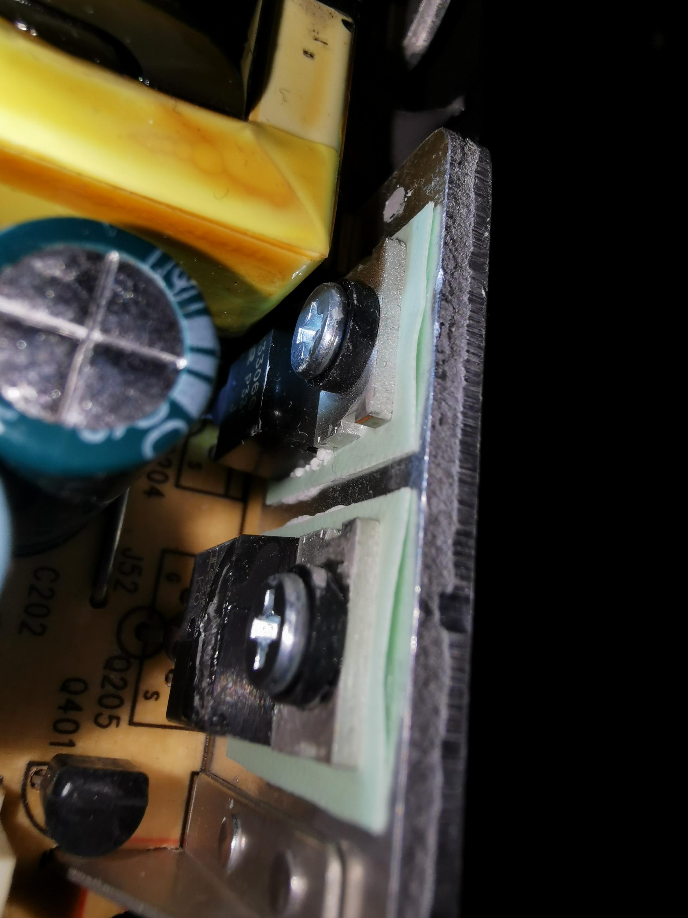

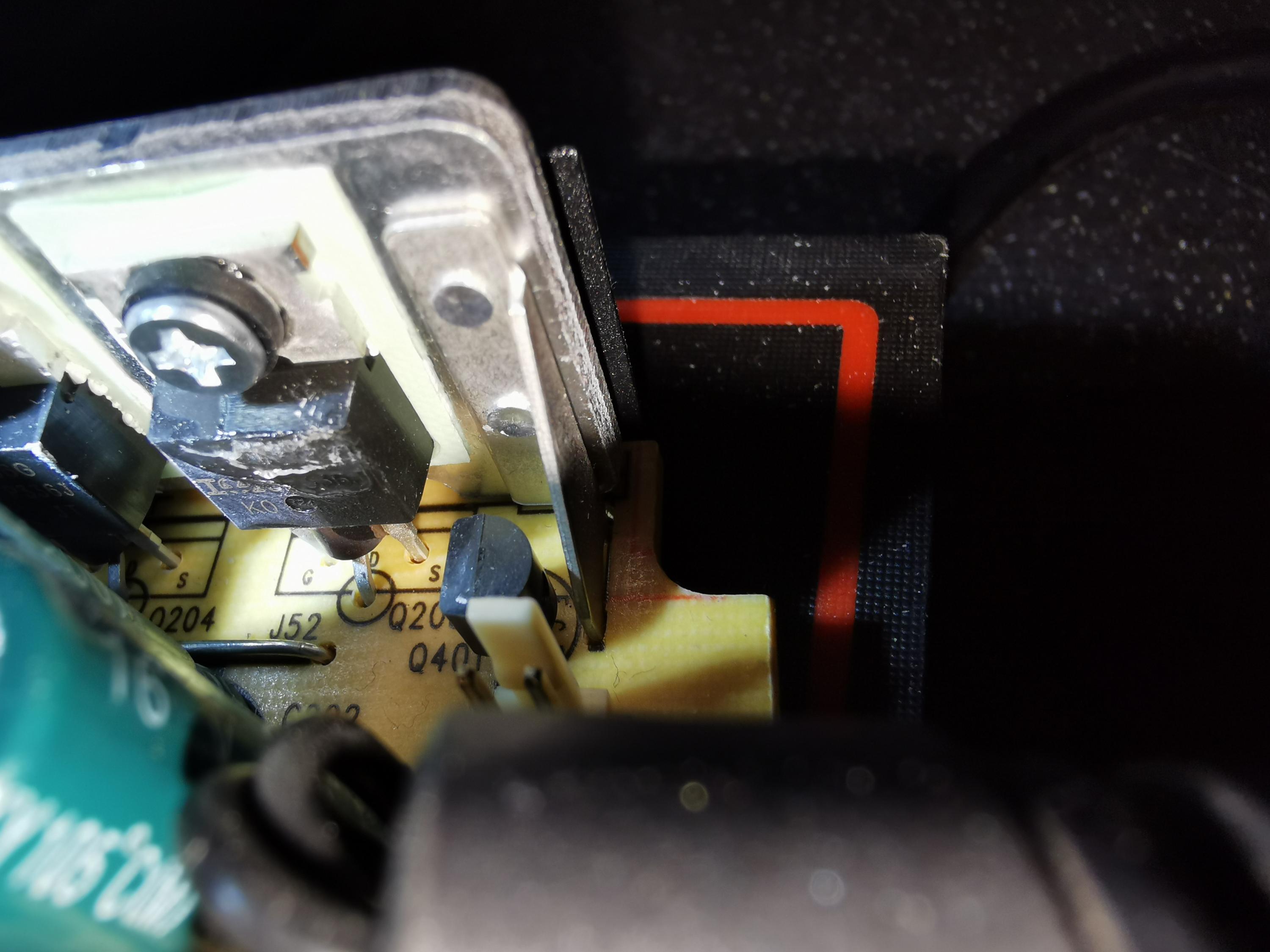

                      hey guys, yes i know old post, i have the xbox one power brick, replaced the ltec cap as was swelled, plugs in wouldnt go past the green xbox screen a few mins later didnt power upat all on a closer look one on the MOSFET looks like its burnt, i will post a pic, but i cannot see the spec on it, its Q205 and cannot find anythink online either, so i came to here
                      thank you in advance
                        • 31298
                        Re: XBOX One Power Brick Repair
                        i think it's threadlock,
                        you should have changed the other caps - specially the small ones
                        • Unspun01
                          • Jun 2011
                          • 349
                          @Leeroy89: I think those 2 mosfets are same, and operate in push-pull configuration. If you can read the one at left side, then I think you can find datasheet and replacement for the one on the right. In my power supply, I could not sourse exact replacement, so I replaced both as matched pair with new MOSFETS of equal or better ratings. If I recall, they are low voltage, high amperage MOSFETs and I may have ended up pulling some off an old P4 PC motherboard.
                          Usually power supply won't do anything if those transistors are shorted, so if your xbox turned on, then the transistors may not be the issue. Or if you are saying it turned on, and now it no longer turns on, then try my advice above to source replacements. Sorry I don't have one in front of me to read the markings on them
