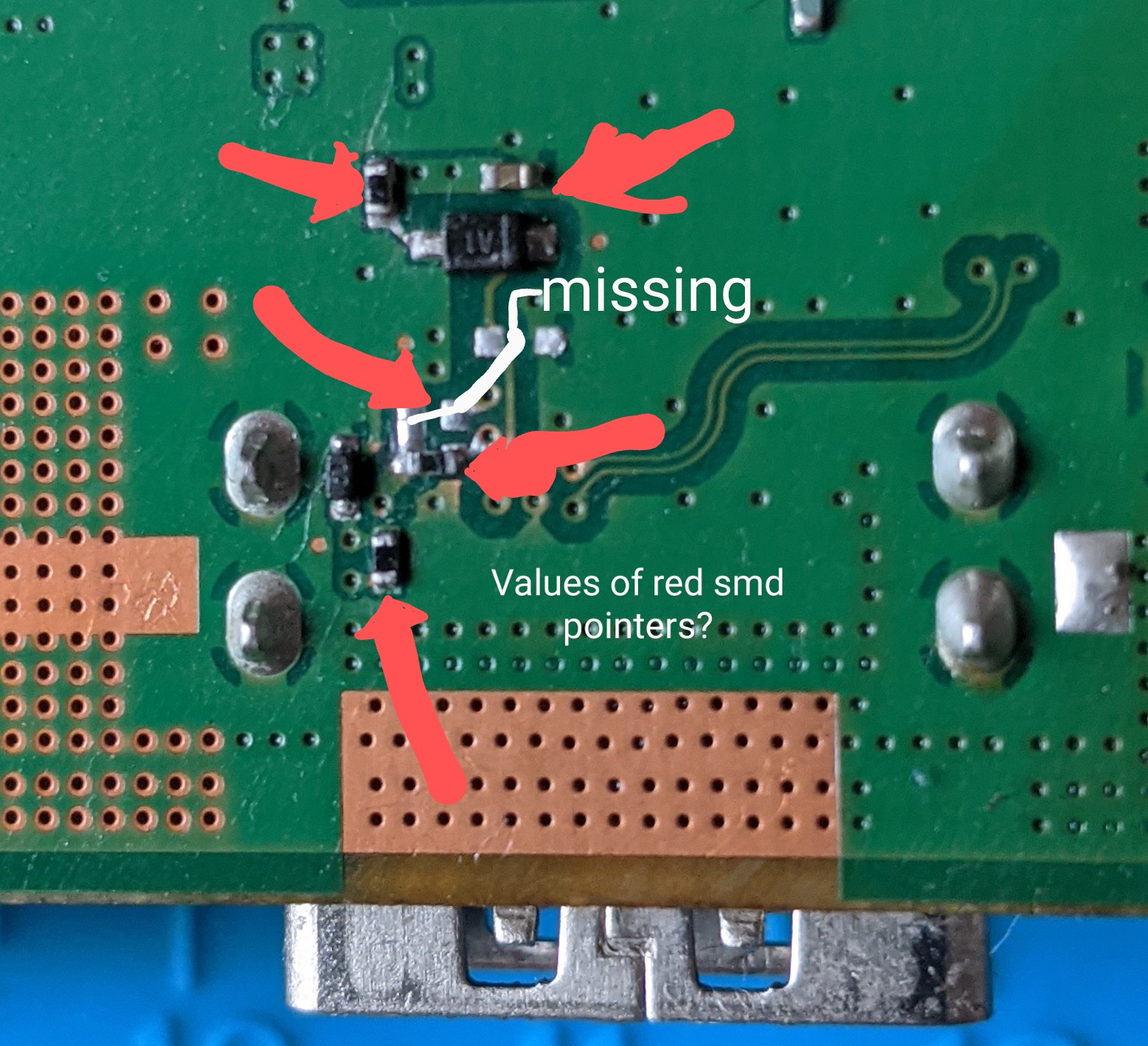

    Hi all, I am trying to find the values of these components from the hdmi on the underside of the board of a PS4 motherboard Sac-001
    If anyone can help by testing a donor board or even telling me what each component value is to buy some new ones.
    The diode's i think are fine as I get OL one side and approx 0.585v to 0.625v on the opposite side. It's mainly the missing components and surrounding area related to the hdmi.
    Reason, getting no signal/picture. Hdmi port is fine.
    Thankyou all

      I can help you out identifying the missing resistor. It is a 0401 2K resistor. It has the same value as the one directly beneath it. They are connected to pins 15 and 16 on the HDMI port (you probably knew that).
      If your diodes are fine, you should be good to go with a new resistor.
      If it does not work with a new resistor, I would look at HDMI decoder. Check for shorts on the 4 filters as a start.. Between the port and the decoder.
      Cheers

        Hi Do you know the correct value for the resistor near edge of board as this is where I seem to be getting 0.013v each side,which I'm sure is wrong.
        Hdmi filters are working no short.
        Thanks for your help bud๏ฟฝ๏ฟฝ

          I will measure it tonight and post..

            The resistor in question measures 22R3, so a 22 Ohms resistor should do.

                Sorry if it was a little unclear.
                "The first post" i referred to was the missing resistor. That is a 2K, aka 2000 Ohms.
                The second one "close to the edge" which I referred to as 22R3 is the same as 22,3 Ohms. This should even make a beep if you test it in continuity mode on your DMM.
                They look the same, both are 0402 (size) resistors, but completely different values.
                The choke with different value, is it the one "not in line" with the 3 others on the main input?

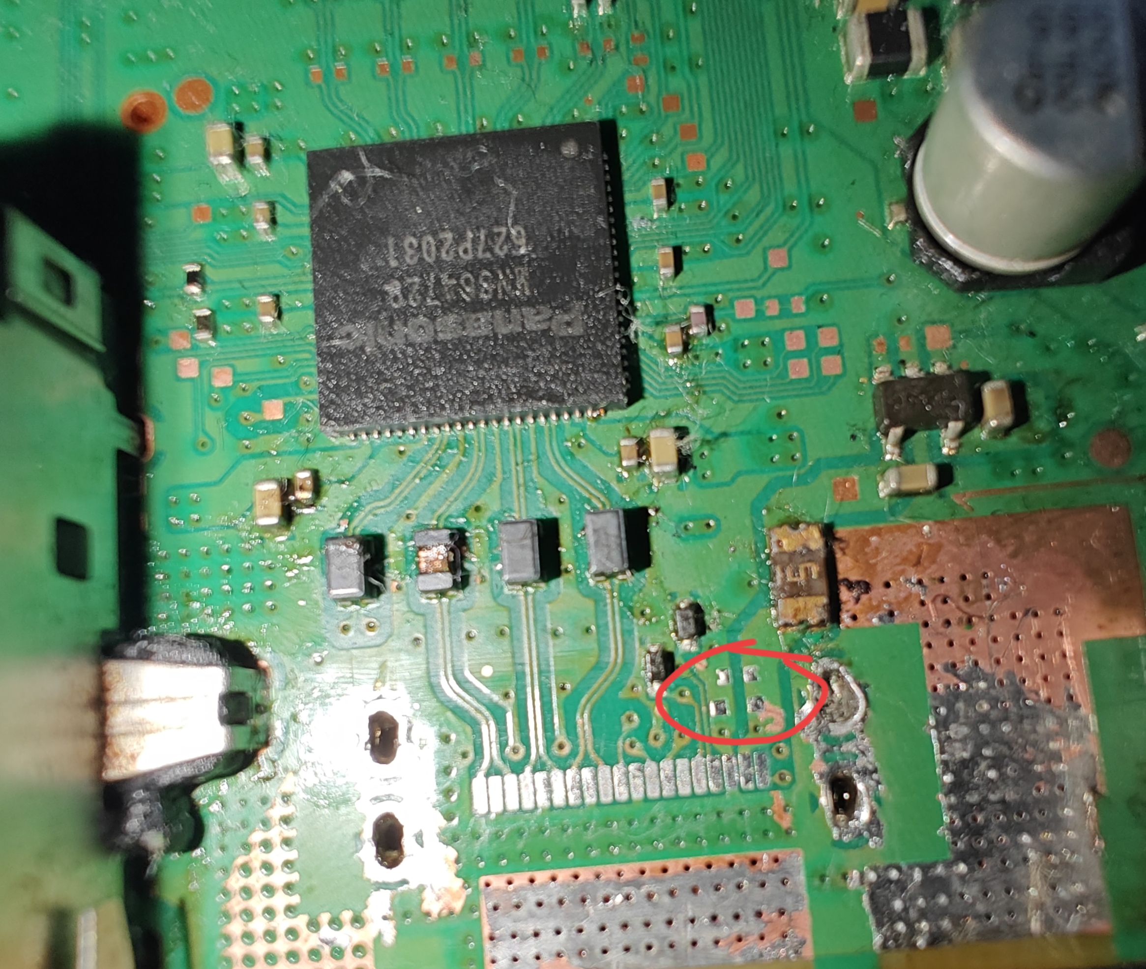

                      I am glad your PS4 starts up and gives you a white light. This means basically that your PS4 is good to go..
                      The fact that it boots up assures that all essential components play along and accept the startup. With this in mind, your APU, RAM and NOR are good and not at fault in this case.
                      I would not crawl down the "rabbit hole" starting to measure voltages on the components around the HDMI encoder. Primarily because, since you do not have picture on the TV, meaning that the necessary powers are not produced in the area, can misguide you away from the real problem.
                      What I would do, first populate the missing component. To my understanding, only one 2K Ohm resistor is missing. Unless there are other component other places on the board missing.
                      On the picture you were posting there is only ONE resistor missing. The upper empty pads, close to the word "missing" should NOT be populated.
                      The missing resistor has to be in place before a picture would be produced in any respect, whether the IC is good or bad.
                      If there is still no picture with the missing resistor in place, the chances that it is in fact the HDMI IC or the HDMI port itself at fault, would in my opinion be 95%.
                      The HDMI decoder is very sensitive for power spikes. Even putting in the HDMI cable into the Tv while the Console is powered, can take it out if you're unlucky.
                      The chances that any of the surrounding component are broken is very slim. These component are much more robust than the HDMI IC itself.
                      I do not have a live SAC-001 board at hand so I could not tell you the voltages. I also do not quite understand why you would measure the resistors in diode mode.?

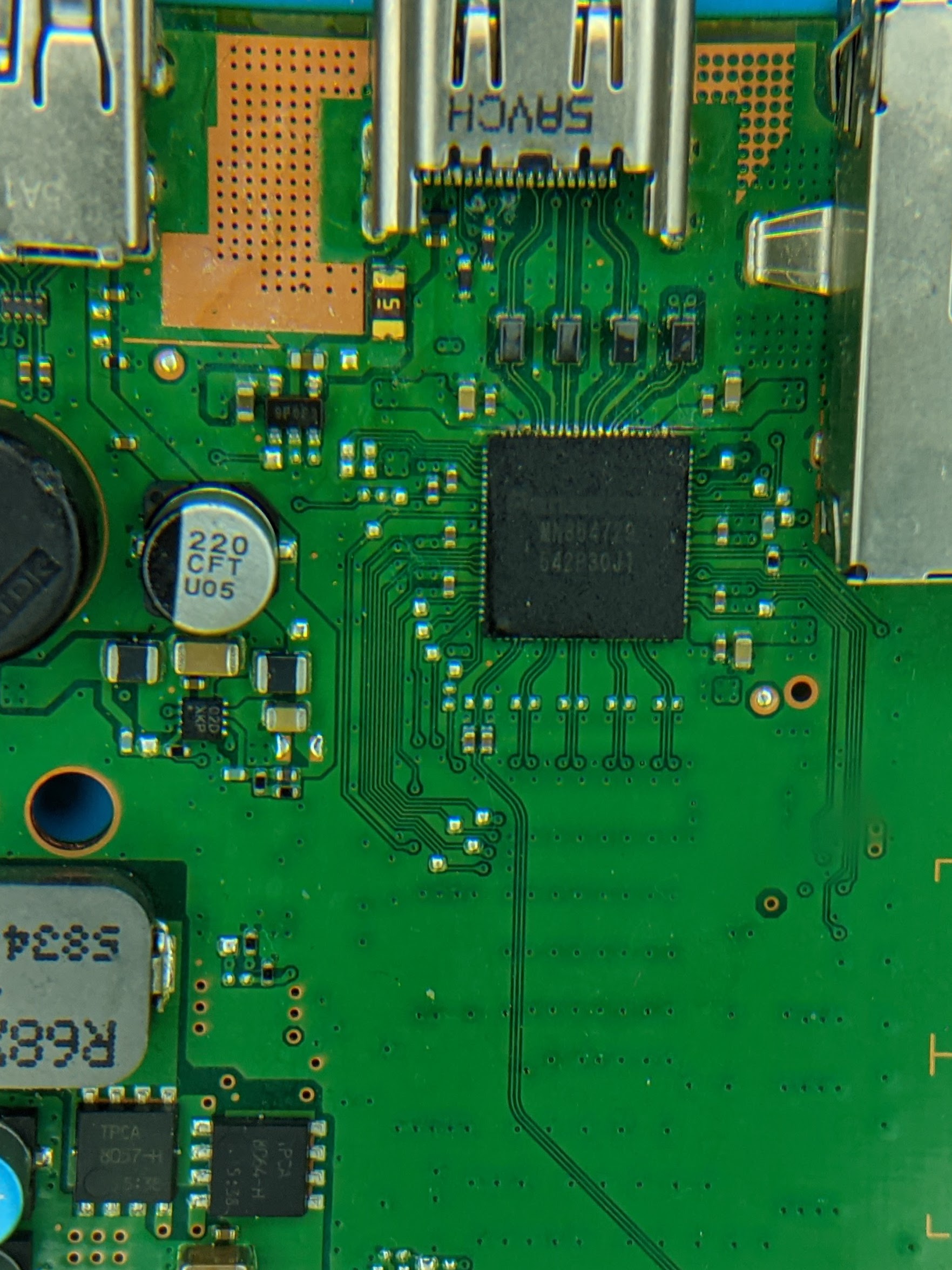

                      Any chance you can post a picture of the HDMI port and the IC area?
                      I am happy to help you out if I can
                      Cheers

                        Hi. It could well of been while the PS4 was switched on and hdmi inserted as it suddenly would not show a picture. Reason for diode/continuity mode is from what I have watched being tested on YouTube.
                        The 2 resistors needing replacing are the 2 together as I knocked them both off at one stage as this is the area from where I started to see unusual readings.I had continuity from all the hdmi pins and started to test values and the underside of the hdmi port. Diodes seem to be giving good readings,it's those few other components that need investigating or replacing to know for sure.

                          Re: PS4 hdmi component values?
                          Picture of hdmi port

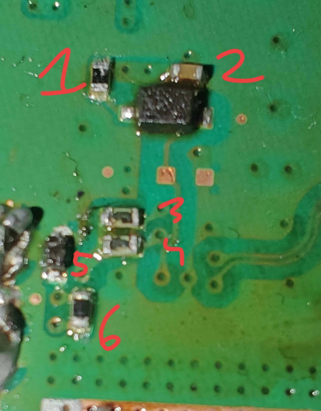

                                      I've measured mine on the back for you but currently I get no signal as I knocked few components off and not even sure if they're in their right places, here's the values I measured
                                      1- 26.95kOhm
                                      2 - is this a capacitor? Not sure how to measure this
                                      3 - 1.986kOhms
                                      4 - 1.986kOhms
                                      5 - if yours is in right place could you check the direction please?
                                      6 - 2.16kOhms - I read up this is meant to be the same as 3&4 but I lost the resistor so this is closest one I could find (could this be the problem)
                                      Also on other side I removed both diode and capacitor as its supposed to work without, I will try few more things today, maybe we can both fix our boards with eachothers help!
