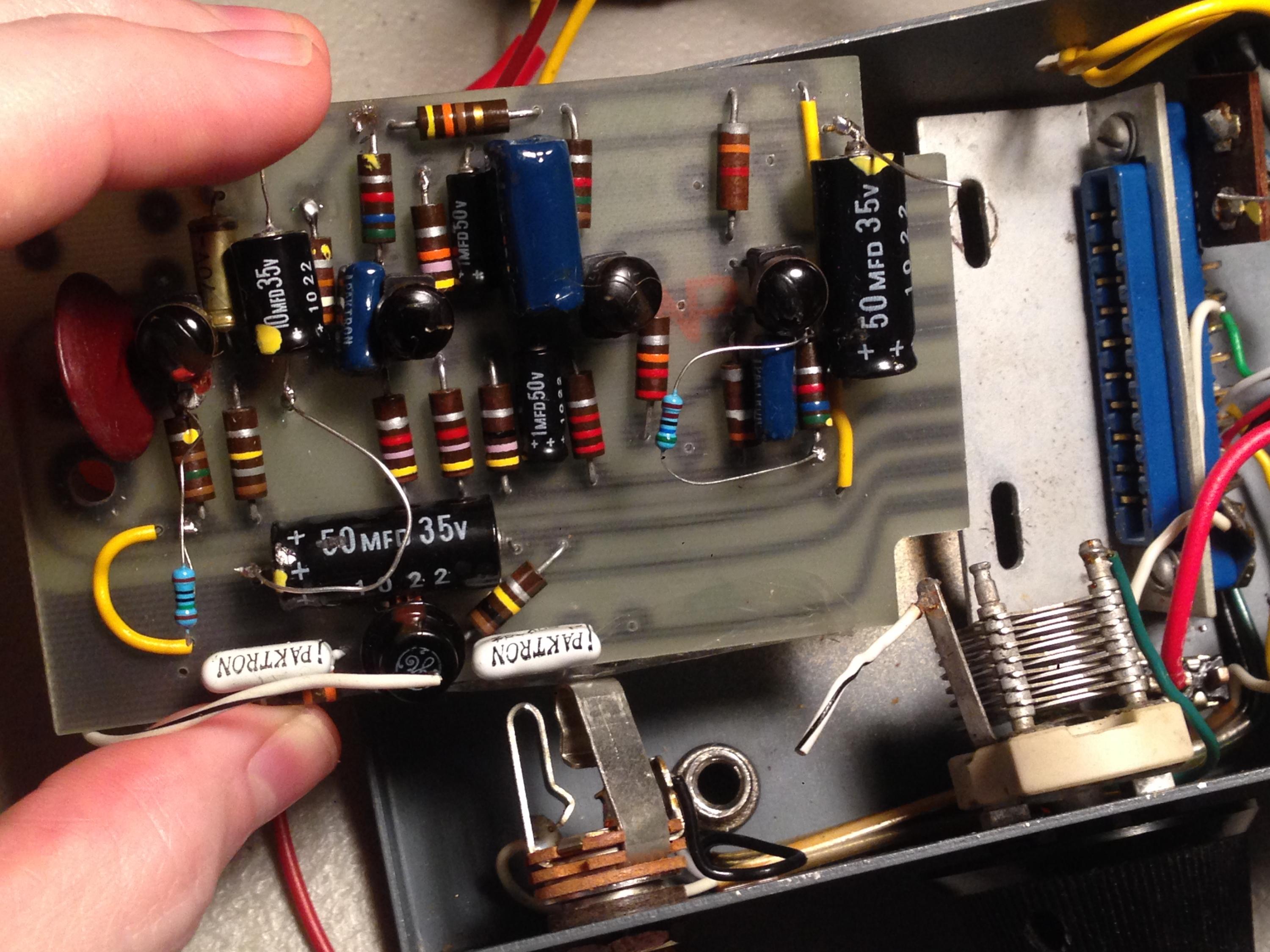

    Looking for service manual for this old thing or a very similar detector it is from 1965 with germanium transistors .. I didn't think there was any real use for it until someone asked

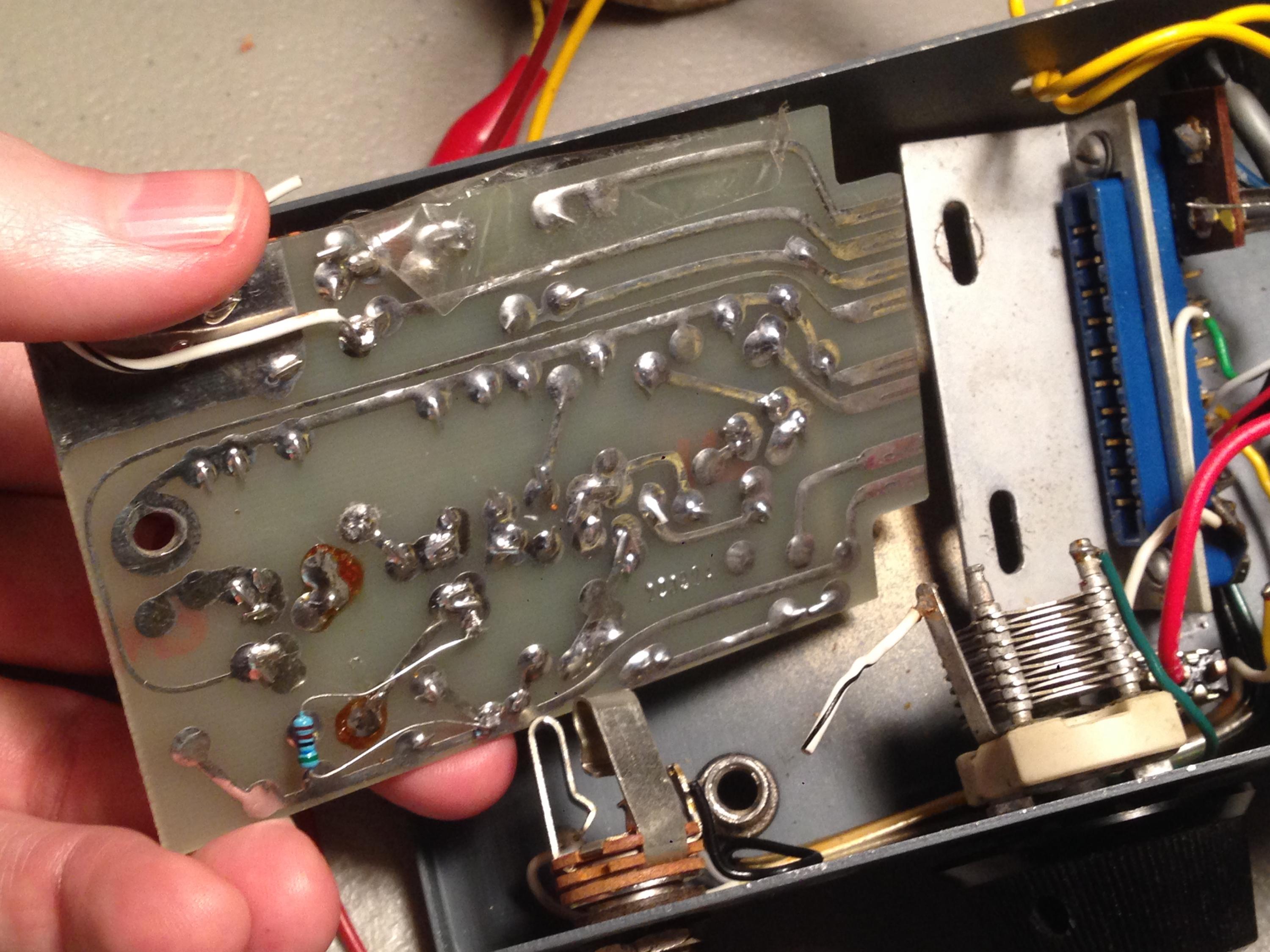

        Looks like someone soldered two "modern" resistors in there at some point. I wonder why that was.
        Unfortunately, I don't have much knowledge in the way of metal detector theory, but if bad comes to worse and you can't find a service manual on any of the popular websites online (Elektrotanya, eserviceinfo, and etc.), then perhaps you can try to draw a diagram of the circuit. The PCB doesn't seem too complicated or with too many components, so should be do-able.

          .. i scoped out those transistors and resistors .. the old carbon resistors drifted .. that is why the knew ones were piggybacked

            These old metal detectors (along with even new ones) are still working the same way, they should be implementing an oscillator which changes frequencies when you pass over metal objects. Yeah I suspect the resistors indeed drifted but shocked they weren't simply replaced instead of parallelized...

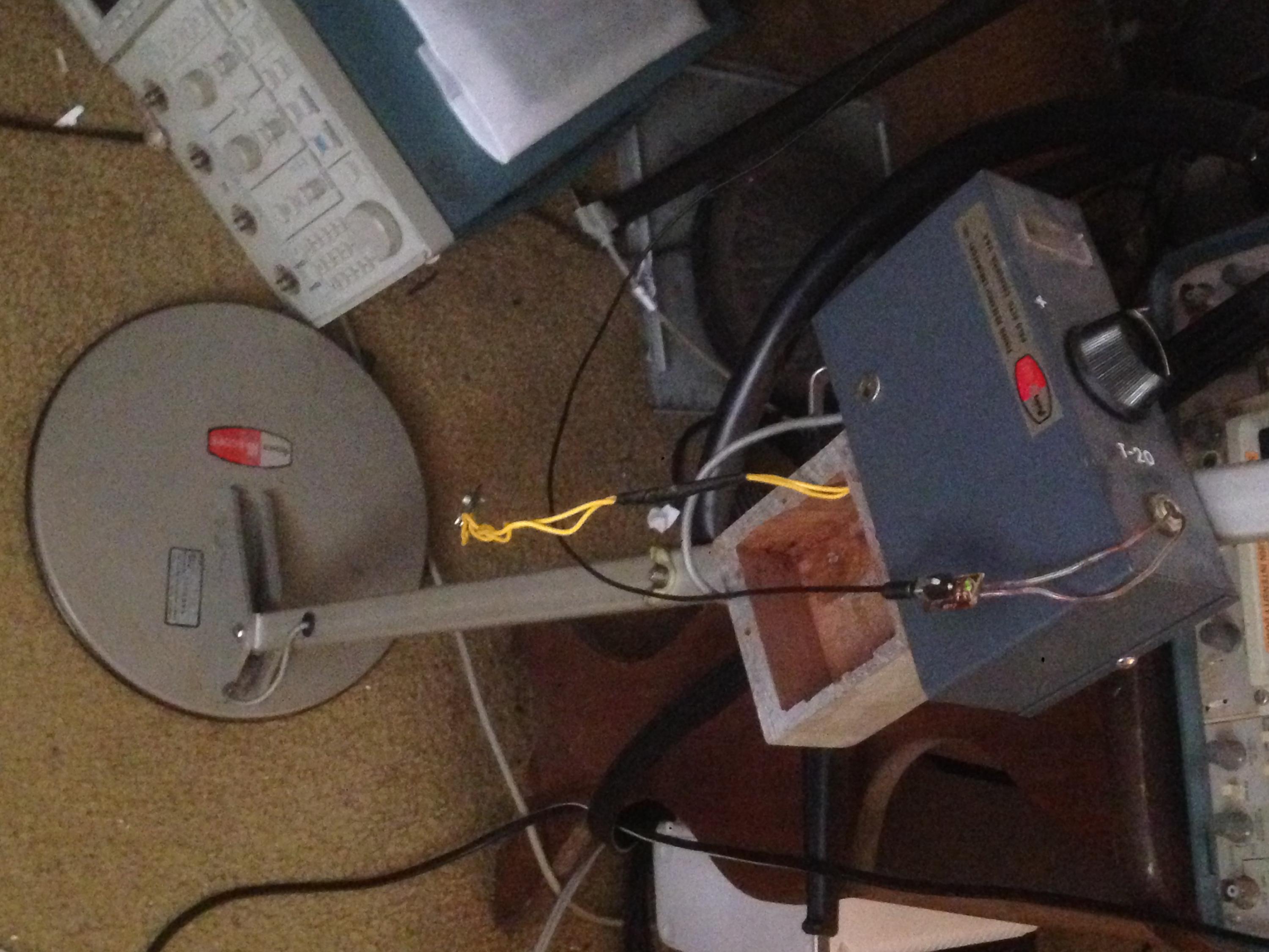

              It is running and oscillating and I can hear a very quiet low hum putting on some regular headphones .. it was probably meant for some piezo headphones with high impedance since the output is so quiet
              .. I will try to check each oscillator and look at the signal closer with a scope tomorrow and maybe trace out the circuit a little now that I have a rough detector circuit to draw from and look for some parallels
              .. I reconnected the cut wire to the variable plate capacitor to the control knob but it does not change much to the sound
