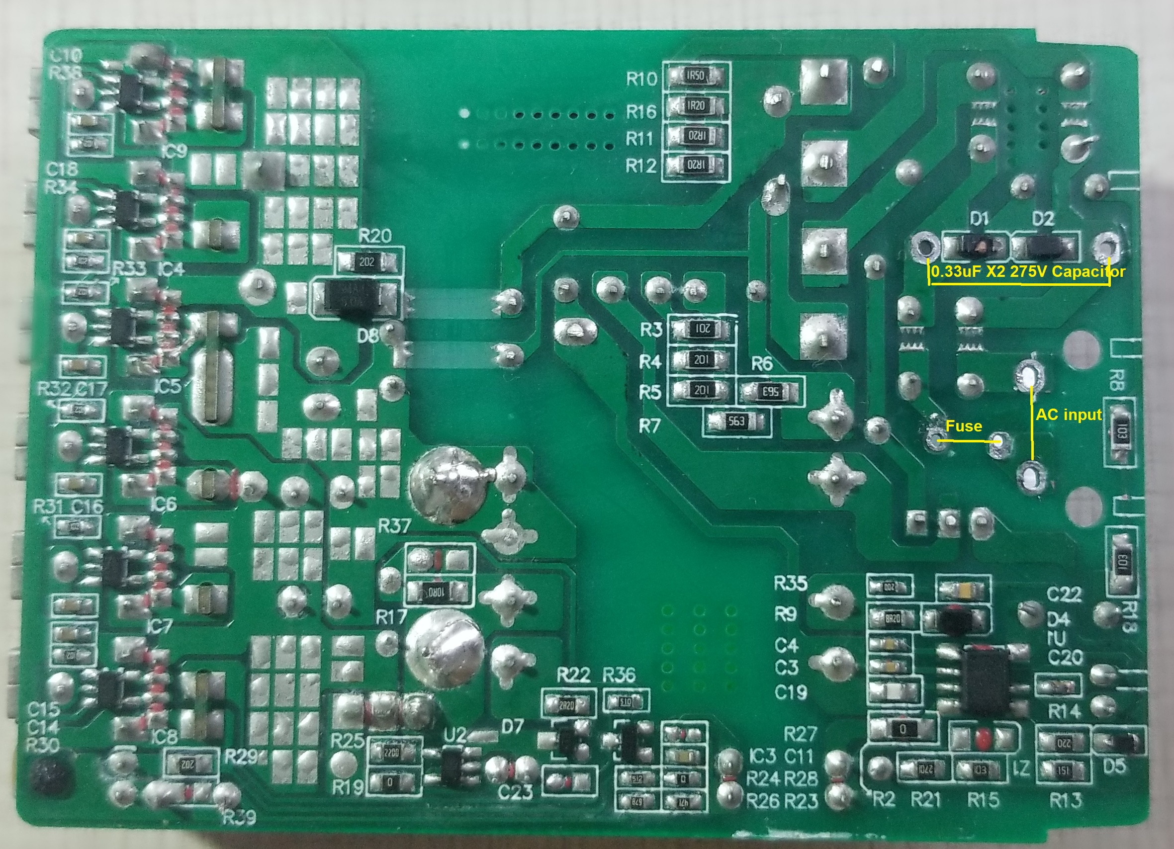

    Hi Folks
    My Anker 6 port USB charger stopped working. There was no signs of life. so i opened up (they make it real difficult to open) .Anyways on opening and looking around for long the following are the conclusions
    1. The AC plug socket on the motherboard was knocked of the board.. But this could be a result of my using brute force to open the adapter. But the fact that the socket came clean off the board would indicate a possible cold solder joint.
    2. The fuse next to the AC adapter was blown.
    3. Knowing the fuse was only a symptom and not the cause. I looked further and found a damaged diode(Diode D1). The diode was in line with the 0,33uf X2 capacitor.
    No my problem is i cant identify the damaged diode. There is another diode next to it and is marked as A7. I am assuming that the damaged diode is also an A7. Problem is i cant seem to find this A7 diode in any store here. So i need the following help
    1. Does anyone know alternatives for the A7 Diode. I cant find it in any of the stores here. The data sheet for the A7 Diode is here.
    2. Do you see any other issue with the board
    There is a possibility that the diode D1 was also damaged when i tried to open the charger. I guess this because the diode is showing physical damage and not burn damage. So i am going to replace the fuse and the diode and then see what happens.
    So please advise if anyone knows the alternative for the A7 diode. Also if you can see any obvious issues with the board

    What part does the mid-point of D1, D2 connect to? The trace goes to R8+R18 to do something weird, zero-cross detect for the SMPS IC?
    If it's a MOV, then I think D1, D2 are bidirectional TVS for surge protection. Something like SMBJ170CA?

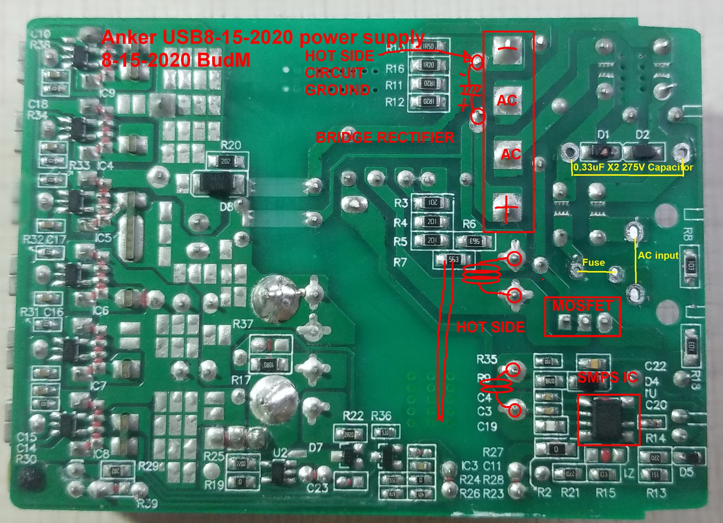

        Re: Anker USB charger Part no
        Since R8 and R18 connected in series, at 20K you will not have enough current flowing through the diode to cause that kind of damage.
        I also do not see any sign carbon or burnt around the diode, more likely you have short circuit somewhere else that caused main fuse to blow.
        You should test the bridge rectifier, MOSFET. Get the P/N of the SMPS IC so you can look up the spec sheet, see attached picture.

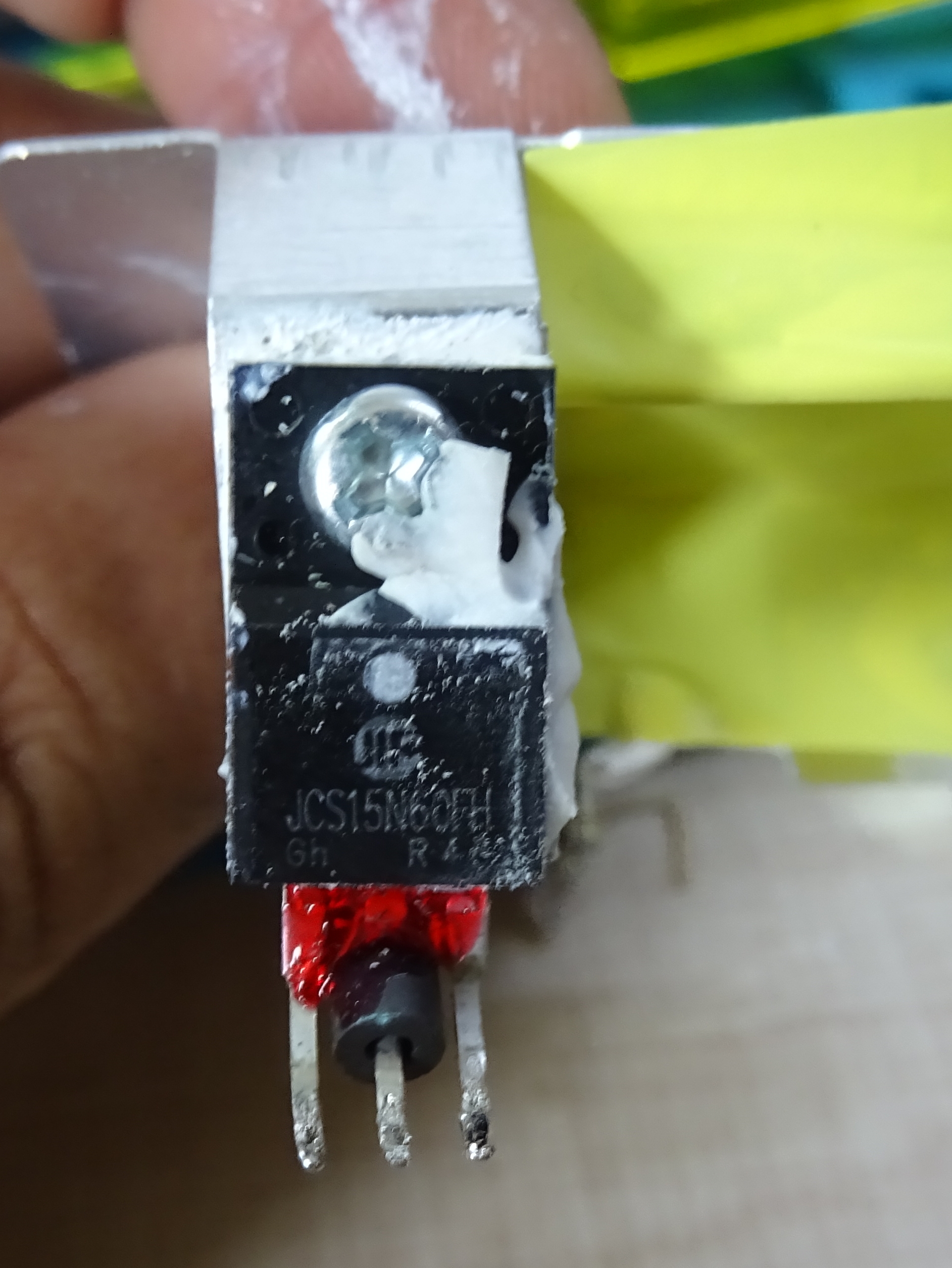

          Ok so i disassembled the board a little more. The MOSFET is a JCS15N60FH. I removed it from the board and can see some goey stuff coming out of it, ,not sure if it indicates damage or its normal. The SMPS IC is a HFC0500.
          How do i test the MOSFET?
          Also if i have to replace the MOSFET can i replace it with this one FCP190N65S3R0 - Refer Datasheet
            https://www.badcaps.net/forum/attach...9&d=1597559804
            That is heatsink compound, you can test in on board to see if the Source and Drain pins are shorted together, if it tested bad on the board then you remove it ans re-test it again.
            If you look at the picture, the Left pin is GATE, Middle pin is Drain, Right pin is Source; so just check the resistance between Source and Drain pin to see if it shows really low Ohms reading, just measure it and report back.

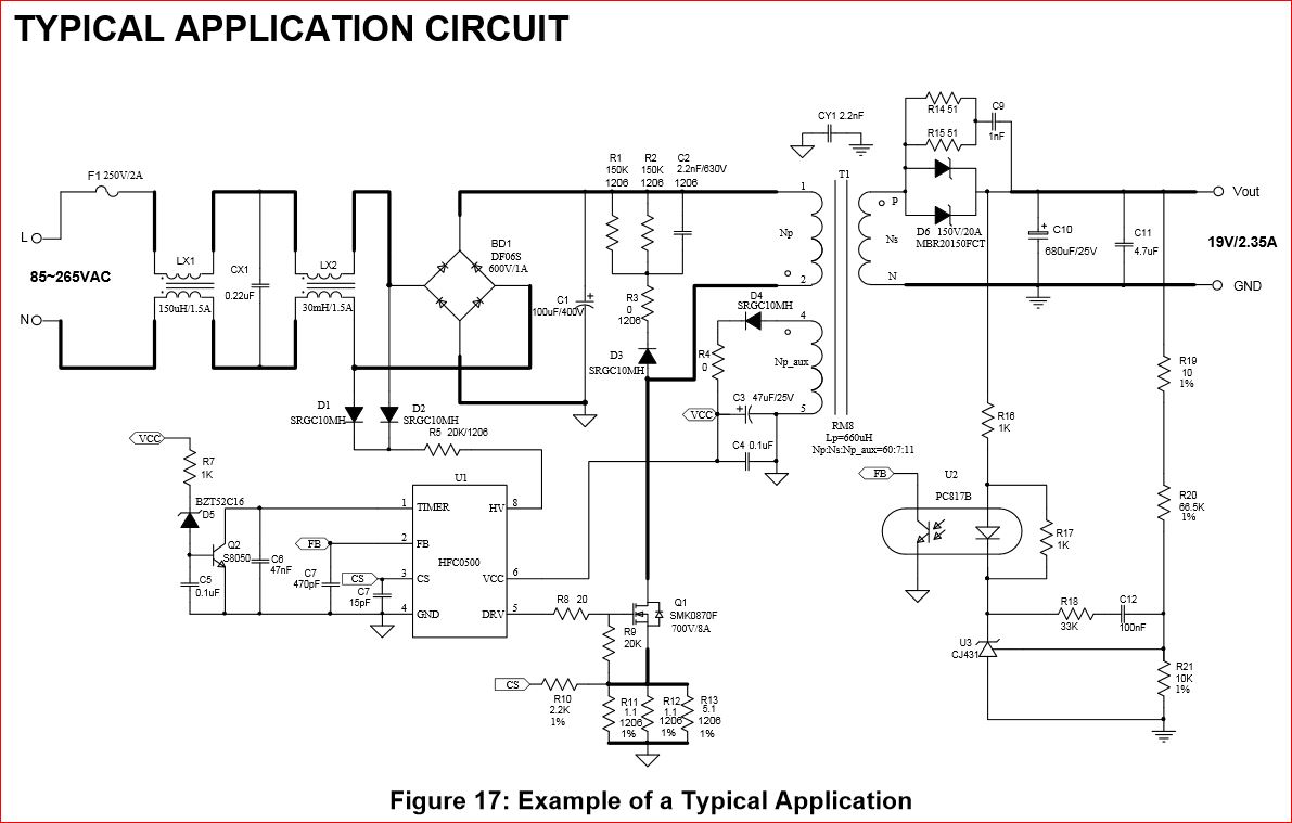

              From the datasheet, D1 D2 would be two 1A 1000V rectifier diodes supplying the start-up circuit. A7 is 1N4007W, or M7 as SMD4007. S1M or RS1M would also work in SMA package.
              It's strange- the diodes have no way to blow up really with the 20k resistor in series, unless both shorted due to mains overvoltage spike?

                Thanks. resistance between Source and drain is open. No resistance value measurable.

                        Sorry about so many posts. But found a way to test the MOSFET-JCS15N60FH (something from youtube). So i Tested as follows:
                        Test 1 - Pass
                        1. Kept the negative of multimeter on Drain and positive on source. The multimeter shows a connection. Voltage reading of about -0.5V
                        Test 2 - Pass
                        1. Kept the negative of multimeter on Source and positive on Drain. The multimeter shows a Open connection.
                        Test 3 - Fail
                        1. Kept the negative of multimeter on Source and positive on Gate. This is supposed to trigger the MOSFET. Then moved the positve of multimeter to the Drain. The multimeter still shows a Open connection or MOSFET still off. This is supposed to show an ON Mosfet
                        So basis the above test is the MOSFET spoilt ?
                          The questing is why the main AC fuse blown, the MOSFET is not shorted, the rectifier is not shorted as tested, but as you said, it can be due to power surge.
                          The MOSFET may not turn on using that test method if the meter puts out <3V and also if the Gate did not stay charged long enough to keep the MOSFET on when you move the probe over to S and D

                            You are correct. I applied an external voltage of 5 volts to the gate and voila MOSFET turned on. So atleast for now it looks like a simple fuse replacement. which was made double difficult because of the damage caused by brute force opening of case. I dont understand... why dont they just use screws to close the case instead of putting a sealent that requires such force to open.
                            Now wait for the parts to come. Will keep post updated.
