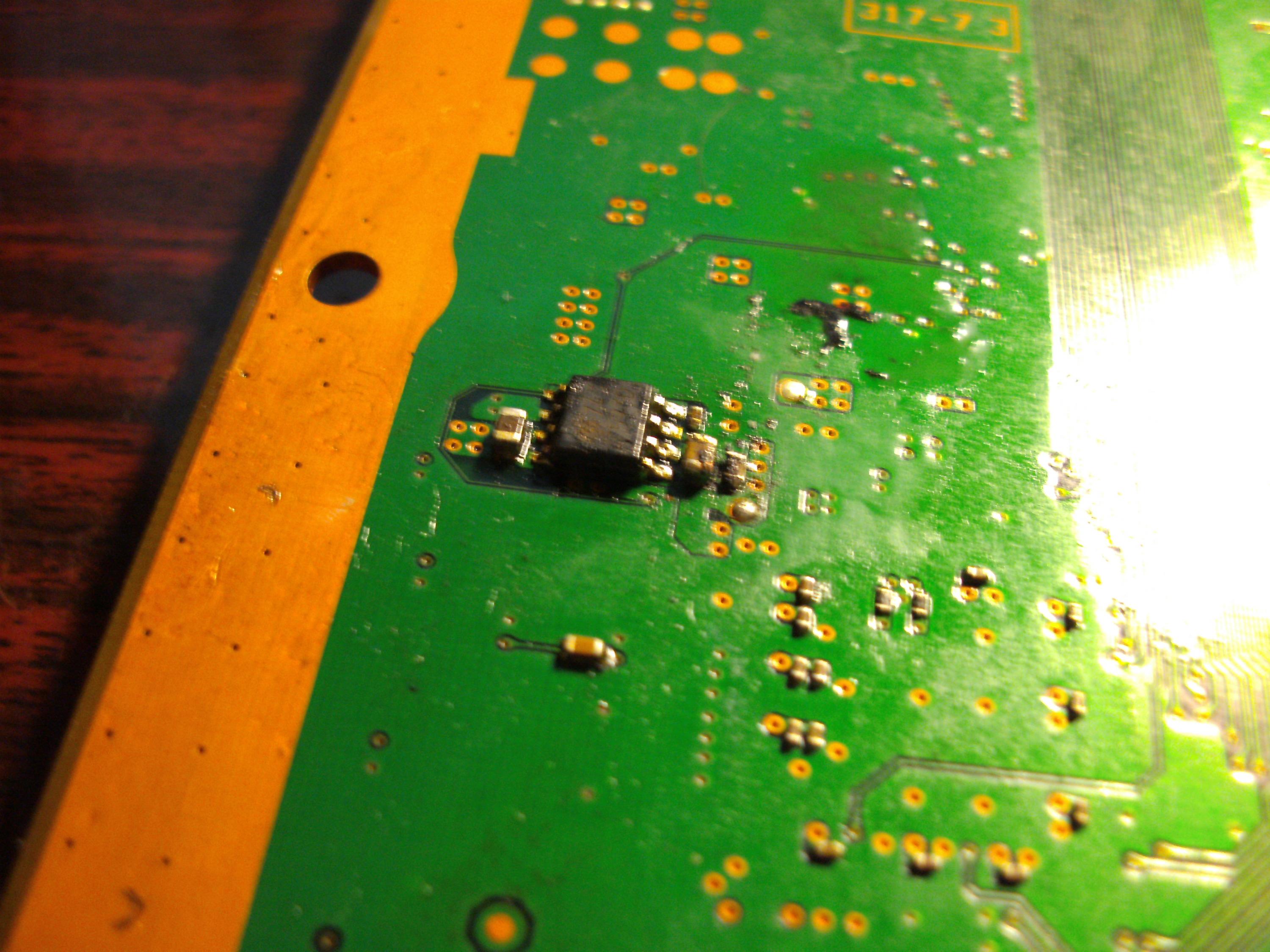

                    • sigmeyer
                      • Feb 2020
                      • 155
                      • Serbia
                      Re: PS3 , Part replacement Issue , found the problem
                      UPDATE: OK so.... I have taken out the chip .. and that chip wasnt the one causing the problem... However... i have found the problem .. it was the chip on the other side of the board.Sure enough it had a nice big hole in it(i will upload some pictures when i get the time)..Its the IC 2502 on the schematic. On it it says sillicon village scei and some random codes on the lower part of it... On the schematic it says its confidential..
                      However i now have the 3.3volts and the short is gone... But now the PS3 stays on for a shorter time .. i dont get the really hot CPU anymore and the fan doesnt spin that fast.. and after that it goes to red light and beeps 3 times like usual... I was wondering can the ps3 work without this chip? here i found the picture of it online
                      Think i am on to something here .. but maybe im just wasting my time... btw im just fixing stuff for fun.. im not really looking to make any profit doing this.

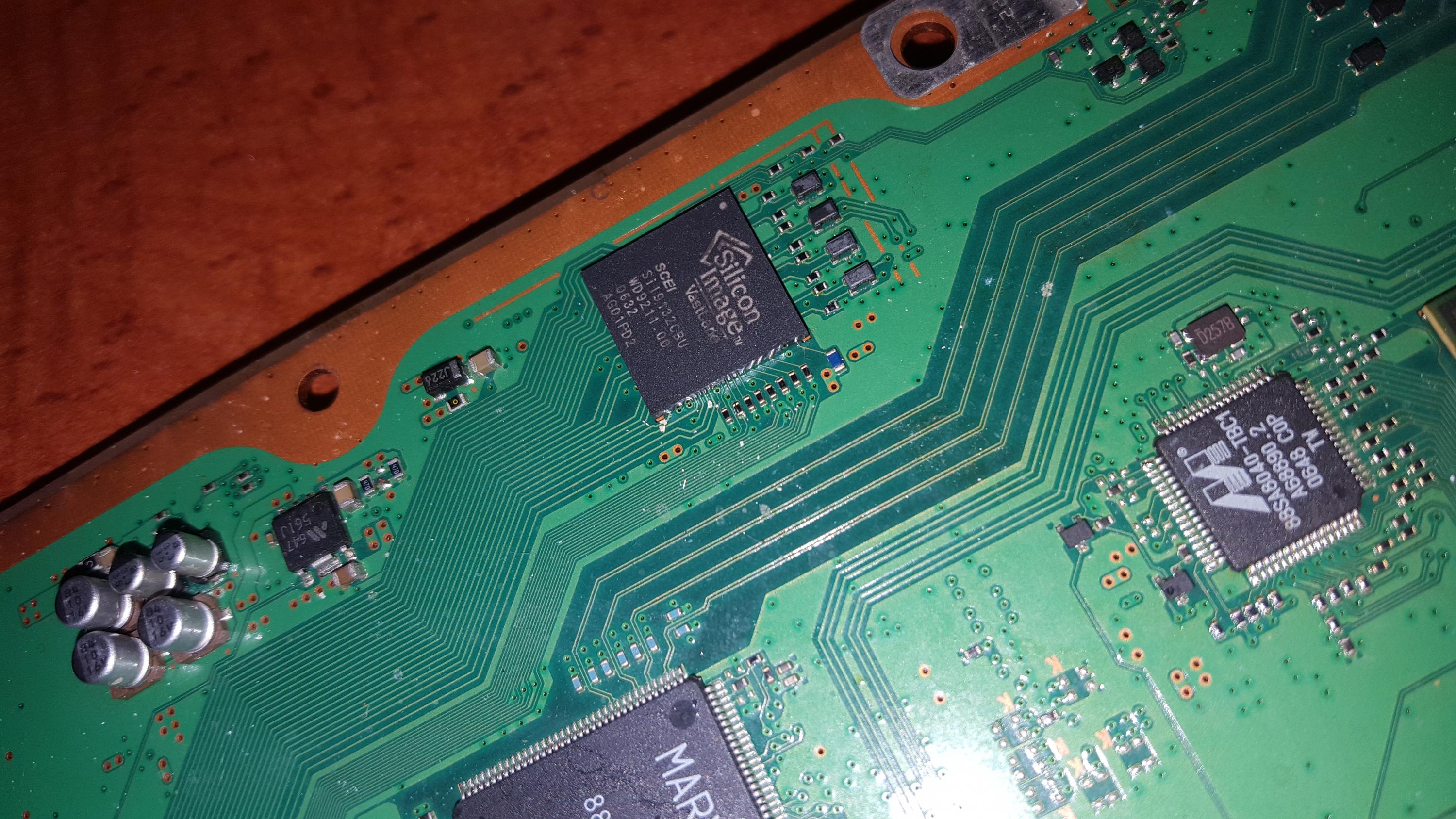

                          • sigmeyer
                            • Feb 2020
                            • 155
                            • Serbia
                            you might be correct... alot of the pins come straight from the RSX graphics chip. i think i need this chip for the ps3 to work...

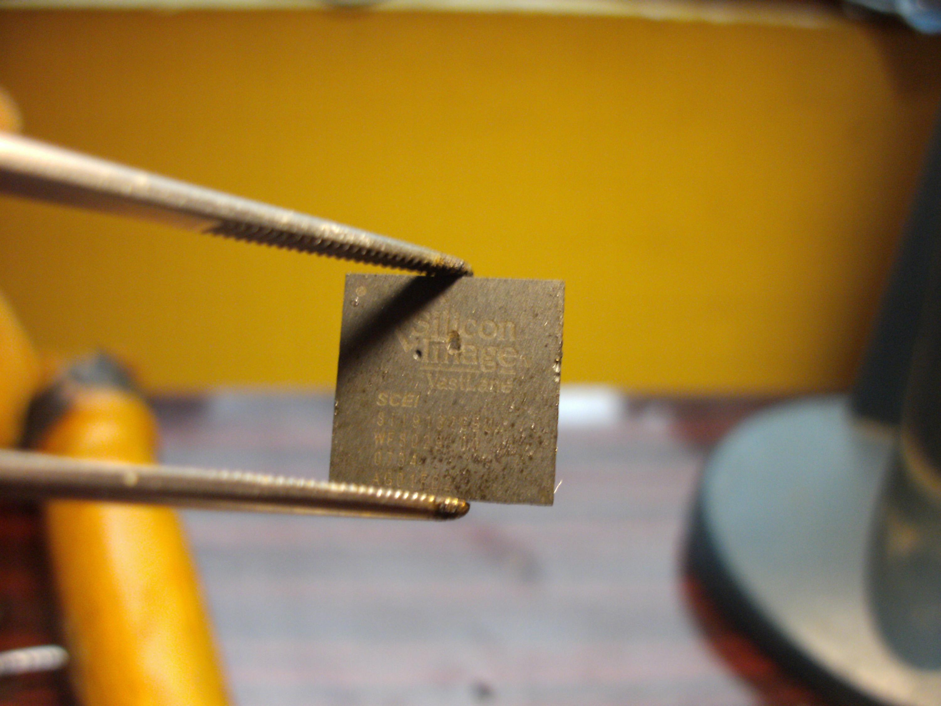

                              • sigmeyer
                                • Feb 2020
                                • 155
                                • Serbia
                                Here are the photos … 2 nice holes on the chip … and i soldered back the 3.3v regulator … nice and dirty

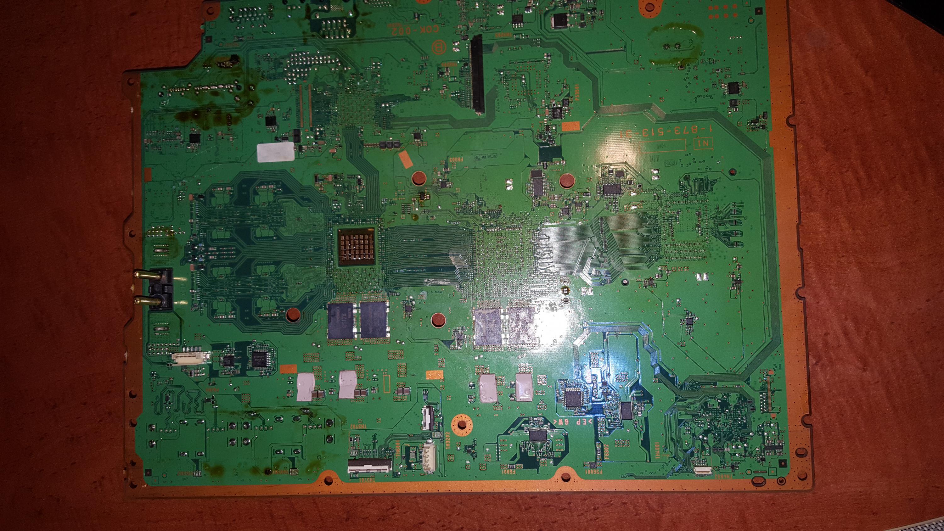

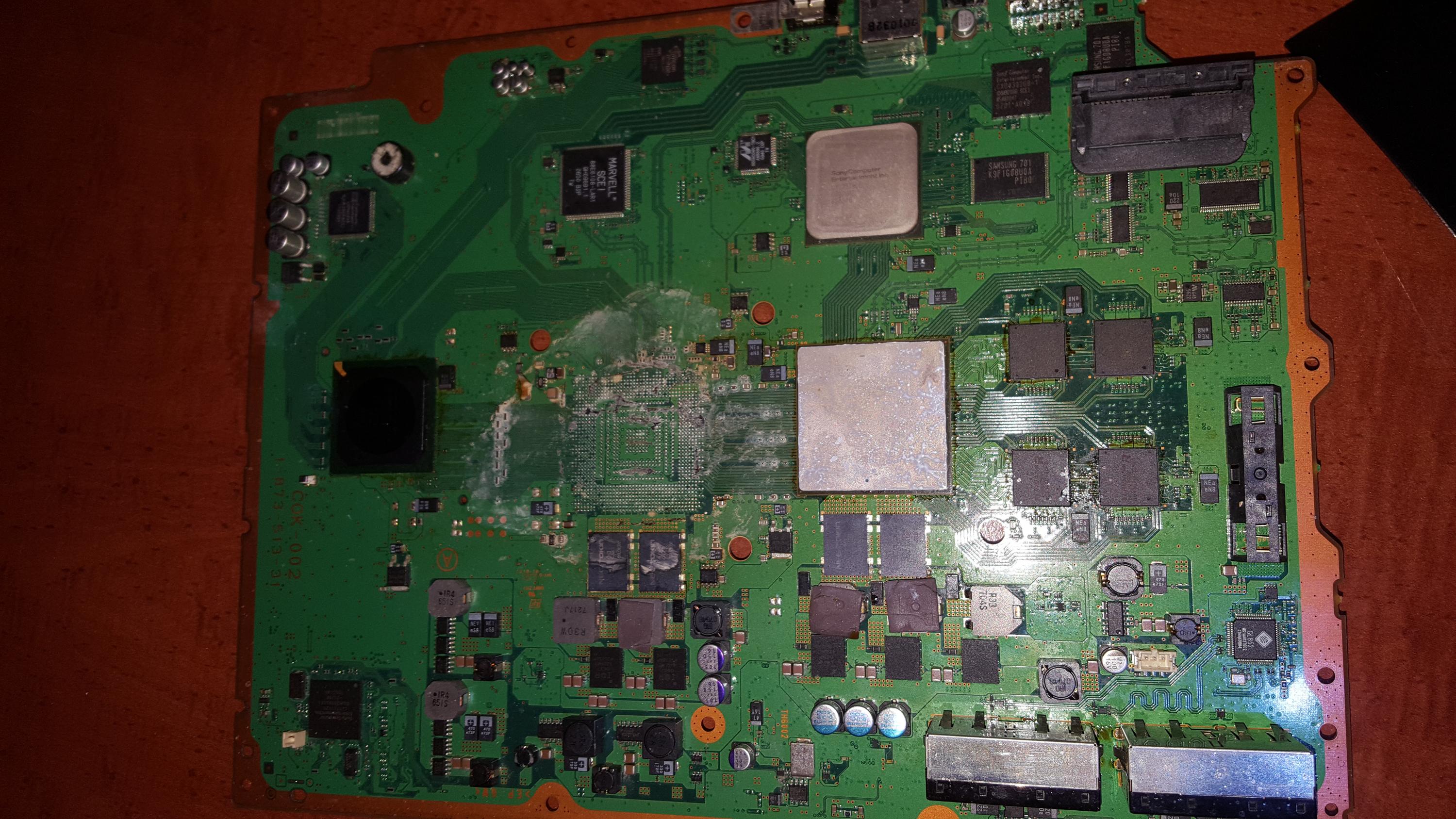

                                • madan1
                                  • Nov 2016
                                  • 698
                                  • Bulgaria
                                  Here is the scrap board.
