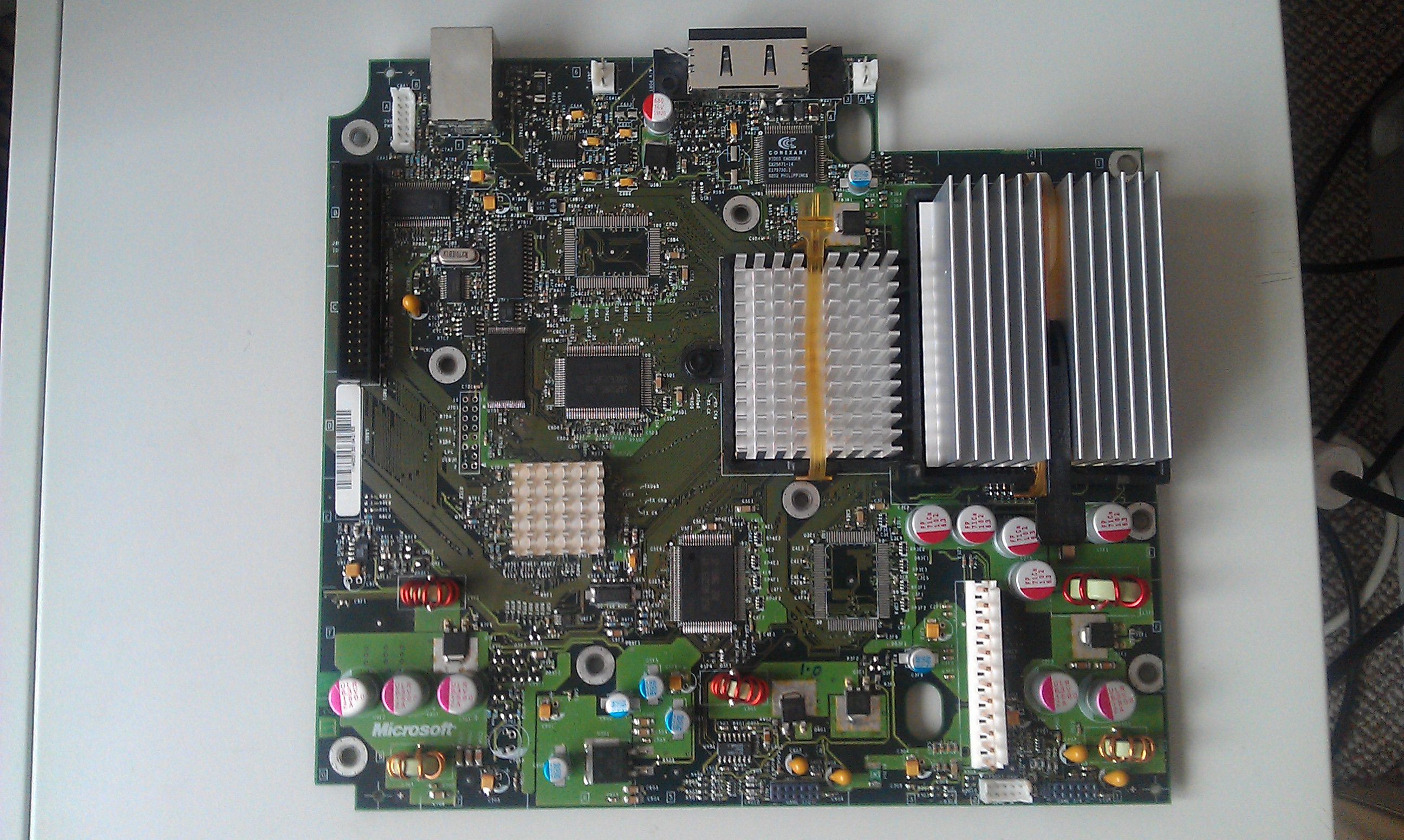

    xbox ultimate solid-mod
    previously, others have put polymers in xboxes,
    but usually not replaced the smd electrolytics or the vrm smoothing.
    the main failing caps!!
    and often they used oversize caps that dont fit well.
    so here is one done right, i call it the XXX-BOX because it's hardcore!

    Re: xbox ultimate solid-mod
    Looking good, are they the poly caps you got from Ali?
      • 30977
      everything other than vrm was ali,
      vrm came from RS.
      but only because i got those first - future boxes will be 100% ali sourced.
      btw, while doing this i discovered something usefull.
      any FOXLINK psu's - check the 1200uf caps!!!!
            Great work but why did you use tantal caps instead of polys in some places?
            Also do you've plans to do the same for the psu as well?
              • 30977
              the board has pads on it for tantalum caps, but m$ cheaped out during production and only used tants on the underside.
              i wont poly the psu - that usually wont work.
                        Noooooice, did you change 10v 3300μF caps to 6.3v 1500μF
                          • 30977
                          yes,
                          but notice i fitted more of them.
                          where m$ used 3300uf they left spaces because they had originally fitted 1500 or 1800uf caps.
                          so the total capacitance is actually similar - but the esr is much lower!
                          • RoroX
                            Awesome, can tell me the paramets of your tantalum caps?
                              • 30977
                              https://www.aliexpress.com/item/32370177546.html
                              https://www.aliexpress.com/item/32372832101.html
                              https://www.aliexpress.com/item/32983008282.html
                              https://www.aliexpress.com/item/32951610902.html
                              • RoroX
                                • Feb 2020
                                • 7
                                • United Kingdom
                                Sorry for bothering you, but what are the ESRs of your 25v 22uF / 100uF caps?
                                  • 30977
                                  i have no idea.
                                  lets just say that they have to be better than the original general purpose crap i removed.
                                  it's not critical there anyway - only for the 1500uf caps because they are smoothing power circuits.
