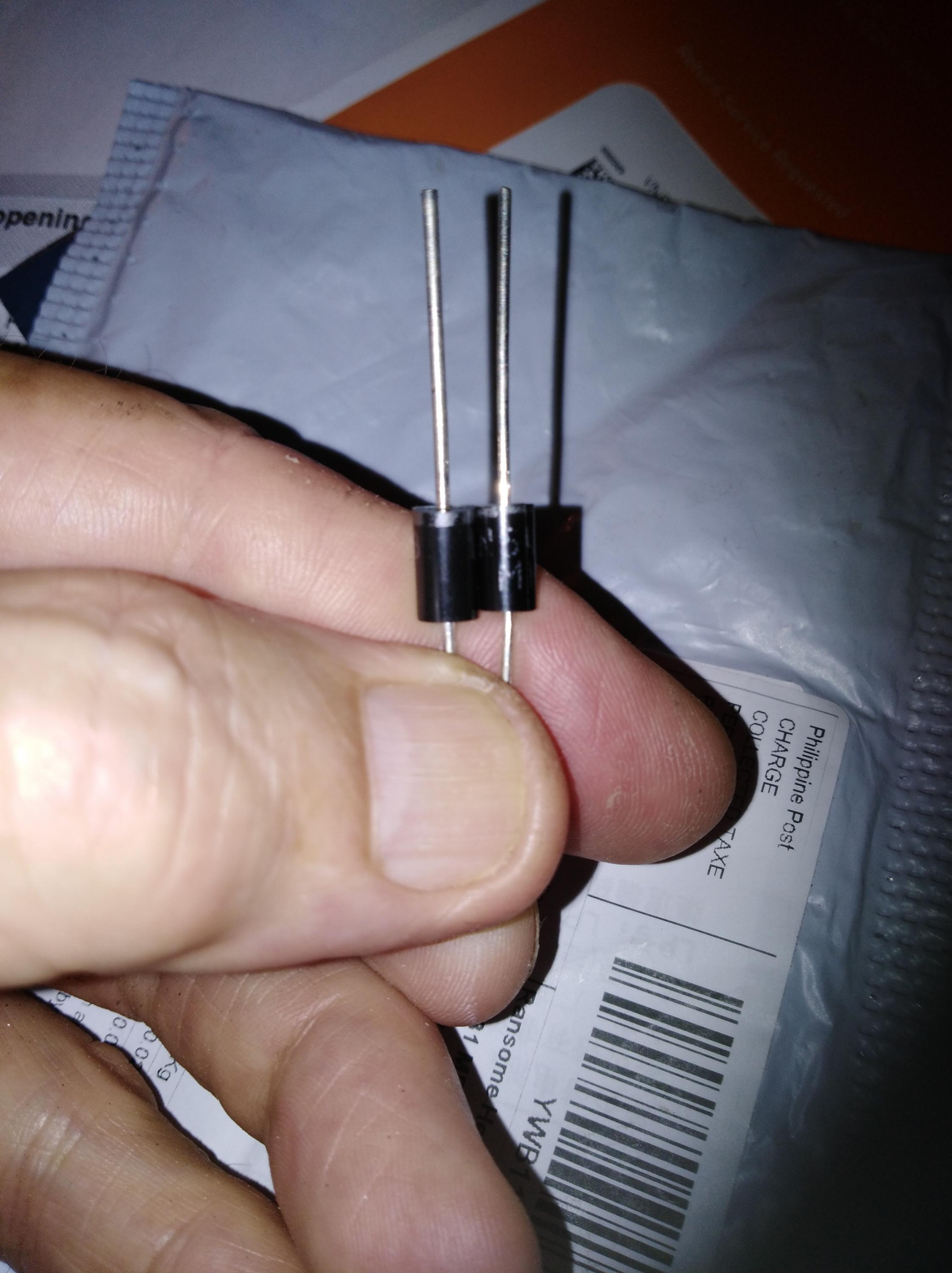

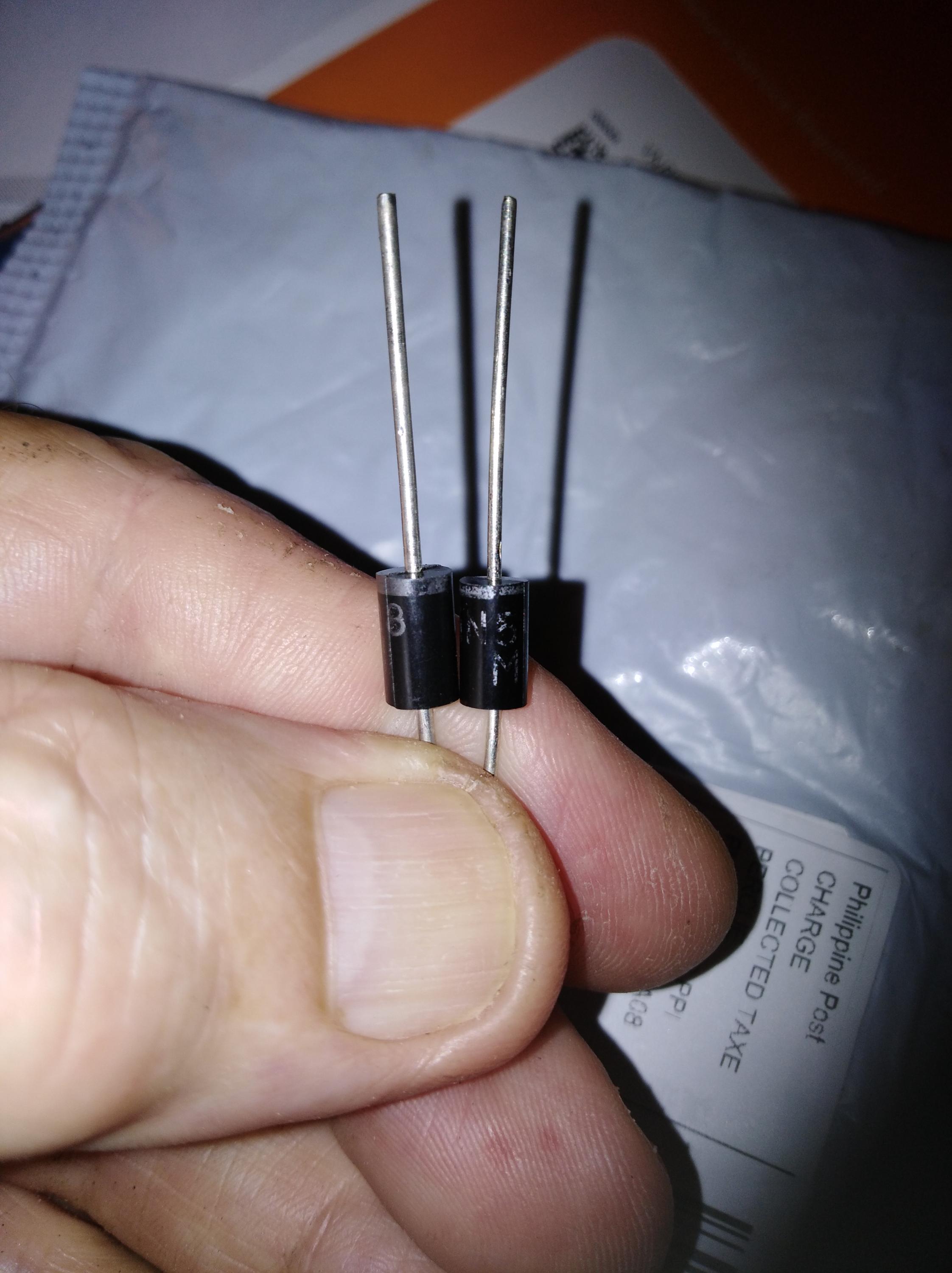

    UPDATE: Originally, I ordered 1N5408 from aliexpress and since that was taking too long, I paid twice the price for half the quantity from a USA seller on eBay, for delivery in a week. In the pics herein, you can see the eBay sellers product is on the RIGHT and the Chinese seller on Aliexpress is on the left. If SIZE MATTERS, then the Chinese Aliexpress product is superior. Also note, not only is the chinese diode itself large in diameter and length, the diameter of the cathode and anode wires on the chinese product is larger. Remember, herein the USA sold eBay product blew out 3 times before I placed the heatsink. Just FYI. Opinions?

      Re: Harbor Freight Tools Heat Gun Item 96289 JSRF-601C Repair
      lots of good stuff is produced in china under licence . and lots are produced on the cheap that anyone can sell on .
      one on the left looks better markings to me .

        The 1N5408 must be bigger than the typical 1N4007s I hope people have seen before... Need a scale to really tell how big they are, but yes they should be larger to dissipate more heat and hence support more amperes.
        Some diodes, from left to right:
        (15 amp stud rectifier)
        1N1614 (1969)
        (6 amps plastic)
        P600M
        (3 amps)
        MR851 Motorola (1983)
        SMR750
        (1 amp)
        1N4007 Motorola (1981)
        1N4007 (??)
        1N1379 240A
          the one on the left is new and has lead-free solder coated wires, the one on the right looks very old.
            I could have sworn I had a 1N5408 somewhere, and I finally found it... same size as the MR851/SMR750. And yeah I've noticed a lot of my old diodes have "shitty paint jobs" that scratch off very easily. However the size difference of the two you have is probably inconsequential, though if they are both the size of a "tiny" 1N4007, that's a problem...
            And it could very well that the "USA seller" bought a boatload (literally) of counterfeit 1N5408's to resell...
