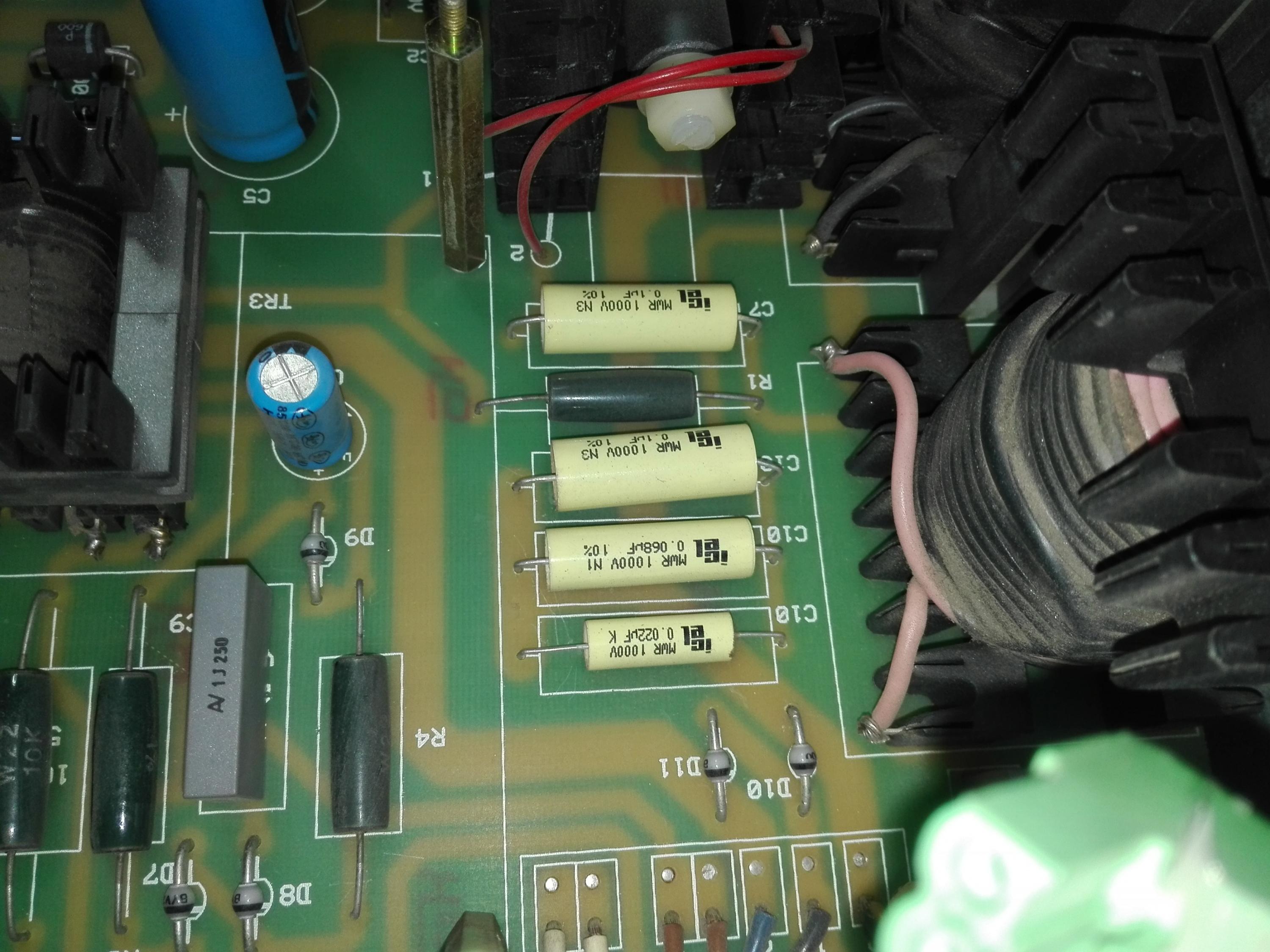

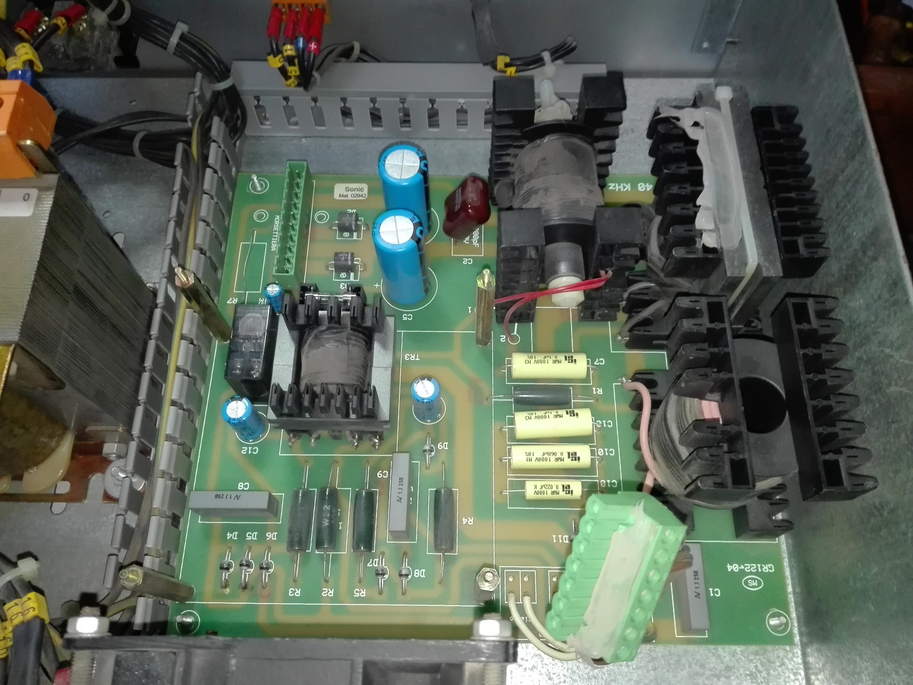

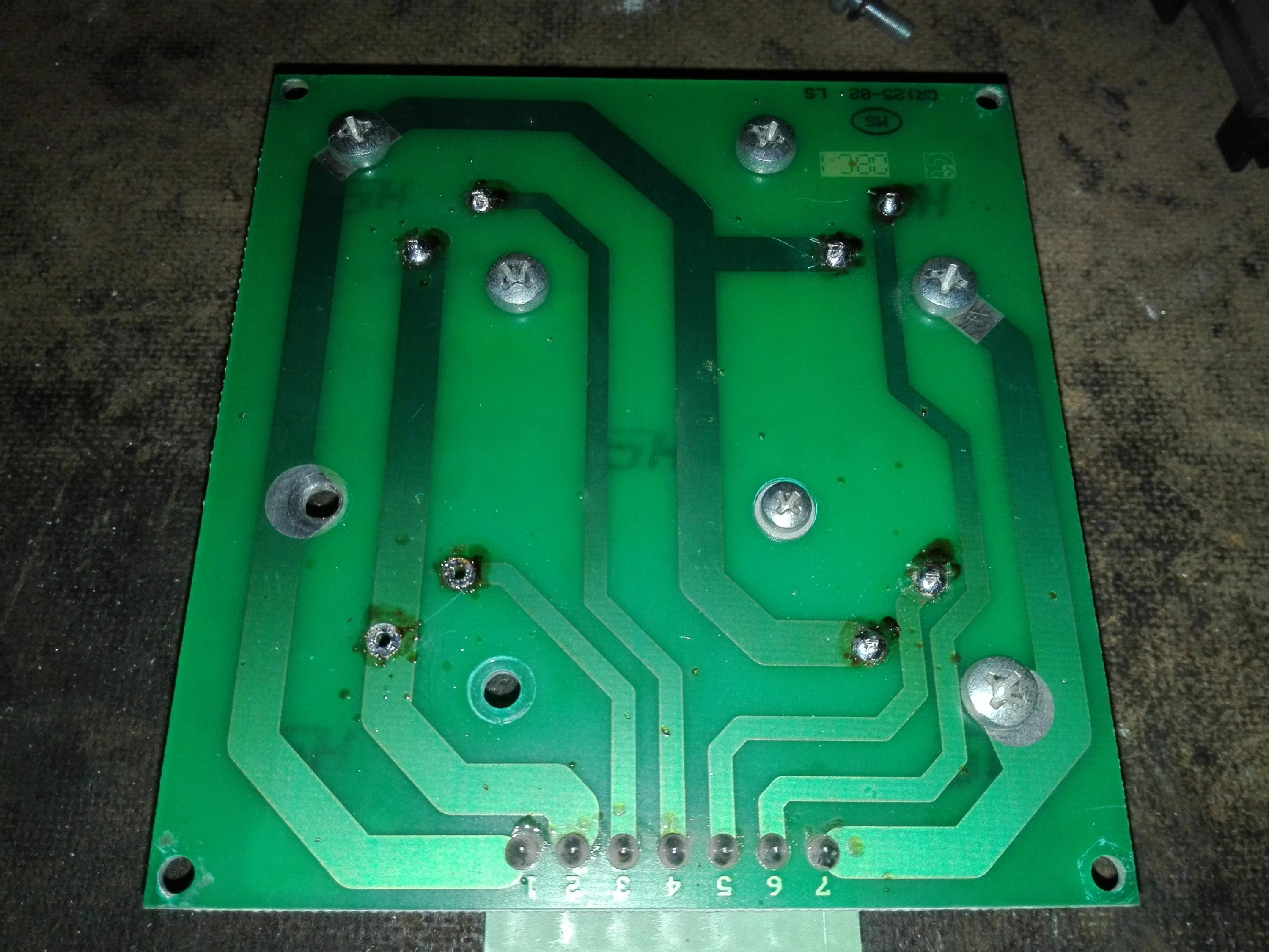

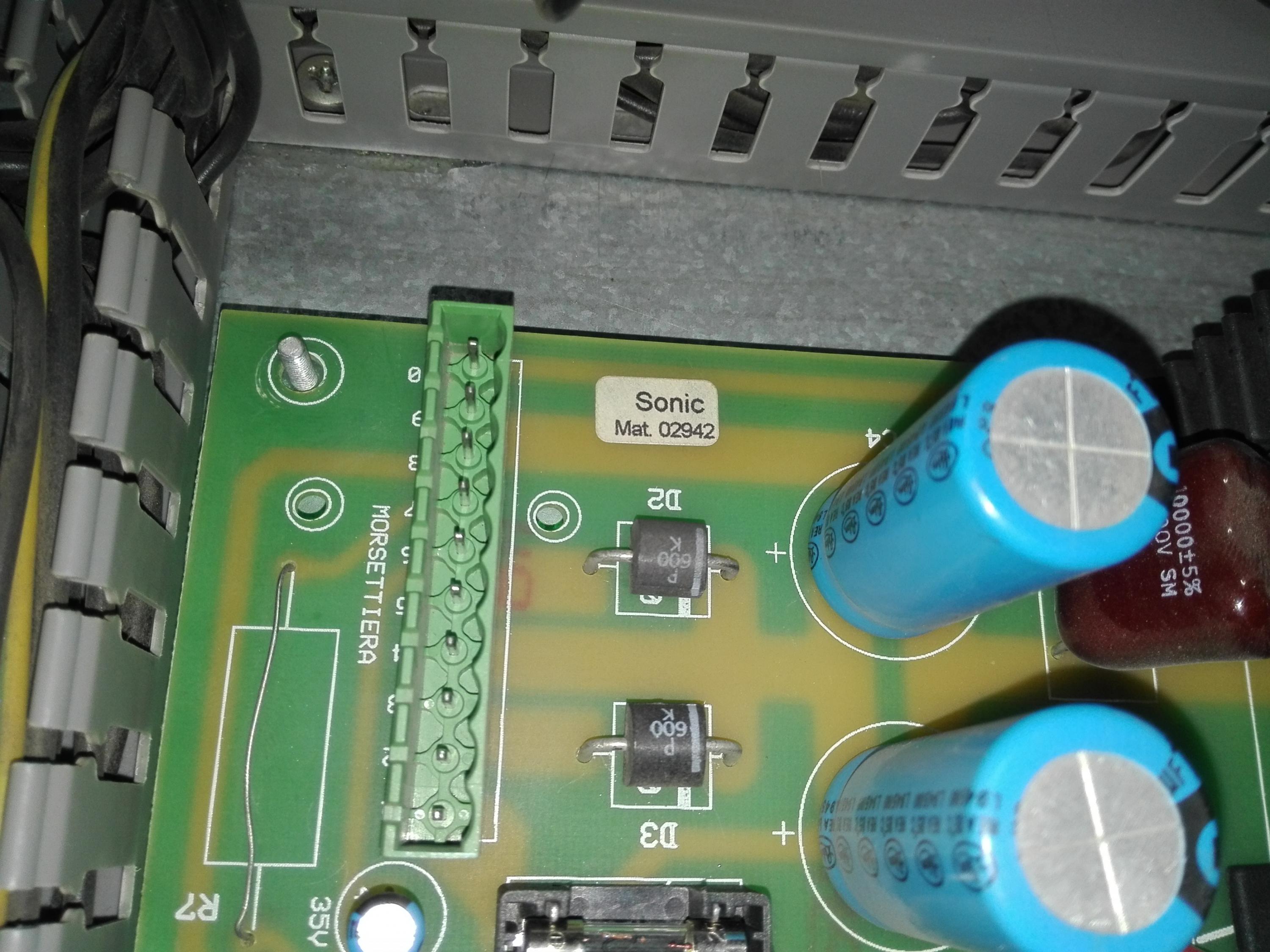

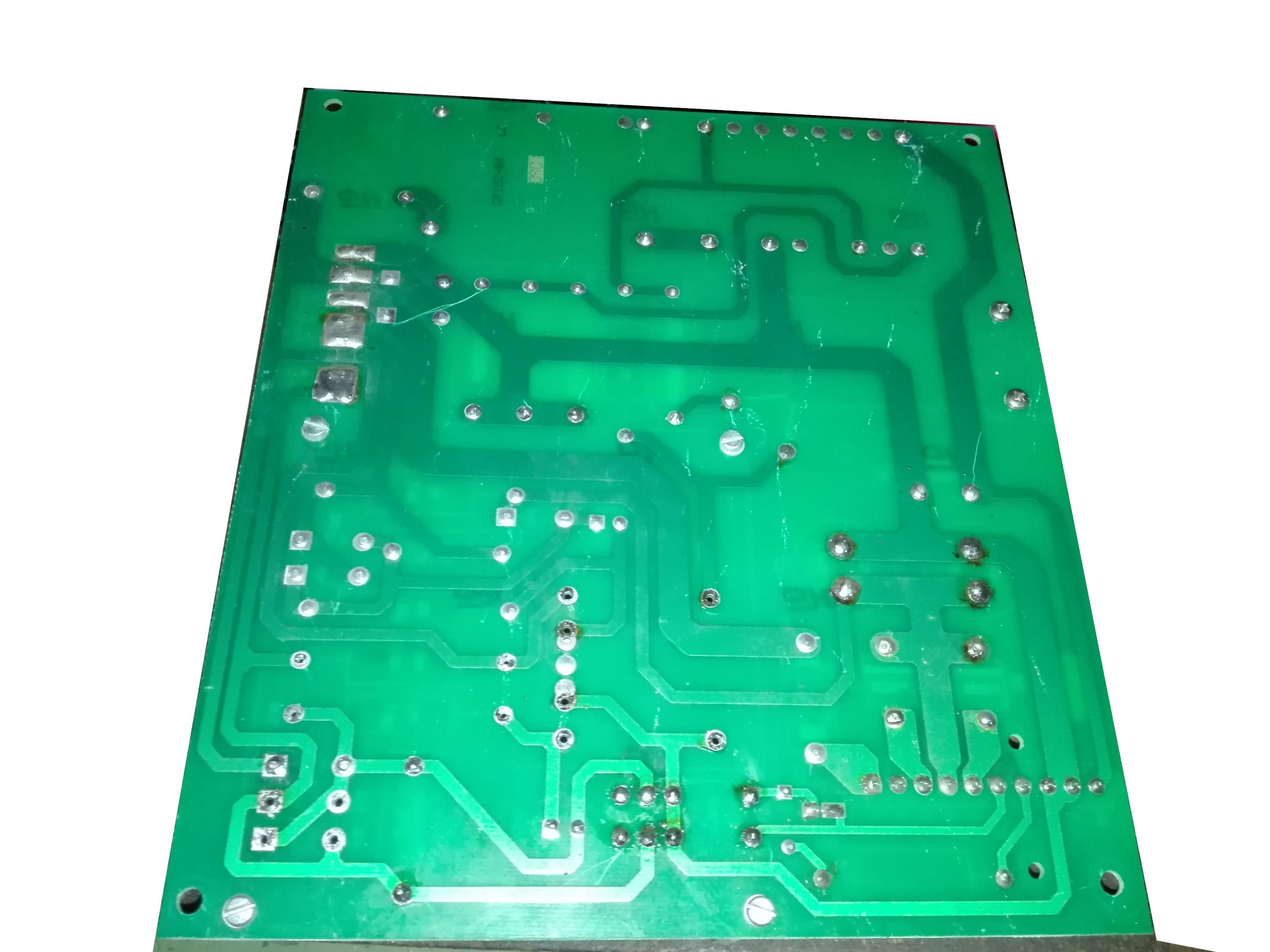

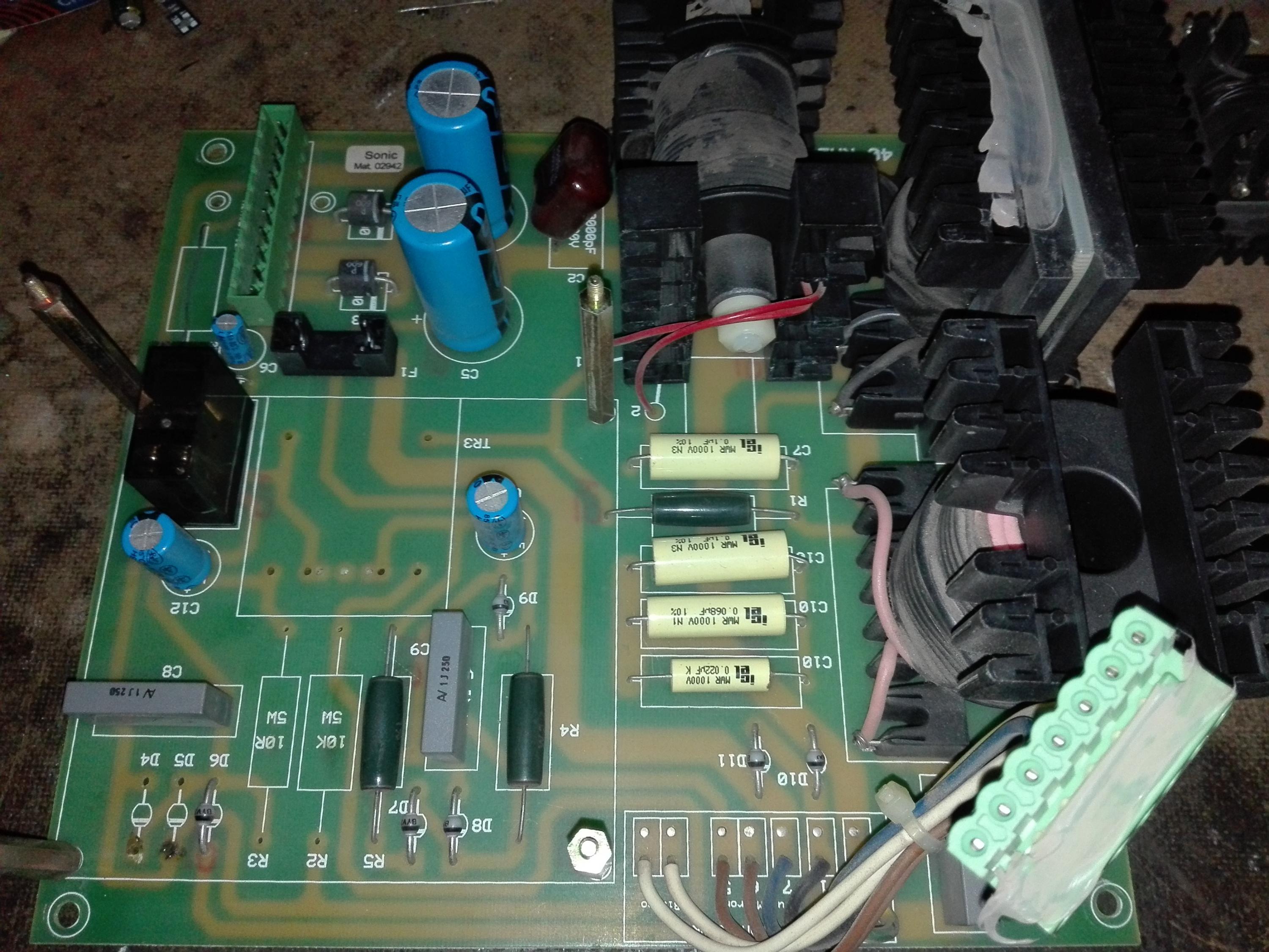

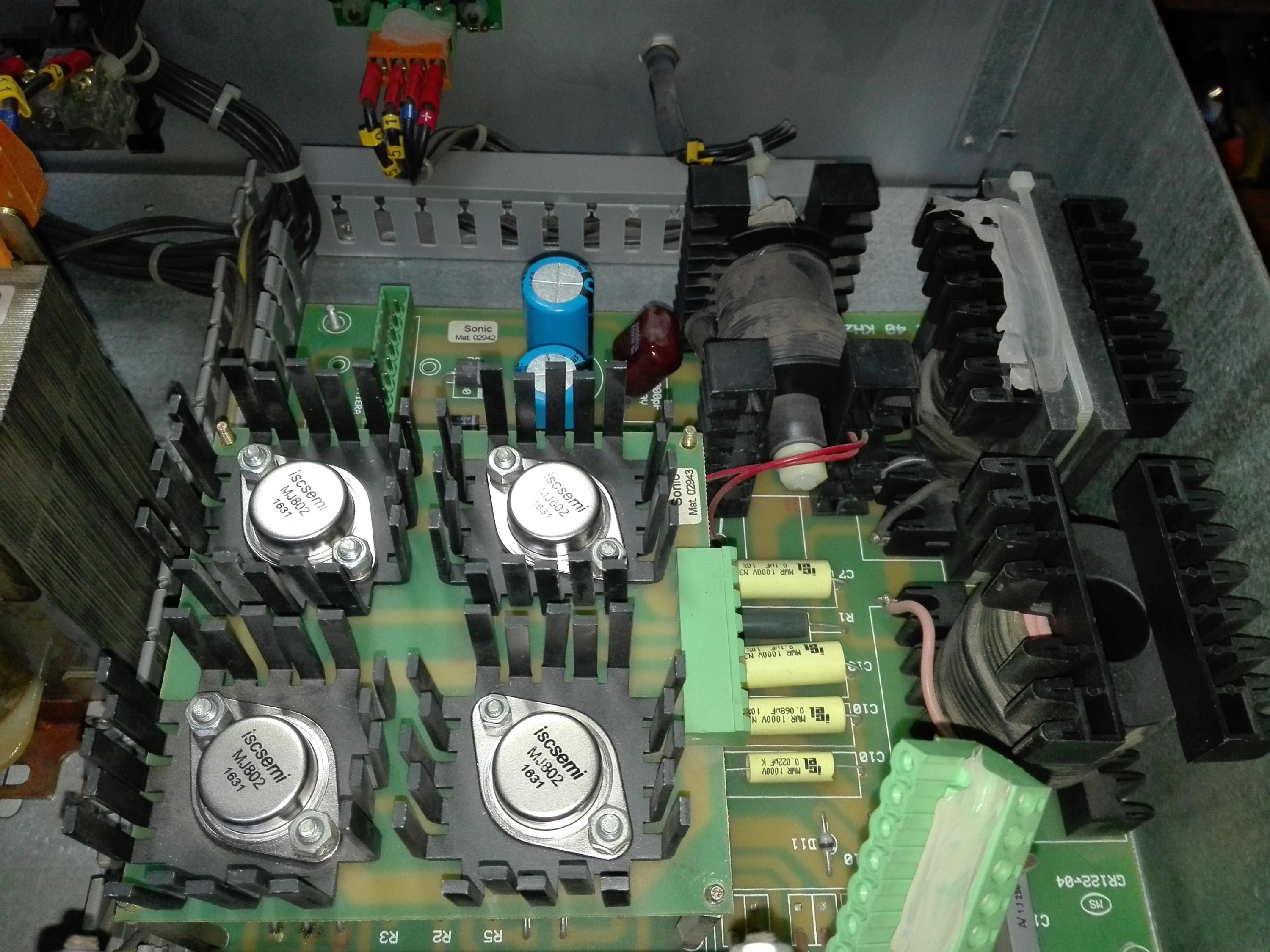

    hi, i have a welding machine with ultrasonics. it's REALLY old
    btw since now i could use it without any trouble. now i have the HIGH POWER NPN TRANSISTORS MJ802 that keep shorting after 1-2 hours of using.

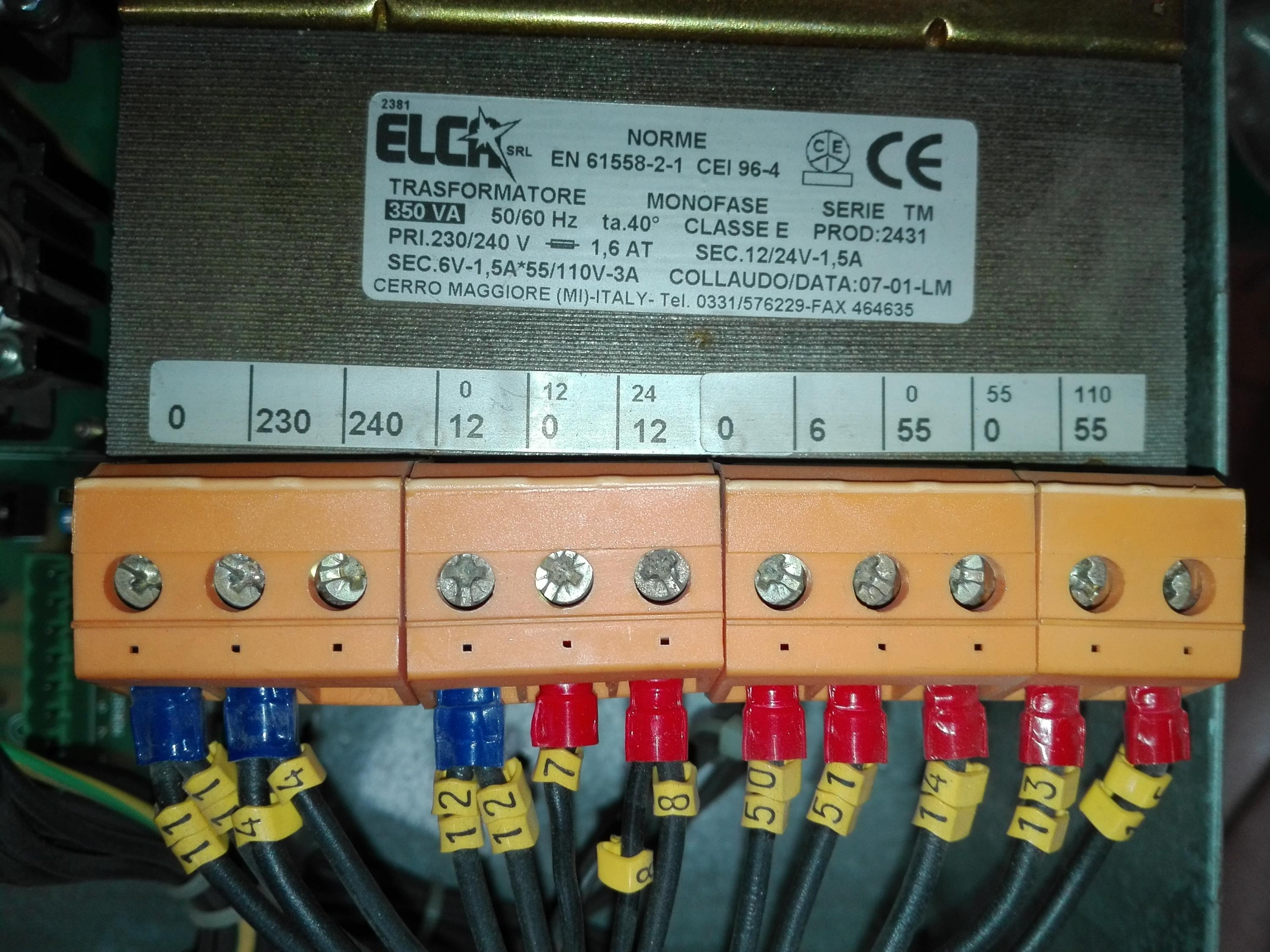

    this board is powered with a transformer that from 220V give 55v, 6v, 12v
    MY question is : why these transistors burn?
    i wish someone expert can give me some hints and what to check on the board.
    There are few components luckily. i am uploading photos of the board so you can have an idea. if something else is needed i can do measurements or else (no problem in soldering/delsoldering )
    thanks in advance

    if it runs for atleast an hour then it's probably heat.
    try replacing any thermal pads/paste - maybe add a fan.

        Re: Plastic welding machine repair and hints

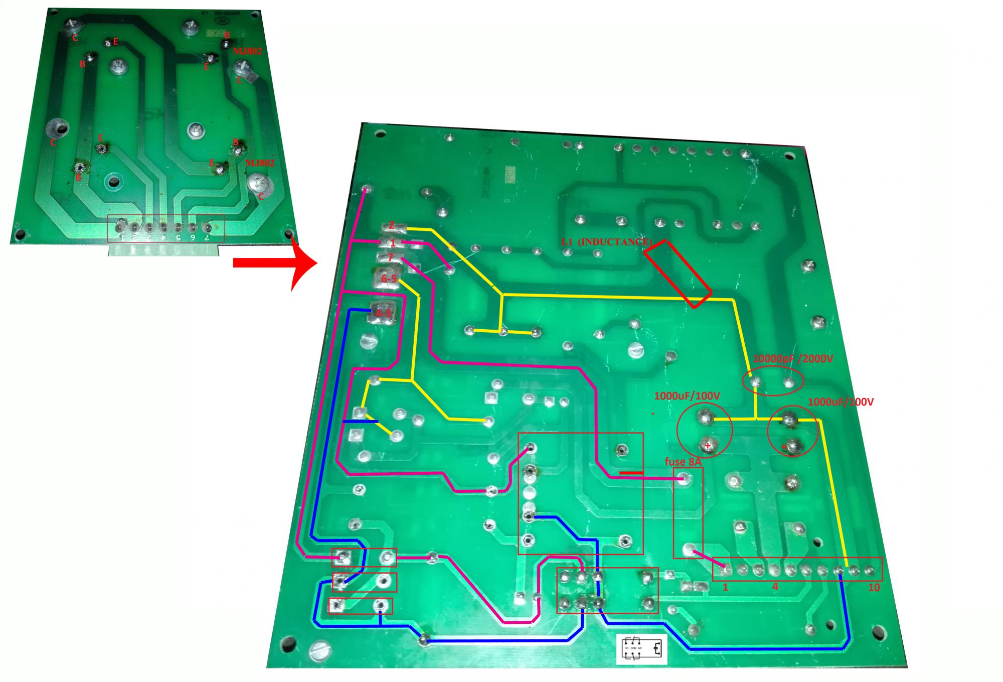

        thanks to all for the hints. about heating, that machine have a fan even if i dind't made a photo to it. and last time was working 1 hour BUT not correctly. i checked quite all the passive elements except the inductances that i cannot verify and seems all to be ok. only two big capacitors i found that are 800uF /900uF and have MANY hours of work, but i don't think they are the culprits for this defect
        6v and 12v are perfect and stable, what should be 55v really is 61v but is stable too.
        how can i check if elements connected to mj802 drawing too much current ?

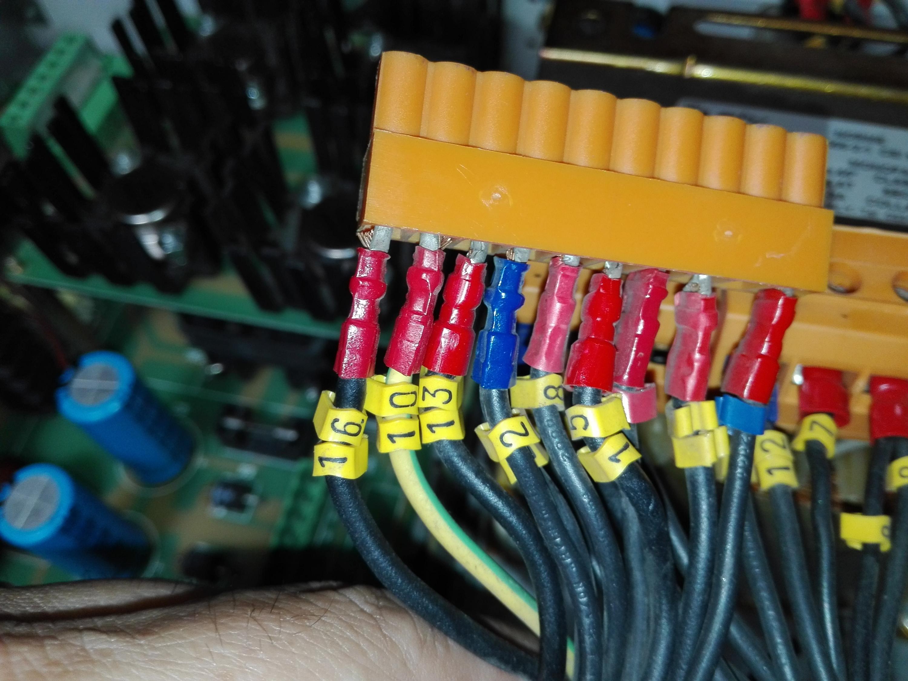

            hi, please explain more.. output from MJ802 should be nearly 100v on the COLLECTOR, right? i did some other photos on the main transformer and his plug (10 pin)
            on main capacitors, i have 81V DC. (when machine is ON in standby) so i suppose mj802 are inactive

              Are those the same number output transistors that were in it before? It could be they need to be matched or the drive to them has an issue. It cold also be the piezo has a problem (cracked?)

                or they could be fakes,
                lesser parts that have been cleaned and re-printed.
                  marking code is the same. original ones are from ON semiconductors. I found it to buy too. i wish to understand first if sonotrode is absorming too much current (more than 30A (from specs of transistor)

                    you need to fix a thermocouple to the transistors and see how hot they get,
                    those heatsinks are not really enough to let you drive the transistors to the maximum.
