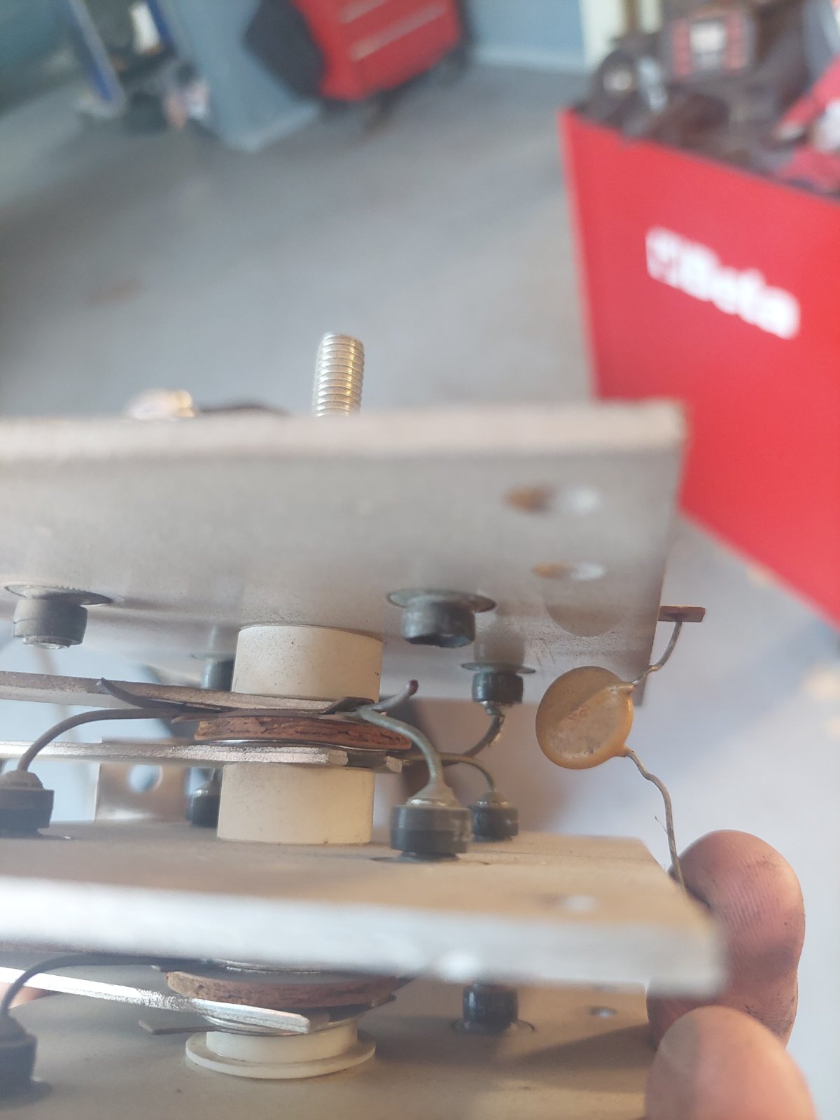

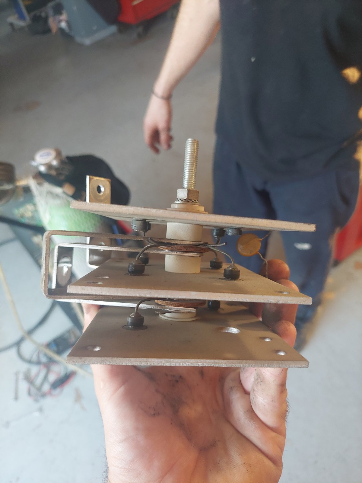

    hi in an old welding machine i have the power diodes you can see from the fotos
    these diodes the most of them are damaged
    do anybody know if there is possibiliti to change them ;
    the one side is easu to dissasemply and connected the pins the other side is connected in a material on metalic plate likes as seal
    does anybody has change diode like in mine case ;

    Re: question about diode of an old welding machine
    stud diodes by the looks of it .they press in . replace all with matching diodes .

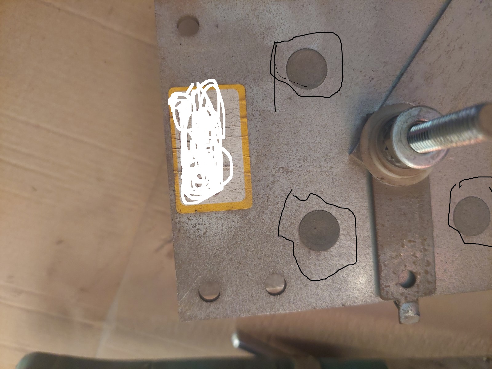

      so sir to understand better
      The foot of the diode that seems to go to the metal plate in a point like insulation you can see in the picture i have tsese points in circle is not glued with a rod I mean but it is like nailed inside so if I pull the passage up its foot will come out from the inside and the new one corresponding to the old diode I will press it inwards at that point where there will be a hole left to nail correctly I understood ?
        What make and model is the welder? Voltage and current rating. It is 3-phase?
        Looks like https://www.mig-welding.co.uk/forum/...t-diodes.51350
        The rectifier diodes are a "press-fit" into the heatsink. Using hydraulic press, they push in/out of the heatsink plate. But do not crush the other side- so a special tool or die is needed.
        Can you can read the part numbers, writing on the side of the diode?
        They look like Motorola/On-Semi parts like MR254?. My guess 25A each one.
        There would be two different diodes used - common anode, and common cathode.
            Bosch BD2504 25A 400V is 13mm check size (DO-21 0.5"/13mm).
            Many others here and cheap ones at Aliexpress but most are low voltage ones for car alternator, so watch out for that.
            These (press-fit) diodes are hard to work with. If there is room, stud-mount would be easier. This has a cooling fan?
              ok sir my rectifier writes pms 8/02/140
                What make model is the welder? It seems to be a Sealey SuperMIG140?
                This is relevant: https://www.instructables.com/Mig-We...-in-bridge-rec
                They used qty. 2 of 70HFR160 70A 1600V VISHAY and qty. 2 of 70HF160 70A 1600V VISHAY stud-mount.

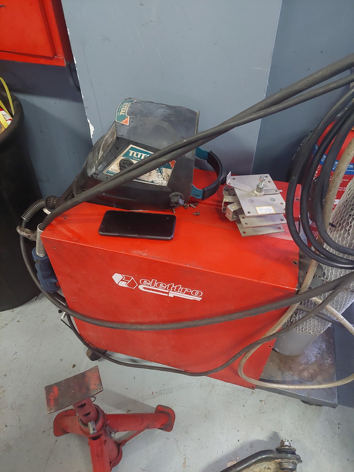

                          • Wolf1977
                            • Jul 2023
                            • 59
                            • Greece
                            sorry sir
                            the model is electro mic 210
                                Did you mean "elettro MIG 210" ? It is discontinued but you could ask them for a replacement rectifier.
                                Rectifier assy. is PMS 8/02/140 (140A) which is made by Scomes Italy.
                                Faet also sells a PMS 160 version. But you need 6 diodes, so need to add 2 more.
                                Either you hunt and try find a new one, or go to an electronics repair shop and get them to fix it.
                                P.S. - No picture of the front panel? Are you trying to make this stupid hard? Why does Post #3 scratch out the label and part number. I'm out now.
