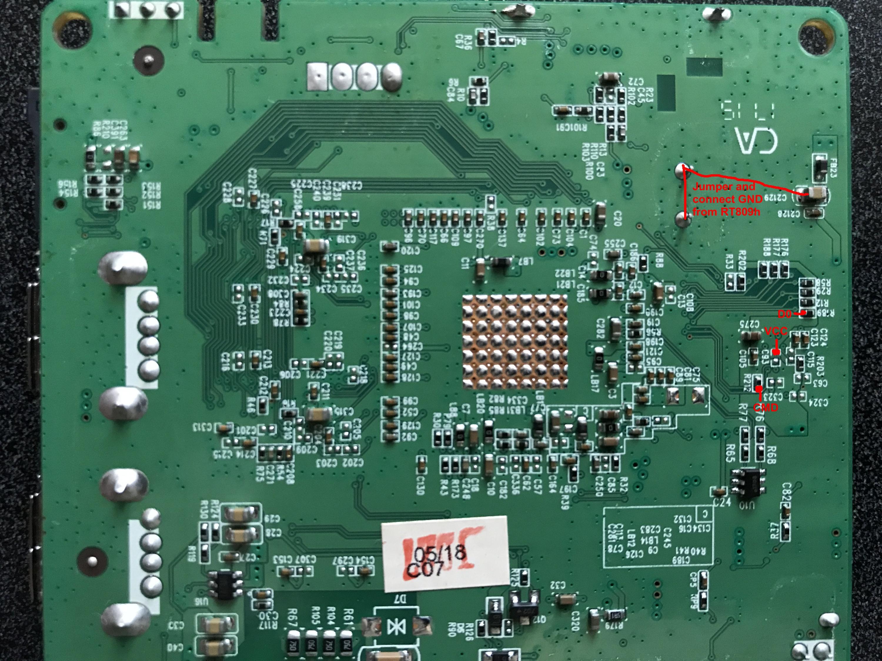

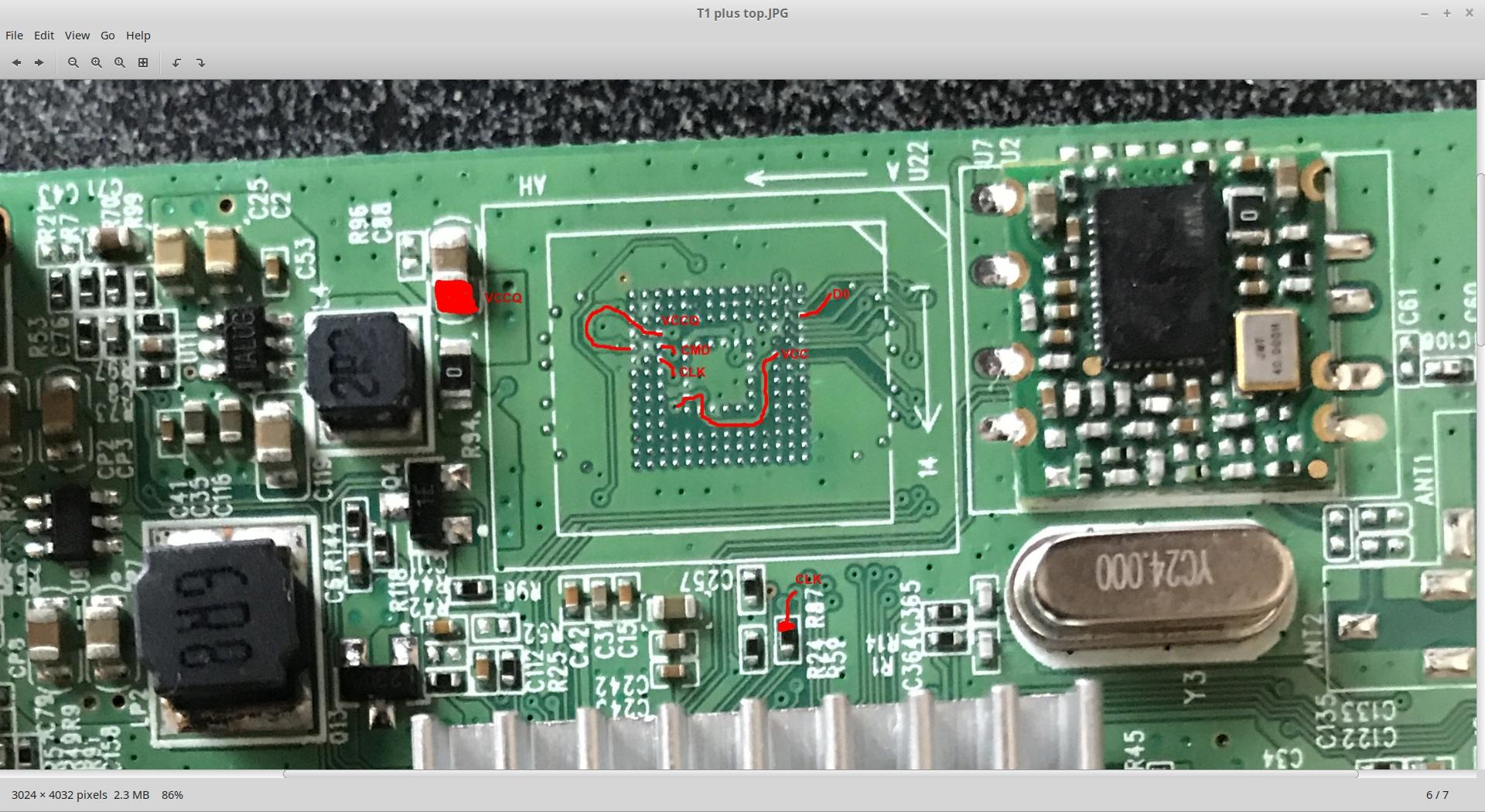

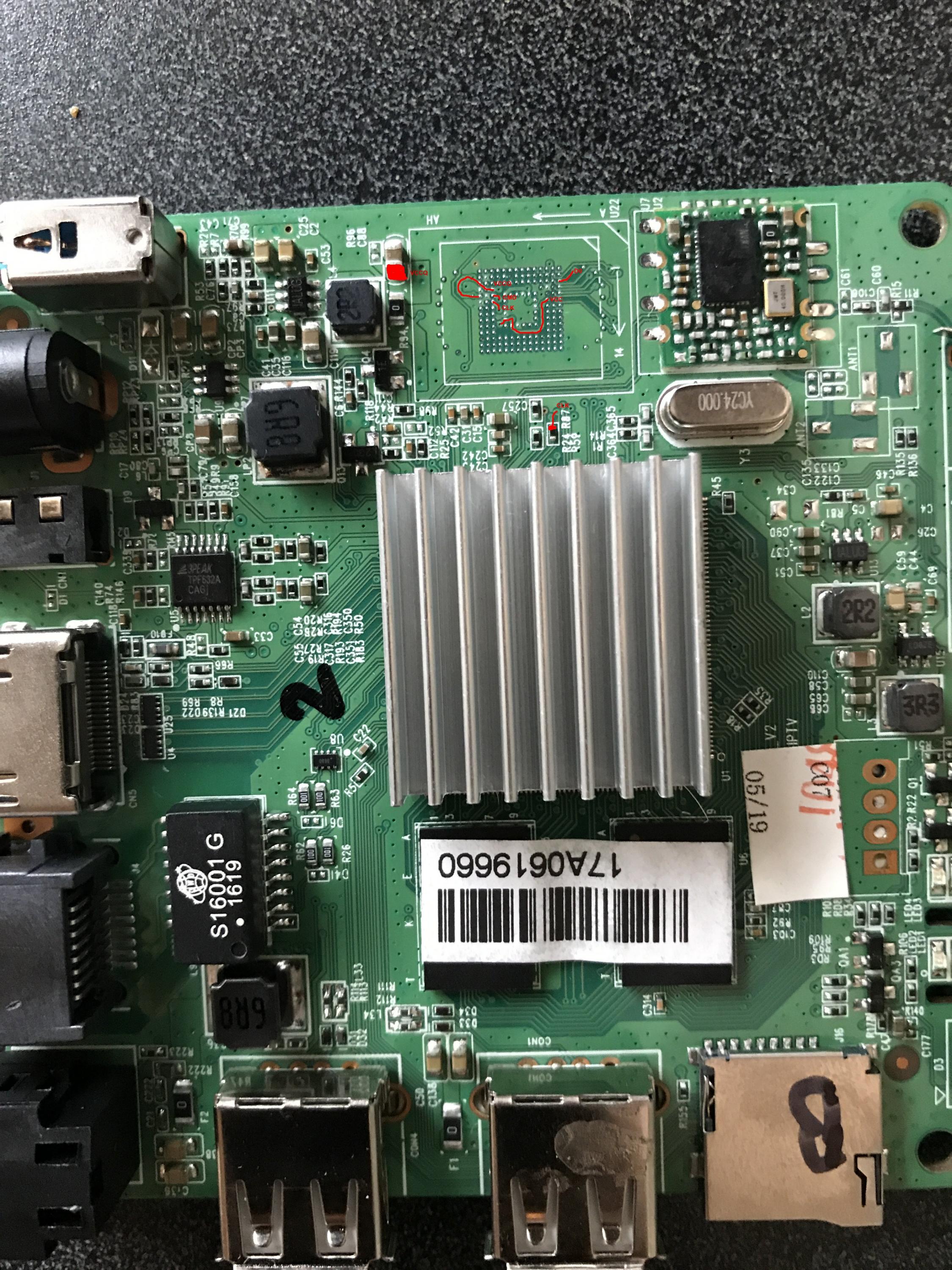

          Here it goes... dismantling time!
          I did some work on how to connect my RT809h to this Dreamlink using flying wires. Reason is, because I have one T1 plus in my possession that actually does work! I dind't want to chance anything to ruin the working one, because it doesn't belong to me. BTW, thanks to the owner for lending me his!
          I've made some pics and scribbled on them, so who ever wants to read their eMMC of the Dreamlink T1 plus can do so, without taking the eMMC off. It looks easy on the pictures, but just wait until you see the actual board. This is really small guys. Forget it without having magnification of some sort.
          Just put the RT809h in Auto ISP, 3.3V and you are good to go. It takes like 45 mins or more to read it.
          That's it for me today... next step is to program a new eMMC and solder that back on to the broken T1 plus.
          stj: I did measure about 3.37VCC and VCCQ on the working one.

              Re: Dreamlink T1 plus two green lights, need working dump
              I proved today that reading the eMMC on the working T1 plus, doing a factory reset, reading the eMMC again, then flashing the first files I had read back to the eMMC, the box is still working and the factory reset was reversed. That was done with flying wires using the RT809h, I didn't take the eMMC off the board.
              Ran into a little snag, where I had burnt the 47k resistor on the D0 line (see pics above) and that changed it to 67k. The box wouldn't boot like that. That got me going all right, because I thought I had bricked it. Switched the resistor out and the box was working fine afterwards.
              The project is coming to an end for now, as I ran out of chip quick. So things have to wait for 3 weeks or so. After that I'll see if it is possible flashing the files I took from the working T1 plus to a 16GB eMMC and install that to one of the wrecked boxes and fire that up.

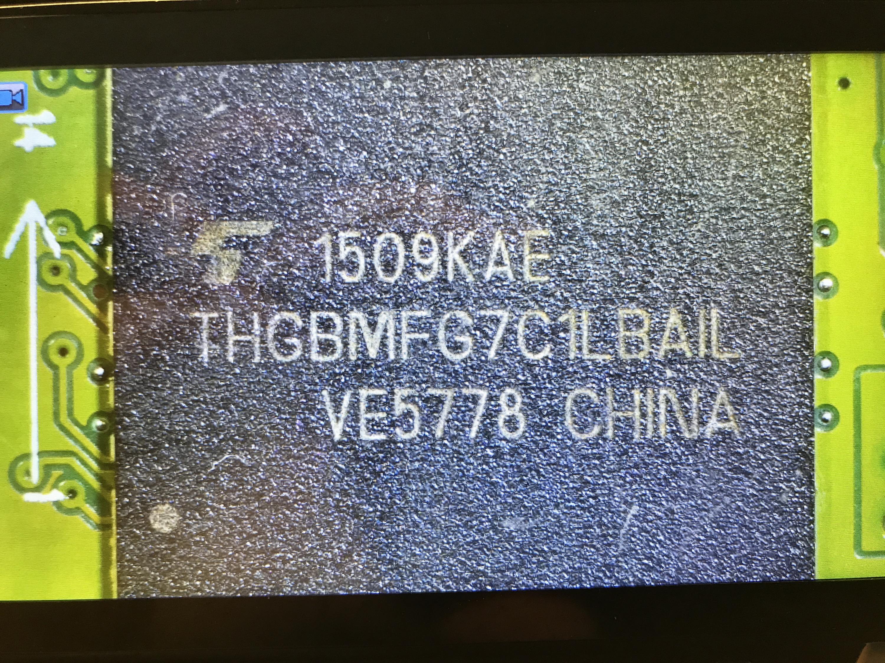

                Well, it is just about a month later now. Received the solder paste I needed to complete this project. Here is the verdict:
                SUCCESS!!!
                I've copied the image I took from a working box a while back to my salvaged 16GB EMMC (double the size), then I've soldered the flashed chip back to the board. Turned it on and it works!

                  The original Essencore I3E-86TH2CMRE 8gb EMMC is readable as a THGBM5G5A1JBAIR on the RT809h. Just fixed another one.

                                    Probably the Essencore emmc is dead, which is 95% the case, I So you have to pull the spec sheet from the original and find a similar emmc if you need to replace it, just like i did. You cant put just some emmc in it, as some are faster than others. Depending on if you have the proper adapter for the programmer or not, you can either program the emmc off the board, or with flying wires with the emmc already soldered on board and the dump I provided. You do need an emmc programmer, I used the RT809h. The dump is not going to install via usb or something. I've got replacement emmc's from either salvaged units or Aliexpress. The thgbmfg7c1lbail worked perfect as a replacement and it had double the capacity, see post #8, first and second picture.
