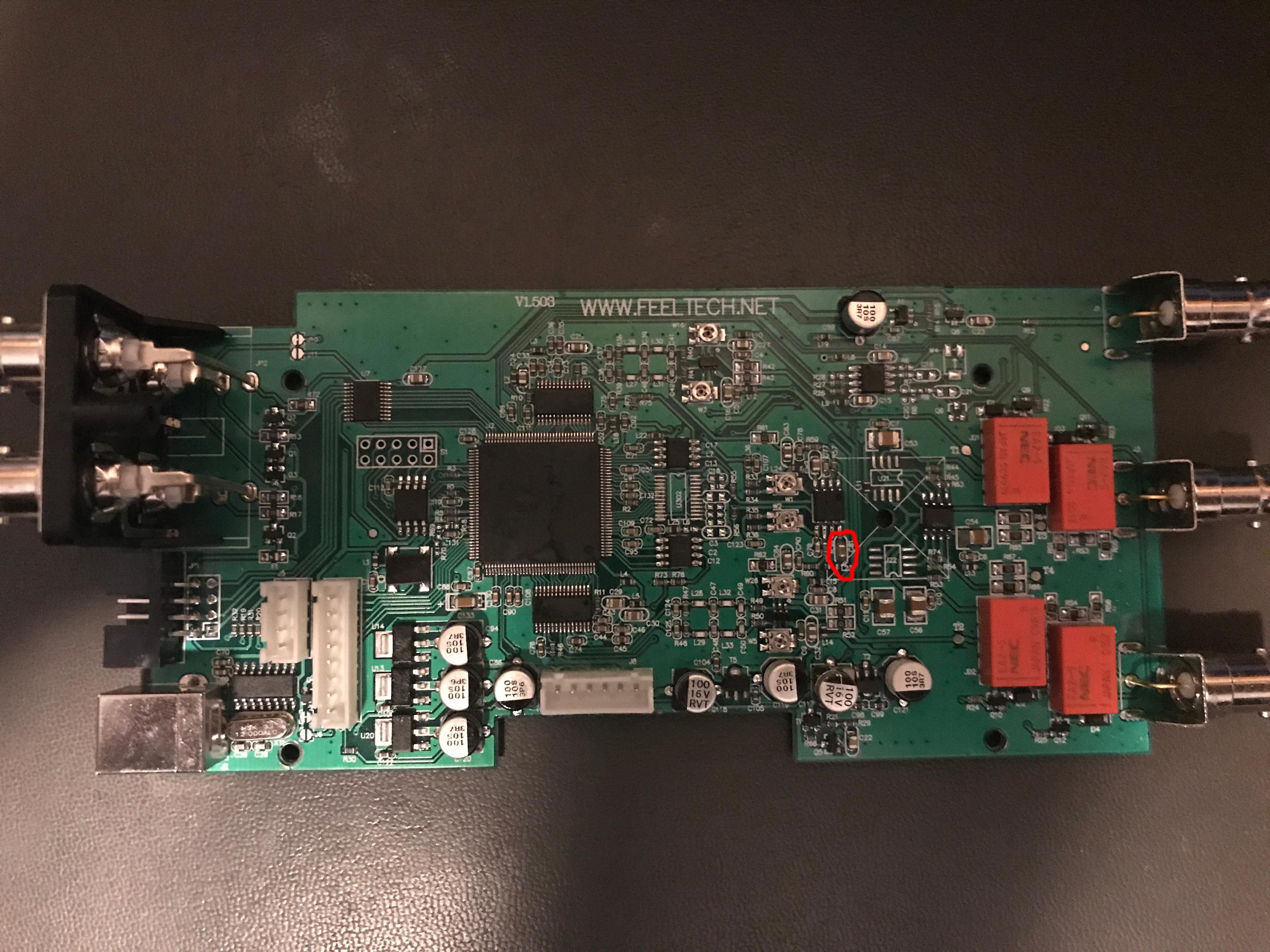

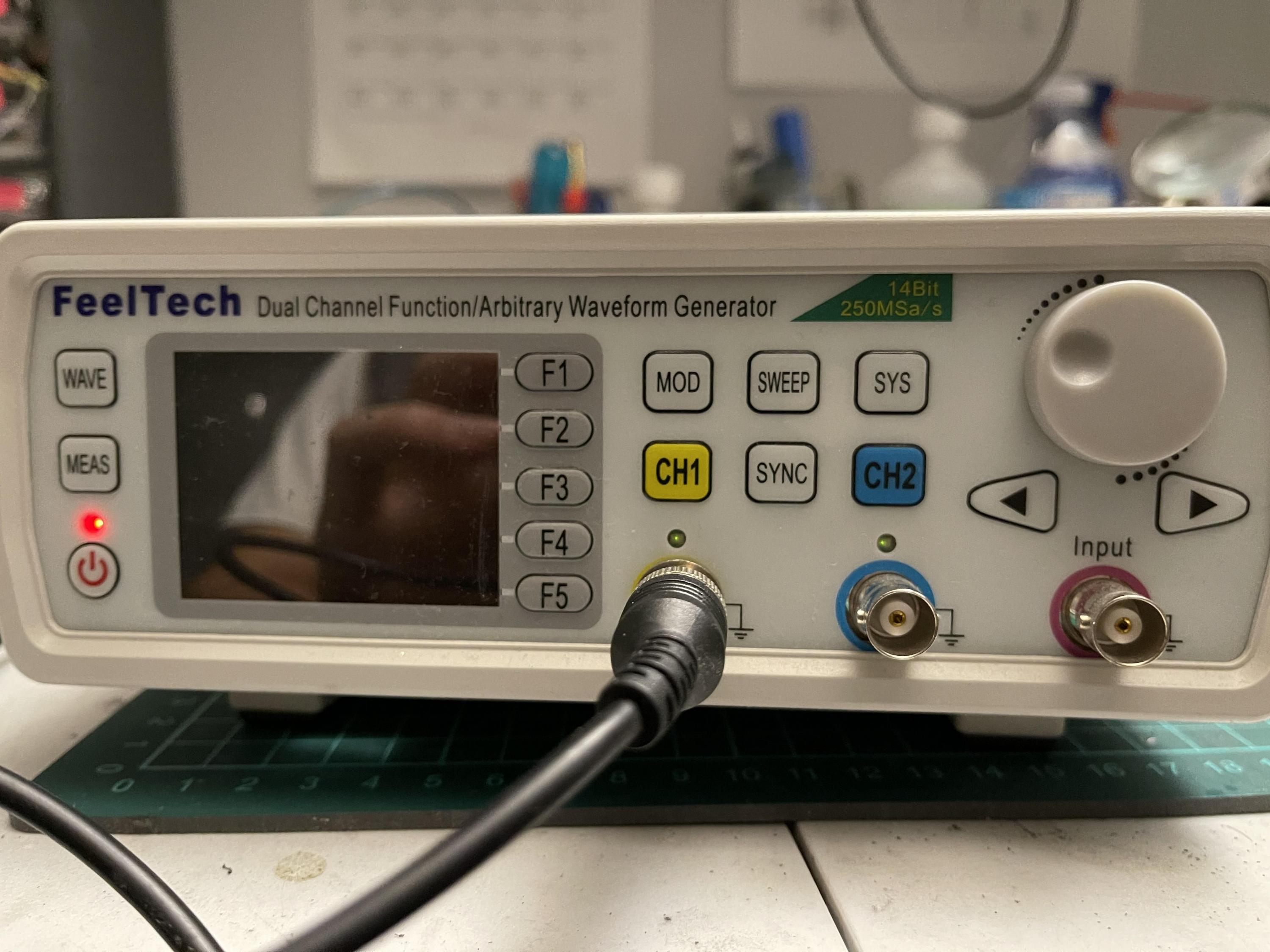

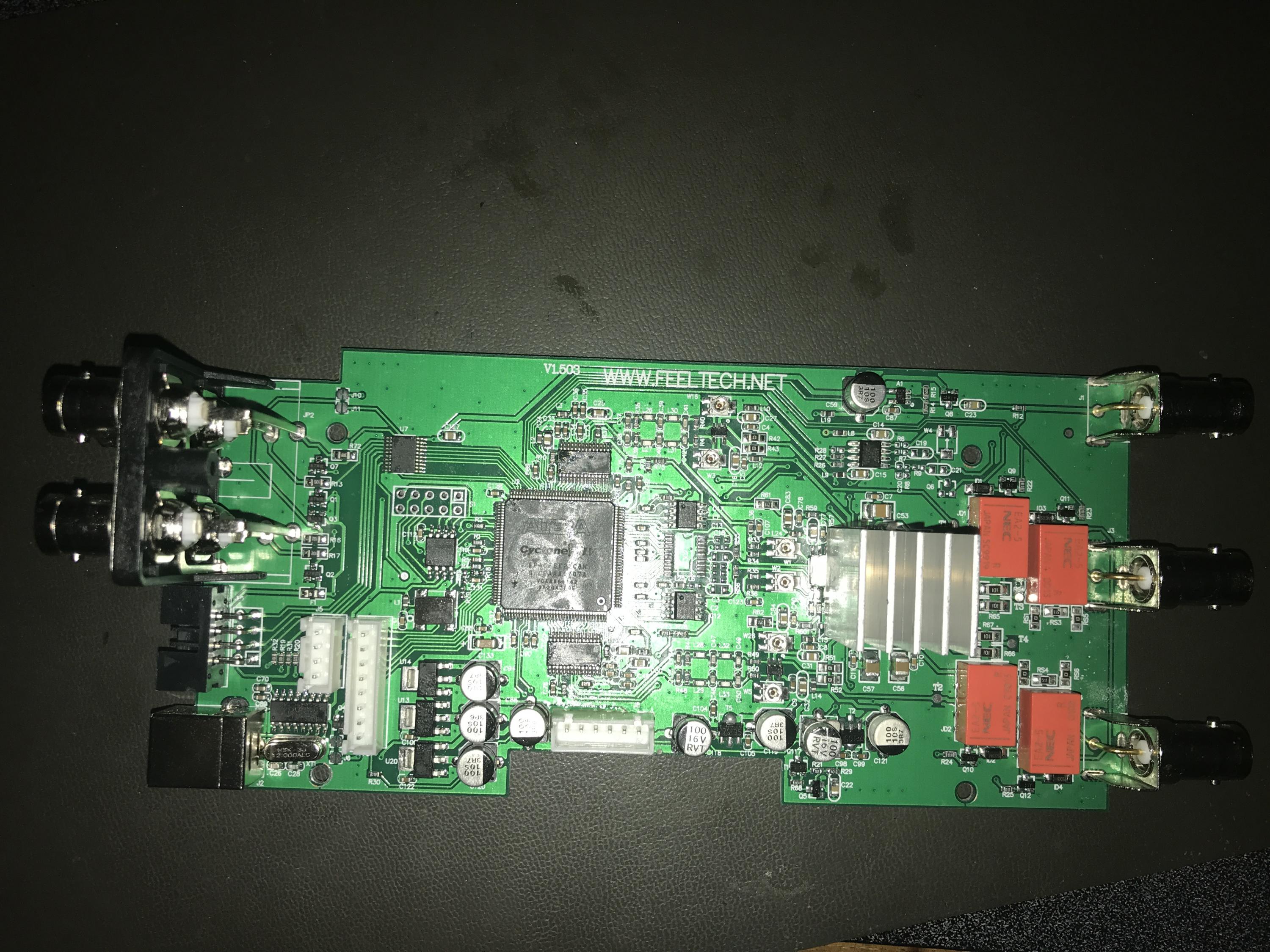

FeelTech / Kuman FY6600 DDS Function Arbitrary Waveform Generator repair
  • CapLeaker
    Leaking Member
    • Dec 2014
    • 8118
    FeelTech / Kuman FY6600 DDS Function Arbitrary Waveform Generator repair
    Some Got it as a X-Mas present from wifey. Lasted about 30mins and then it was absolutely dead.
    Checked the PSU and it was loaded down to next to nothing. Unplugged the main board from the PSU and all is O.k. on the PSU. Ahh! Main board problem!
    Took the main board out and find a short at T2 (78L05) regulator between the input and GND pin. Took that out including the cap that is next to it and still have a short. I also measured shorts between C53 and C57. Took these out, took the 2 IC's under that heat sink out and still a short! Running out of options I decided to go old fashioned way hunting a short. Feed Power! Fed 5V 1.2A on the shorted line, doused half of the board with alcohol and success! SMD cap C81 bubbling! Replaced that with another cap the same size I found on a TV main board, put that in, soldered in all the parts I had taken out, reassembled it and I've got a working Function Generator.
    So in short: If you have a Feeltech / Kuman FY6600 that doesn't work and the PSU is good, check C81 on the main board. It is under that little heat sink that is on top of of the 2 IC's.
    Merry X-Mas!
  • eccerr0r
    Solder Sloth
    • Nov 2012
    • 8696
    Re: FeelTech / Kuman FY6600 DDS Function Arbitrary Waveform Generator repair
    Was that heatsink specifically for those two ICs? Weird... expecting a SOIC8 and SOP8 to dissipate that much heat is not a good sign...?
    • CapLeaker
      Leaking Member
      • Dec 2014
      • 8118
      Re: FeelTech / Kuman FY6600 DDS Function Arbitrary Waveform Generator repair
      Yes. The funny thing is that the heat sink only covers the both IC's only to 75% and there was no thermal paste either.
      • CapLeaker
        Leaking Member
        • Dec 2014
        • 8118
        Re: FeelTech / Kuman FY6600 DDS Function Arbitrary Waveform Generator repair
        I decided to open her up again and read the Winbond 25Q16JV SPI flash.
        https://www.eevblog.com/forum/repair...nal-generator/
        My firmware version is 3.2.1
        Enjoy!
        Last edited by CapLeaker; 02-23-2019, 05:07 PM.
        • CapLeaker
          Leaking Member
          • Dec 2014
          • 8118
          Re: FeelTech / Kuman FY6600 DDS Function Arbitrary Waveform Generator repair
          ... forgot the schematics to that thing.
          • CapLeaker
            Leaking Member
            • Dec 2014
            • 8118
            Re: FeelTech / Kuman FY6600 DDS Function Arbitrary Waveform Generator repair
            Now I have to figure out how to read the STM32 in the head unit. That is where the actual firmware is. The stuff on the Winbond doesn't look like firmware.
            Did anyone try to copy and flash an STM32 before?
              • Jul 2011
              • 6033
              Re: FeelTech / Kuman FY6600 DDS Function Arbitrary Waveform Generator repair
              Took the main board out and find a short at T2 (78L05) regulator between the input and GND pin. Took that out including the cap that is next to it and still have a short. I also measured shorts between C53 and C57. Took these out, took the 2 IC's under that heat sink out and still a short! Running out of options I decided to go old fashioned way hunting a short. Feed Power! Fed 5V 1.2A on the shorted line, doused half of the board with alcohol and success! SMD cap C81 bubbling! Replaced that with another cap the same size I found on a TV main board, put that in, soldered in all the parts I had taken out, reassembled it and I've got a working Function Generator.
              This is very interesting in how you found the shorts that were on this board
              This was very interesting reading I enjoyed it Thanks for sharing this
              • CapLeaker
                Leaking Member
                • Dec 2014
                • 8118
                Re: FeelTech / Kuman FY6600 DDS Function Arbitrary Waveform Generator repair
                Yeah, that old trick saved my butt a few times.
                I've managed to get the 3.3 firmware, some .FYbi file for the STM32 from the manufacturer. Now I have to figure out how to update that Function Generator.
                  • 30979
                  Re: FeelTech / Kuman FY6600 DDS Function Arbitrary Waveform Generator repair
                  ask your source, stlink / serial uses HEX files.
                  they may have written a special bootloader - possibly using the usb port.
                  • CapLeaker
                    Leaking Member
                    • Dec 2014
                    • 8118
                    Re: FeelTech / Kuman FY6600 DDS Function Arbitrary Waveform Generator repair
                    Originally posted by stj
                    ask your source, stlink / serial uses HEX files.
                    they may have written a special bootloader - possibly using the usb port.
                    That's the problem. FeelTech doesn't provide that unless that is something brand new. Nothing is available from their website. All they say is: send it in.
                    • CapLeaker
                      Leaking Member
                      • Dec 2014
                      • 8118
                      Re: FeelTech / Kuman FY6600 DDS Function Arbitrary Waveform Generator repair
                      This is supposed to be the version 3.3 firmware for the STM32 on the FY6600 that I've managed to download from FeelTech.
                        • 30979
                        Re: FeelTech / Kuman FY6600 DDS Function Arbitrary Waveform Generator repair
                        that's encrypted binary with a custom header.
                        install the pc remote-control software and see if it has an upgrade option in it somewhere.
                        • CapLeaker
                          Leaking Member
                          • Dec 2014
                          • 8118
                          Re: FeelTech / Kuman FY6600 DDS Function Arbitrary Waveform Generator repair
                          Back to this puppy. Had to grab an old windblows machine and really install that software. Nope, you can't upgrade the Firmware through the PC-software v. 5.5 and that is the latest. Maybe I'll try the software from the newer FY-6800 later on and see what that does.
                          • bcgelandewagen
                            • Feb 2021
                            Re: FeelTech / Kuman FY6600 DDS Function Arbitrary Waveform Generator repair
                            Some Got it as a X-Mas present from wifey. Lasted about 30mins and then it was absolutely dead.
                            Checked the PSU and it was loaded down to next to nothing. Unplugged the main board from the PSU and all is O.k. on the PSU. Ahh! Main board problem!
                            Took the main board out and find a short at T2 (78L05) regulator between the input and GND pin. Took that out including the cap that is next to it and still have a short. I also measured shorts between C53 and C57. Took these out, took the 2 IC's under that heat sink out and still a short! Running out of options I decided to go old fashioned way hunting a short. Feed Power! Fed 5V 1.2A on the shorted line, doused half of the board with alcohol and success! SMD cap C81 bubbling! Replaced that with another cap the same size I found on a TV main board, put that in, soldered in all the parts I had taken out, reassembled it and I've got a working Function Generator.
                            So in short: If you have a Feeltech / Kuman FY6600 that doesn't work and the PSU is good, check C81 on the main board. It is under that little heat sink that is on top of of the 2 IC's.
                            Merry X-Mas!
                            I have experienced a similar issue where turning on the unit I can hear relay clicks but no display on the led screens. The Red power LED and green channel LEDs seem to be on but faintly. Do you know the value of the C81? I downloaded the schematics but i did not find the value. I'm not very good at troubleshooting I am still learning along.
                            Thank you,
                            • CapLeaker
                              Leaking Member
                              • Dec 2014
                              • 8118
                              Re: FeelTech / Kuman FY6600 DDS Function Arbitrary Waveform Generator repair
                              yours has a different problem than mine had. Mine was totally dead, as one of the voltage rails was shorted to GND. Not sure what problem yours has. Maybe give it a good visual under the microscope. Check all the voltage rails, 12, 5, 3.3, 1.2V. There is a TTL, maybe read it out.
                              • jason123
                                Agilent 33220A 20 MHz Function Generator
                                by jason123
                                I can't find a forum to discuss "instrumentation Troubleshooting", but PS maybe the closest.
                                So, I'm having an issue with about 13 year old Agilent Function Generator. it works, passes self-test, but it has an annoying "audible" noise, that changes as I change the output frequency setting of the instrument. Prominent around 600 Hz and up (at least that's what my ears are picking up.) I saw on some forms that it could be fan, linear regulator, dried up caps,... I can't seem to find the source of audible noise. Here is what I tried:
                                1. Turn the output off - still...
                                07-01-2025, 08:12 AM
                              • SolomonMan
                                Function Signal Generator Some Questions...
                                by SolomonMan
                                All,
                                I have been collecting/purchasing equipment as I go along my "Electronics Journey". Thanks for all those who have helped me on this Journey and have educated me... I really appreciate this guidance!
                                Also the fixing of many of my household finds have kept the wife happy as well as I buy said new electronic equipment.
                                I have read and heard that every electronics workshop should have a Function Signal Generator or more than one.
                                As I barely understand the use of such a piece of equipment can someone educate me first on what this...
                                12-15-2020, 01:38 PM
                                Electronic Goldmine has replacement Irons for the ZD-978 or similar model number this the one that has the sleep function
                                by sam_sam_sam
                                This is a new item at Electronic GoldMine that has arrived within the last few weeks
                                Here is the link for them I know for sure that it works because ( I tried it on mine soldering station ) I bought two of them and I just bought two more of them so I have some extra replacement ones in my parts bin
                                Stahl Tools DDDS Replacement Iron for DSDS Stahl Solder Station
                                https://theelectronicgoldmine.com/products/g28392
                                One note it will not work for the ZD-917 or similar model number that does not have the sleep function that are the same iron but the plug only...
                                11-24-2024, 01:25 AM
                              • japlytic
                                Conventional vs arbitrary function generators
                                by japlytic
                                These days, I recommend arbitrary function (waveform) generators over conventional function generators given arbitrary function generators are easier to use (especially with a waveform display), more flexible, consistent in output and offer better value for money considering that the design (and calibration) of an arbitrary function generator can be less expensive than a conventional function generator (depending on how many waveform types a conventional unit includes) nowdays.
                                Many arbitrary function generators include a number of built-in waveforms, some of which are complex...
                                Conventional
                                0%
                                2
                                Arbitrary
                                0%
                                3
                                No preference
                                0%
                                2
                                09-19-2017, 06:05 AM
                              • Nevillet
                                Square wave (from a function generator) Vs a pulse generator
                                by Nevillet
                                Hi All,
                                Can someone please explain the difference between a 1kH square waveform with a 50% duty cycle and a similar waveform from a pulse generator?
                                Many thanks,
                                10-09-2022, 02:39 AM
