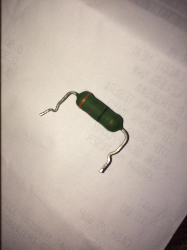

Hello, could anyone help with the resistor value for this resistor, my induction hob has a fault code after having a close look i found this resistor is cracked.
Induction hob power board
Re: Induction hob power board
It's too hard to make out the colors reliably in your photo with the lighting you have.
Try this if it makes things easier for you:
https://www.digikey.com/en/resources...or-code-4-band"The one who says it cannot be done should never interrupt the one who is doing it."
