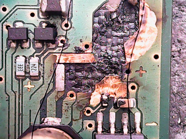

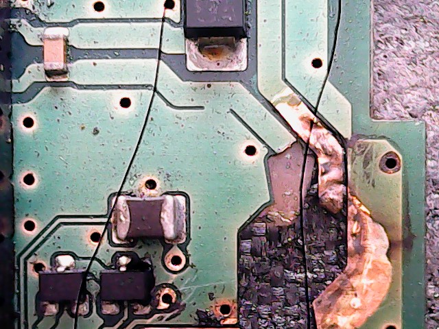

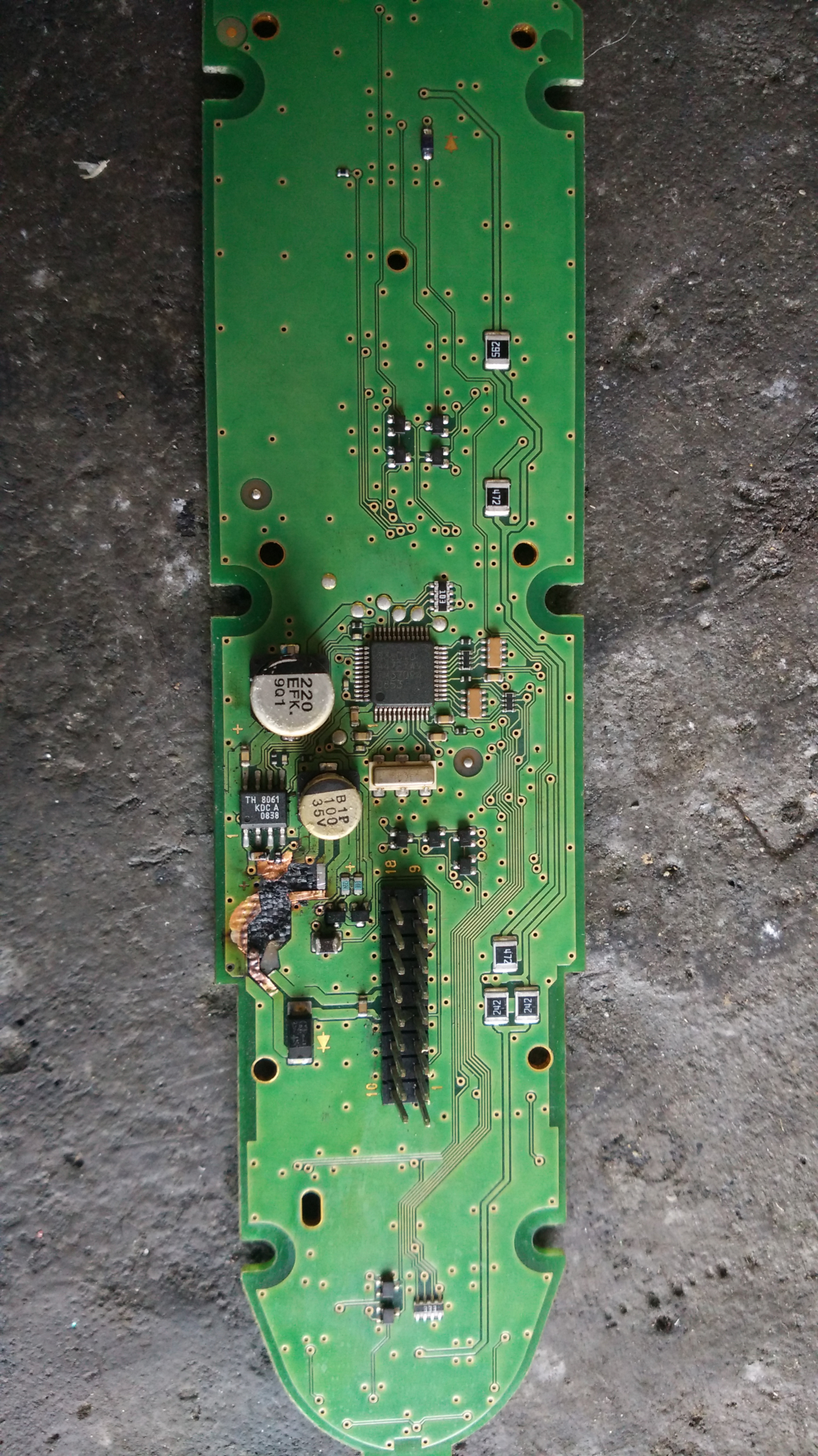

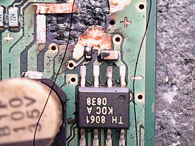

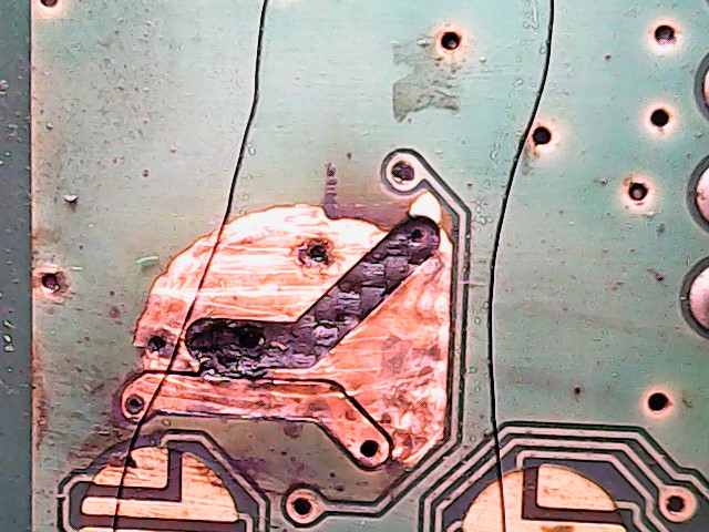

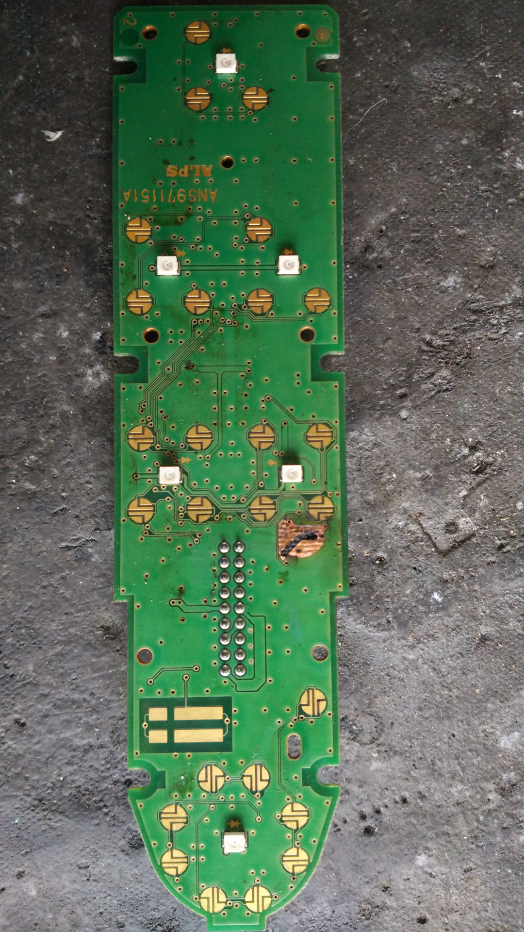

    Hi. Hope this fits in here....
    So I have a module here that burned a bit. See Photos. Top, Bottom, and some close-up. Ignore the black lines on the last few photos, lens got damaged.
    I need to figure out what goes where. Can't seem to find a diagram/schematic or any reference image of good quality.
    Anyone here worked on something like this or have one laying around? :P (long shot)
    Much Appreciated

      Re: Window Controller for BMW 335i
      too much work, find another online.
      you need to grind out all the burned carbon and then rebuild.
      positive thing is it didnt damage the area for the buttons,
      negative thing, i suspect a part is completely missing.
      you you check the remaining diode & ceramic caps for shorts?
        Thanks guys you both are so helpful!
        @SMDFlea thanks that would at least give me an idea of the pinouts.
        @stj Yeah it is I agree, but id give it a shot in anycase. The traces & pcb is pretty much toast as you can see. I think there maybe something missing as well but it also seems to not be the case.
        It seems like it may have been a spillage... Those traces there are mainly ground. The only one not ground is coming from the Diode. No shorts on anything.
          could have been a loom short or maybe a stalled motor then.
          loom damage is common in cars these days.
            Interesting point. I saw the car today... Made me say that uhm no thanks I'm not spending anymore time on that module... The owner clearly doesn't care about his car... Its sad. Anyways so I moved on not doing any more work on this.
            EDIT: To add, before my decision I did check the connector in the car and the 2 pins that run side by side with the bridged cap is 12V and GND.
