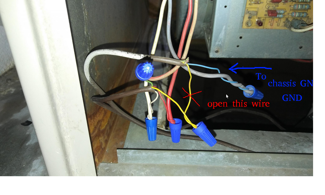

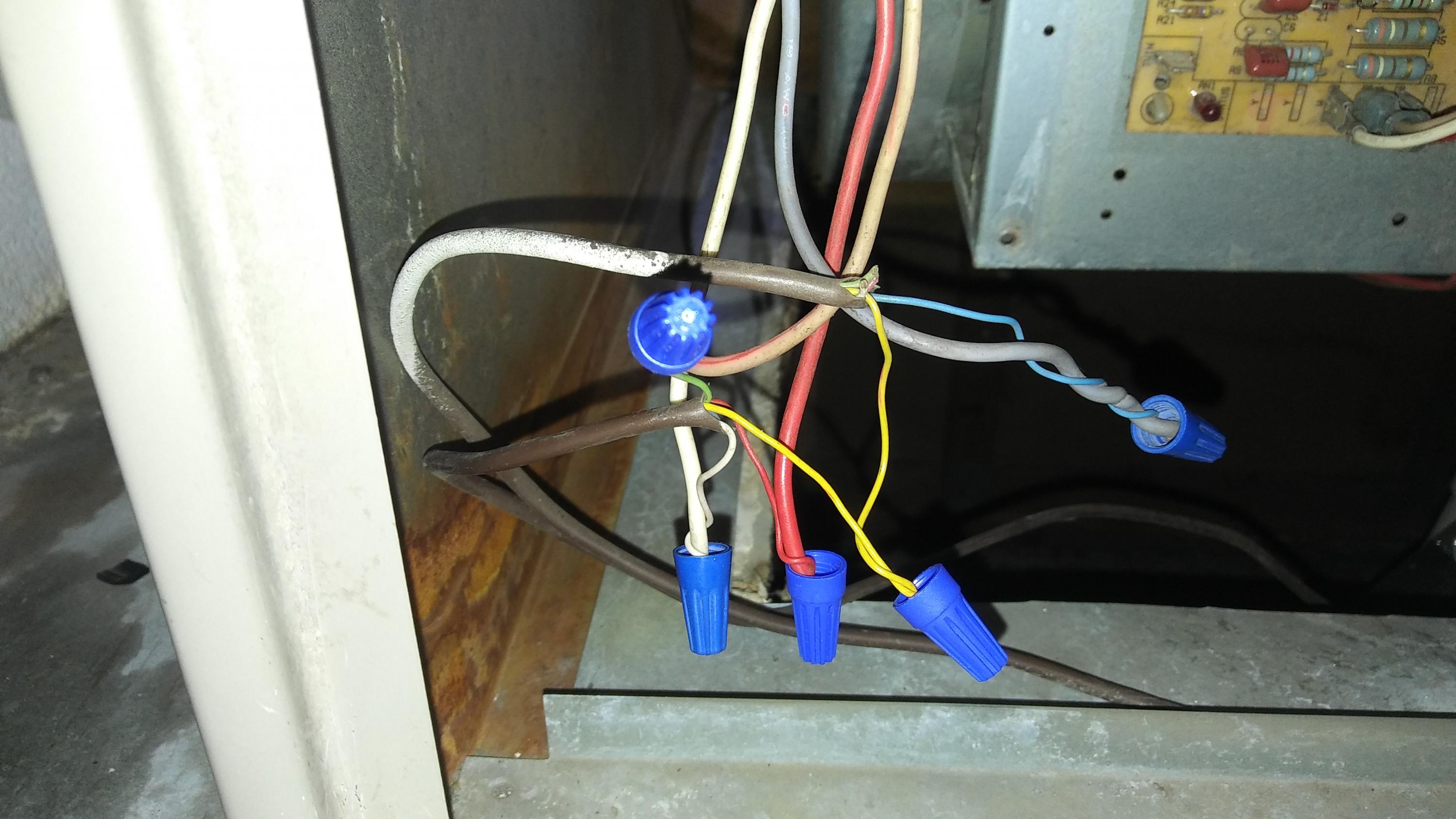

        Hello.... I think I found the problem................
        Last-night when I opened the yellow wire ( at one of the two wires cable) the fan motor no erratic run problem, still testing.
        PS: the yellow wire is for cool system, why two of them.
        Chassis GND to condenser... which condenser? in this system has four condensers, two outdoor condenser, one in the ceiling and one at top of the furnace?
        PS: Maybe I mixed up condenser with evaporator

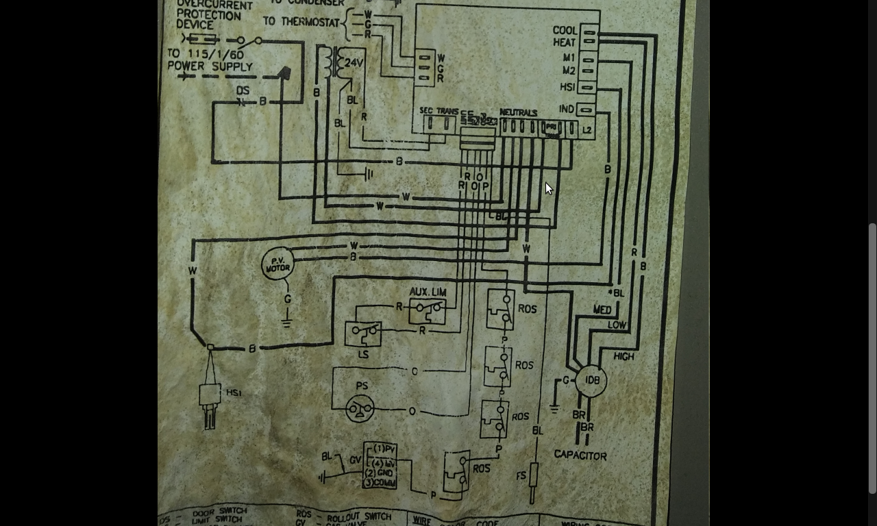

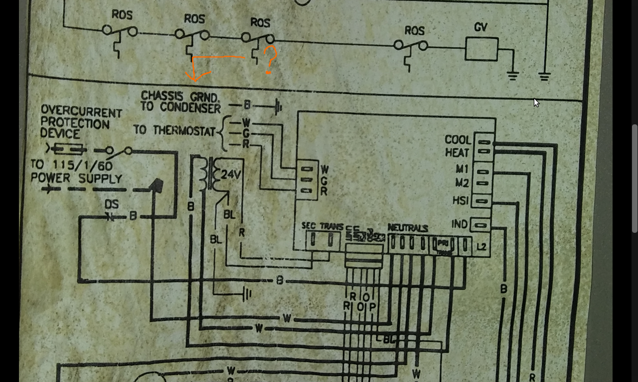

          The schematic inside the furnace panel is all you need. Difficulty here is due to incorrect assumptions. Furnace motors have multiple speeds. Fan Only mode is typically a slow speed. Heat or Cool operates at high speed. One of your lower speed windings (could be up to 5 speeds in some units) is intermittent. The fan motor itself is the problem. Go to the fan motor connections on your schematic...all the speed connections will be there along with the start capacitor, which should also be replaced regardless.
          Is it plugged in?
          • capwizard
            • Jun 2016
            • 1991
            Re: Furnace Blower Fan Cycles On/Off During the off Cycle
            "Furnace motors have multiple speeds"
            In the diagram shows IDB indoor blower has three speed LOW, MED and HIGH
            the start capacitor I've changed to a band-new one.
            PS: The Furnace work OK only problem is the blower motor run erratically?

                      Here's some clarification on your situation.
                      1. Your blower runs at high speed in A/C mode black wire to motor
                      2. Your blower runs at low speed in heat mode red wire to motor
                      1+2 - look at the schematic
                      A short in the blower motor will not cause it to turn on and off during the off cycle. During the off cycle NO power should be going to the motor, since it's turning on something on the control board is causing power to be sent to the motor.
                      You need to put a voltmeter on the control board when the blower is running when it should be off and see if it being powered from the A/C high speed or heater low speed wire.
                      Could you take a look at the blink codes again ,also when it runs the blower does it also run the inducer/power vent motor?
                      Let us know what you find and we'll take it from there.

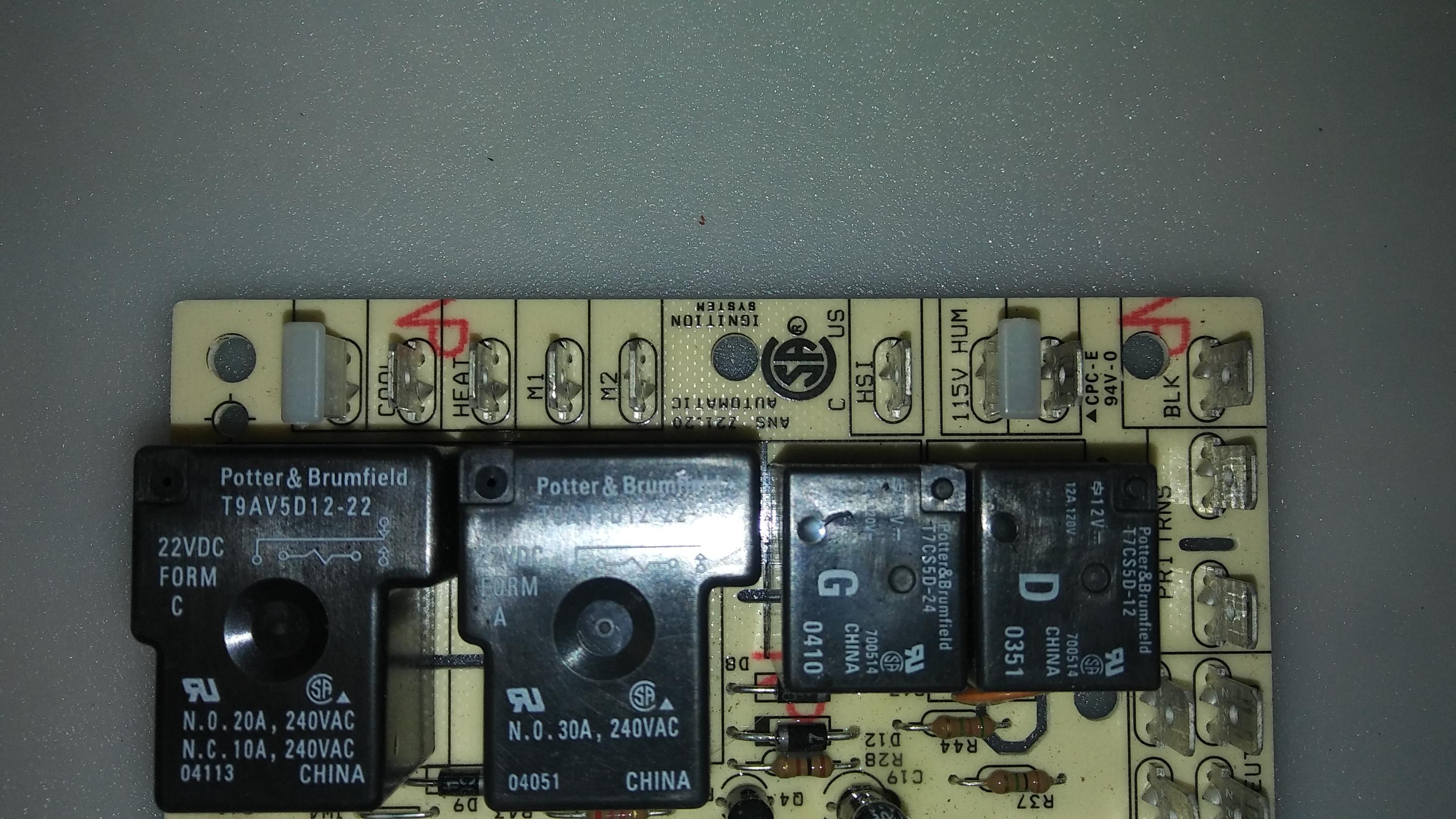

                                Everyone reading this thread needs some clarification.

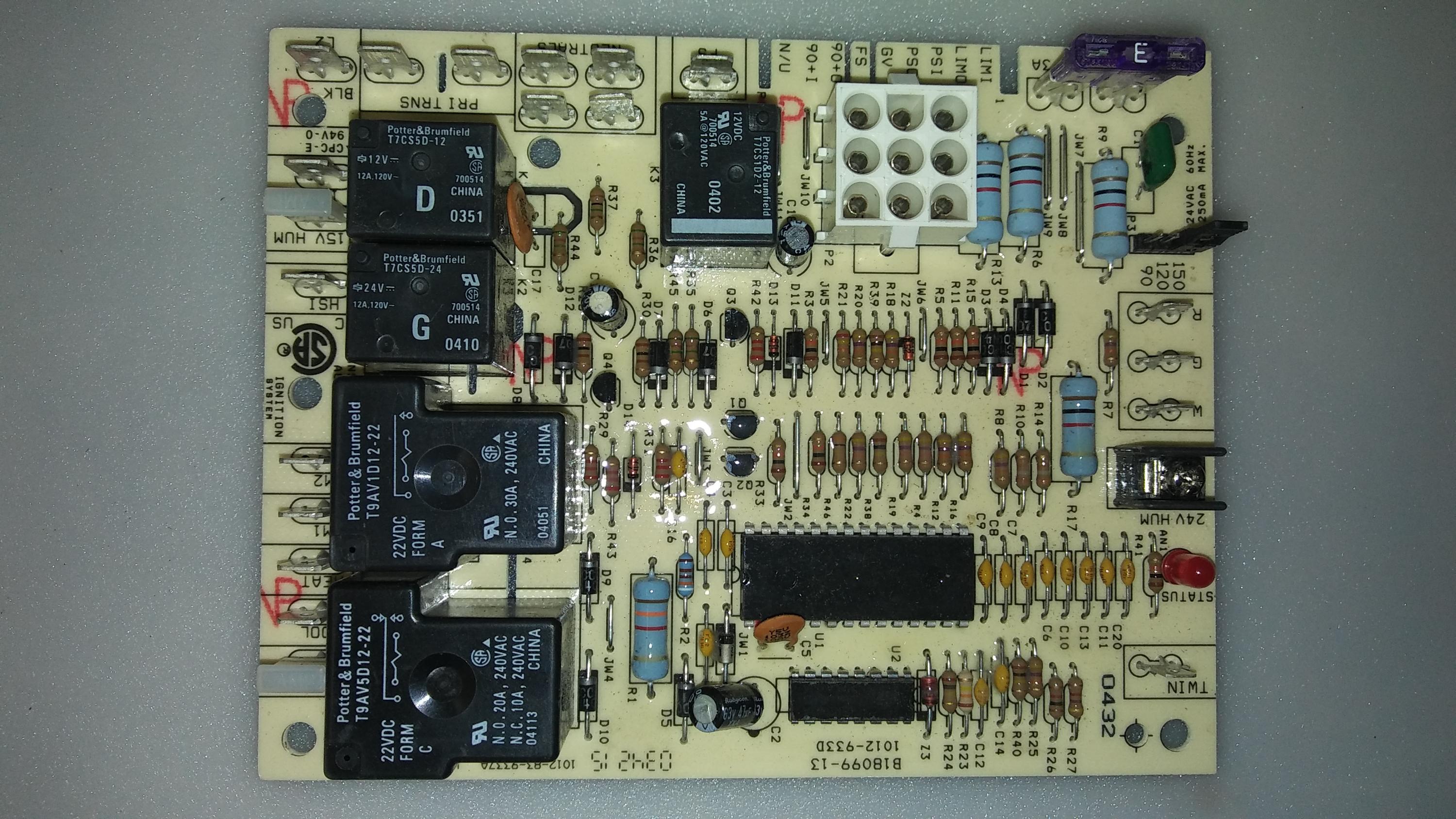

                                1. You said you changed the main board. Does the board still have blink codes or is it on without blinking?
                                It should not be blinking if the board and all the sensors are working correctly. The best way to check this is to turn off the power to the furnace and then disconnect ALL of the thermostat wires at the furnace. Turn the power back on. Light shouldn't be blinking. If it is stop here and troubleshoot the blink codes. If it isn't blinking, you can then call for heat by jumpering R to W on the control board. If the furnace calls for heat and then starts the blower without any blink codes we've verified the furnace doesn't have any major problems. Hook the thermostat back up.
                                Let us know what happened.
                                Until this is done all people can do is guess at what the problem is.
                                  Good news, the Furnace PCB comes in now, so I will do it tonight, I'm kinda nervous.
