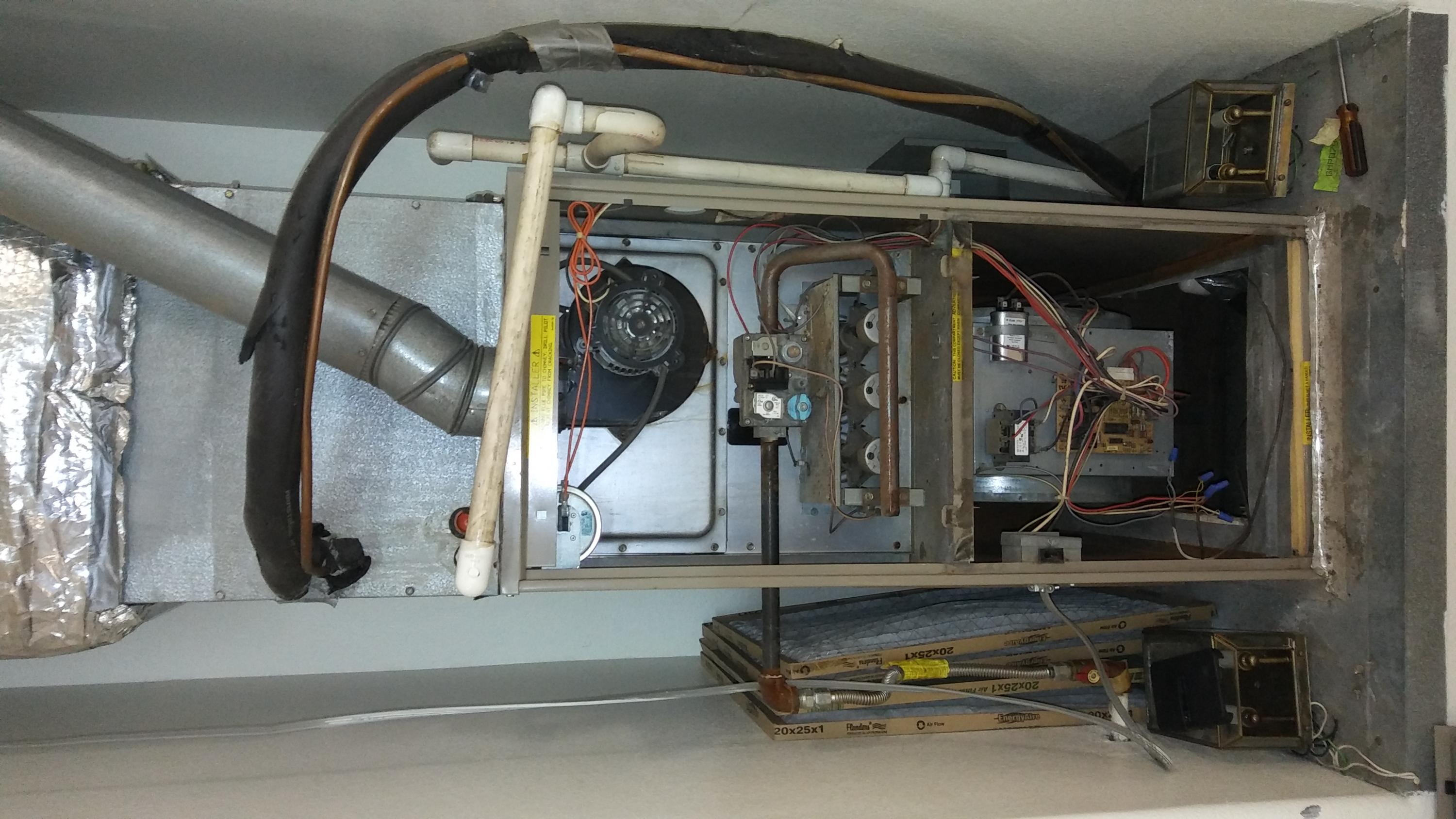

    Goodman model NO. GMP075-4 Blower Fan Motor turn on and off irregularly while the thermostatic FAN switch is at off position, error code are one blink then 4 then 5 blinks, then red LED light on constantly and fan still running will stop and on randomly, drive me crazy!!
    lastnight Id spend over three hours to troubleshooting, did everything this video said, its not thermostatics, its not the cables, its not sensors, I bypass fan limit switch, cleaned the air filter, same thing happened, so I order the PCB B1809913S, will update!..Any Helps ?........................
    PS: Goodman B13709-08 limit switch tested on 0.4 Ohm should be ok, cleaned flame sensor still the same.
    PS: the furnace gas fire up and work normally.

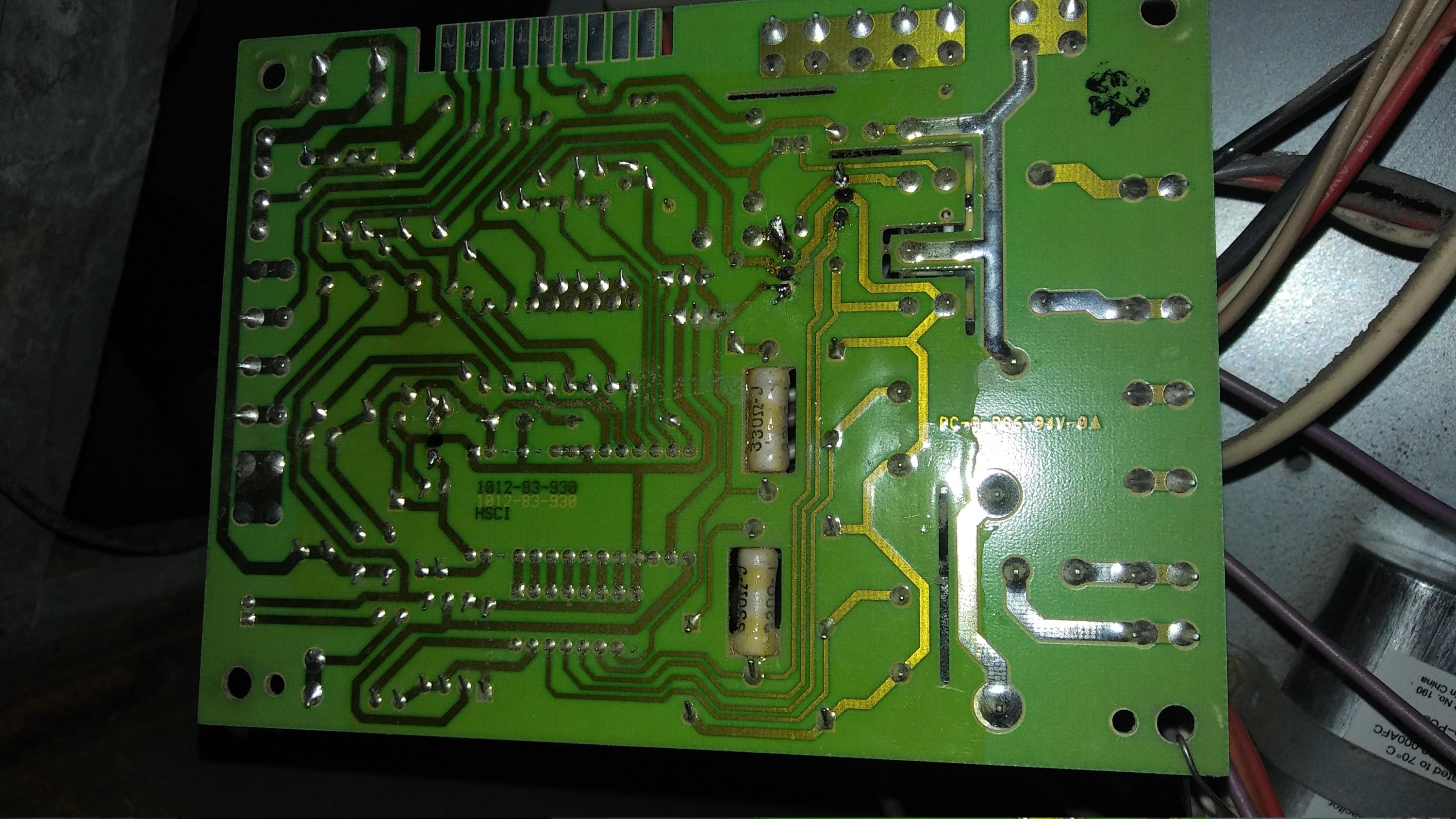

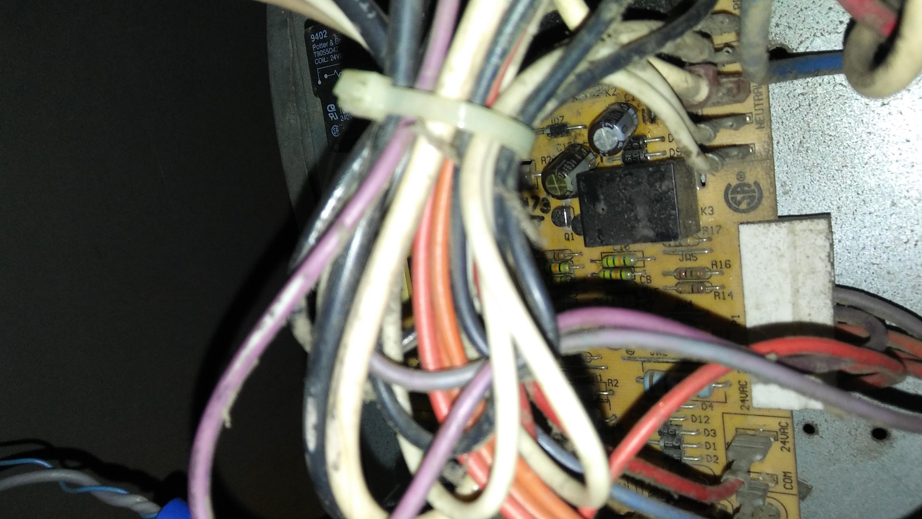

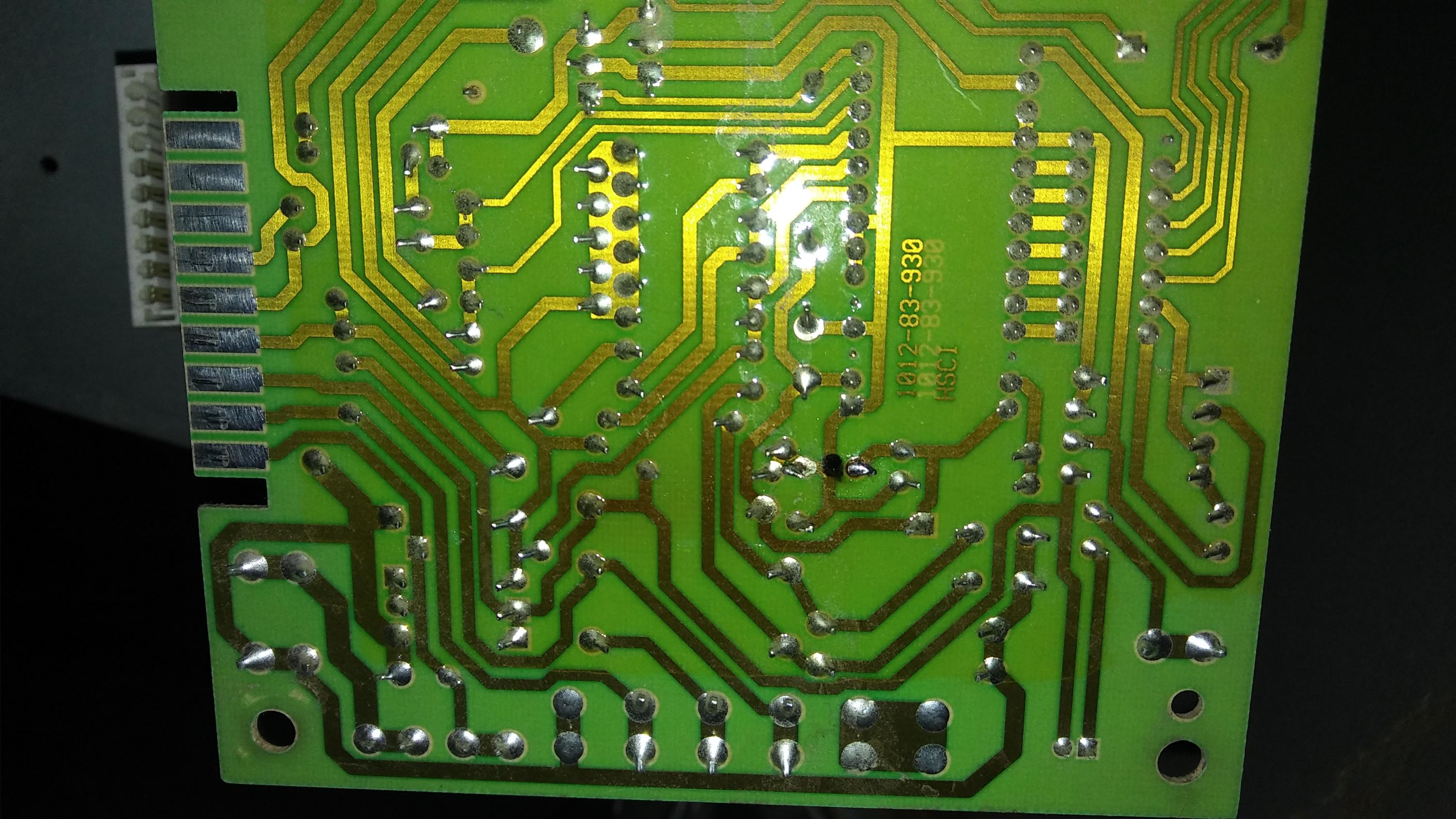

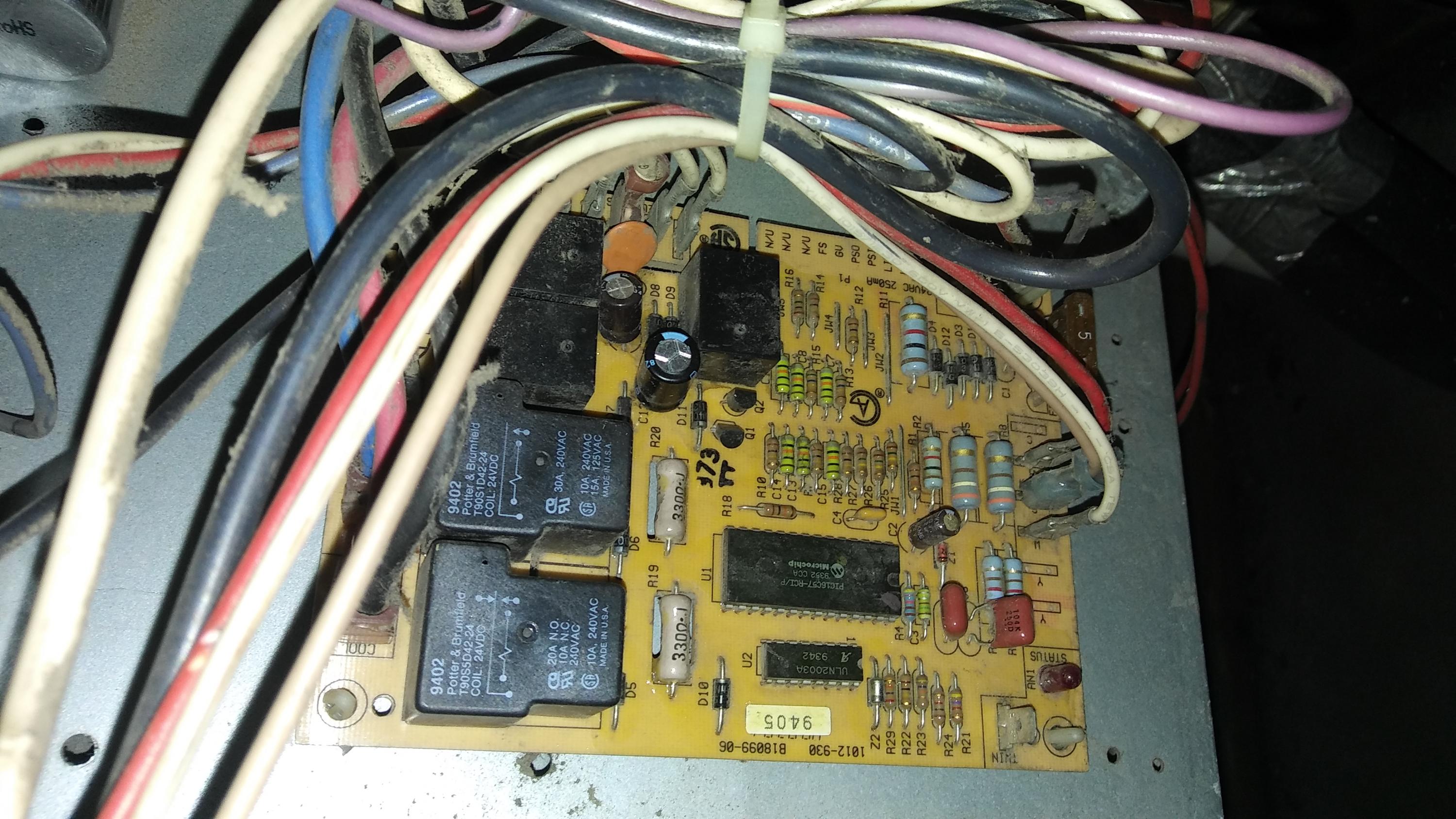

    so what does the pcb look like?
    in my experience, boiler control pcb's often suffer from cooked caps or cracked solder joints.
    it's because or the enviroment they are in.

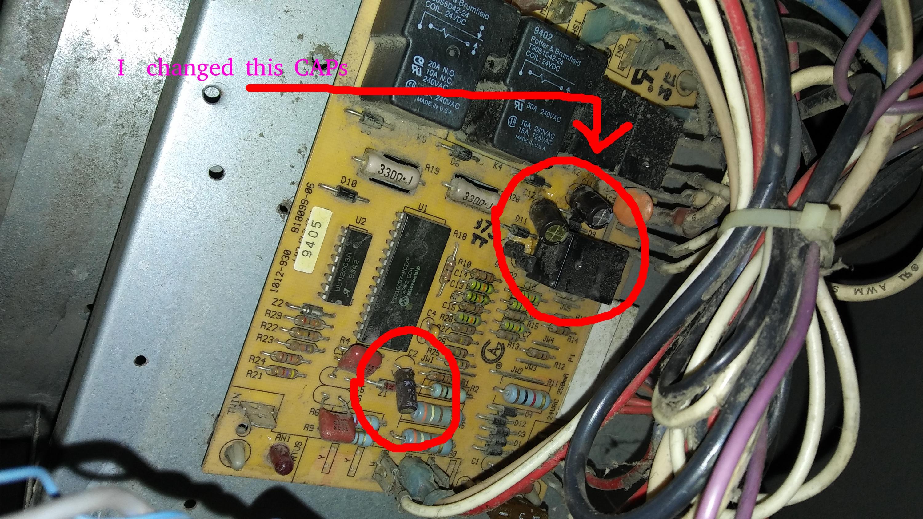

      Re: Furnace Blower Fan Cycles On/Off During the off Cycle

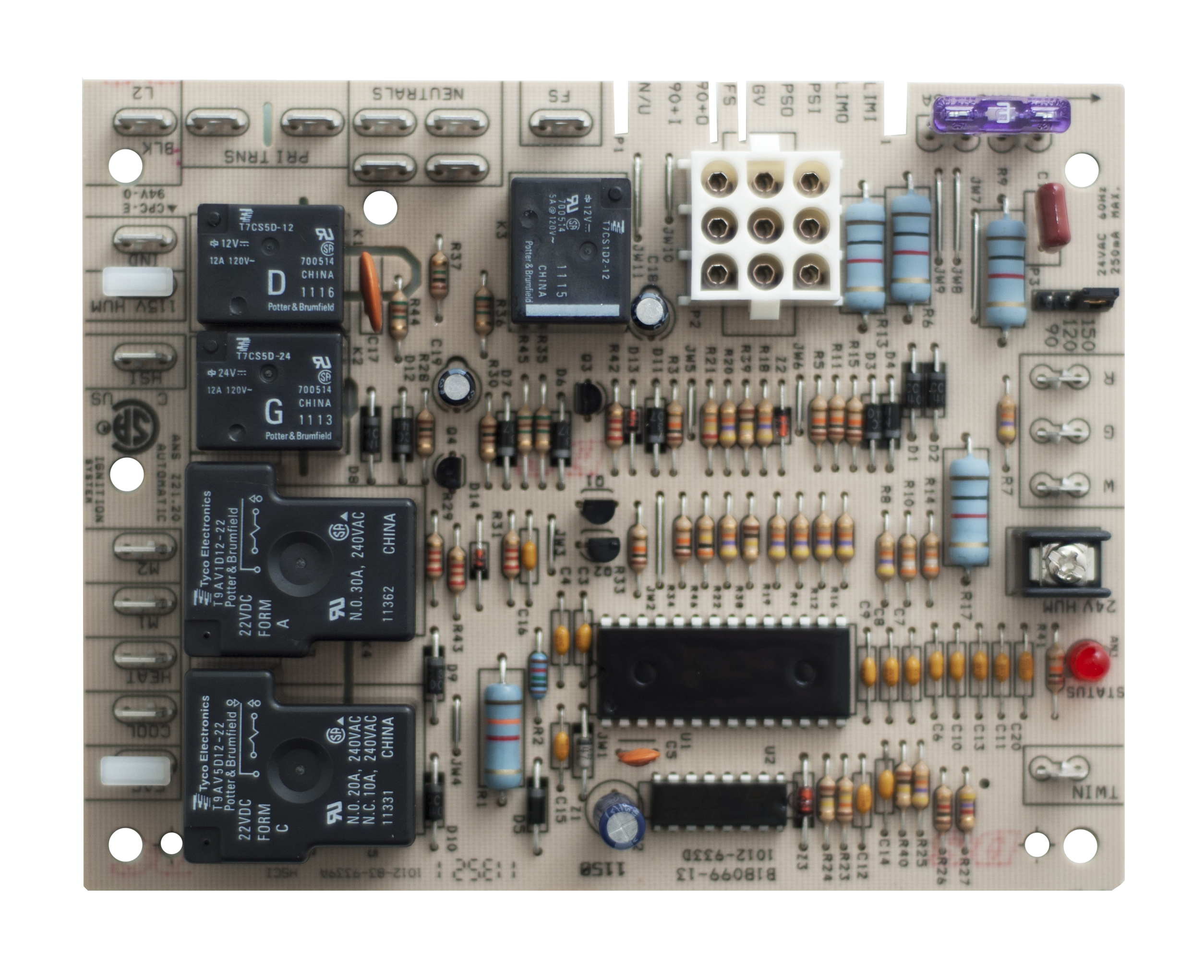

      Three caps ESR tested good but I still changed one, the back has glue on it same as car's PCB, I hate that. no backside picture of PCB because I thought it's not gonna be the PCB.......
      I ordered this PCB.......Circuit Board — B1809913S Goodman/Janitrol Furnace Control Board
      This is a guaranteed genuine Goodman OEM replacement circuit control board for several Goodman, Amana, and Janitrol units. All of our parts are shipped factory direct, giving you the assurance you need for a quality replacement on your furnace, air conditioning condensing unit, or other Goodman product. The B1809913S replaces outdated part numbers B1809908, B1809906S, B1809908S, B1809910, B1809913, DB1809906S, DB1809907, DB1809908S, DB18099013, and 1809913S.

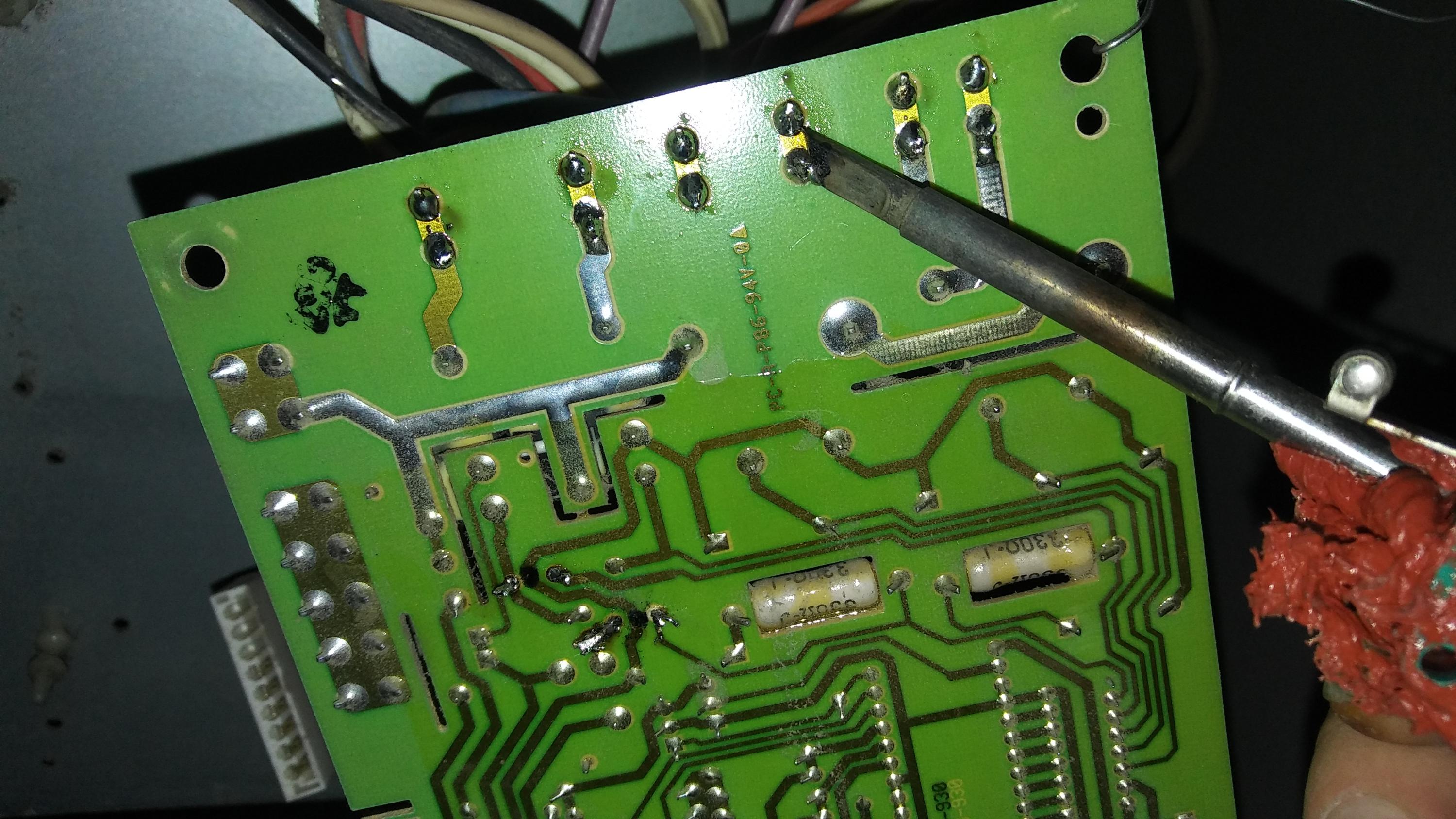

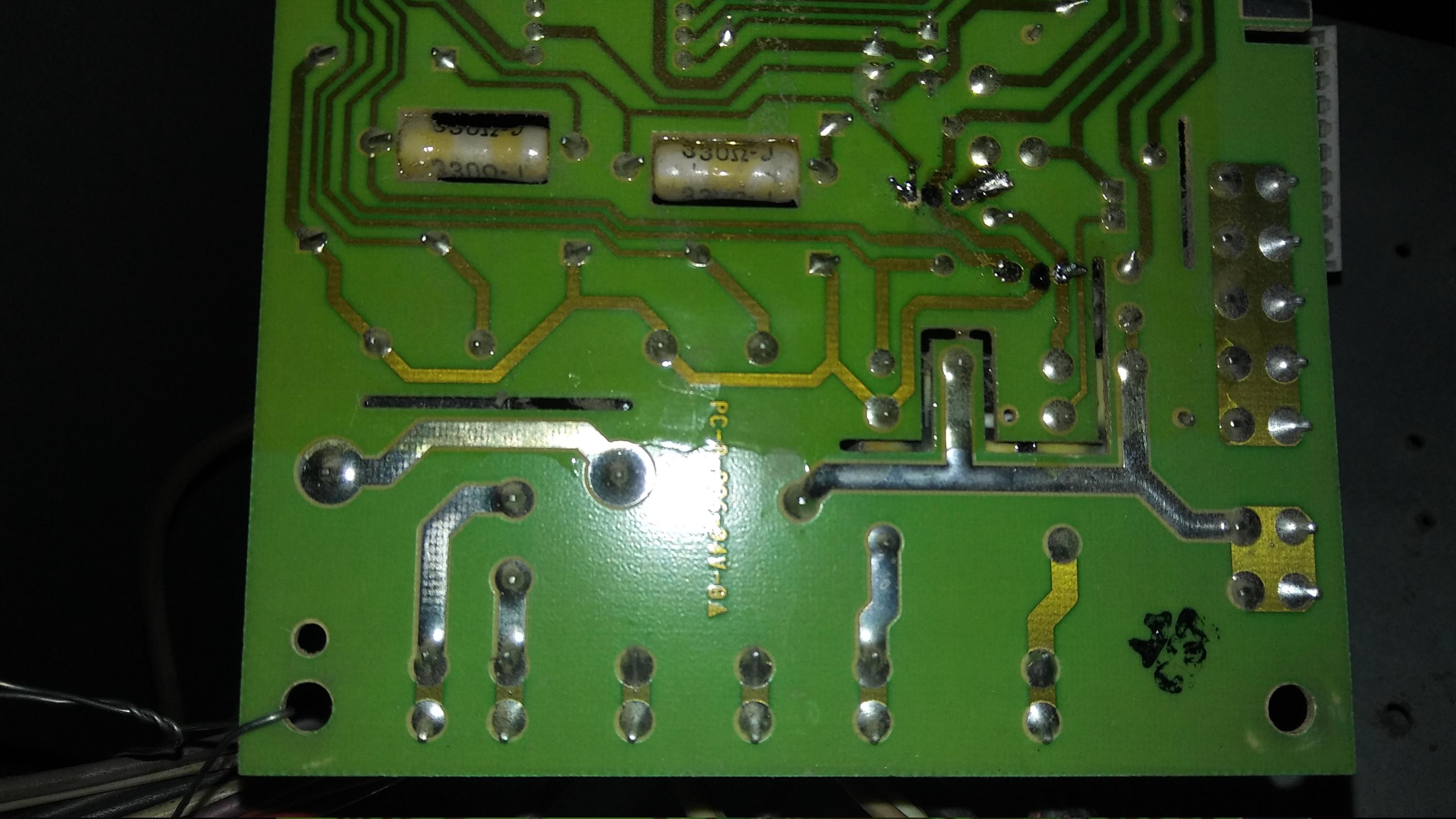

        well the soldering on the relays & spade connector tabs is all under stress.

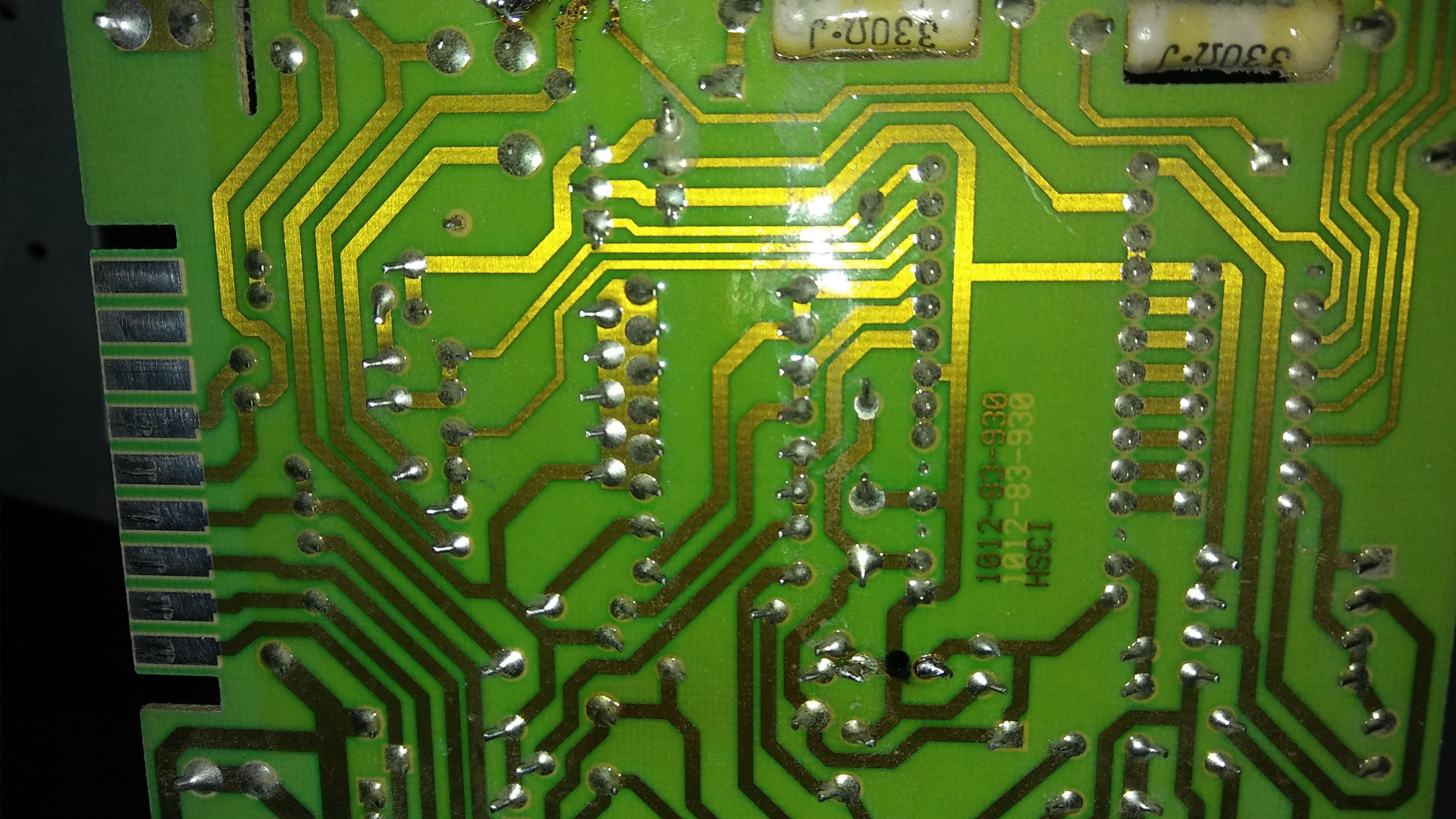

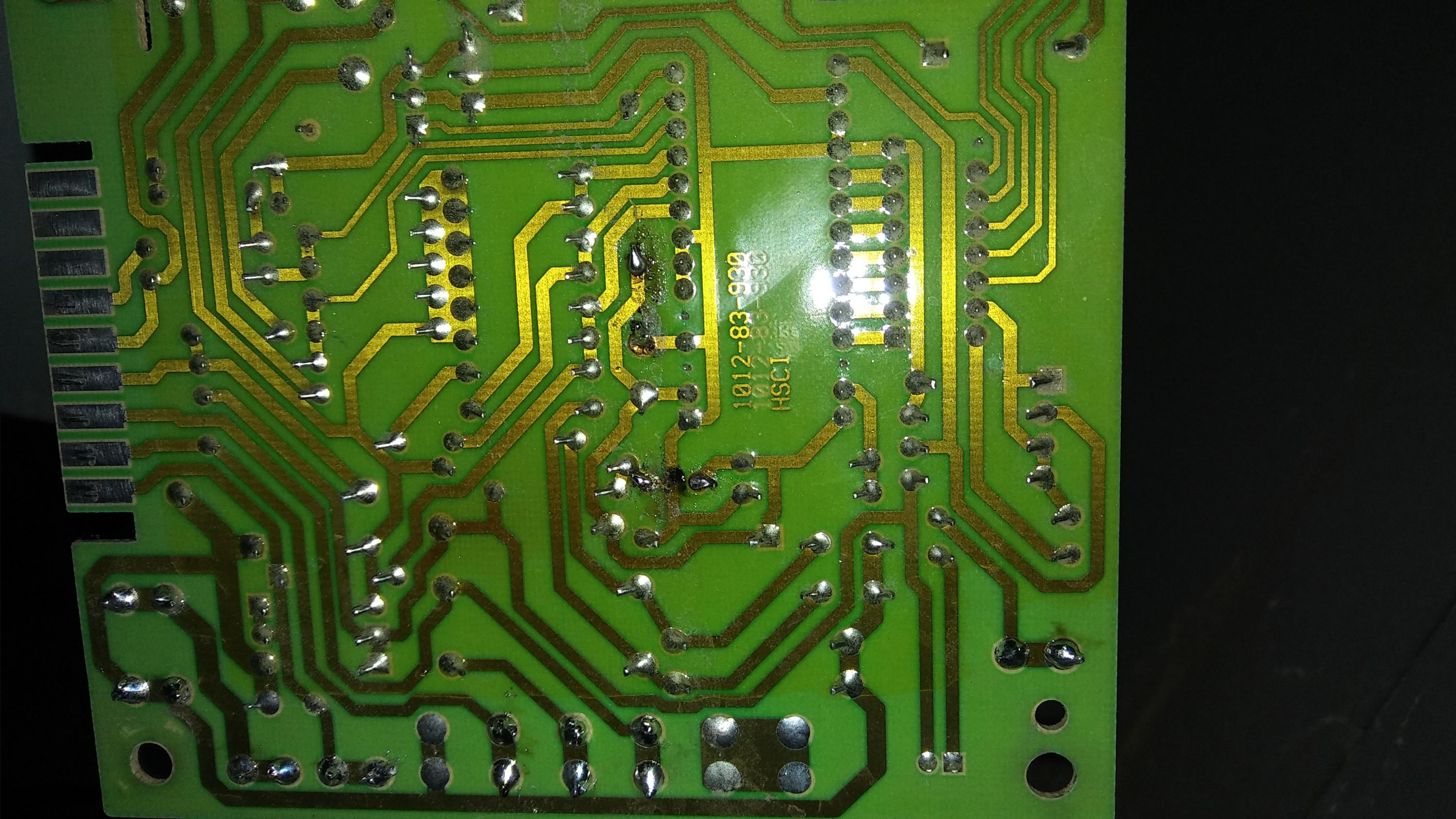

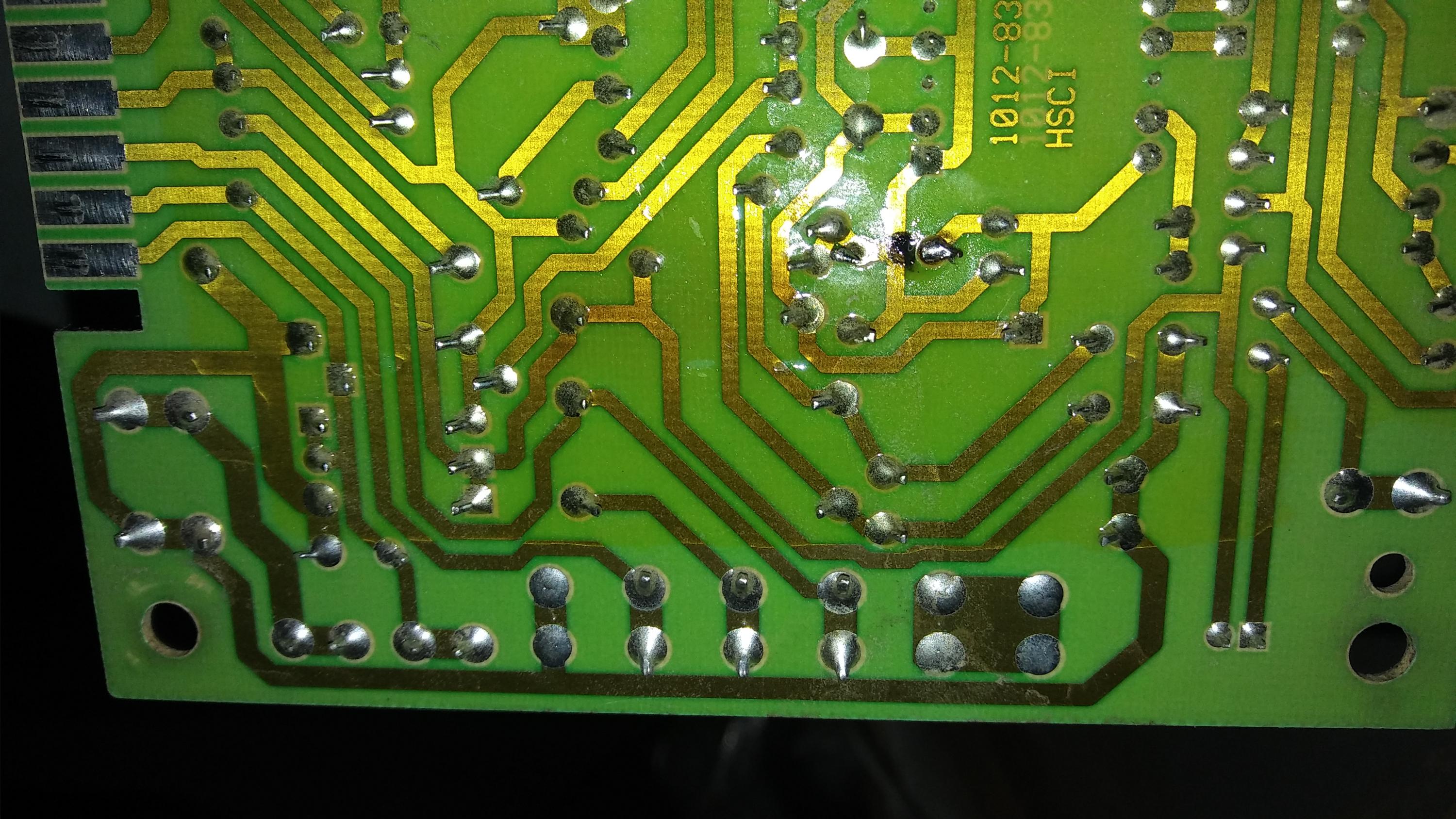

          Most of the time these board are repairable most of the time it is bad soldiering joint that are bad or bad relays I would also replace the caps as well

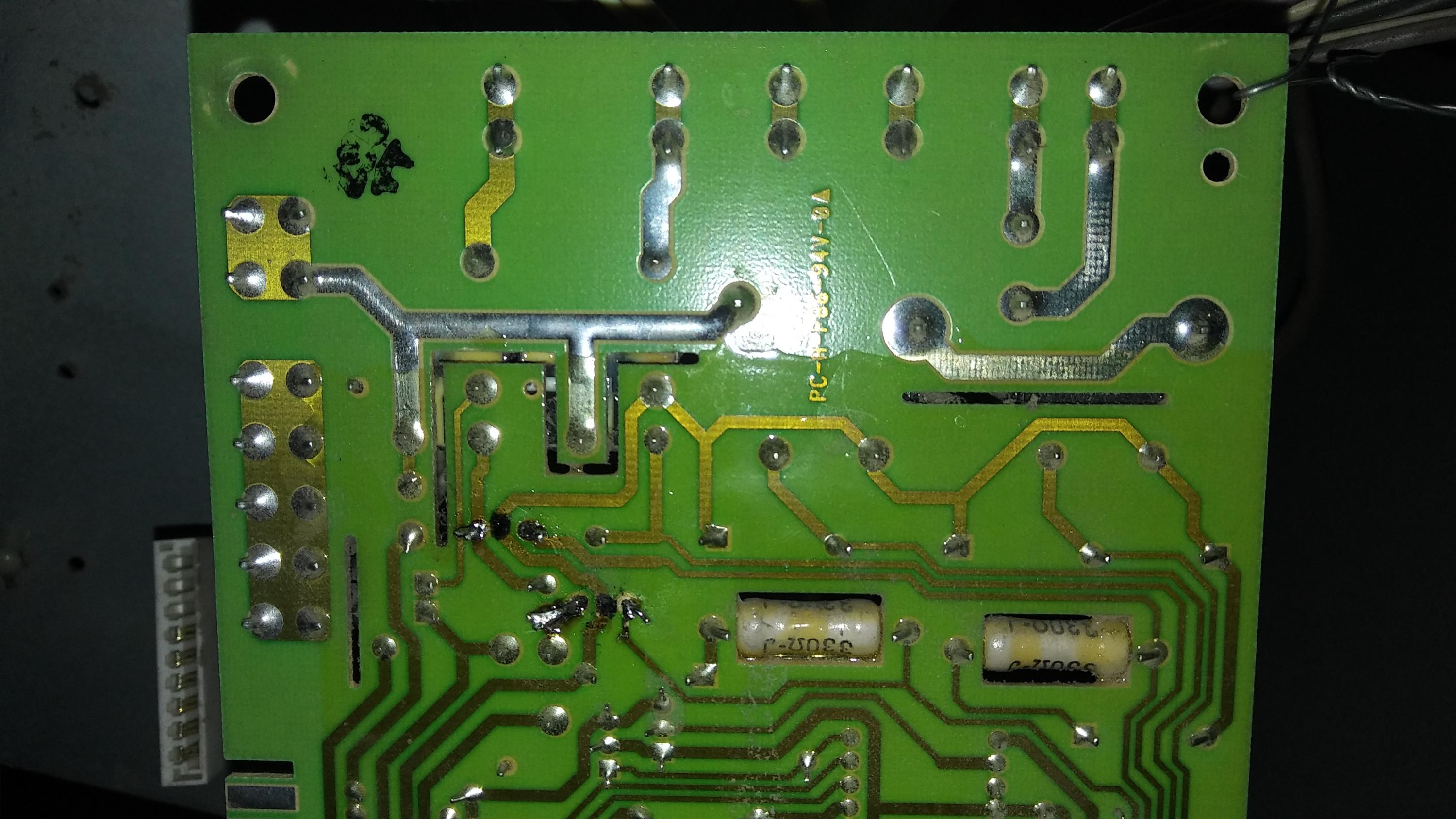

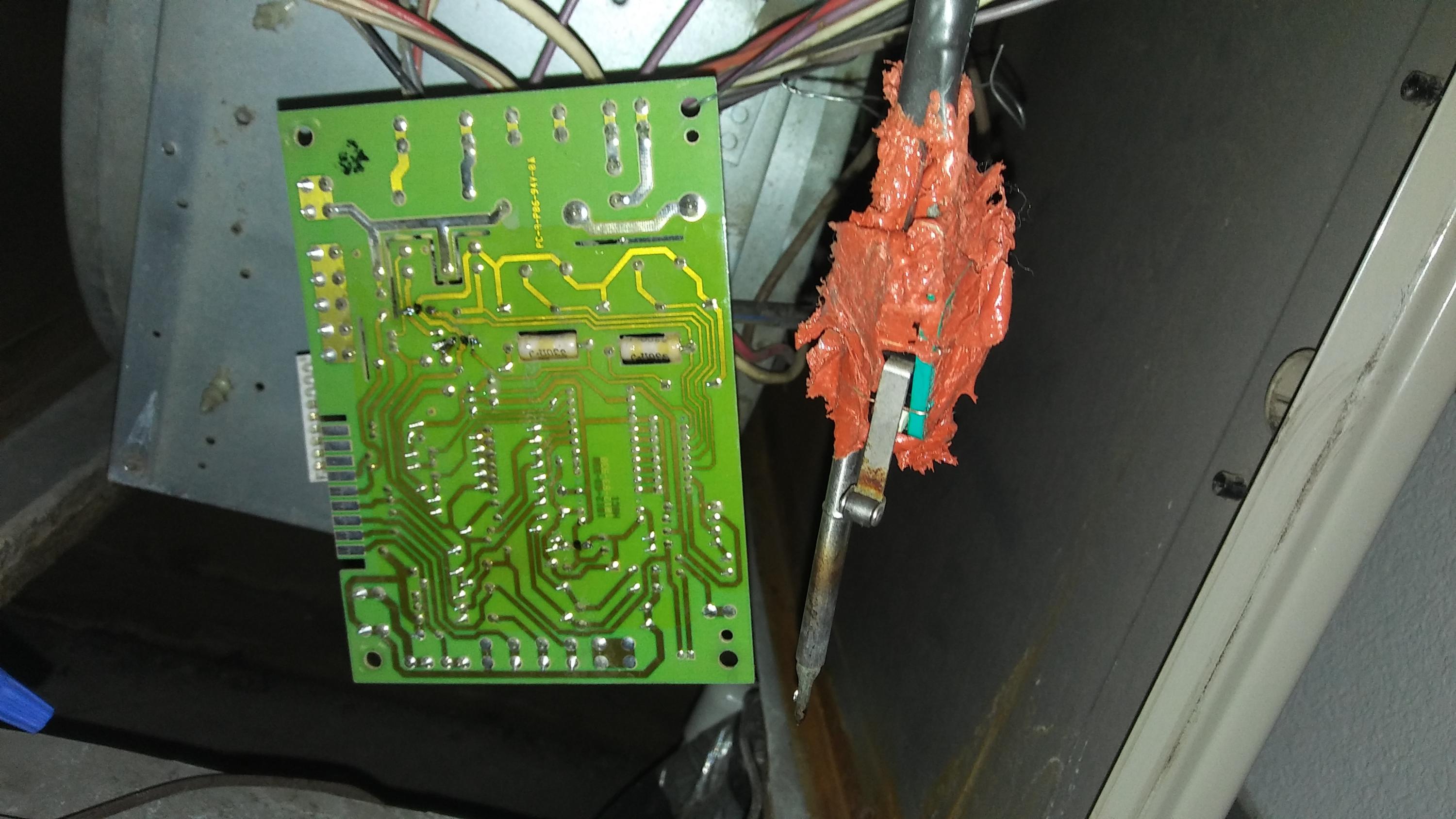

            Thank you will go back and check the soldering. How can I get rid of that semi-transparent glues?
              • 31296
              try white spirit first, that melts the wax-polymer type.
              if that wont work, see if the soldering iron will break it up.
              DONT try this first, if it is wax-polymer then it will mess up the iron like hotglue!

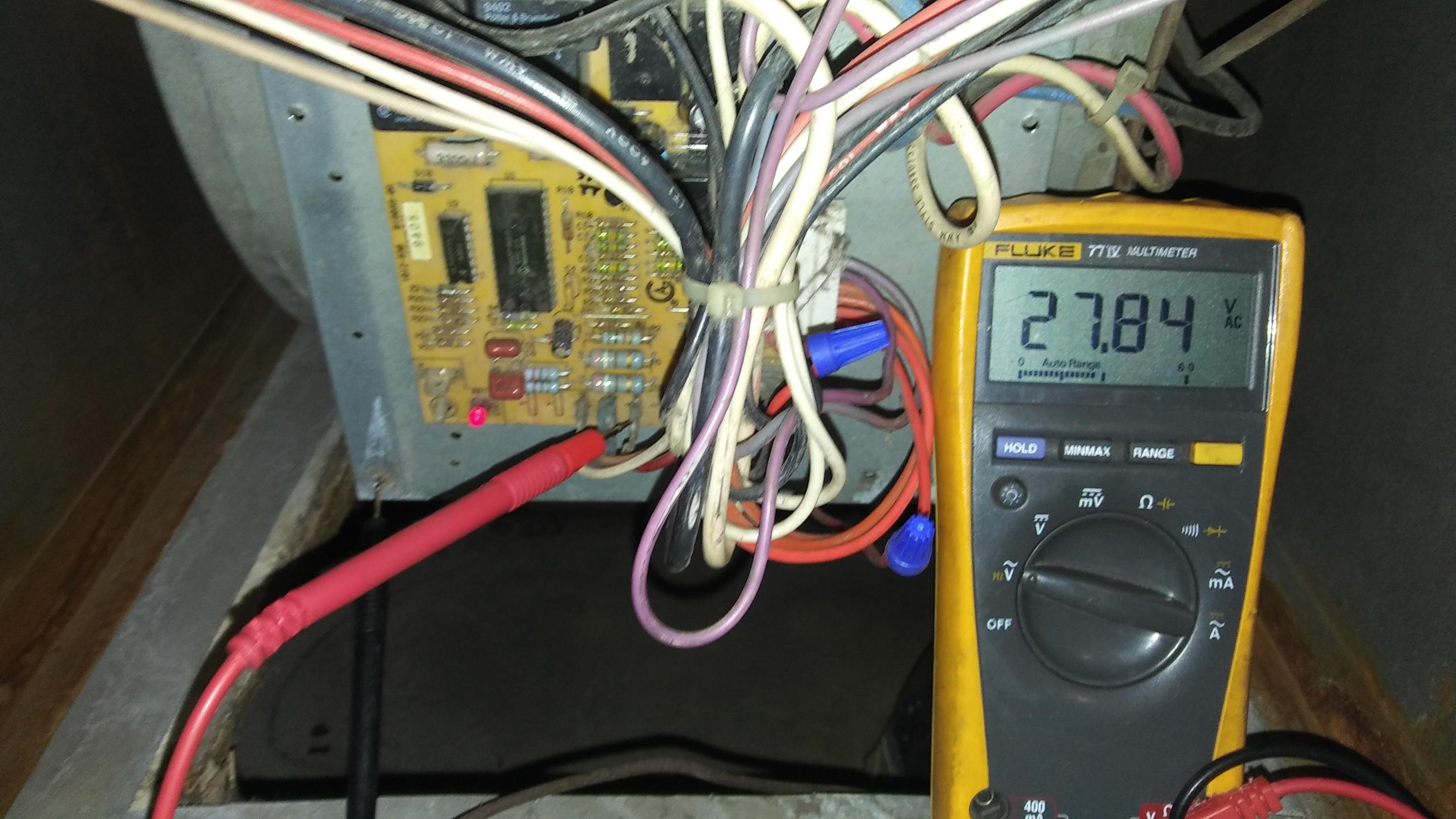

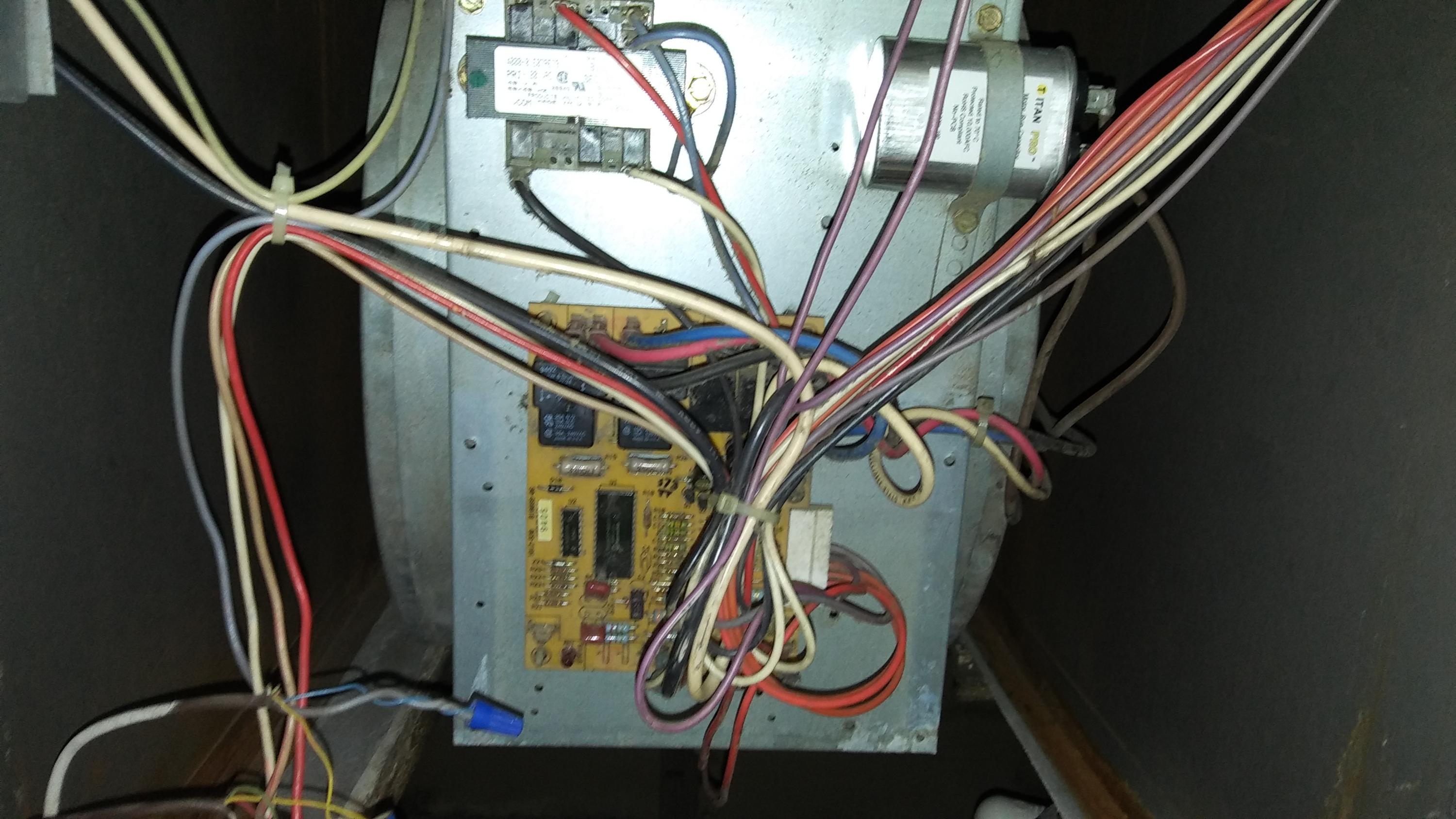

                  After did bad connectors correction, till has the same situation.
                  What happen change NEW PCB still the same, this unit is A cool and Hot central unit, Is that possible, the signal from cooler keep give dirty filters or high humidity error signals to confused the PCB to blow the fan???................
                  Pic 11 : is that normal cheeses ground to AC hot shows AC 27 V ?

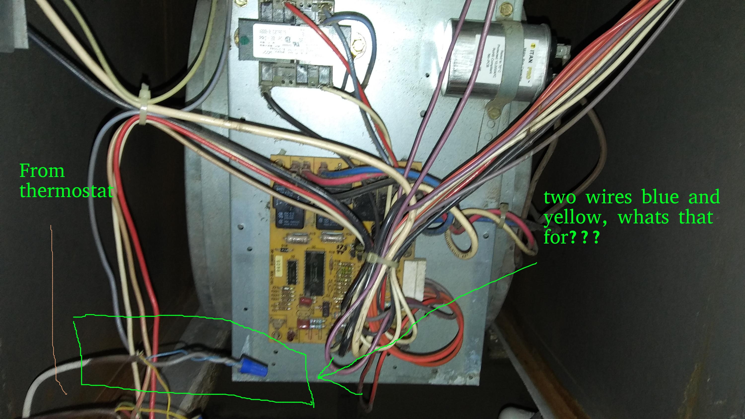

                    There has A blue and yellow wire, what is that? Maybe the one gave fault signal?
                      hot and neutral are maybe swapped at some point or simple bad connection . is that line voltage you are measuring ?
                      27v on neutral is pretty high if that is so .
                      check supply is good order .
                        It is the thermostat red wire AC 27v to chassis ground. Sorry Im must be hungry #9 type to cheese ground.

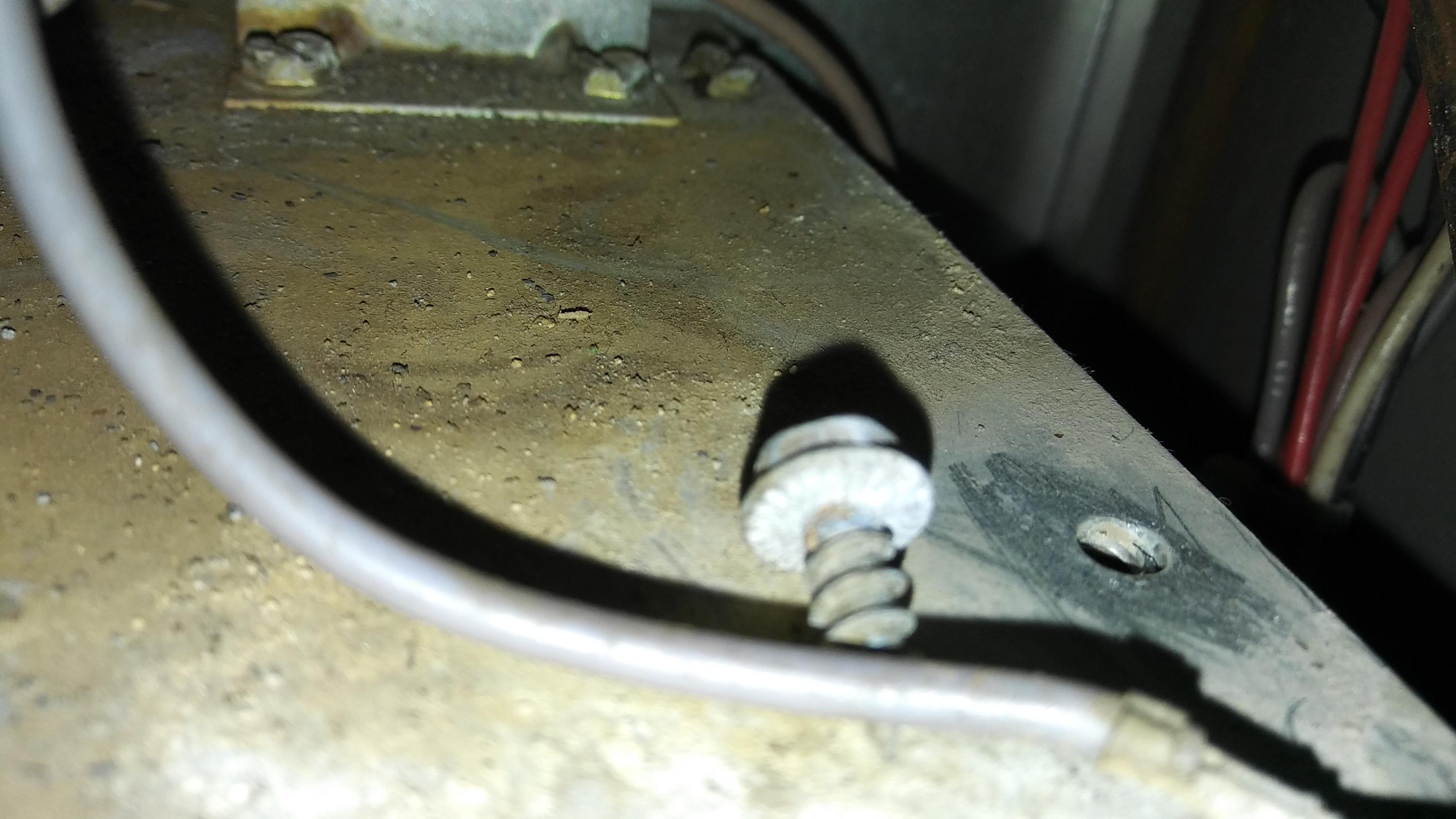

                                      • capwizard
                                        • Jun 2016
                                        • 1991
                                        Thank you, I did exactly the same test as this guy doing.
                                        Blower Fan Motor Won't Shut off!- STEP by STEP Troubleshooting!
                                        https://www.youtube.com/watch?v=fxRB4MVFOuo&t=451sodman

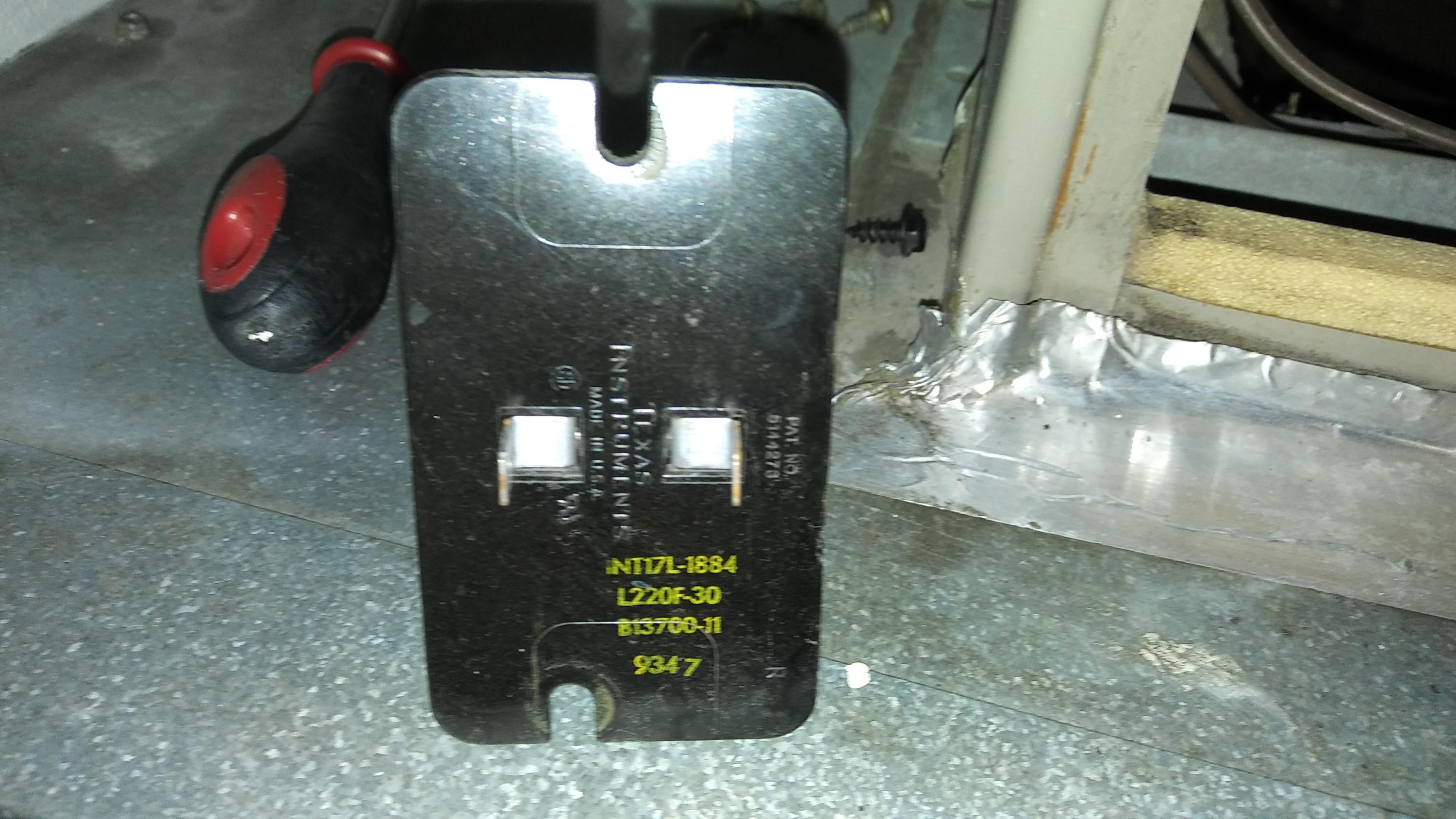

                                        in the picture I clean the ground point of Flame Roll Out Switches.
