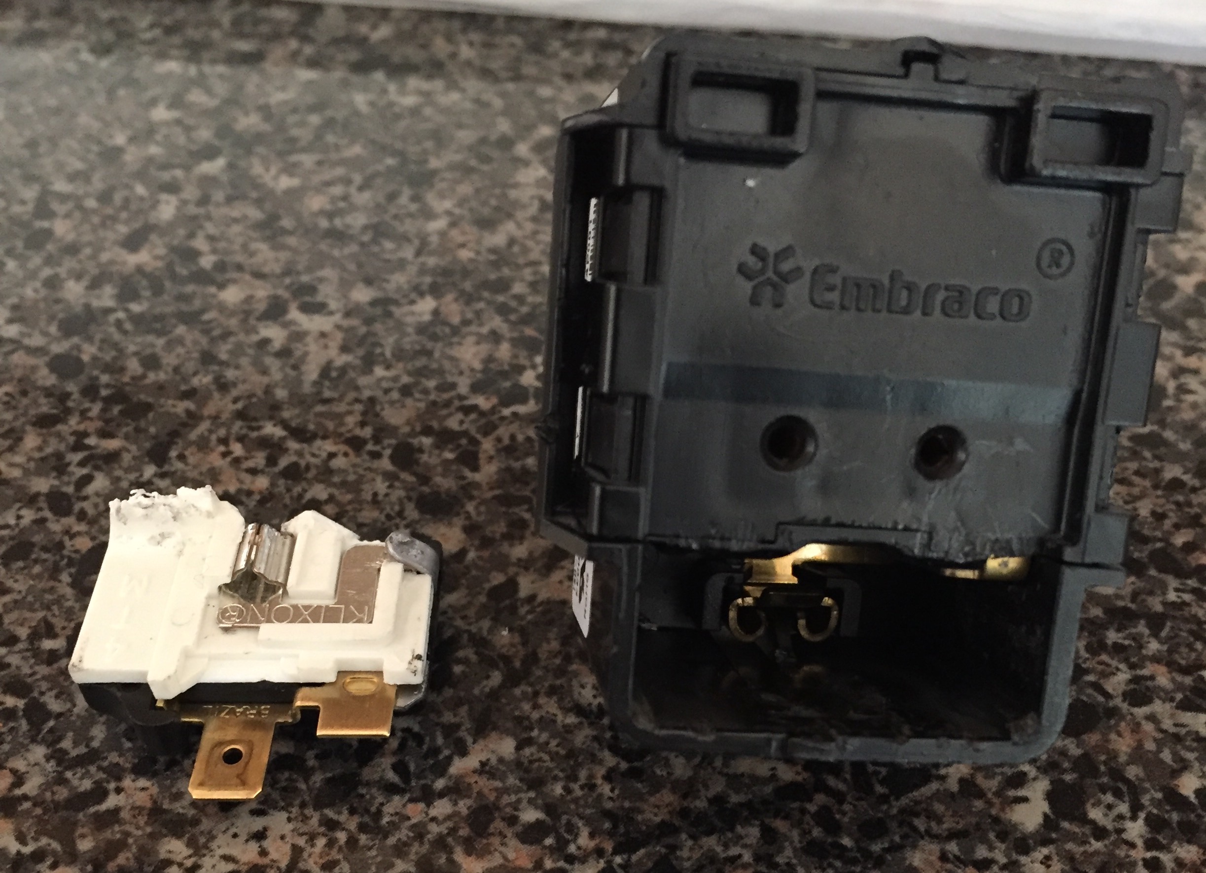

          Wait a minute. I think I'm getting lost in terminology.
          Is the "overload protector" different than the "relay"?
          If so then the circuit board would be the "relay" that gets the compressor started/running and the overload is separate and opens ONLY if the compressor draws too much current but otherwise stays closed allowing electricity through?
          Here is the overload (left) which is connected in series with L and the circuit board "relay" on the right.
          If so then the clicking I was hearing must be the overload. So maybe the compressor is shorted internally even though both start and run windings measure fine

            Unless you are referring to a capacitor not shown in the pics, neither of the capacitor's on the board are motor start caps. The pcb's role looks to be an electronic alternative to either a relay or ptc start device and probably provides a soft energise for the start winding's plus some basic protection. I would tend to share the previous posters view that the rotor has probably seized
                Yes I was confusing the overload (white device on left in previous pic) for the PTC/relay. So when it was "clicking" I thought that was normal as in clicking off the start winding.
                Now it makes sense it was working as intended due to the motor not turning and drawing an excess of current.
                If the rotor is locked, could I try hitting it with a rubber mallet to see if it'll get going or?

                                  Thanks. Still unsure how exactly the circuit works as a relay. What triggers the gate of the triac on/off?
                                        So the hot side should be connected to the over-voltage protection. I actually do not think it is actually over-voltage I think it really is and over current. I believe that this will pop out and has to be manually reset.

                                          I think we are looking at it wrong. The PTC is connected to the neutral line and the run winding is also connected to the neutral line. If you connect the hot side of the line to the over-voltage protection then to the hot side of the compressor. and left off the connector on the other two line. Then measure those connections on the compressor to neutral you should read 120V. I believe the PTC Shorts out the run capacitor and when open it uses the capacitor. I believe that whole board is to shift the phase of the start winding from the run winding. Once the motor starts it must use that circuit along with the run cap for efficiency of the motor by helping the run winding. You should be able to measure across the run cap with no power applied and get less than 1 ohm.
