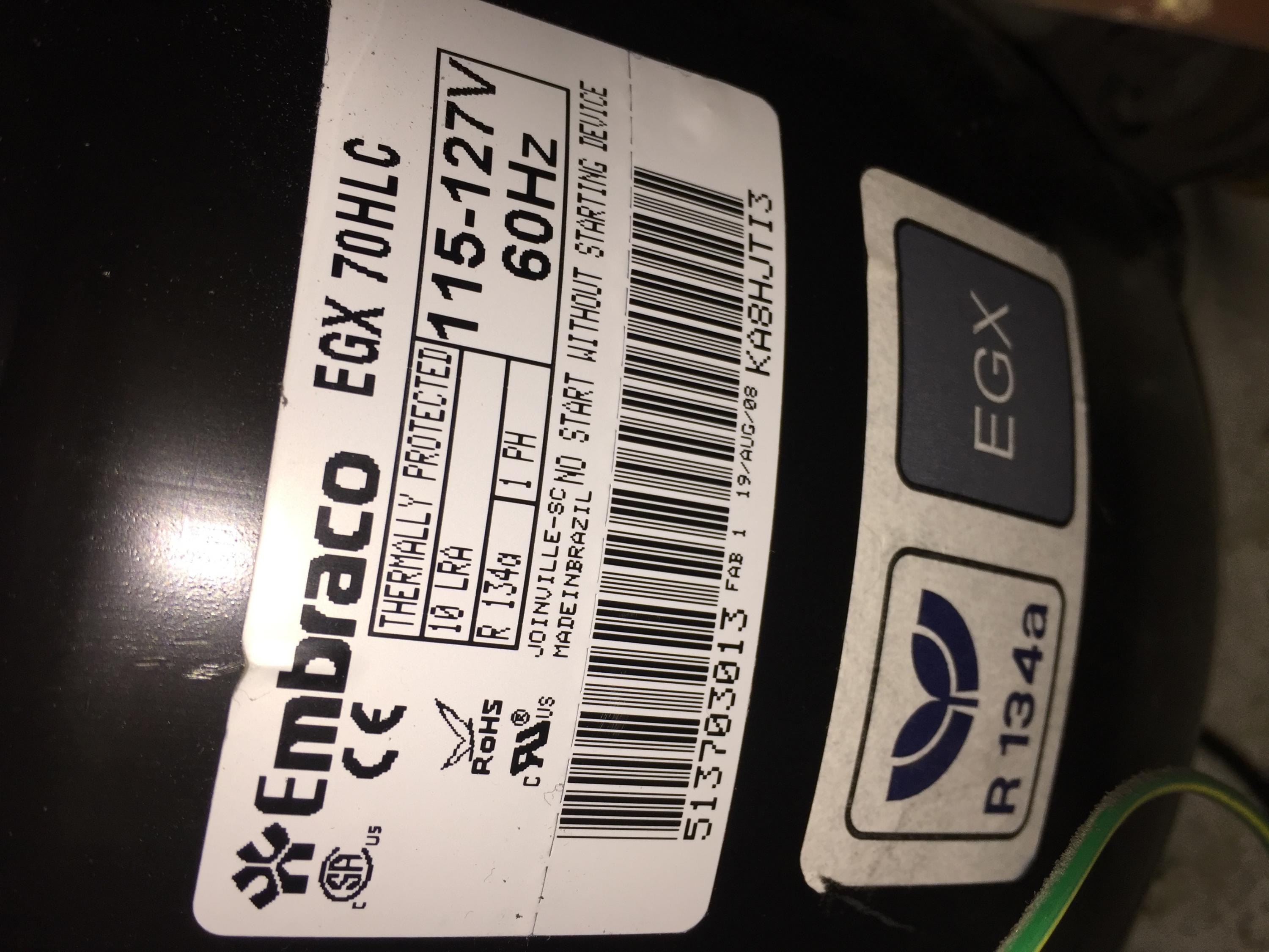

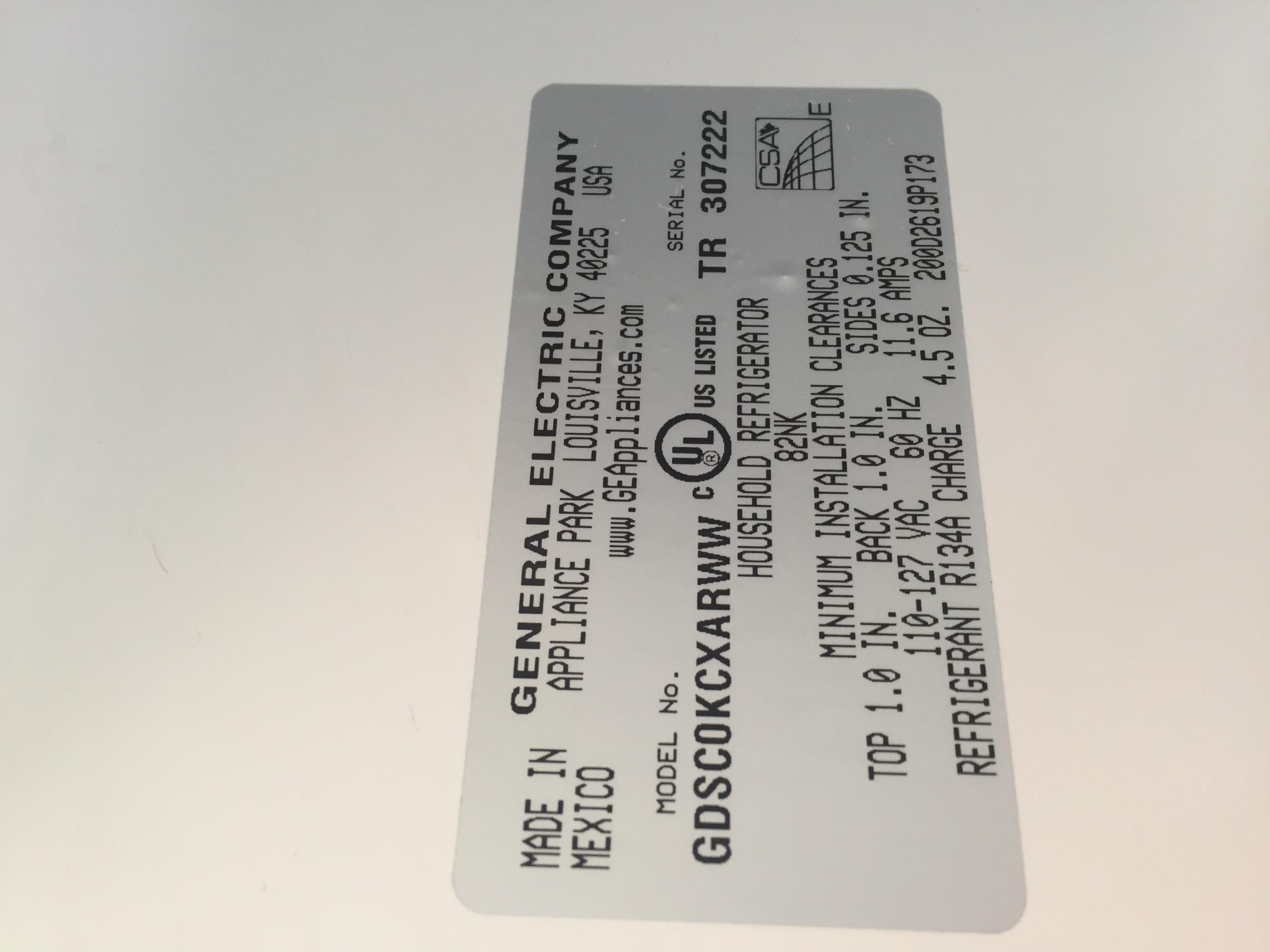

    Anyone have troubleshooting knowledge of refrigerators?
    My GE refrigerator model# GDSC0KCXARWW stopped cooling. It's a bottom freezer refrigerator.
    Both evap and condenser fans run. I do not hear the compressor. Hear an occasional click sound I think coming from the sold-state relay.
    I've ohm tested the 3 prongs on the compressor, one way reads 5 ohms the other 7 ohms and third way a total of them at 12 ohms. No continuity when when testing to chassis of compressor so it's not showing any shorts.
    With the relay disconnected and probing at bottom common connector with negative lead of volt meter, I get 40v on the start terminal that slowly tapers down and a consistent 115v on the run terminal.
    Is that normal run voltage or should it be higher? Trying to determine if the relay/overload is working properly. It does rattle when shaking but I'm not sure if that test is feasible for a sold state relay or not.

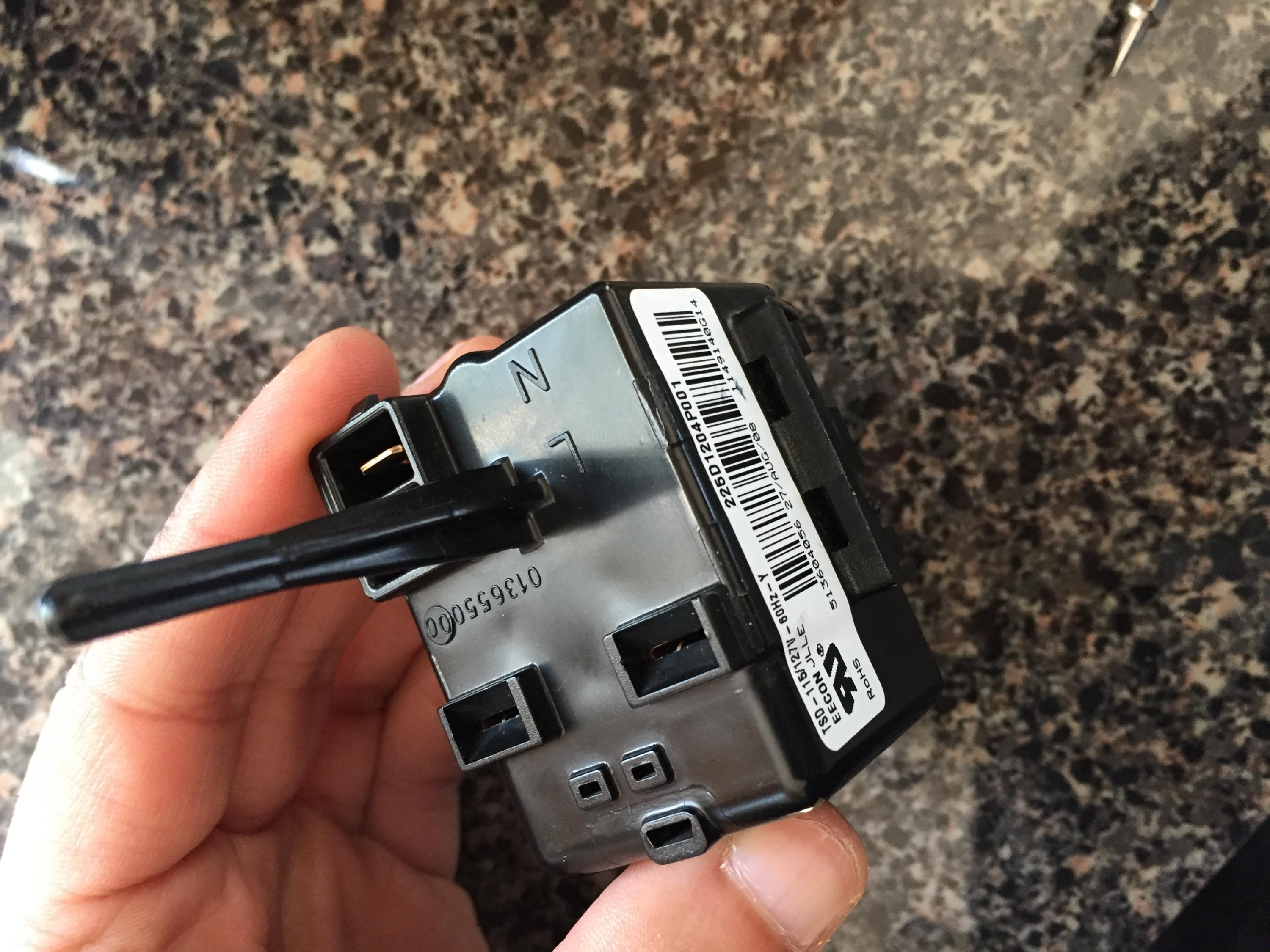

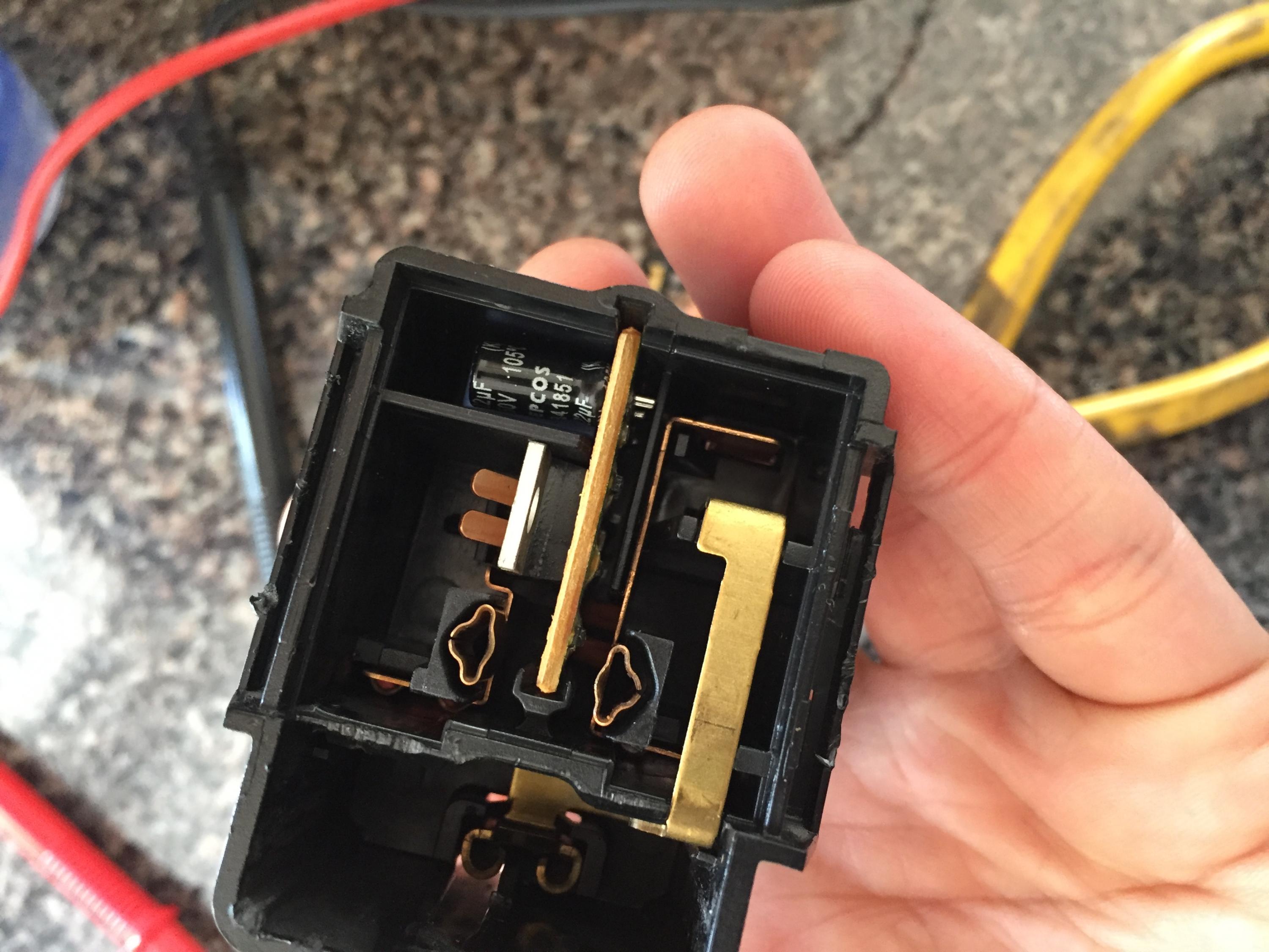

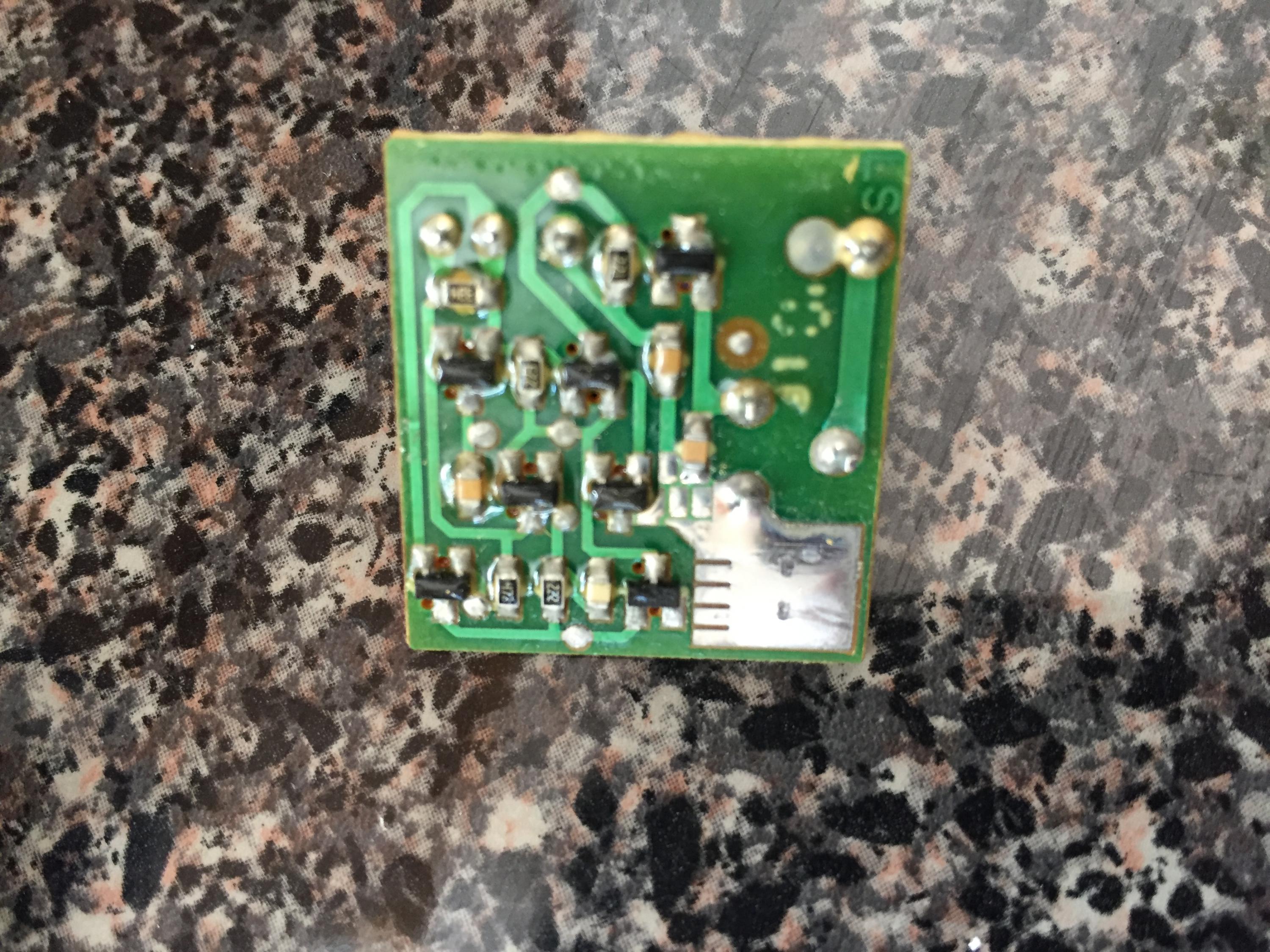

          Re: Anyone have troubleshooting knowledge of refrigerators?
          I don't see a wiring diagram. Here's the relay (cap removed) and the circuit board. Not shown is the overload which is a PTC type that uses a metal button that springs up disconnecting the contact.
          The overload is tied directly to the Line terminal and the capacitor and circuit board are connected through the Neutral terminal. I'm wondering if the resistance of the overload has gone up causing the drop in voltage on the start line or if the triac is failing causing the voltage drop?

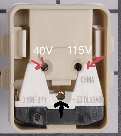

              My thing is the start terminal of the relay only getting 40v. Shouldn't it be 120v as well as the run circuit?
              Does anyone know how this solid state relay works? It looks like line and neutral are only wires connected to it so what's triggering the gate of the triac?
                    @keeney yes that's my understanding too but that circuit board with the triac still doesn't make sense because only those smd components underneath connect to the gate and they aren't linked back to the main control inside the fridge. So is the main 120v fed to the gate as well through the smd components as a trigger to turn on?
                        I believe the main 120 volt connects to the defrost circuit. If the refrig is in defrost it will not apply 120 volt to the compressor. It takes 30 minutes for defrost. What is the number on the triac. We can look the specs up and find out real fast. What they can do with a gate circuit is put a resistor in the gate which lowers the voltage and current going to the gate and still have the 120 volts on the drain and source. These would be two parallel circuits where the resistor on the gate would be eating almost all the voltage.
                                When I probe with volt meter at the relay I get 40vac on one terminal that drops and 115vac on the other that doesn't change. Using the bottom terminal as the common keeping my negative lead in (using similar relay to show what I'm getting for voltage readings as I don't have a pic of mine)
