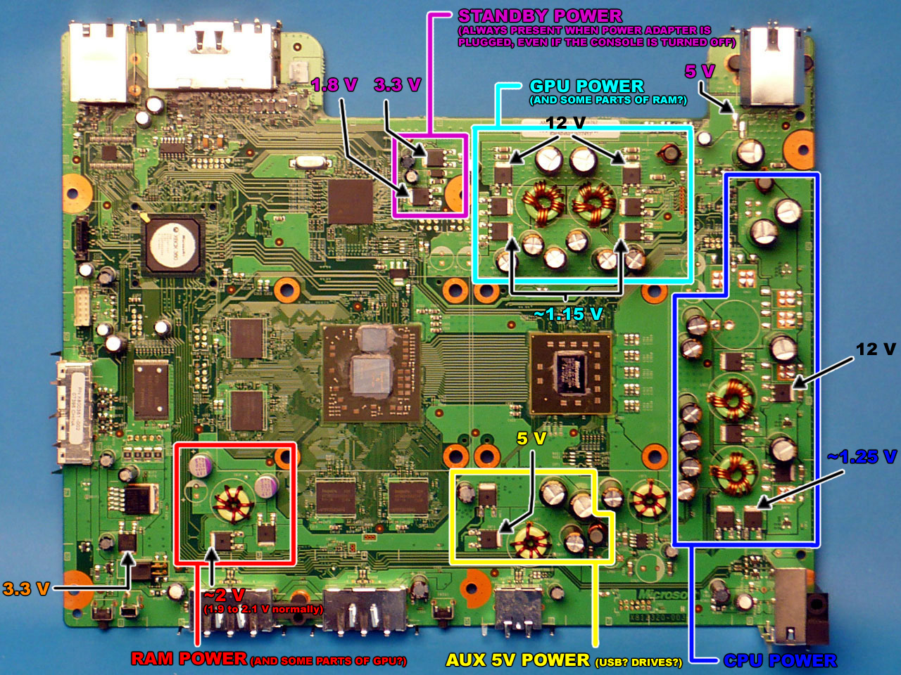

    Re: xbox 360 blowing mosfet
    Originally posted by keeney123
    So why is is listed as phase 1, phase 2, phase 3? You will also notice the output looks back to the input through the V_CPUCORE as a reference. I have not look up the IC, but it would seem to me that the different phases are being sent up by what is being feed back form the V_CPUCORE and this is what is causing when the phases are sinking.
    There are several phases as it lowers the frequency required for switching elements and spreads heat dissipated across them. Some VRMs have up to 10 phases! High end expensive ones. The higher the frequency the lower the output ripple. So many phases is something desirable to get that frequency high. The controller monitors many things. Current, Voltage, switching, etc. I ignore some of the details. But basically it does that, take high voltage and lower it in the most efficient possible way keeping it constant no matter power consumed by CPU.
    The other circuit I am dealing with does the same. I removed some of the regulators and chips in their output path and nothing changed. Someone suggest me in another forum to change the controller chip same as stj. Let's see how I can get one of those new chips. I have no oscilloscope to see what it is spitting so that is my best choice I think.
          I am thinking that the different phases are for different operations and different duty cycles for those operations. So I think they keep track of the phase shift of the power to determine which operation that is presently working. This may be done so that certain portions of an operation are not happening at the same time. So with three phase shifts that would be 120 degrees difference from one to the other. So the first phase for the first 120 of the PWM supply nothing but that phase one will turn on, then the second phase starts and at 180 degrees the first phase turns off. This is a bit of a guess. It just seems it would work like this or something similar.
          is simpler, the PWM is spread across all. One pulse in one line, next in next line and so on. Then the cycle starts again after the last one. The duty is given by the amplitude of the peak as always.
                Allright check this out:
                http://www.powerguru.org/multiphase-buck-converters/
                and the waveforms here too:
                http://www.tij.co.jp/product/jp/LP87...ed_description
                some chips turn on/off phases too.

                              #34
                              No no, CPU and/or GPU doesn't feeds from that. One side is 5v for USB + Drives (i think southbridge too). I saw what seemed to be like 3 regulators feeding from there too. The other side of the chip is for RAM. I think is 1.8v, gotta check this again. That is a problem if the chip is totally faulty. In that case would have to use two converters. Or at least a regulator if load ain't too high (otherwise I would burn it). I think that side was ok and the testpoint was giving proper voltage.
                              Power supply got the possible problem of ground dis-balance. A small swing at ground means a short circuit. So likely will not use PSU. I was reading in another forum that actually grounding the ground would be safe and would do away with that possibility.

                                  #36
                                  Originally posted by waldoalvarez00
                                  So putted another mosfet and took the risk to power it on. Well this time it holded and didn't got damaged but the power brick is sensing something as the console spins the fans for a second and then the power brick turns the led red activating sort of an overcurrent protection mechanism.
                                  That means there is still a short-circuit somewhere. I would bet that 5V rail again. Just because the MOSFET there is no longer blowing doesn't mean the controller is working right. It could be that the controller is trying to turn on both the lower and upper MOSFETs for that rail, causing a temporary short-circuit and thus shutting the PSU down.
                                  Here's a diagram I made a long while back of the voltage rails on the Falcon board:
                                  https://www.badcaps.net/forum/attach...1&d=1461040574
                                  These voltage rails will be quite similar on the Xenon, Zephyr, and Jasper as well, so you can still use the above diagram as a general guide.

                                    #37
                                    Ahh ok thanks pal, I am gonna check the resistance and report. I was just measuring with the meter in diode mode. Interesting, didn't thought about both FETs on at same time. The controller is ADP1823.

                                      #38
                                      Resistance is infinite in both pins of the output coil

                                          #40
                                          I have it
                                          Did you try inserting 5V at the output of that rail, though? If you do and the PSU trips, remove the MOSFETs on that rail (I believe that would be Q6F1 and Q6F2) and try again. Leave the coil in place.
