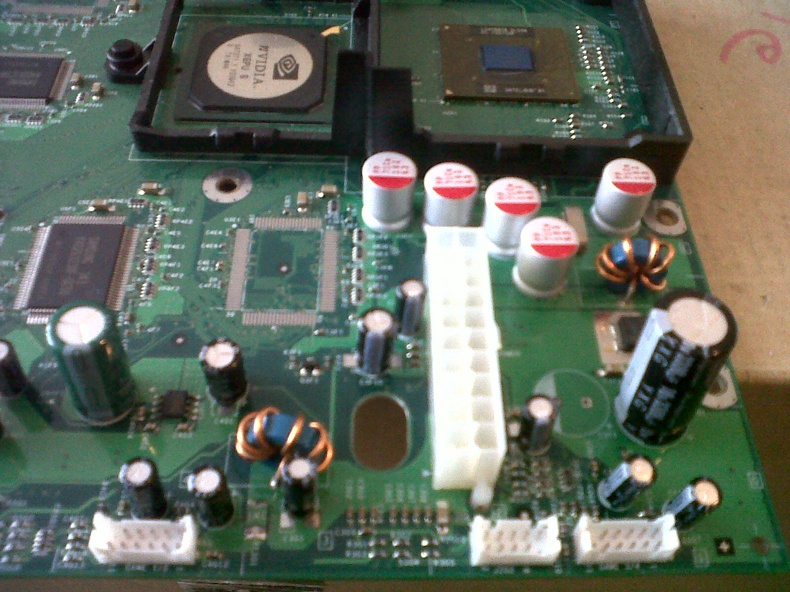

      Re: Original Xbox Replacement Caps
      nobody makes ultra-low esr electrolytic caps anymore, poly's replaced them several years ago.
      if you found someone selling Nichicon HM or Rubycon MBZ / MCZ or Panasonic FL, they would be very old stock.
          i will post results and pictures
              fitted.
              not tested yet, i need to find a video cable & backup the harddrive.
                Cool ! Thanks for the photo !
                Take your time, i'm not in the hurry ! =)
                                So you tested it and it worked stj ?
                                If yes, i will order the caps this evening ! Thanks again, it seems like you will save 3 Xbox instead of just one !
                                  • 31199
                                  #76
                                  3?
                                  each xbox needs 5 caps. - even if you originally had 3 you still fit 5 because they are a lower uf value.
                                  so each pack saves 2 xboxes.
                                  and i played Burnout3 on it - a good test.
