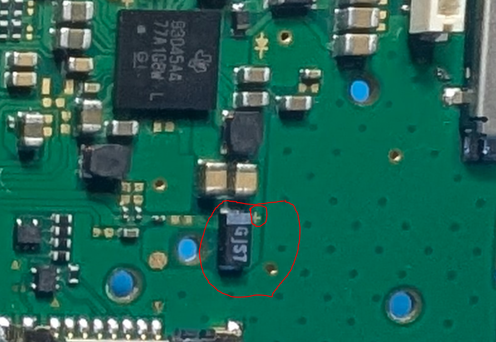

              It looks like the (at a guess) PMIC (Power management IC) is a 93045A4 by Texas Instruments, most likely a custom design for Nintendo since it doesn't show up in their catalogue, so sadly, we can't get a datasheet for it.
              This chip possibly generates all the power rails in the device, and might handle battery charging as well.
              There are at least four inductors around it on the PCB, so it generates at least 4 different rails using probably buck converters. There may be an internal linear regulator as well for a low current standby rail or such.
              The inductor will be connected between an output pin on the IC, and the filtering capacitors on the rail. See the attached diagram for the basic idea. In this case the MOSFET and diode are probably both internal to the IC, but there may be some external diode on one or more rails, depending on the design.
              You can measure the voltage from the output of the inductor to ground, or measure for shorts there too. Look at the PCB traces to find out what is where eg: which side of the inductor connects to a capacitor(s).
              There may be other power supply ICs on the board also, but this looks like the main one.

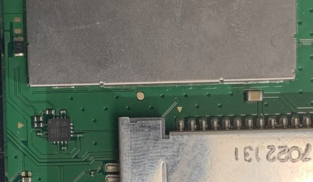

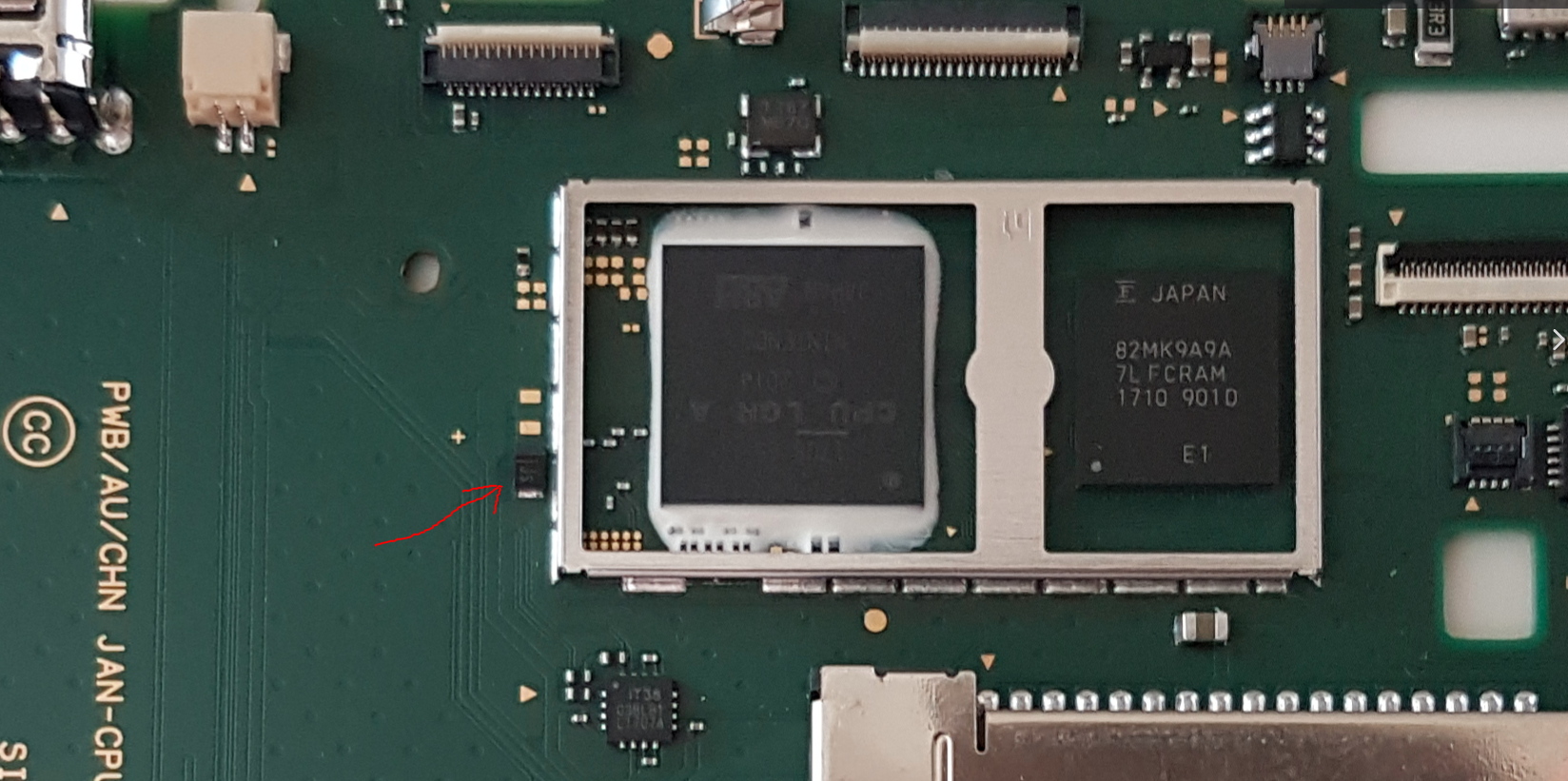

                Hi! I noticed that a component is missing just to the left of the CPU on my Nintendo Switch motherboard. I'm not exactly sure what it's supposed to be, so if anyone has an idea or a reference photo of that area, it would really help me identify the missing part.
                Thank you so much for the other replies as well! If replacing and soldering this missing component doesn’t fix the issue, I’ll definitely move forward with the solutions you suggested.

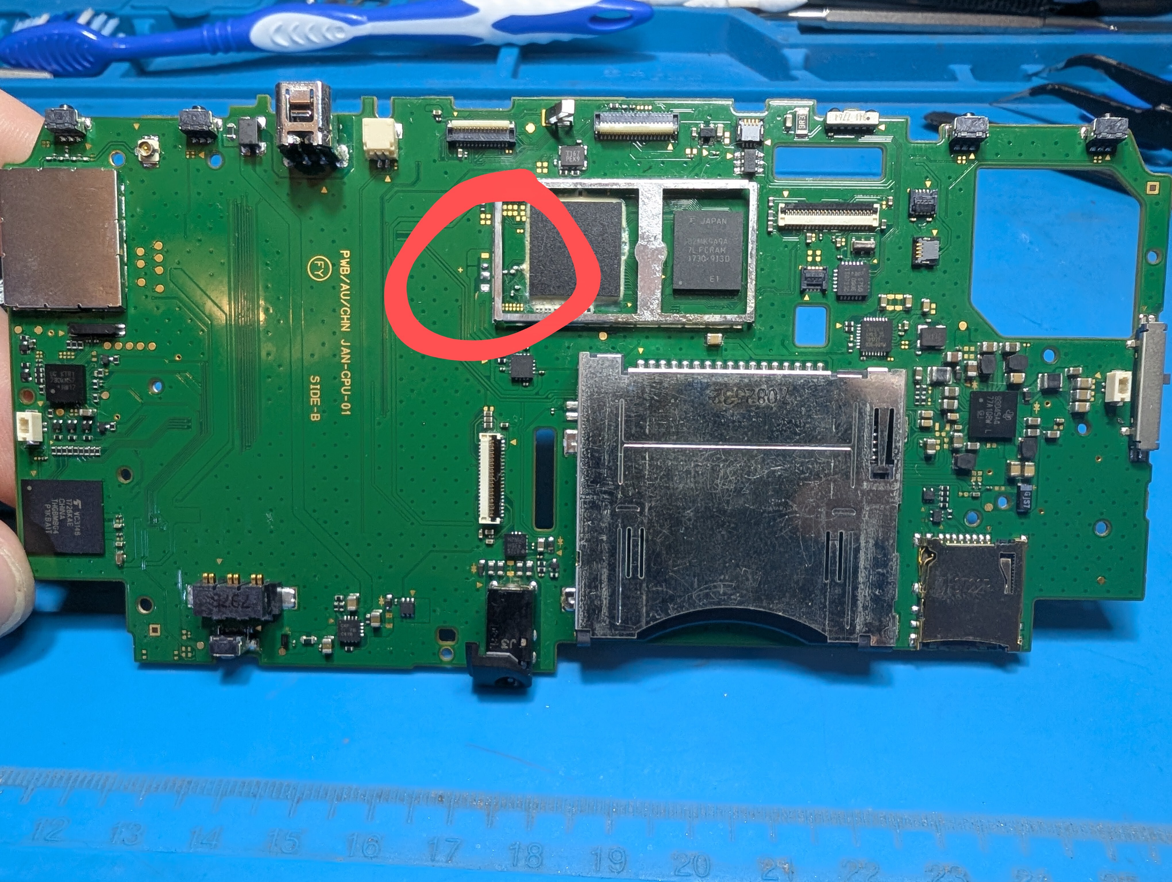

                  Here

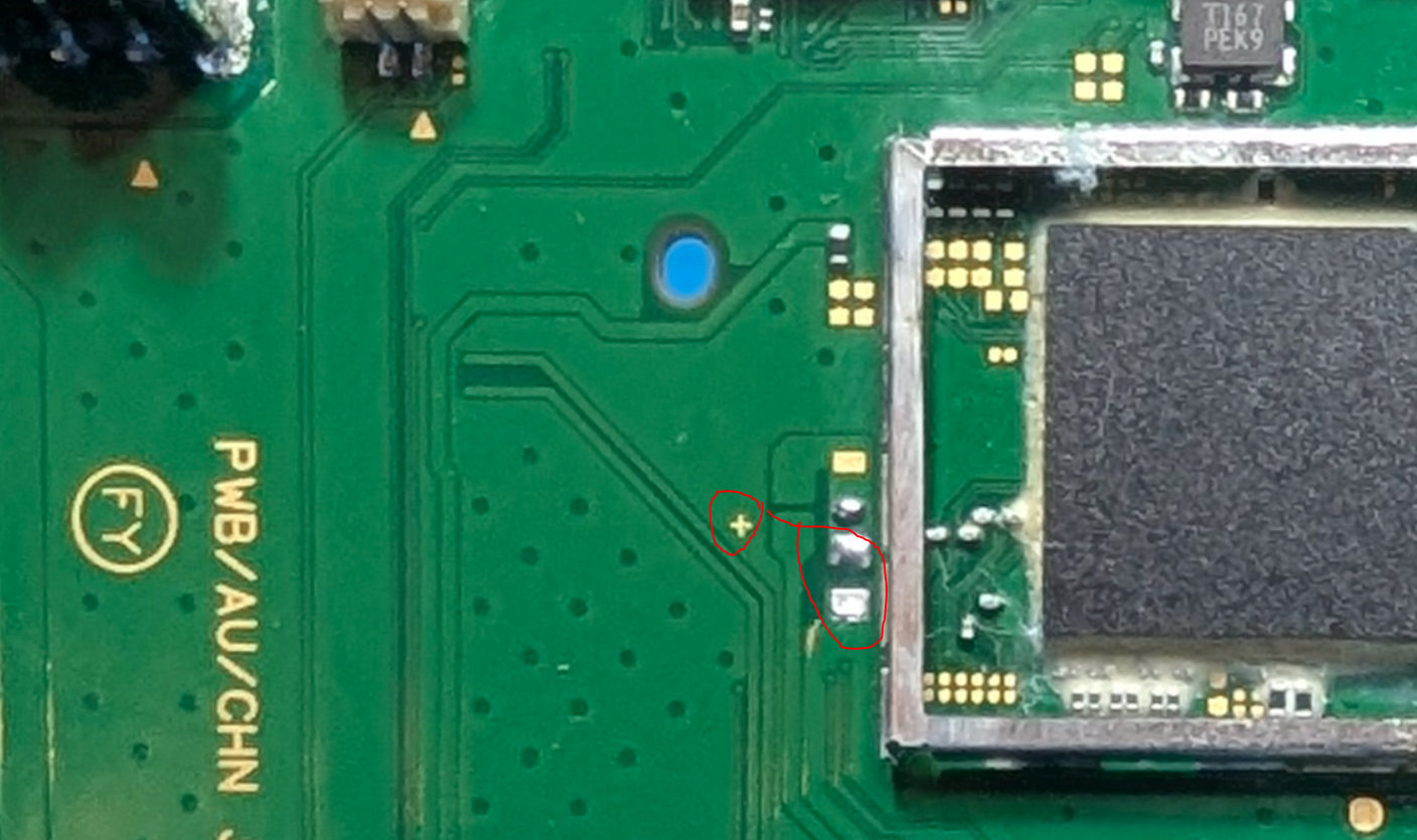

                    Looks like a tantalum capacitor.

                      Here's more.

                        Hard to tell from the photo if it's missing or wasn't there in the first place, solder seems smooth so probably not knocked off at least, strange

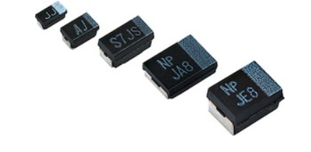

                          It's hard to tell from the photo, there was originally a tantalum capacitor, someone had unsoldered it before (traces of soldering are visible) and forgot to put it back, apparently diagnostics were being performed on the processor core power supply...

                                I'm not sure. In the other photo, it seems labelled as ".Js" but I don't know where to decode that.
