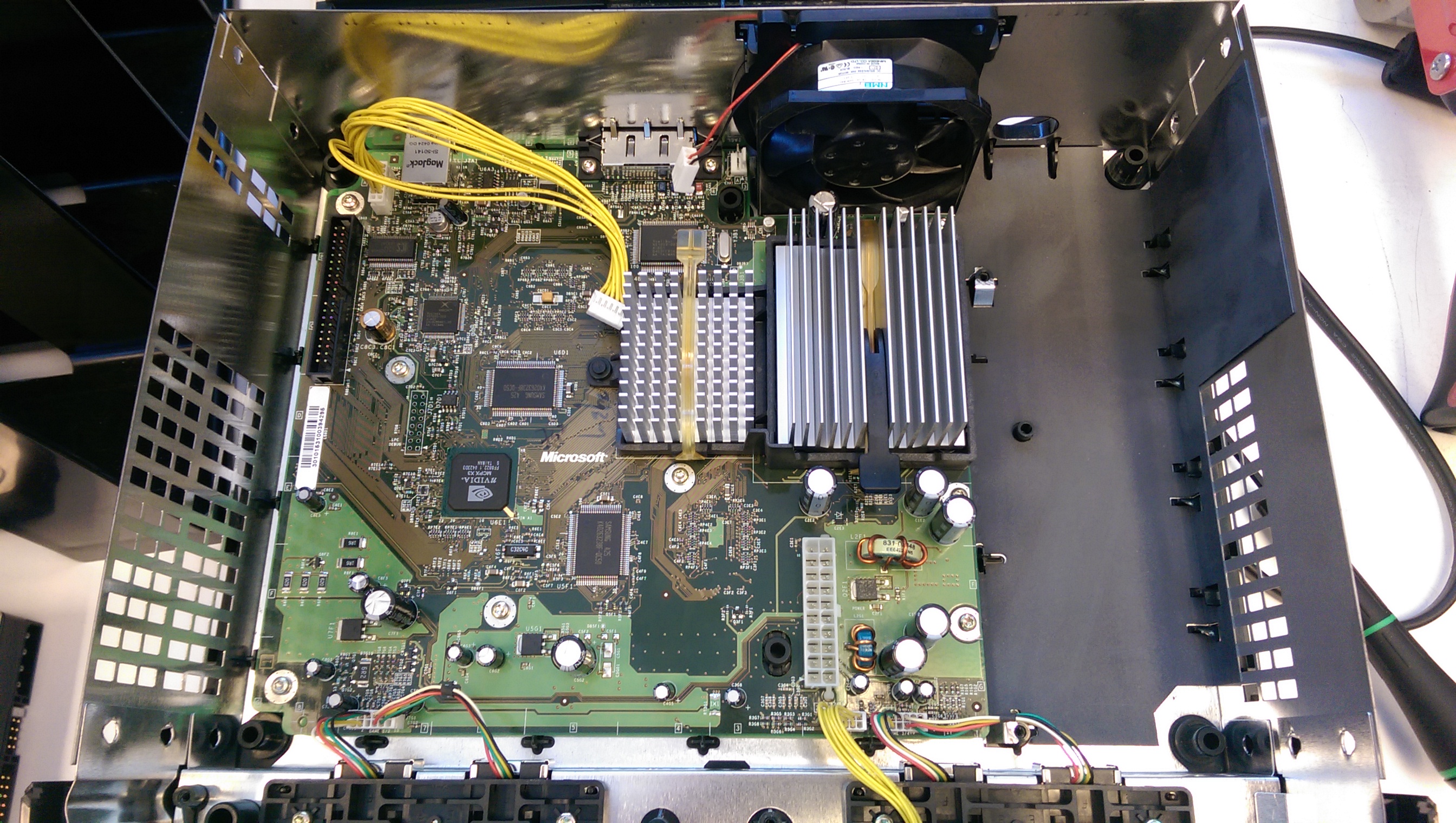

    So I got my old XBOX back from my buddy, as it is it has no issues. But I decided I wanted to play some of my old games, and figured "hey, why not do some maintenance to it and improve it while I'm at it?" I got this broken in 2006 (it just had a bad optical drive) it was manufactured on 7/19/04 Also...check out that 1F cap!! nichicon UC series.
    Here's what I planned on doing:

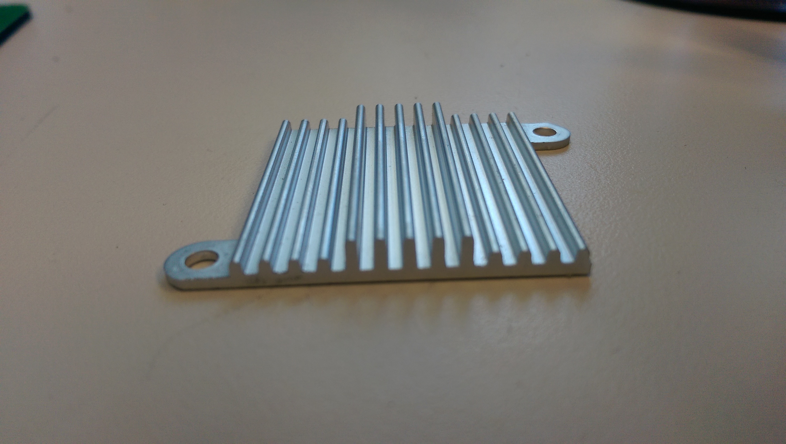

    Add heatsink to nVidia chip (MCPX X3) the heatsink pictured is 5mm tall, should clear under the optical drive. By the way, is this a defective nVidia chip?

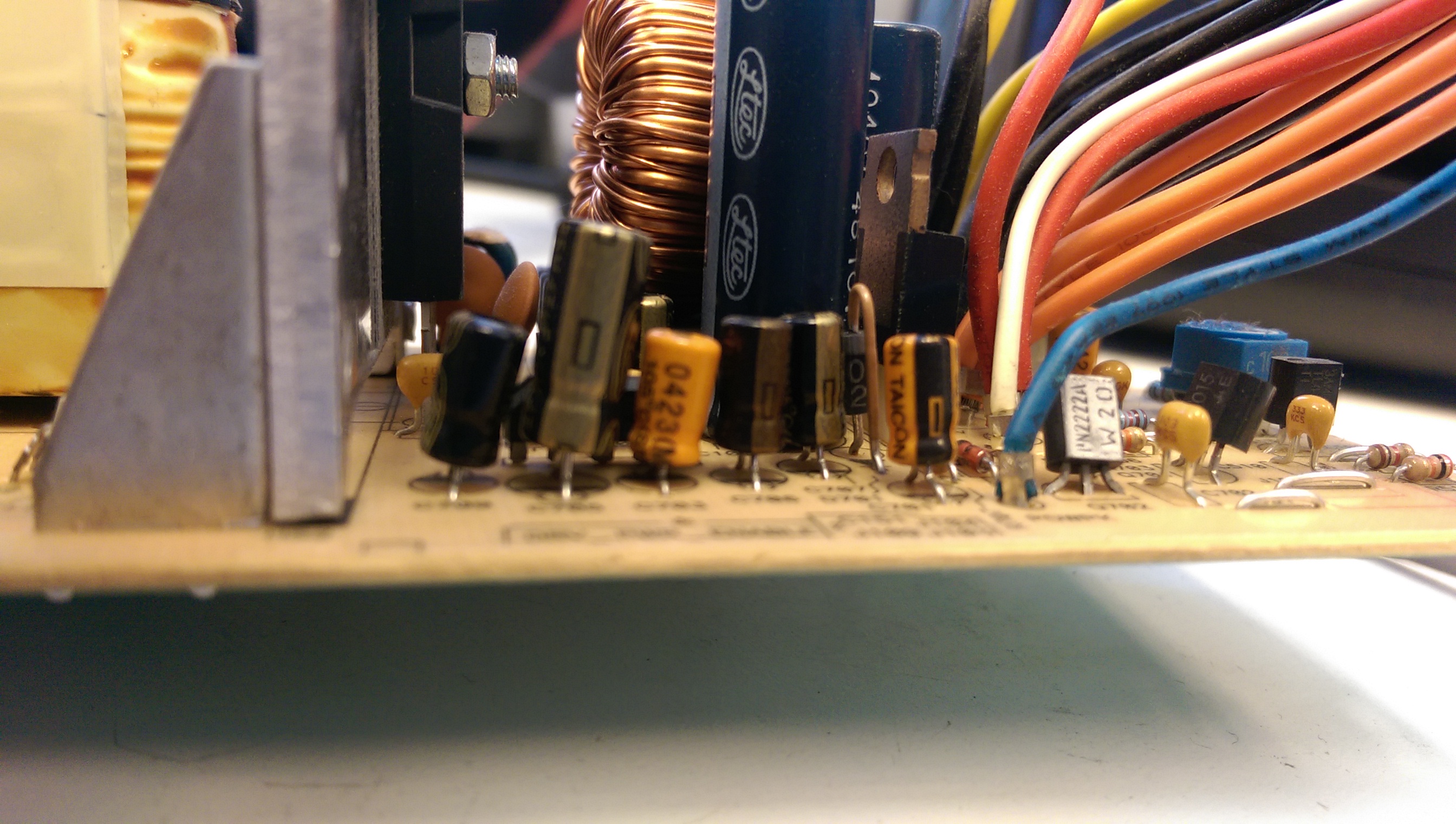

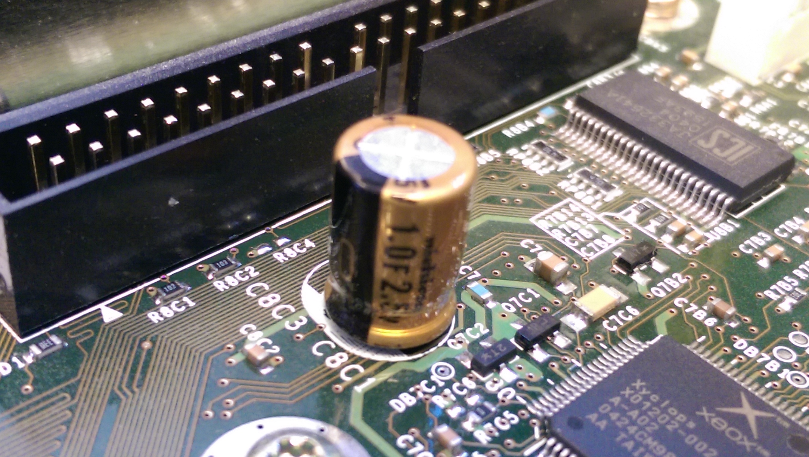

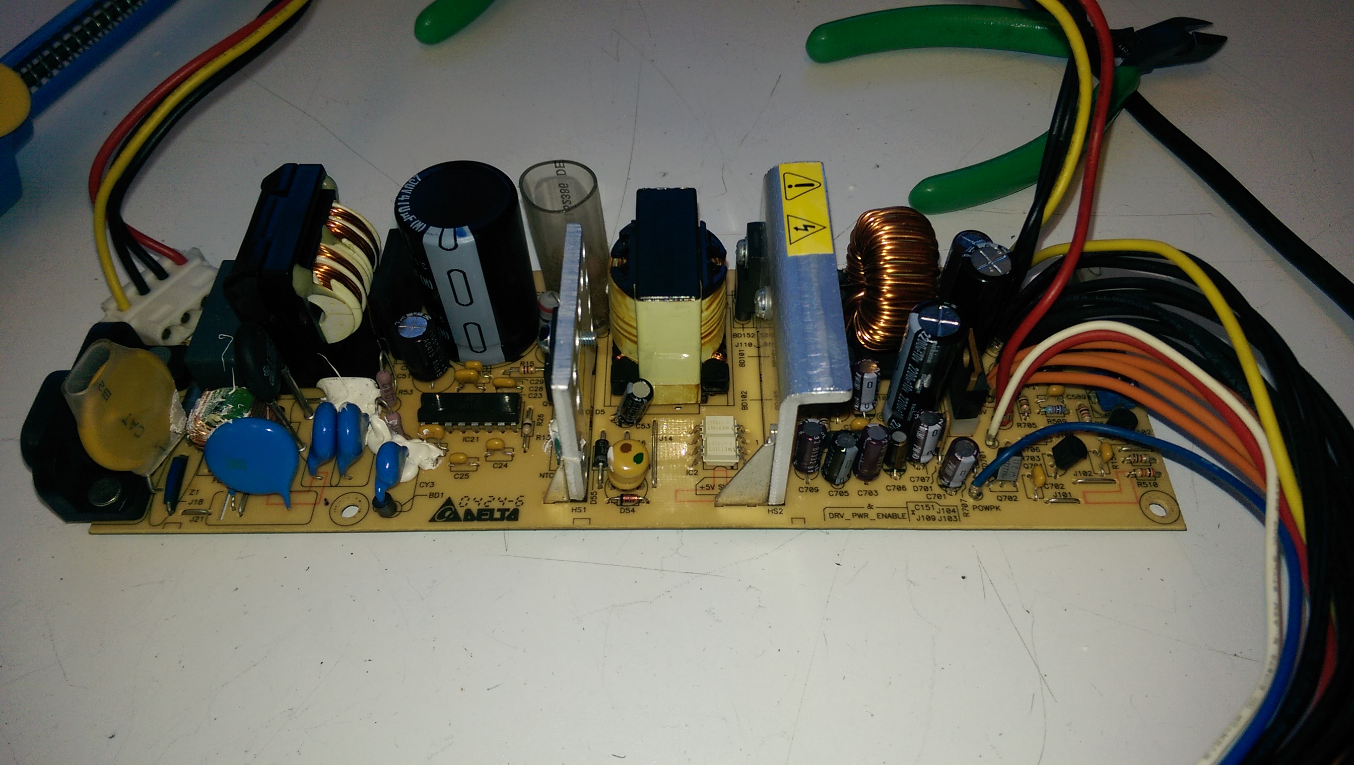

    Replace the suspect nichicon HM (3300uF 6.3V date code 26th week 2004) It looks like they're on the VRM for the CPU, is this correct? I was hoping to use either Fujitsu bumblebees 820uF 2.5V, Sanyo SEPC 560uF 4V, or nichicon HZ 2200uF 6.3V
    Recap the power supply with good caps. Has Ltec and Taicon. My question here, I should be able to safely replace the 0.22uF 50V cap with 0.47uF 50V cap, or should I not even worry about it?
    Replace thermal paste under both heatsinks

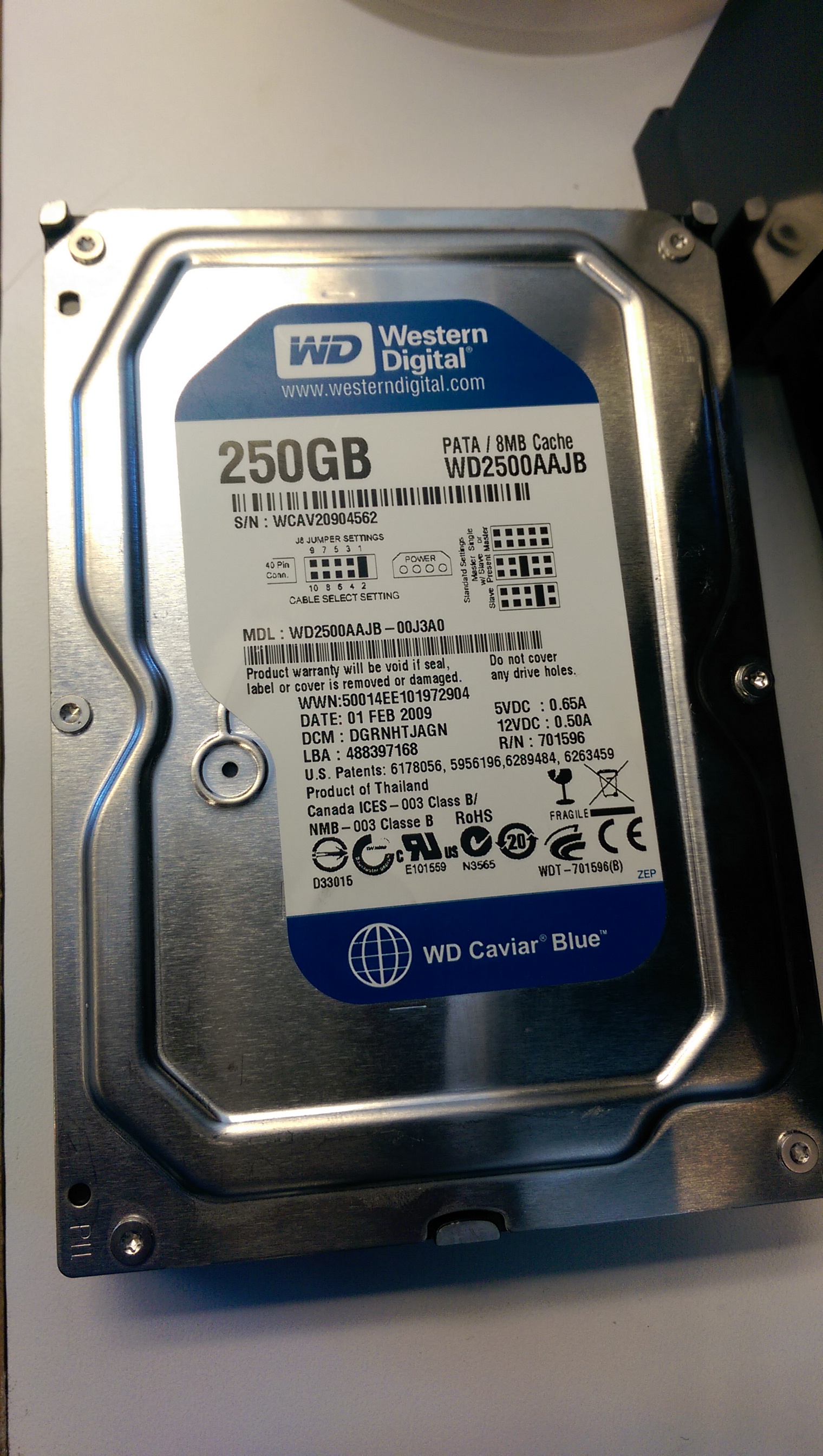

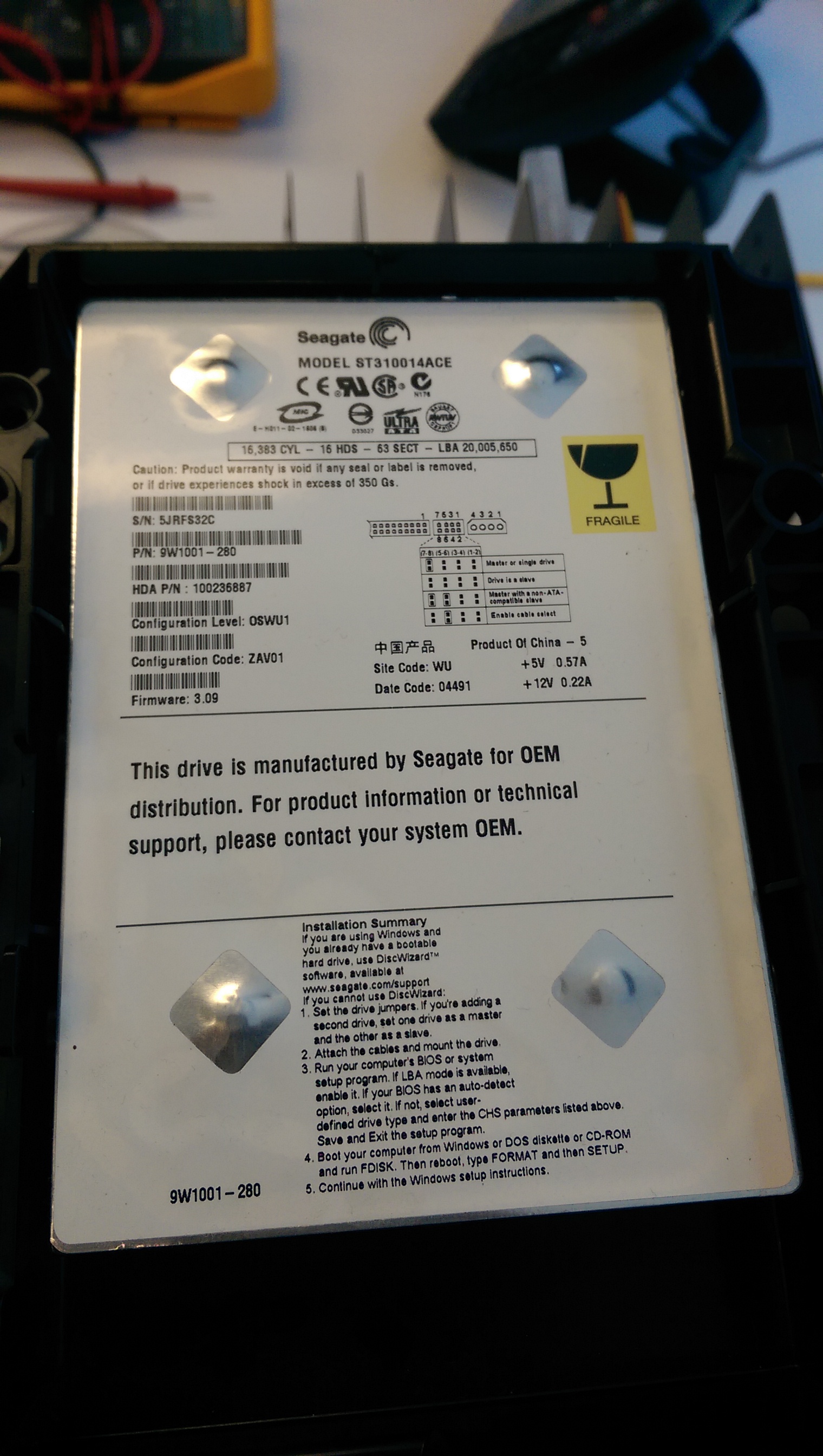

    Clone over to faster hard drive. Stock is 10GB 5400RPM, 2MB cache. New one is 250GB 7200RPM 8MB cache.
    Does this seem realistic? Thanks for any input

    I think those Xboxes are too old to have the nVidia chips with the substrate defect. But is that going to be a modded Xbox? You can't actually replace the hard drive succesfully without modding the Xbox as all drives that come with the units have a security key stored in the EEPROM on the hard drive PCB which communicates with the motherboard in order to unlock it (the drive) when the system boots. This tutorial shows you how to read the EEPROM's contents but it will require a bit of work: http://www.llamma.com/xbox/Repairs/R...ox_Hdd_key.htm
    Failing that you could just keep the stock drive if it still works (though, I do know that the Seagates of those units have SMOOTH chips and those are notorious for failing, but I've never heard of one failing on an original Xbox drive, maybe because they're 5400RPM and not 7200RPM). I don't see what would be wrong with upping the capacitance on a capacitor that tiny - something like that should be used for decoupling, coupling, bypassing, timing, or EMI filtering, so a 0.47uF 50V capacitor should do fine in place of a 0.22uF 50V one.

        is it flashed?
        if not then it needs the stock harddrive.

            The 1.6 xbox can be made to work with a softmod. A new drive can be prepared with the requisite software and then locked with the key that the bios will then try to unlock it with.

                          Thanks for the reply. They were actually Ltec ST. But yes, I've seen many, many failed Ltec TK. They must not properly seal them, they seem to dry out quickly even in Delta ATX PSU's they seem to be failed most of the time

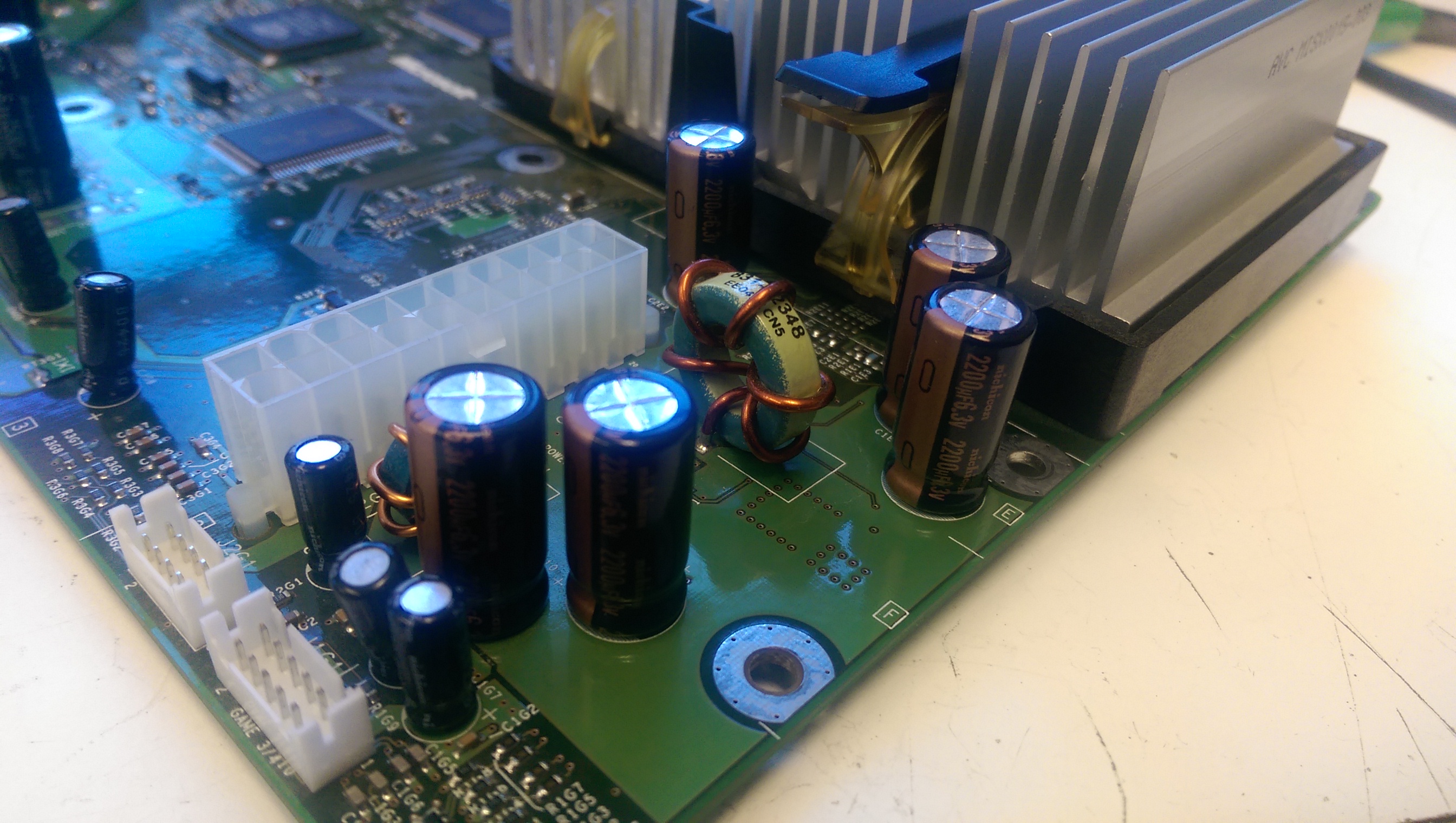

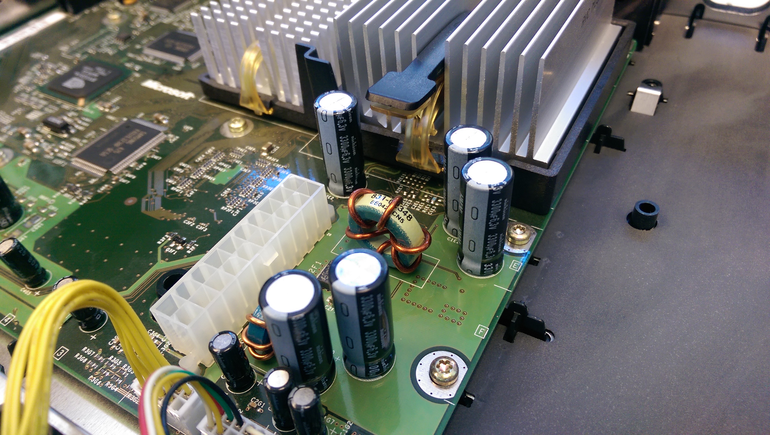

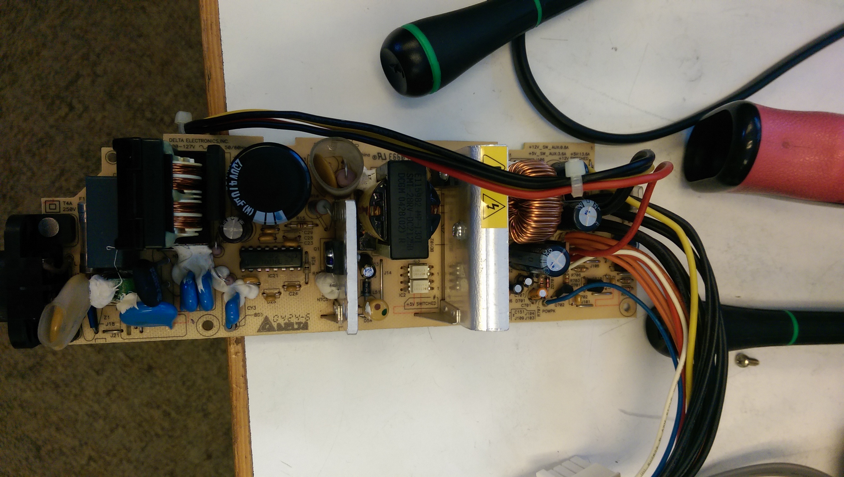

                            Recapped the PSU and motherboard. nichicon HM were out of spec. Anyone know why the orange and red wires read 5V? I guess I just assumed orange would be 3.3V

                              ^ That power supply is DPSN-96DP-1, which doesn't have a +3.3V rail. It has a +5V rail rated for 13.6A, a +12V rail rated for 0.8A, and a +5VSB rail rated for 3.6A. Interesting that the bad Nichicon HMs went out of spec without bulging (unless they weren't out of spec that much, or the fact that they were overfilled is why they were out of spec if you mean severely increased capacitance), I'm so used to seeing the suspect HMs/HNs from that period bulging and spilling their electrolyte, but they're obviously bad either way.

                                Gotcha. So if the PSU is only rated for 0.8A on the 12V, how can it function when the HDD has a 12V rating of 0.22A, the DVD drive has a max draw of 2A on the 12V, plus the fan which is rated at 0.24A

                                    0.8A is just a rating (minimum, typical, or maximum). Those numbers I mentioned were just the ratings found for that unit. Inside you may find a very overspec'd rectifier knowing Delta (probably a TO-220 10A/200V ultrafast) and the toroid may easily be capable of more. Also, those current draw numbers you see on the label of those devices, I believe, represent the maximum current draw in the worst case scenario. They aren't guaranteed to draw that much except in the worst case scenario, at their full load. Many datasheets for DC fans for an example list "typical" and "maximum" input currents, and the difference can be as high as 0.2A between those thresholds.

                                      good stuff you can do:
                                      fit an 80mm fan.
                                      lots of work, but lots of airfflow for not much noise.
                                      fit a mod-chip - esential t use a custom bios.
                                      custom bios lets you use custom partition tables, custom led colours and set the boot priorit between different dashboards.
                                      also it includes the reset by controller function.
                                      80way ata66 cable - pretty easy to do.
                                      putting a heatsink on the main chip under the dvd is a good idea.
                                      i'm including a bios editor so you can see the options to play with.
                                        • 31296
                                        Re: Original XBOX "mods"
                                        btw, you maybe want to remove the cpu/gpu heatsinks,
                                        clean the usually pink chewing-gum off with white-spirit and then use arctic-silver.
