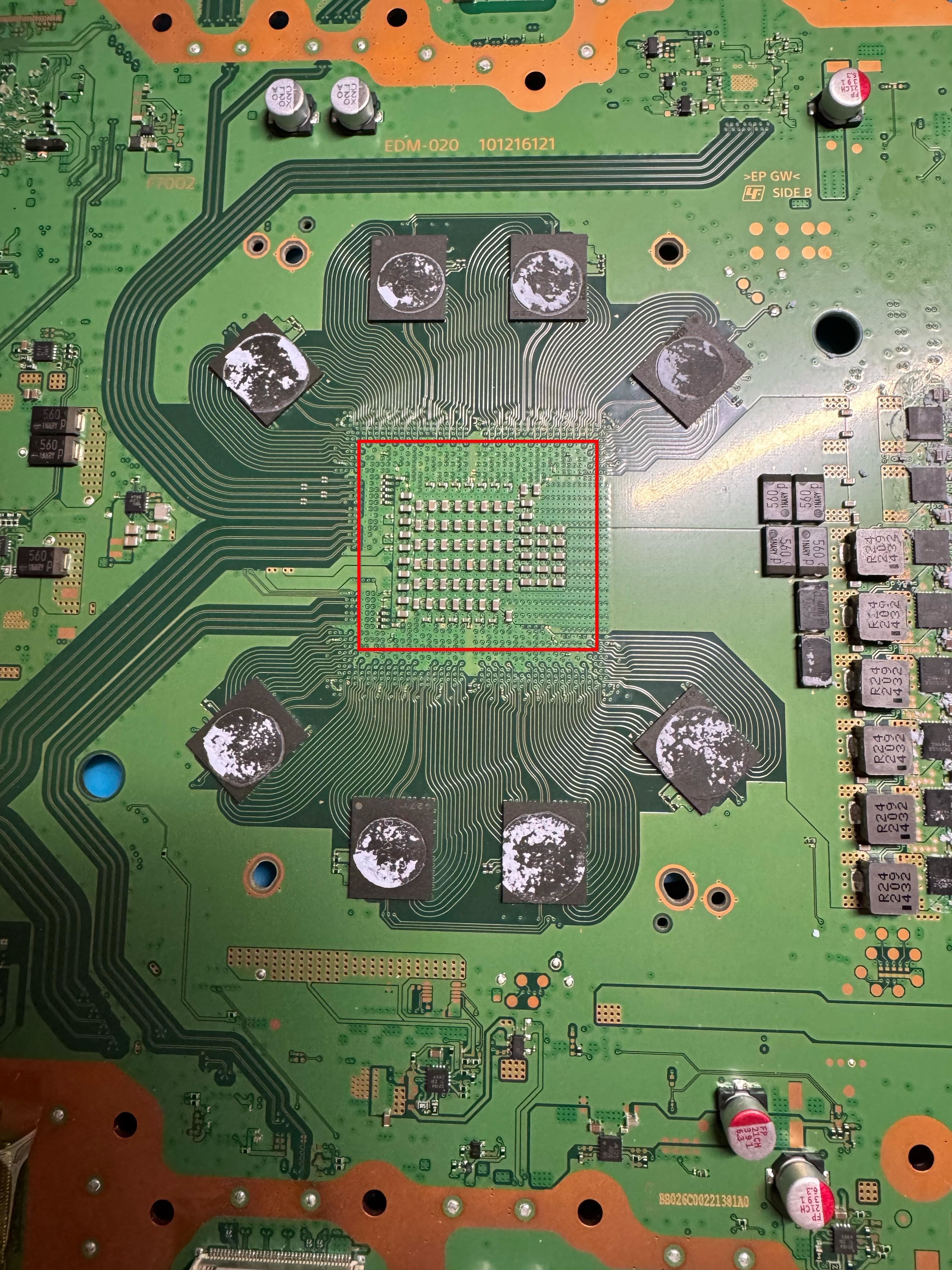

PS5 APU damaged? - Very low resistance below the APU
  • Flipper31
    • Dec 2024
    • 2
    On my PS5, there was a short circuit, and under the thermal camera, three chips were glowing (RT5127 power management IC, SSD RAM, and SSD controller). I removed all three. Now, there are no more shorts except under the APU.
    There, I measure very low resistance. Is that normal, or is it an APU defect?
