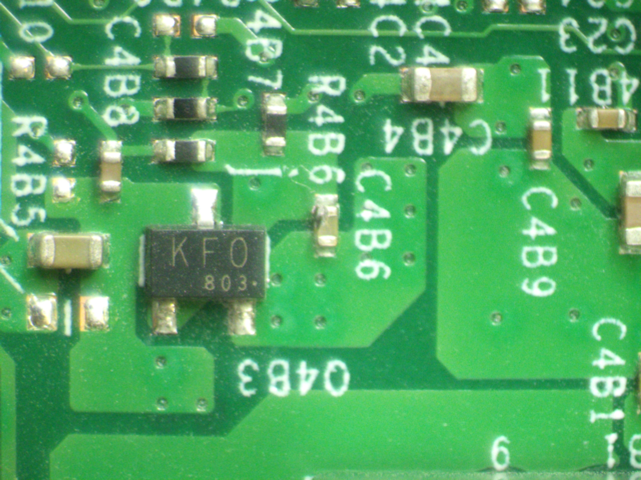

    Xbox One S Identify component
    I have an Xbox One S that beeps to turn on but immediately turns off, I have all the power rails present but on visual inspection I found this broken cap behind the Ethernet port.
    Unfortunately I do not have a donor board at hand. Can anyone help me identify the value of this component? C4B6 - Would highly appreciate it.

    Re: Xbox One S Identify component
    My meter shows 1226nF.
      Thanks! 1uF it was and the console boots perfectly once again.
        That makes it a standard 1mf 50 volts .
