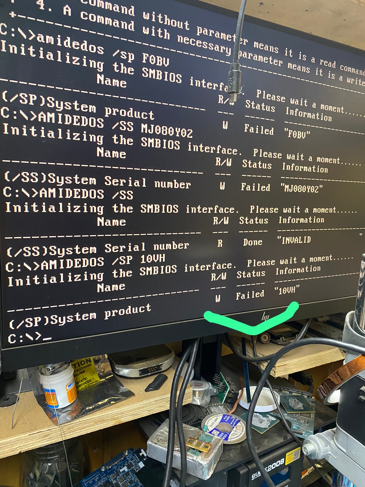

              Hello friends can someone help me please.. I have thinckcentre M715Q 2TH GEN AMD with corrupted bios, can you rebuild amd? I found a file on the web that turns on but the dmi information is missing, I have tried to write serial but I have not succeeded, I tried to do it with amidedos, but an error appears (image attached) I also tried it with Thinkpad maintenance diskette, and with this an error appears write protected bios error...

                  Re: lenovo m715q am4ih ver : 1.0
                  Here's you New Bios, it's a Virgin Bios from Lenovo with your DMI and Windows Key.

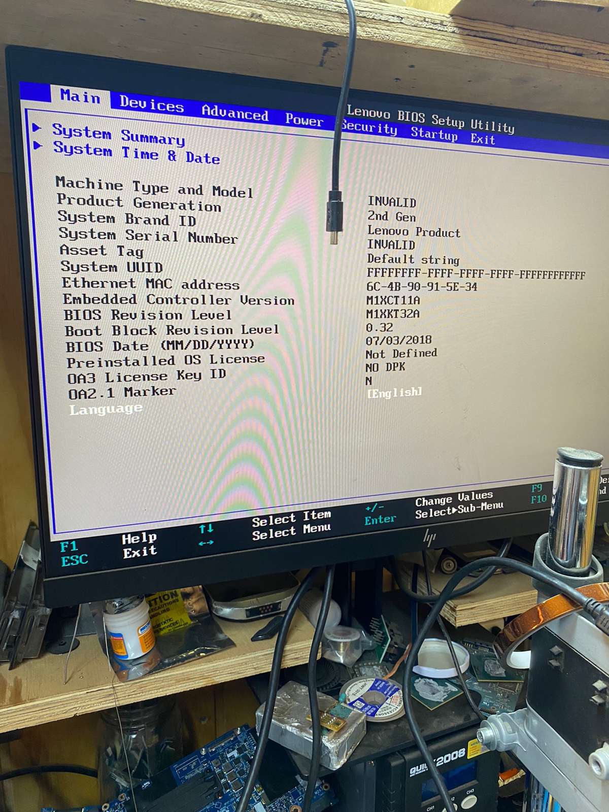

                      Serial Number: MJ080Y02.
                      Thanks Bro, the dmi were perfect, but I have the fan at full speed, the same thing happened to me before with the bios that I had before without dmi data... or will this model be like that?
                          You're Welcome. It's an AMD Platform and there's no ME Region, so it's supposed to be a normal thing. Also it could be fan failure or a hardware issue I don't know.
                            Solved Bro, I leave the information for someone who is going through this problem, I solved it by downloading an ec update from the lenovo sd website attached image of the driver that solves fan at full speed again thanks for your help.
