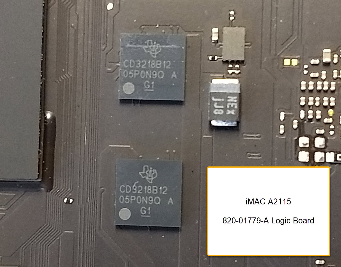

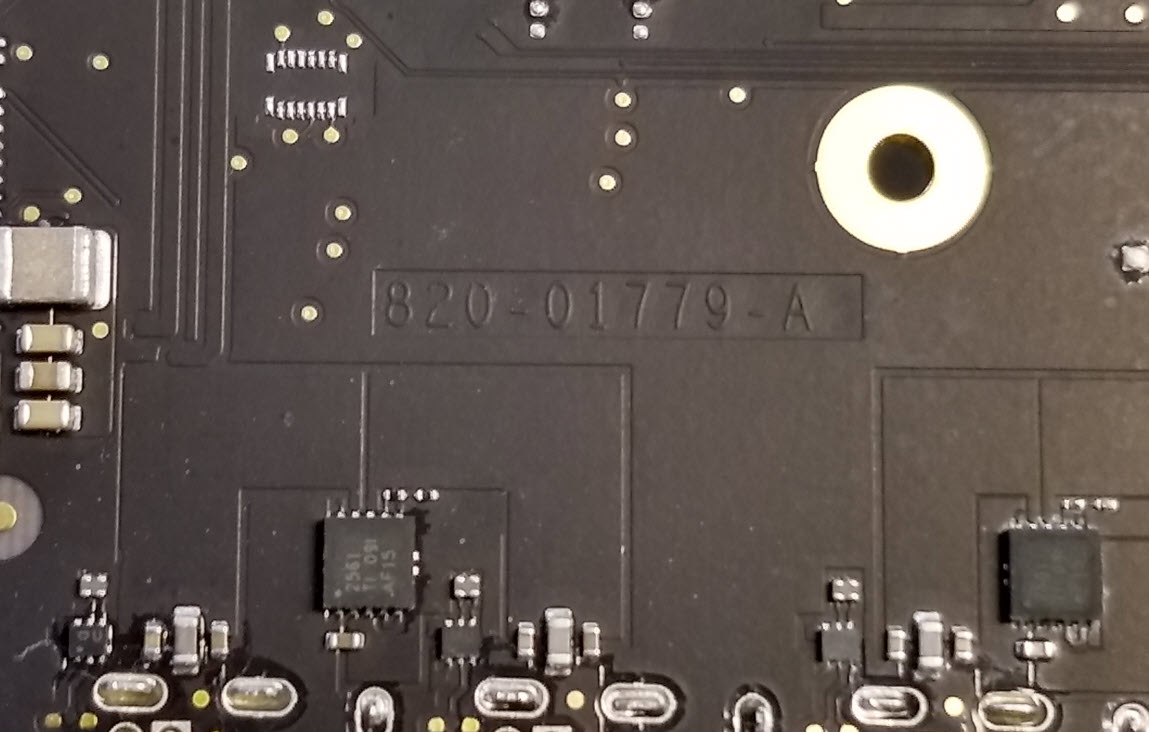

    Re: Request for A2115 iMAC 2020 5K schematics
    Update: Logic Board 820-01779-A
    1) replacement 300W power supply arrived from Amazon - it is a generic 300W unit that is NOT Delta and is NOT LiteON but looks identical. Sold by ICTION from Shenzhen whom we have used for assorted products with success. The cost was very fair to buy it locally and was received the next day.
    Bad news: The fault of this 2020 iMAC 5K is NOT the power supply.
    The unit does not show any sign of life / no leds / no fan spin after a brown out event. Probing assorted caps and each is with 0 volts. 12VDC does indeed enter the logic board through the molex cable harness.
    Will review with the original power supply after this setup shows some sign of life.
    2) After watching this great video:
    https://www.youtube.com/watch?v=GIHSyamWnh4
    have the logic board out. Was not as elgant of a procedure as shown in the video but it is out.
    3) Found that the ACE controller onboard is the CD3218 x 2 on this logic board. That is a new one to me. Next thorn in the ACE line of devices.
    4) So far, unable to locate the schematics so will compare against the A1419 schematics which shows that there is a voltage regulator to create the PPBUS_G3H. Work for tomorrow.
