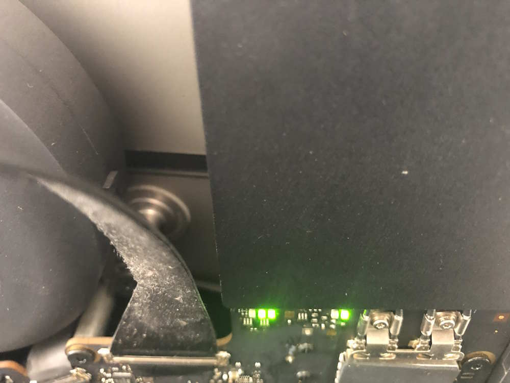

    Hi there,
    I've an Apple iMac 2019 model A2115. Sometimes works fine, but many time doesn't works, the fan spinning but no chime e no video output.
    The diagnostic Led (3+2) are the same: 1-off 2-on 3-on 4 off 5 on
    Any idea?
    Ty Click image for larger version

    Review against the schematics on the position of these DEBUG LEDs. Each LED is an indicator to what is or is not working. Share the board # once it is known to verify the LED status. Could be a failing power rail that is causing that leg of the circuit to stop working. Have seen faulty tantalum caps do this in the past.
    When you have the fan spin - is it a high fan spin or normal? Tried a PRAM reset? Check the RTC battery (PPVBATT_G3_RTC) as well. Suggest to replace the coin cell battery for starters.
