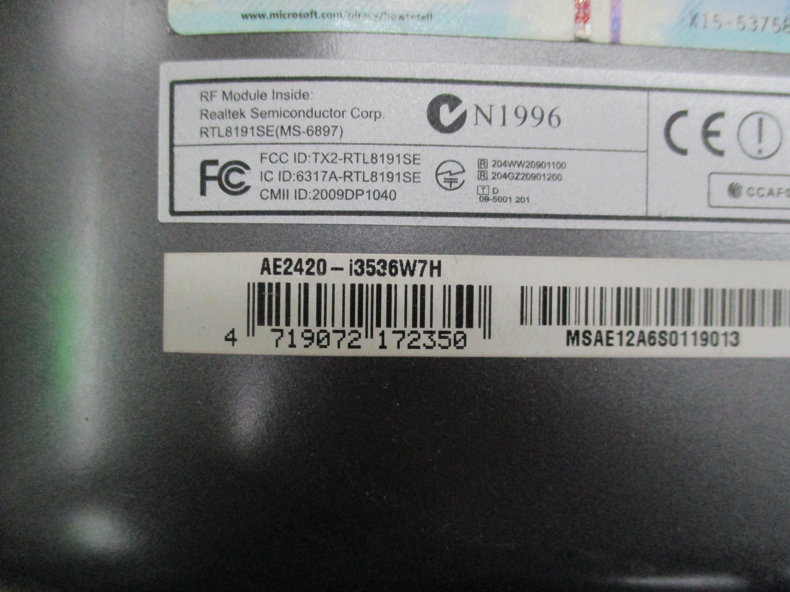

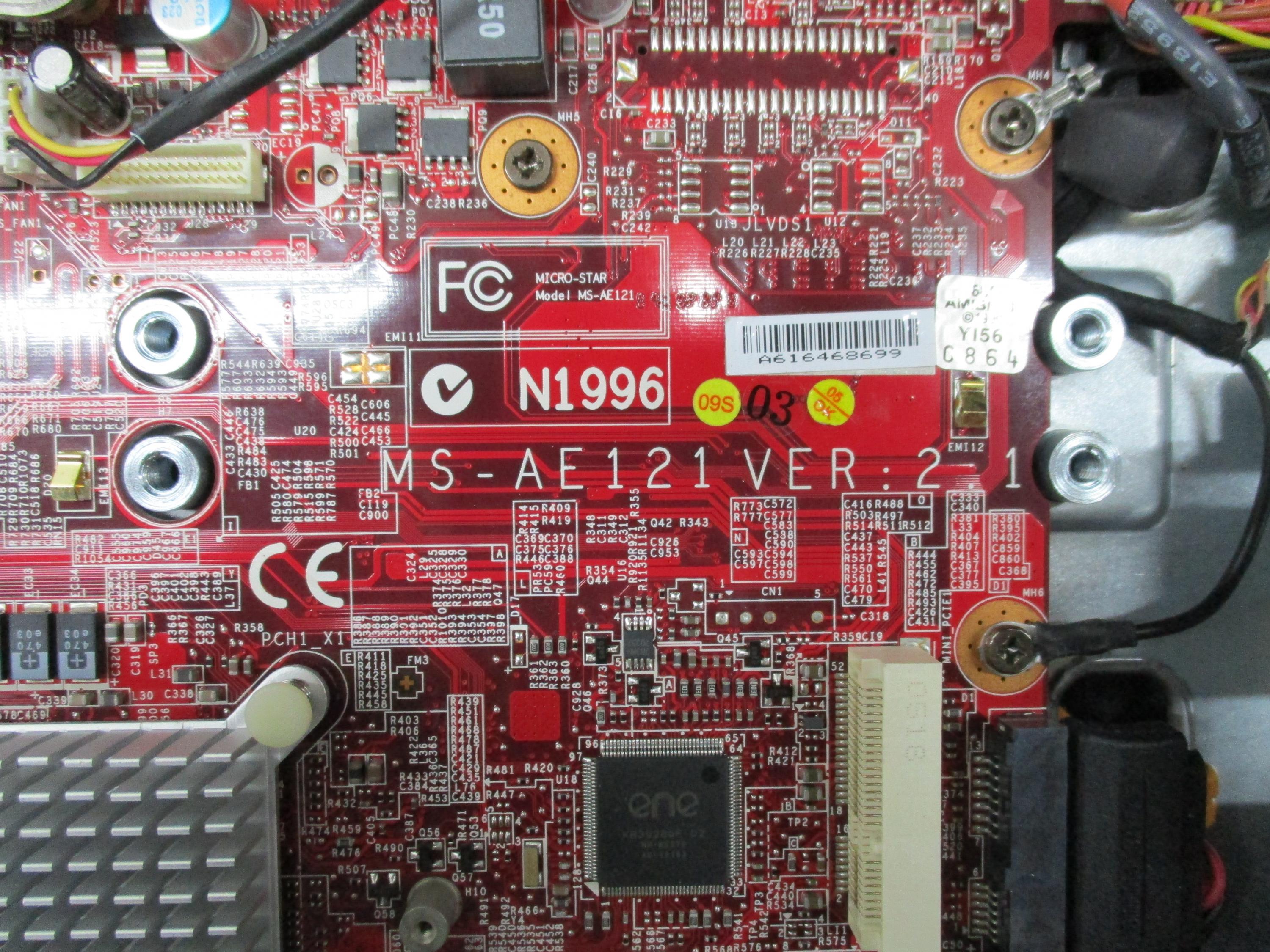

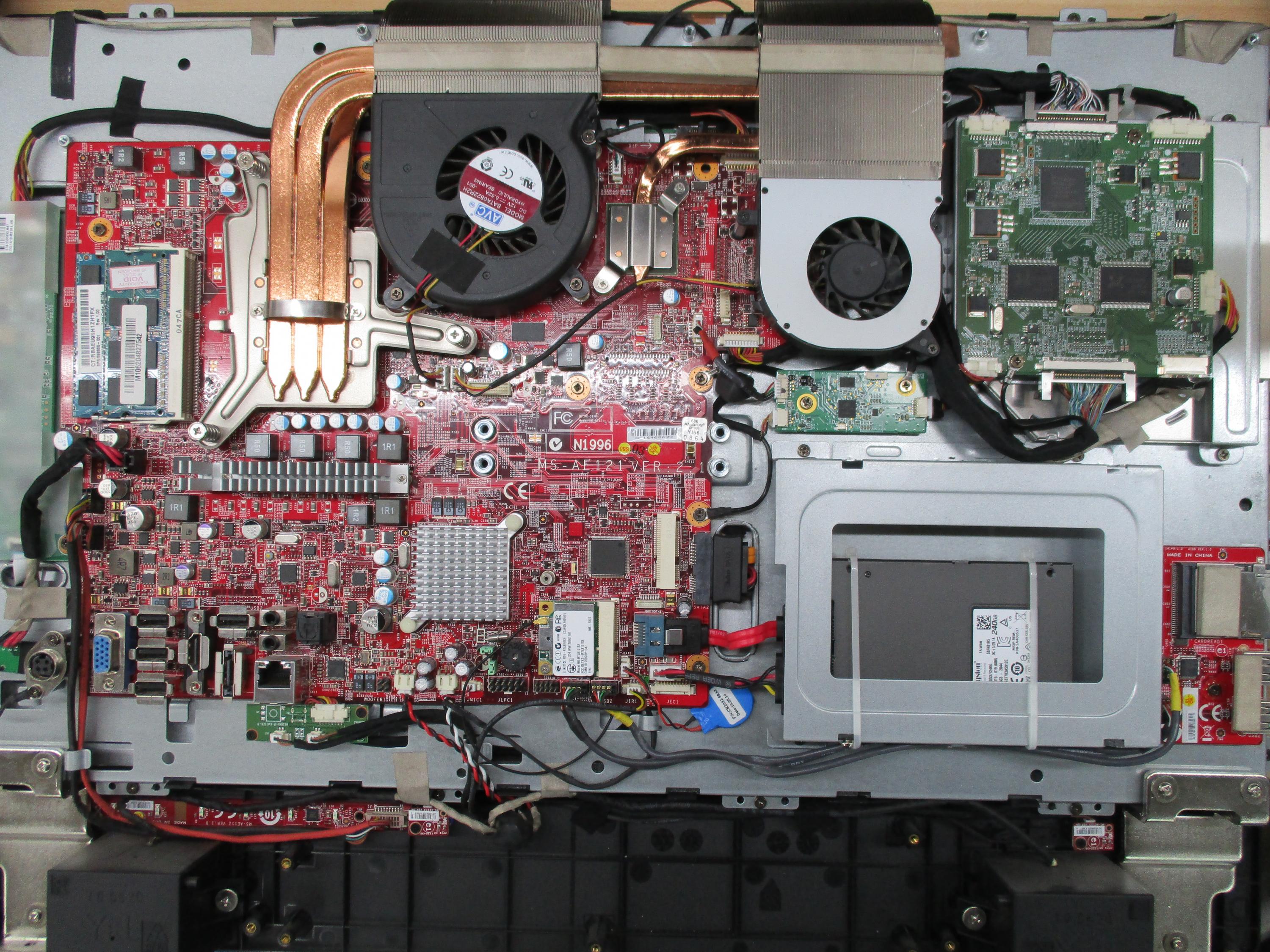

    Hi there,
    I'm facing following problem:
    - Accidently flashed BIOS and EC FW of the "3D" Version (No warning message or anything from MSI's flash tool!)
    - Device was fully bricked after, not coming on at all
    - Flashed correct BIOS bin via China BIOS Flasher from another computer
    - PC comes on again, but shows no signal on the internal screen. If I connect an external via VGA, it's fully working.
    What I've tried so far:
    - Flashing every EC FW and BIOS I could find from MSI support with the MSI DOS flashing tools
    - Connecting the internal Display directly to the mainboard without the display controller board.
    - Everything in Windows with multiple drivers, but the internal display never appears as an option (Screen 1 is always the external)
    - Reflowing GPU
    My suspicion is, that the I overwrote some responsible area on the BIOS chip with the Chinaflasher, which otherwise stays untouched by the MSI DOS tool.
    Any ideas, suggestions or Working dump file for this device I could try? Thank you in advance!

      Re: MSI WindTop AE2420 AIO No signal after BIOS Flash
      that's what I did - I have the 1GB Version, V4.00.
      After flashing with the SPI programmer, the computer itself works, just the internal screen stays black, saying "no signal". If I connect an external screen, all works fine.
      That's why I thought, the first, wrong BIOS flash killed something else, what's responsible for the embedded screen.
