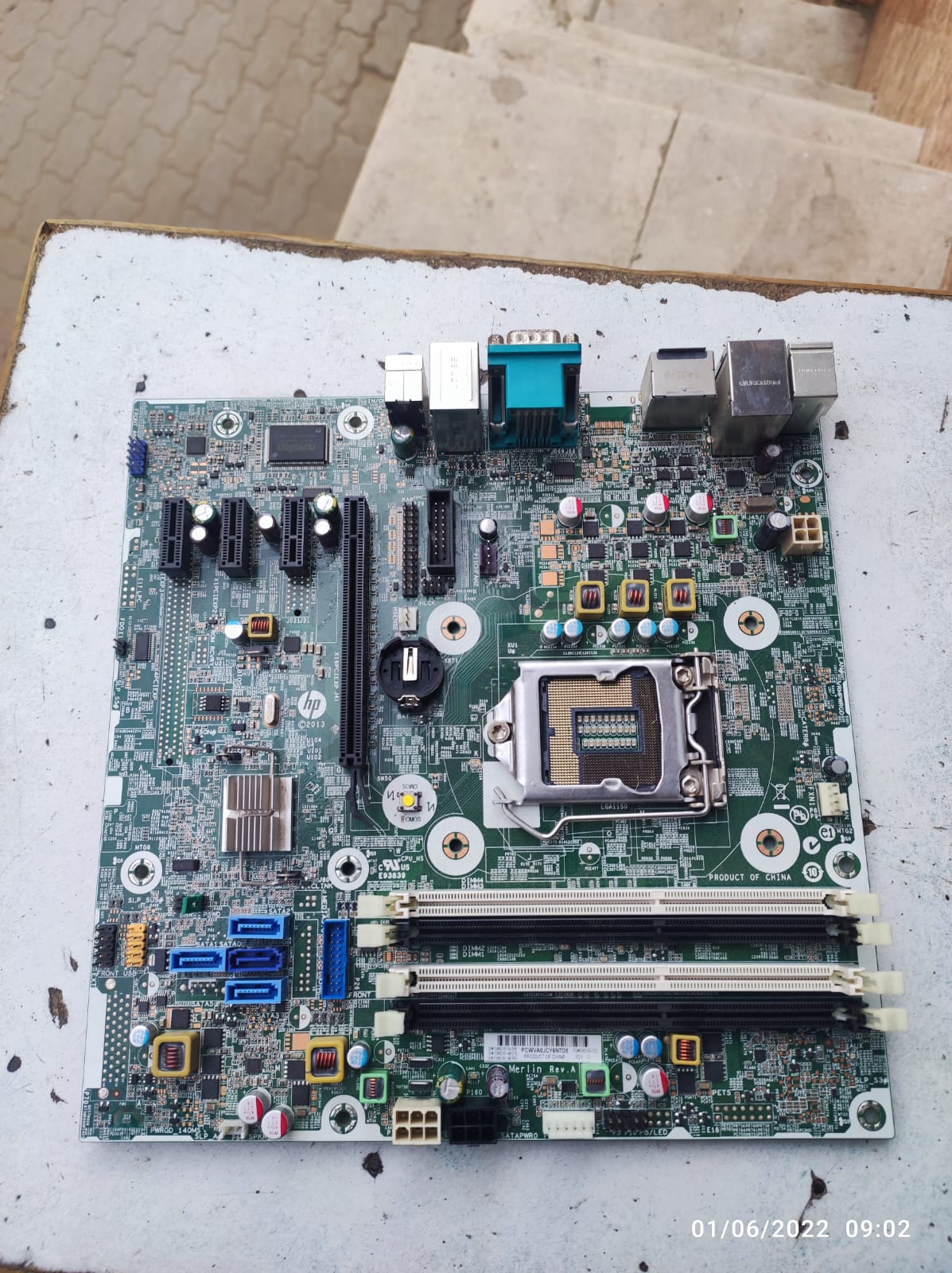

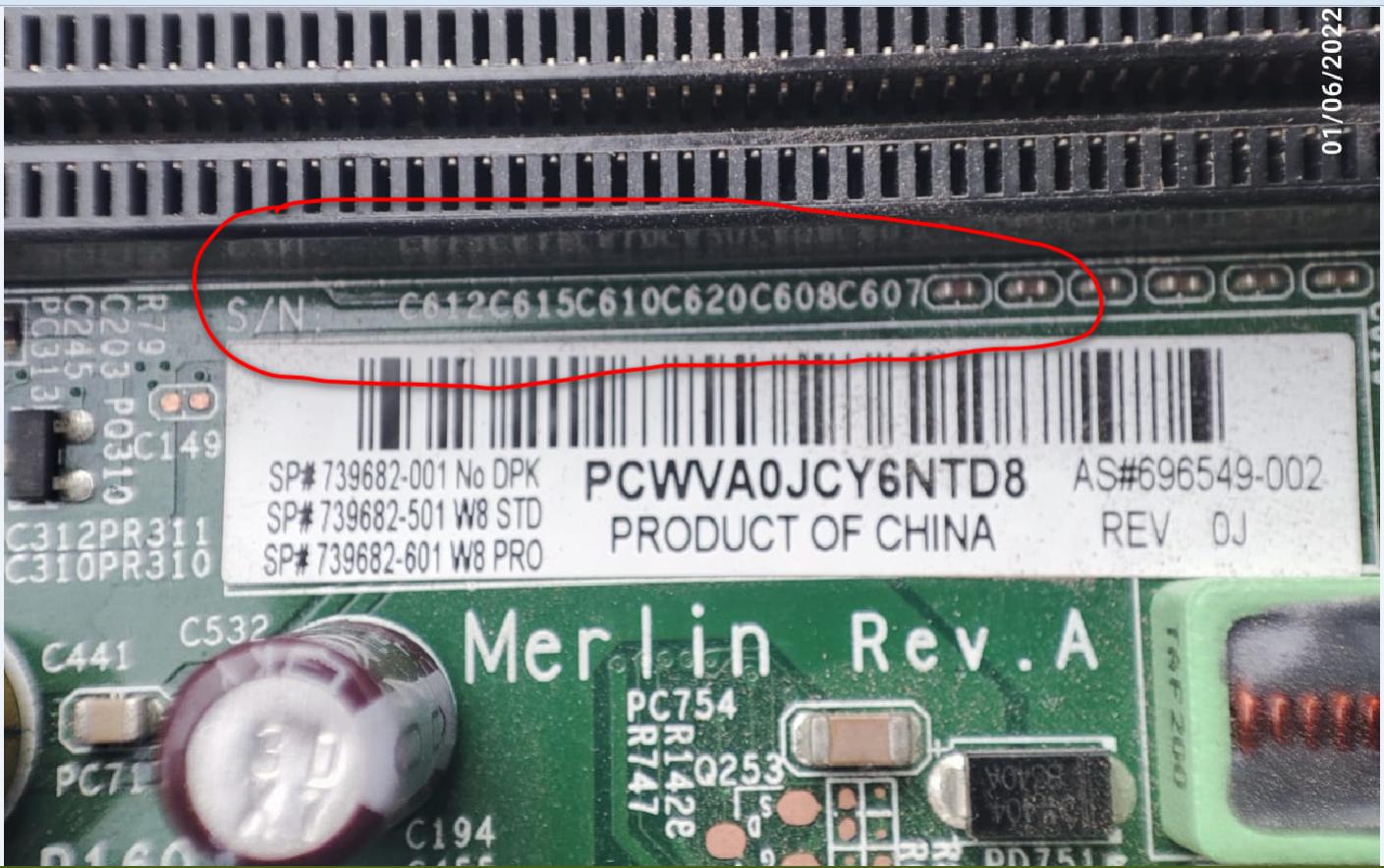

                Re: hp prodesk 600 g1 original bios
                I have hp prodesk 600 g1 sff (merlin rev a) sytem.
                S/n c612c615c610c620c608c607
                dont have backup bios, can anybody arrange clear working bios for it
                thanks in advance
                  "S/n c612c615c610c620c608c607" . what's this ?
                    Originally posted by hoaca388
                    "s/n c612c615c610c620c608c607" . What's this ?
                    board pic attached

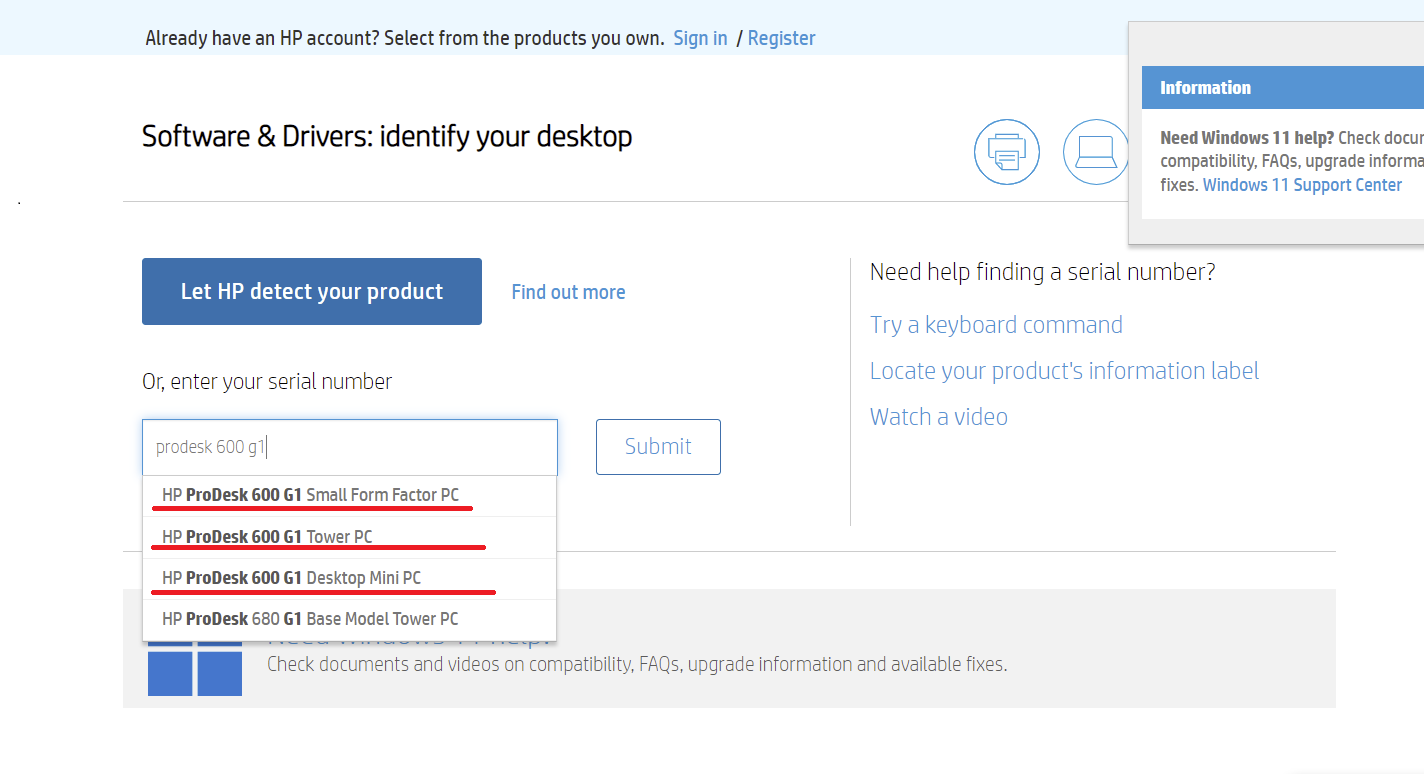

                      Originally posted by PASHACOMP
                      board pic attached
                      There are 3 search results, there is no HP serial number, so I don't know what type your machine is and also need the original bios to determine.
                          HP ProDesk 600 G1 Small Form Factor PC
                            Thanks sir, i will check it saturday and will give feedback
                              Thank you sir
                              Its working
