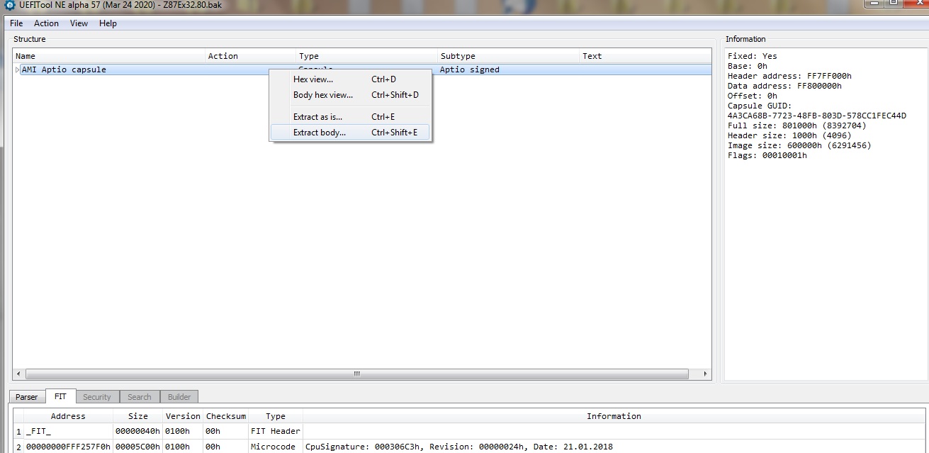

    Hello, I need bios bin file for Asrock z87 Extreme3 Rev. G/A 1.05
    • 21860
    Re: Bios Asrock Z87 Extreme3 Rev. G/A 1.05
    Go to the support page,download the "Instant Flash" bios version. Extract the 8,196KB bios then open the bios with UEFITool,right click,select "extract body" .That will remove the 4KB header leaving you with the full 8,192KB bios .

        Hello. i did as you advised SMDFlea, now this motherboard is working fine, thanks a lot people
