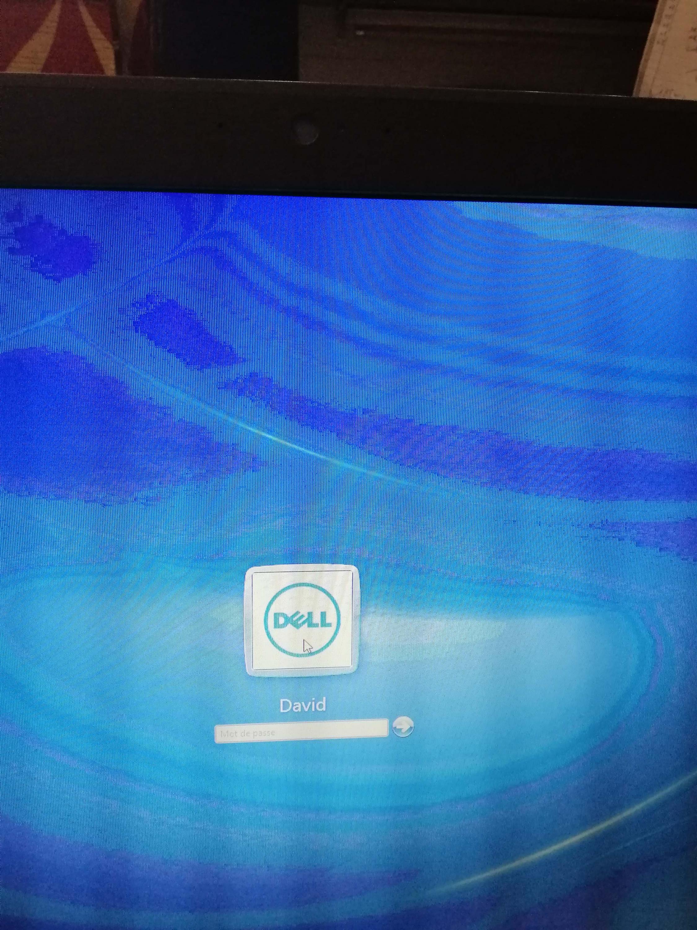

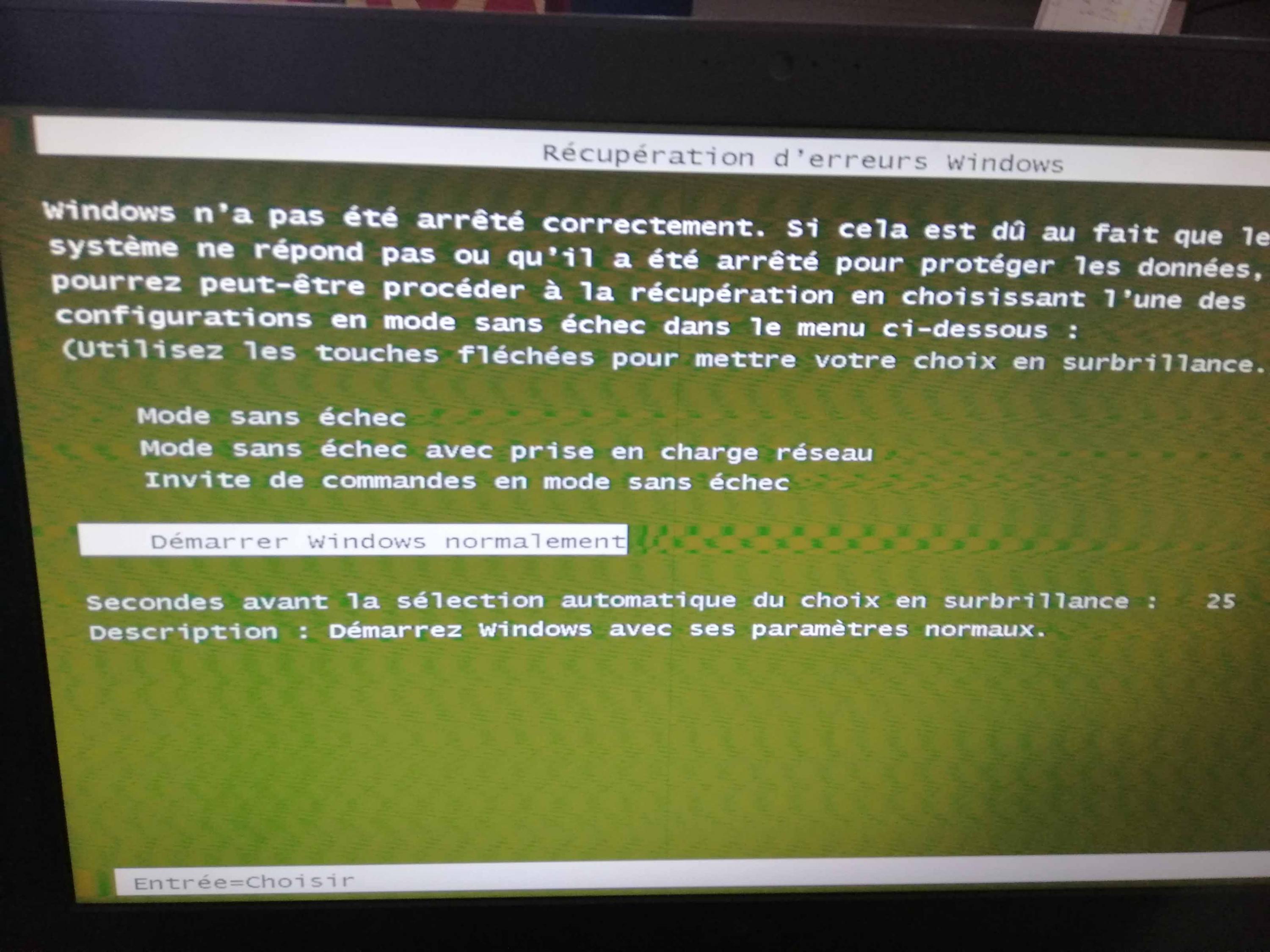

                        After charging, noise appears in the pictures
                        I also updated the same problem
                        The screen is good
                        Where is the defect
                        Do I cut a path LVDS-SLL

                          Re: dell optiplex 9010 all in one need bios pls
                          Clean and reseat LCD cable.
                            Thank you
                            The problem has been resolved
                            Just cleaning up
