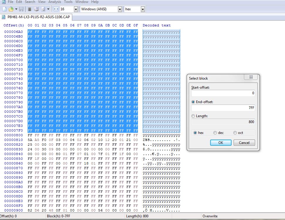

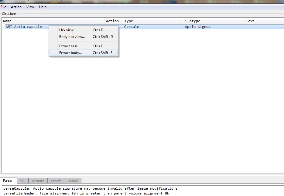

    here is I downloaded from official site but it has 8,194Kb how to cut this and make it 8,192kb?please help

      You can cut the cap header with a hex editor, offset 0 - 7FF Length 800 , or use UEFITool.Open bios with UEFITool ,right click on AMI Aptio Capsule - Extract body .
      https://mh-nexus.de/en/downloads.php?product=HxD20
      https://github.com/LongSoft/UEFITool..._A55_win32.zip

        Re: asus P8H61-M LX3 PLUS R2.0 need bios
        thanks smdflea its working i used UEFITOOL and follow your instructions, now the file is 8,192kb
