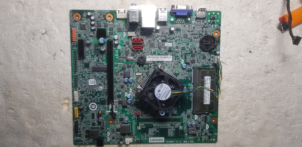

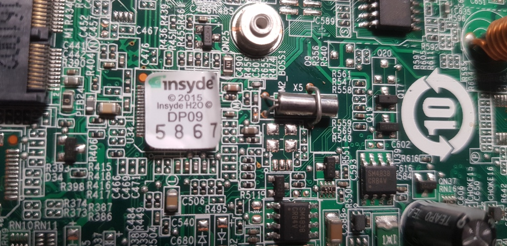

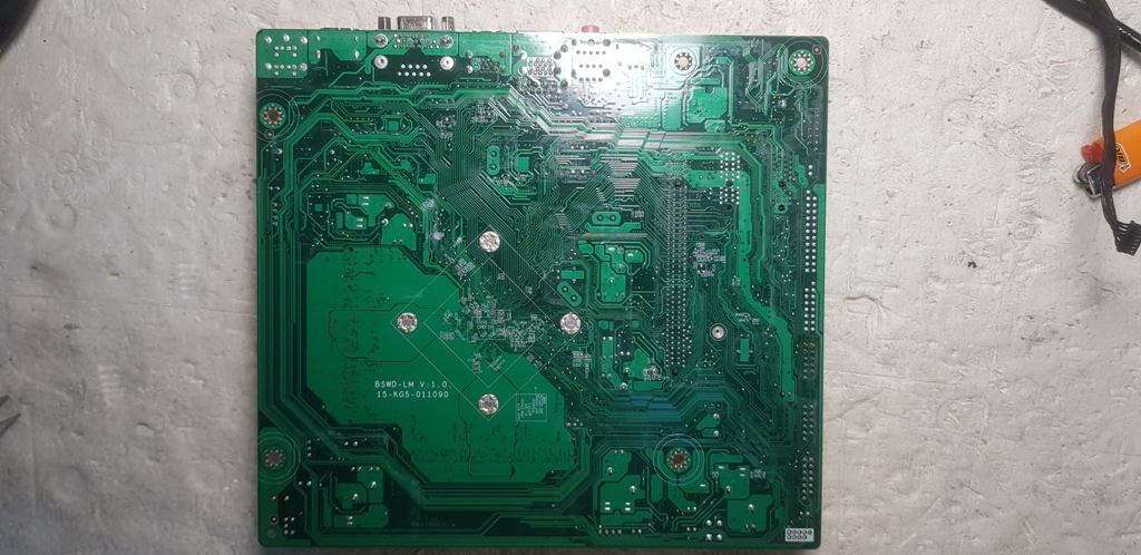

    I need to dump bios please attach photos of the motherboard
    thank you all

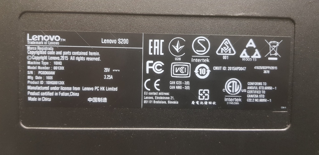

    What is the PC full model number,and machine type.

      Re: Lenovo S200 I need to dump bios please
      it's a desktop
      machine type: 10HQ
      model number: 0013IX
      I attach photo label
      thank you
