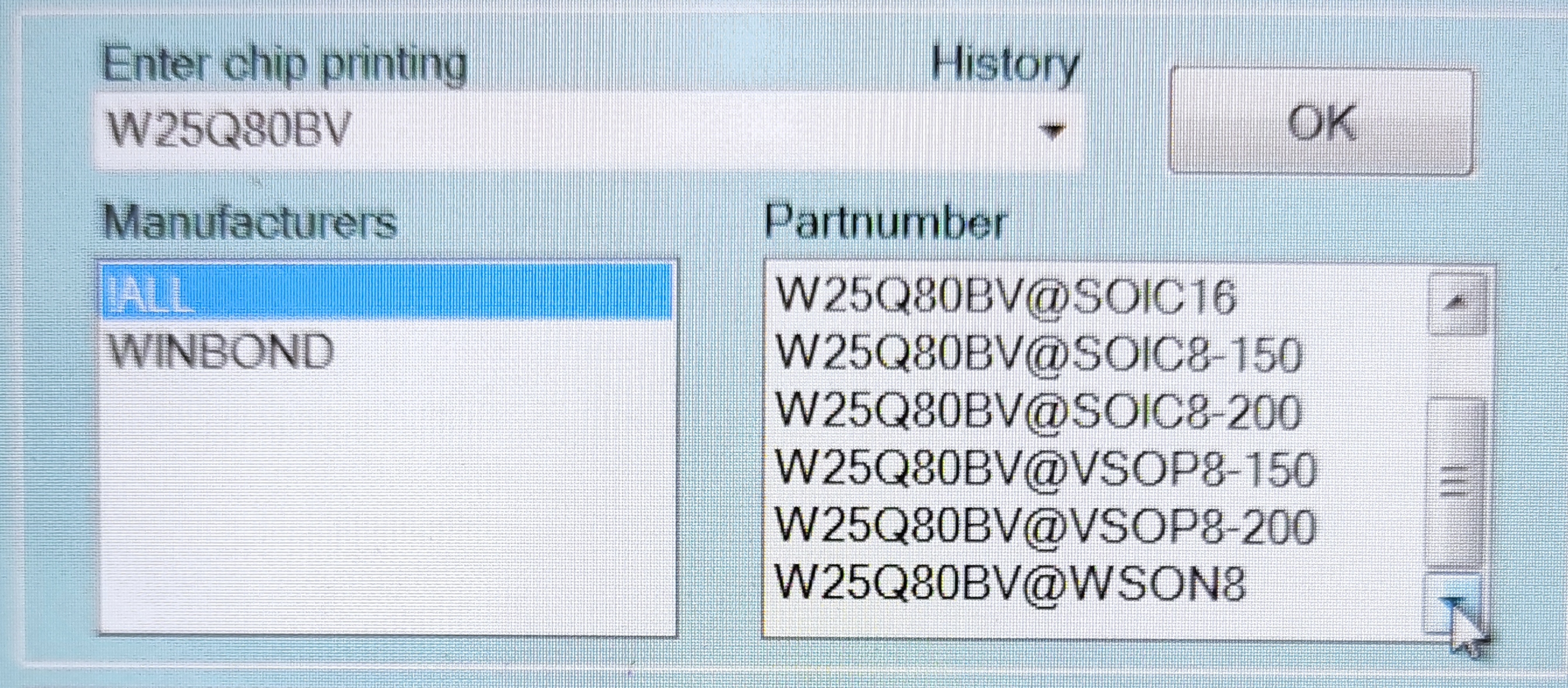

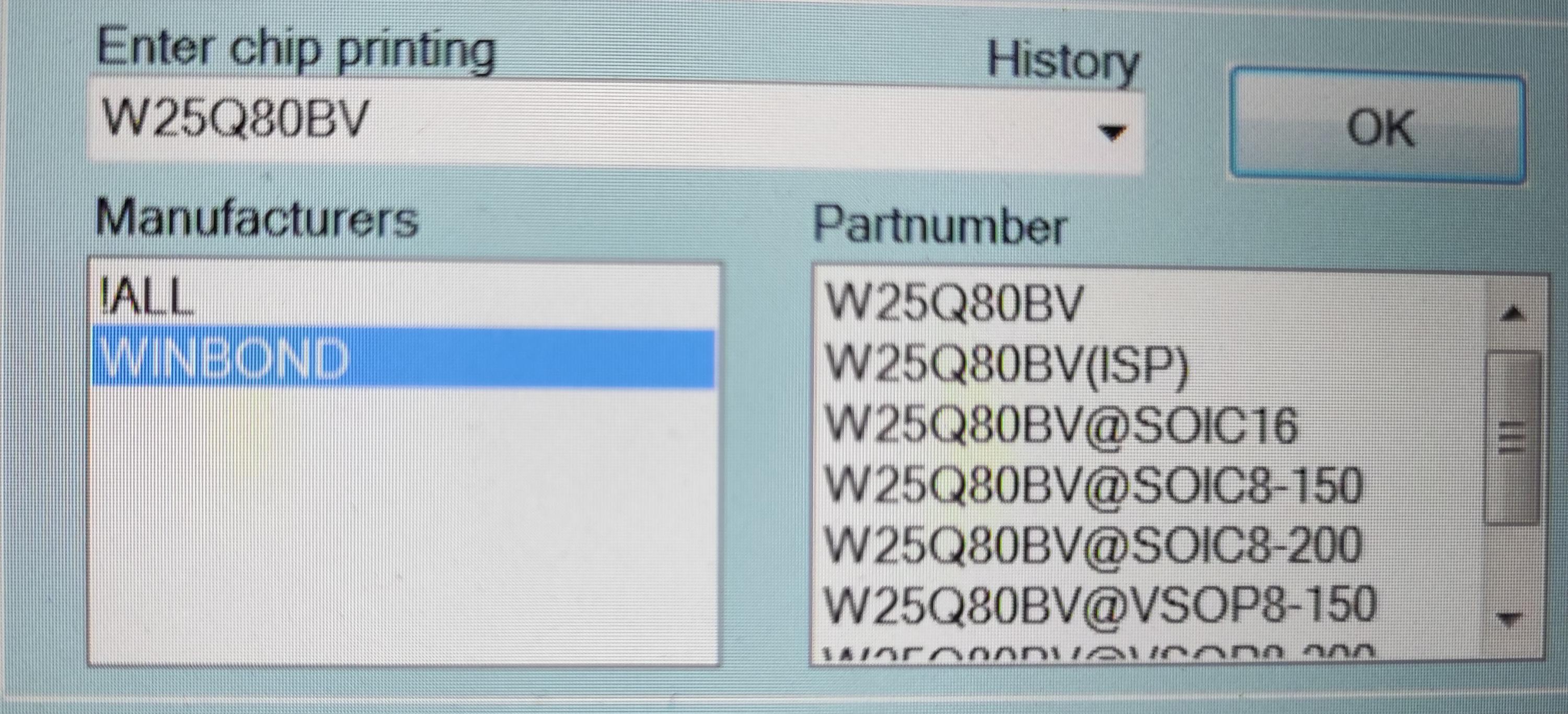

                  Re: Hp envy 20 all in one bios 6050a2516301-a02
                  HP ENVY 20 TouchSmart AIO PC
                  20-d038d motherboard part no: 6050A2516301 A02 bios need urgently please help I have try techman1025 Lar816_zip file it prompt this rom is mismatch to the size the winbond chip W25Q80BVSIG
                    • 20807
                    Because you`ve chosen the wrong SPI chip. The W25Q80BVSIG is 8M-BIT (Mega Bits) not MB Mega bytes. I hope you made a backup and havnt erased it.

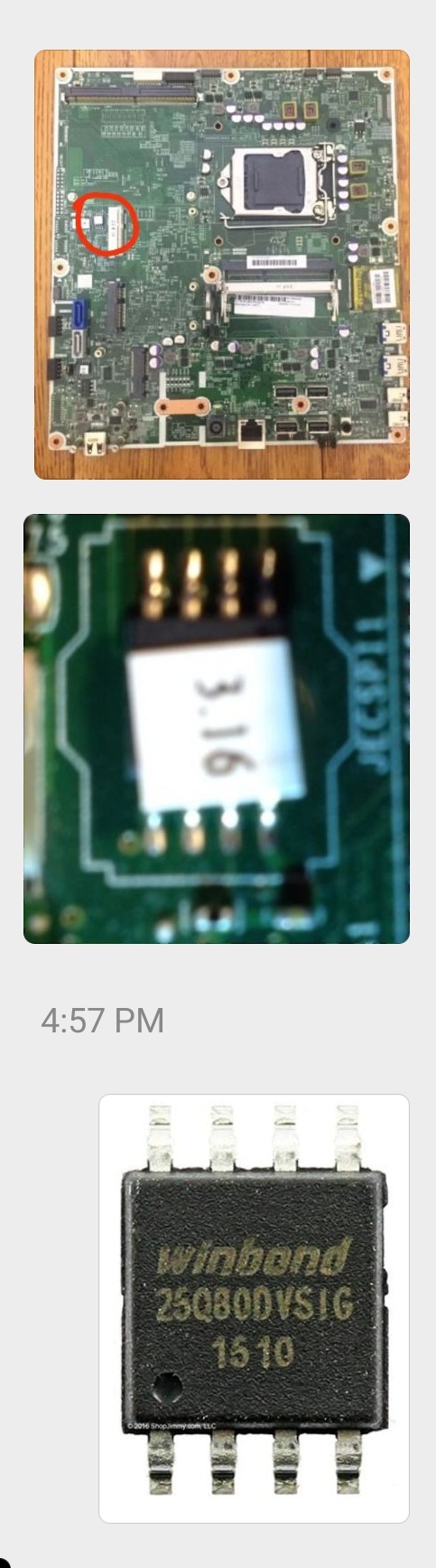

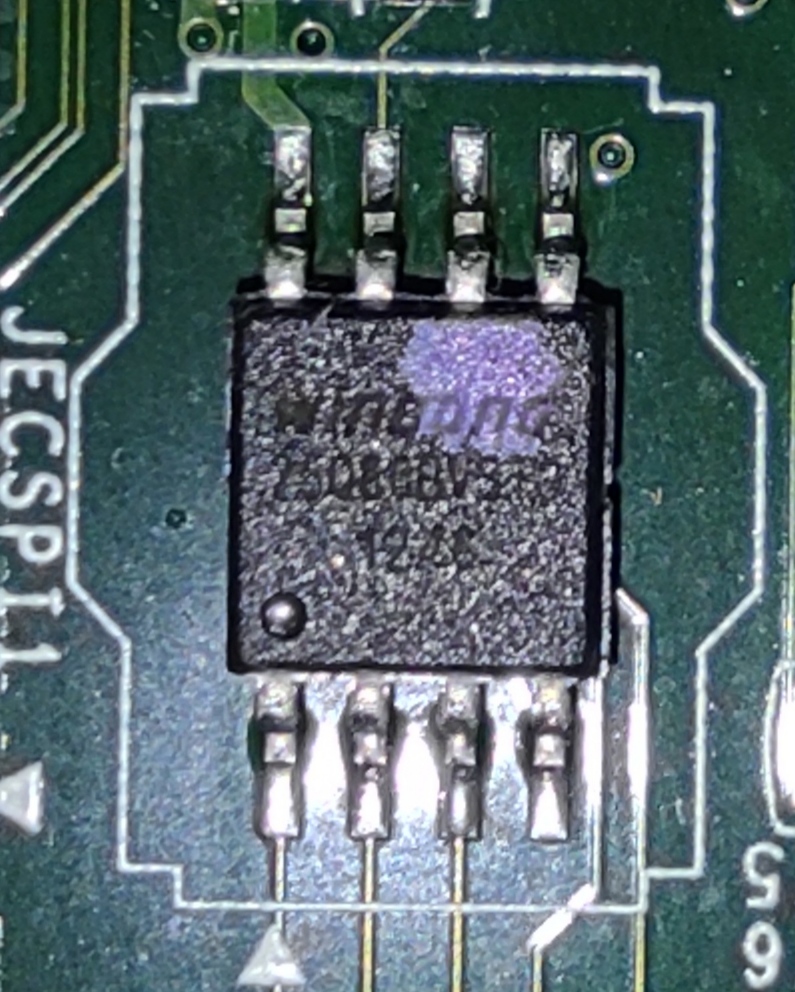

                      Already bricked...and gone this motherboard came with Winbond W25Q80BVSIG chip
                      This is RT809F programmer it have on those winbond chipset part number....

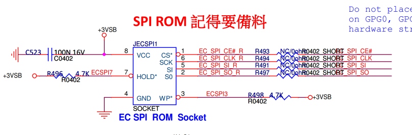

                        JECSPI1 is the EC .
                        Schematic - https://www.badcaps.net/forum/showthread.php?p=1081588

                          SMDFlea the schematic diagram for....? I thought you will upload a bin or rom file to solve my issue
                          • lawch8382
                            • Jun 2015
                            • 5
                            • singapore
                            I saw the location from schematic diagram JECSPI1 EC however I could not find 6050A2516301 A02 motherboard Rom / Bin file
                            • lawch8382
                              • Jun 2015
                              • 5
                              • singapore
                              Any kind soul can upload JECSPI1 EC EC_W25Q80.BIN file (3.16)
