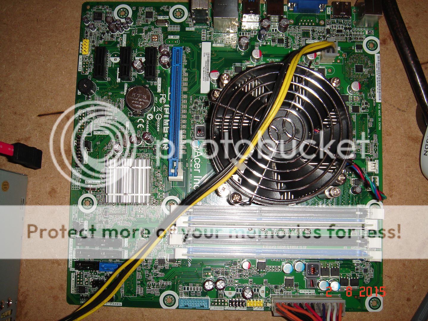

    I'm desperate to find the bios for this mobo, i got the mobo naked and i don't know from which desktop it comes.
    I have made a backup from bios chip, and it's a winbond W25X64 and it's a 8mb file.
    all the bios that I was able to find are 3mb on size.
    Please Help me.
    Thank you

          • 31246
          Re: Bios for Acer Desktop Motherboard IPIMB-AR Rev1.02a
          it's a UEFI bios, those use a hidden partition on the harddrive, i'm not sure how to get around those.
          what's wrong wih the machine?
            previous owner (eBay) says that it stuck on Acer logo, no other explanation, it seems that it happened after a update.
            Here, I only get the fan to run fast, but no keyboard, video, mouse activity.
            But even to get it started, I need to start the mobo several times, causes it seems that the psu is not giving enough juice (tried a 400 and 550 watts psu's).
              • 31246
              unplug all the sata cables and try it.
              what cards are in it?
              and post a foto, i'v never seen an acer desktop board.
                  Originally posted by passete
                  Please, anyone to help ?
                  so what happens if you unplug the drives?
                  you cant just flash a UEFI bios if the table on the drive is corrupt or the version does not match!
                  let me be more specific.
                  UEFI bios stores configuration data and other "stuff" on a hidden drive partition.
                  and bad sata drives can stop a motherboard starting.

                      • 31246
                      no, it means if your harddrive dies it can stop the board starting until it's unplugged.
                      so you have a board and cpu + ram.
                      are you testing it with a psu?
                      show a foto of the setup.
                        It's Acer Aspire M3985 mainboard.
