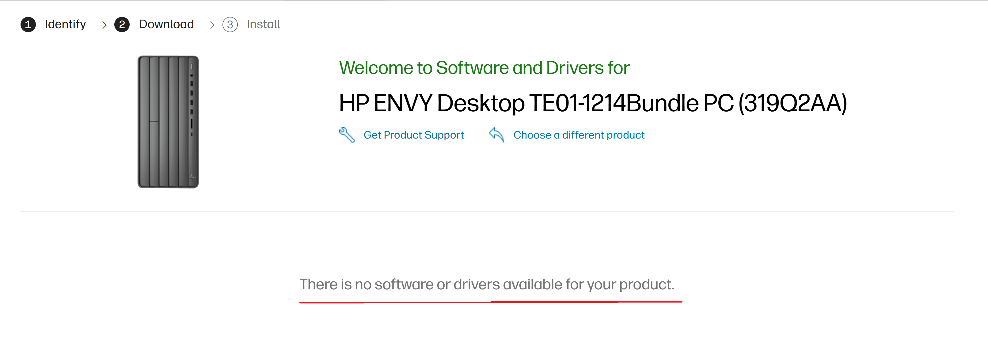

Name:	2025-04-26 22_17_11-HP ENVY Desktop TE01-1214Bundle PC (319Q2AA) Software and Driver Downloads _ HP®.png

        Your bid is 08767 , not 08B3B.

          Interesting. I do not see that .bin file from extracting , but it has 087D6. Should i try this attached bin? Also, I have read the BIOS chip more to identify if the reads were identical, attached as well. Isn't it crazy there are no software drivers or anything on their site for this desktop...absurd

            No , your bid is 08767​.

              Understood. I will try my due diligence to track down the correct .bin file. Do you have any idea -- You saw there are no drivers available on their own site.
