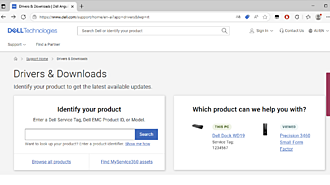

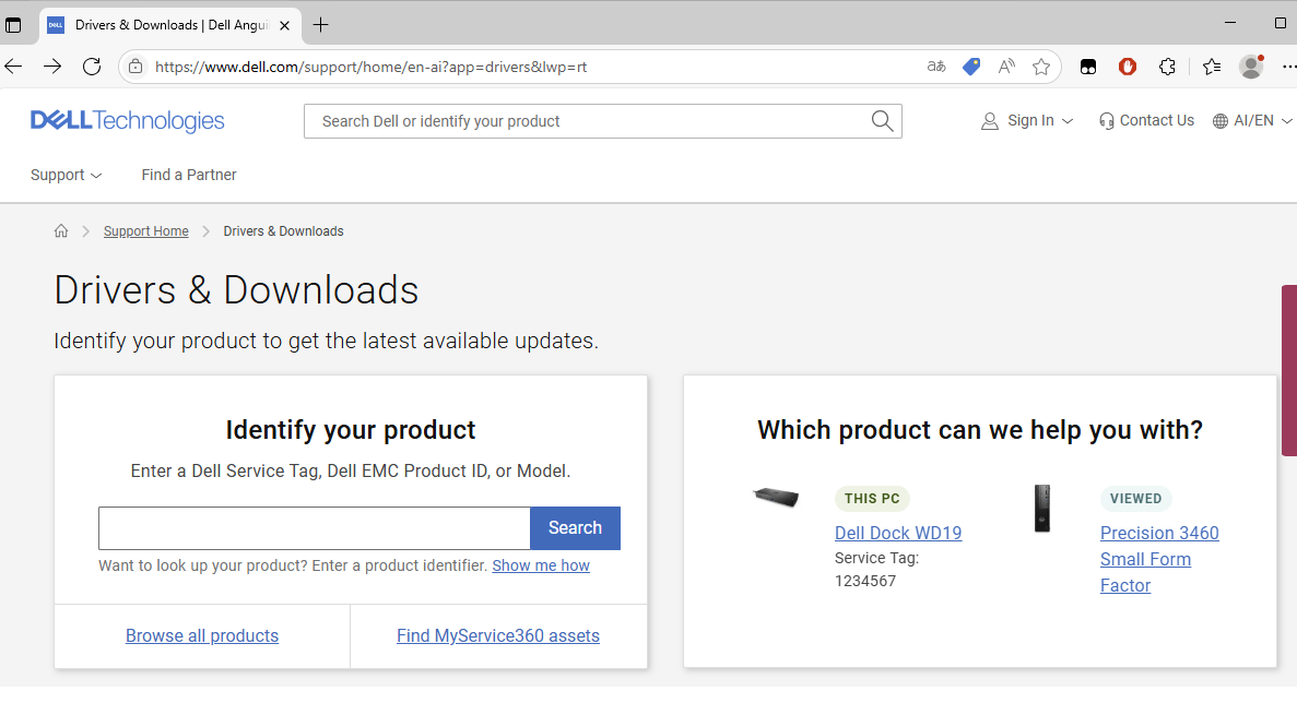

    Hi everyone,
    I have a Dell Precision 3460 Small Form Factor test unit. Its Service Tag was manually set to 1234567, which causes Dell to misidentify the device (it’s being recognized as a docking station), so I can’t use automatic driver updates or get proper support.
    The correct Service Tag should be: FXHFV04.
    Could someone please help me reset or clear the BIOS so I can re-enter the correct Service Tag?
    Any guidance or tools would be greatly appreciated. Thanks in advance!
