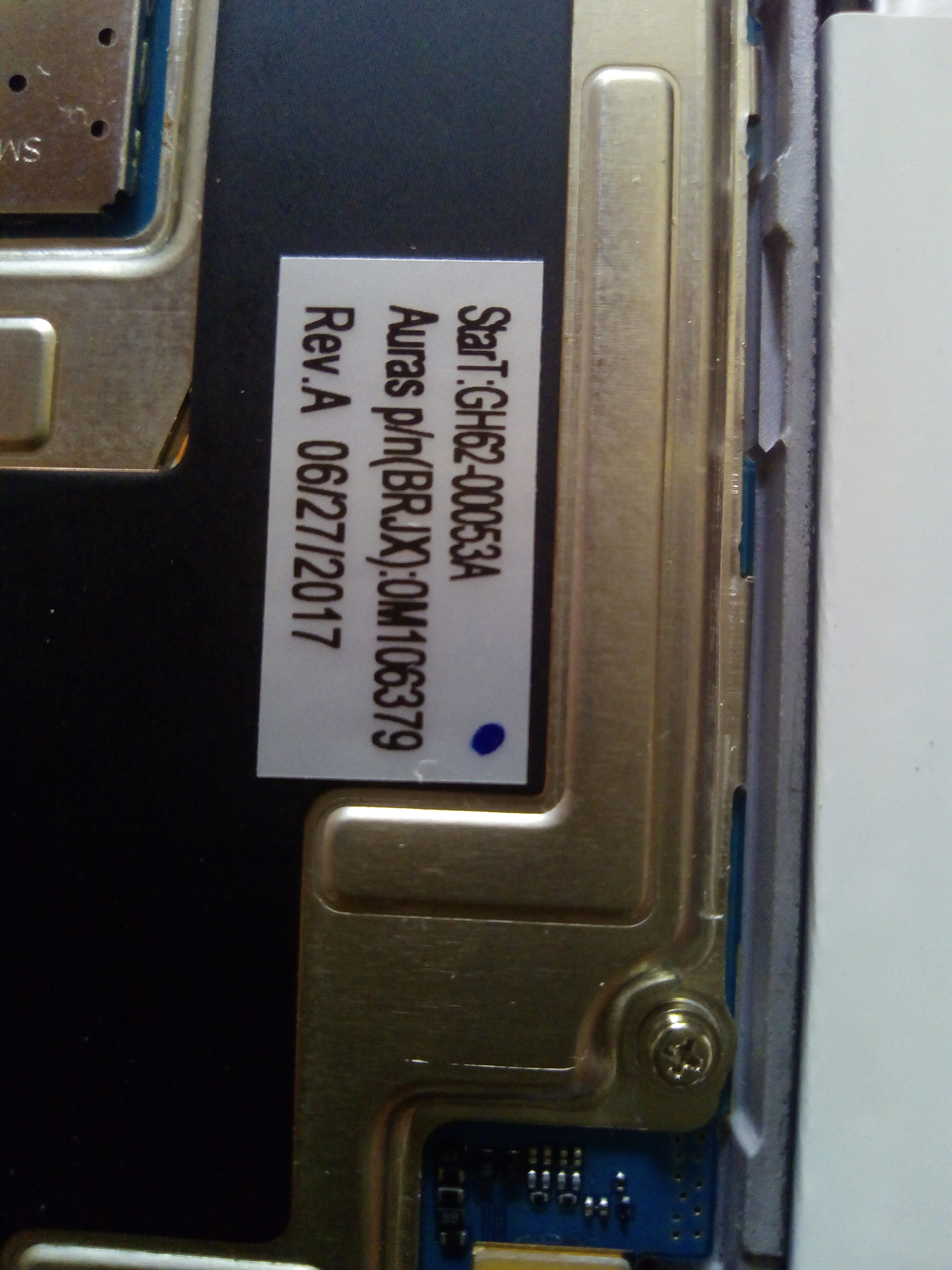

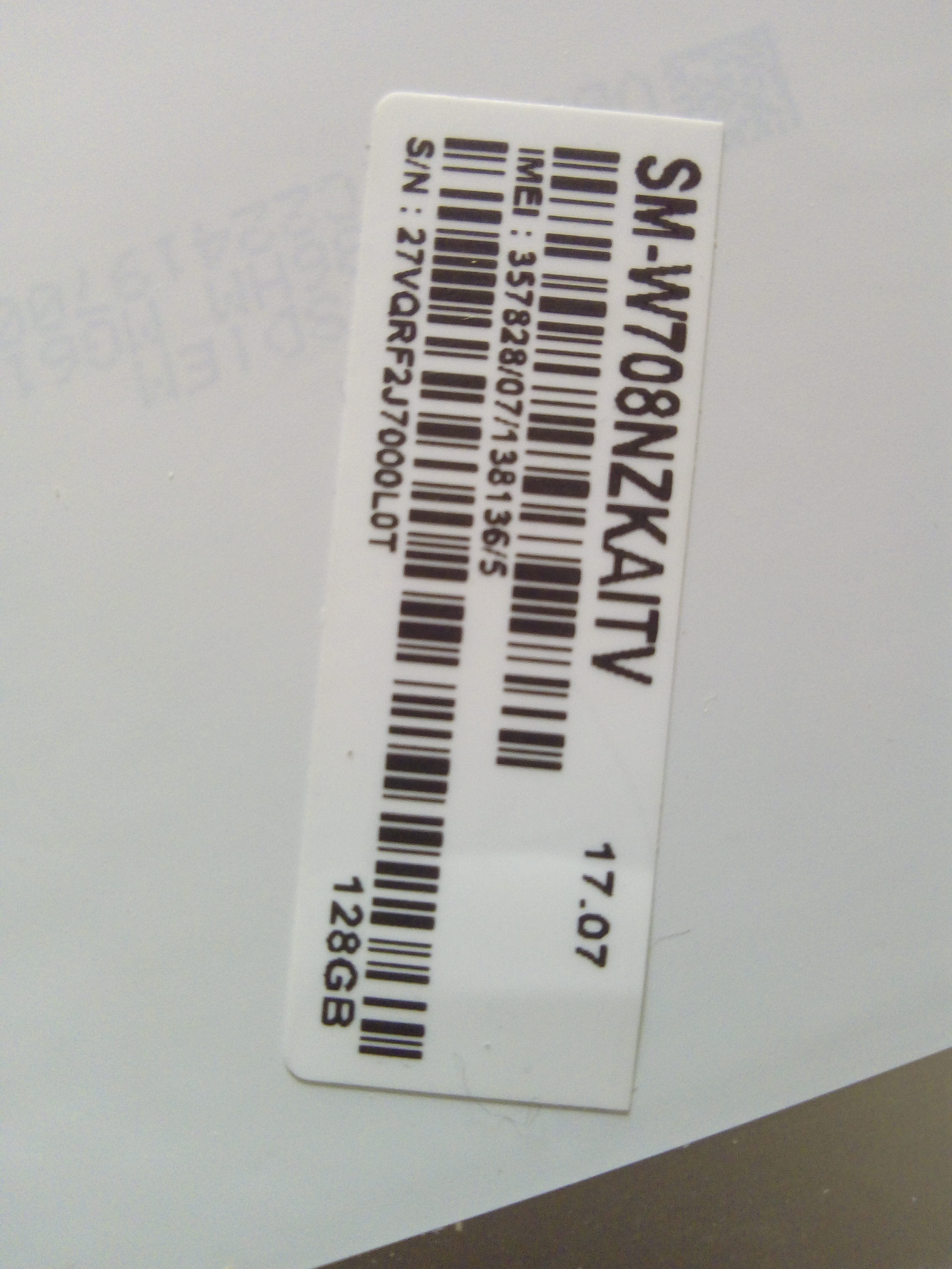

                    Galaxy TabPro S (12.0, LTE) model sw-708nzkaitv s/n 27vqrf2j7000lot mainboard star t:gh62-00053a
                    hi, here is the corrupted bios dump and the images of the serial and mainboard, the tablet freezes on the logo I think it's the corrupted bios

                        dear friends, thank you from the bottom of my heart, after programming with your firmware the tablet came back to life avoiding death in landfill, you are wonderful.

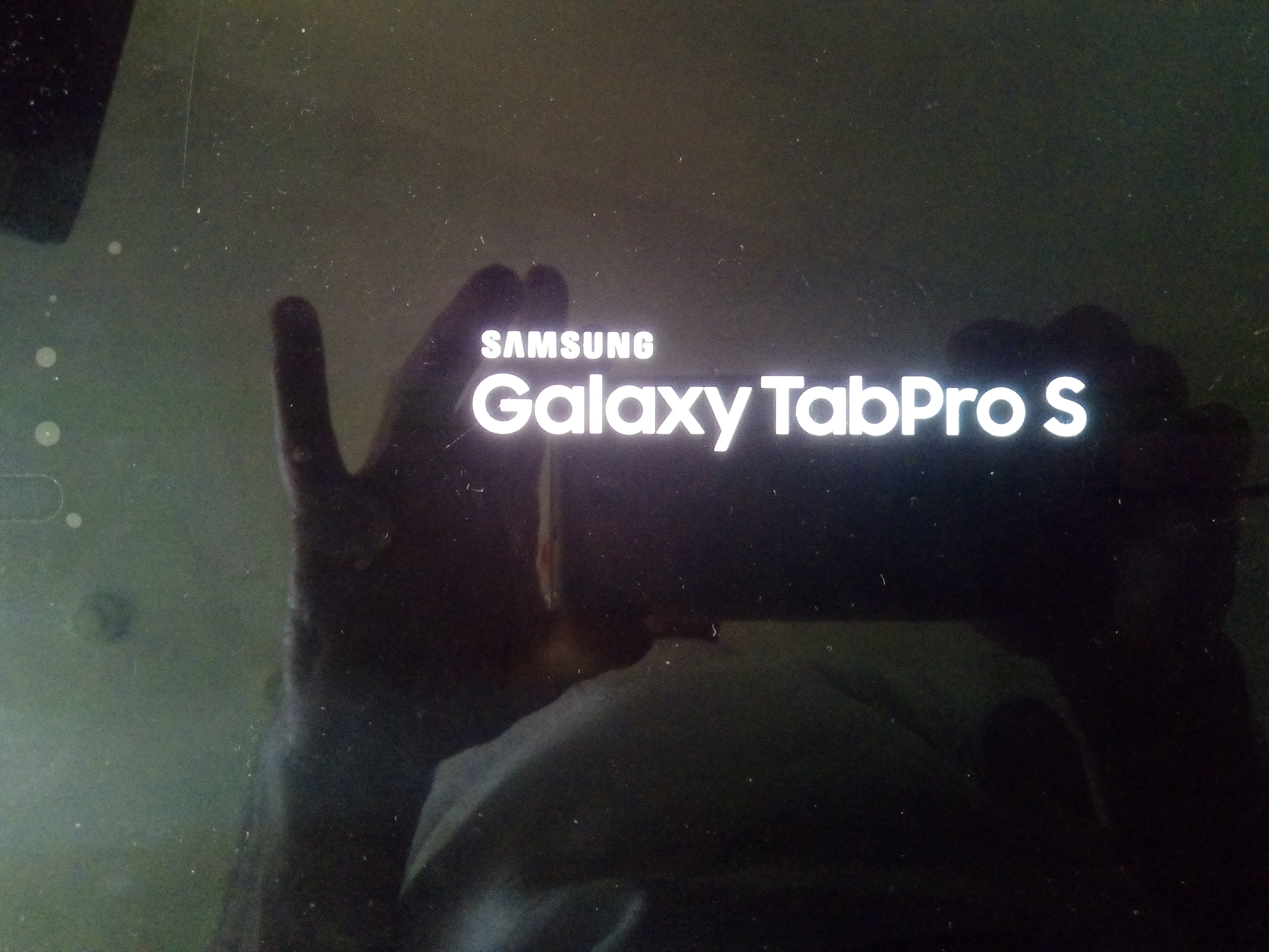

                          Hello friends, I have the same problem, I was updating the bios manually, the tablet worked normally with the bios version on P14 and the micom on the P13, but again I updated the bios already being with the version of the P14 to the same and the tablet started to blink and turned off, now the tablet only turns on to the logo and turns off, I want to reprogram the bios, the tablet is a Galaxy TabPro S (12.0, LTE) model sw-708nzkaphe sn: 285drf2j40005lt, do you think this file works correctly? helpme plaese.... (I try to download the file but it says Invalid File Specified)
